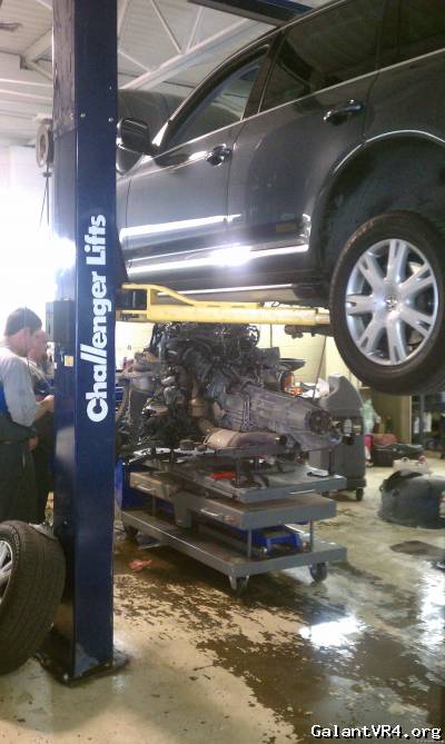

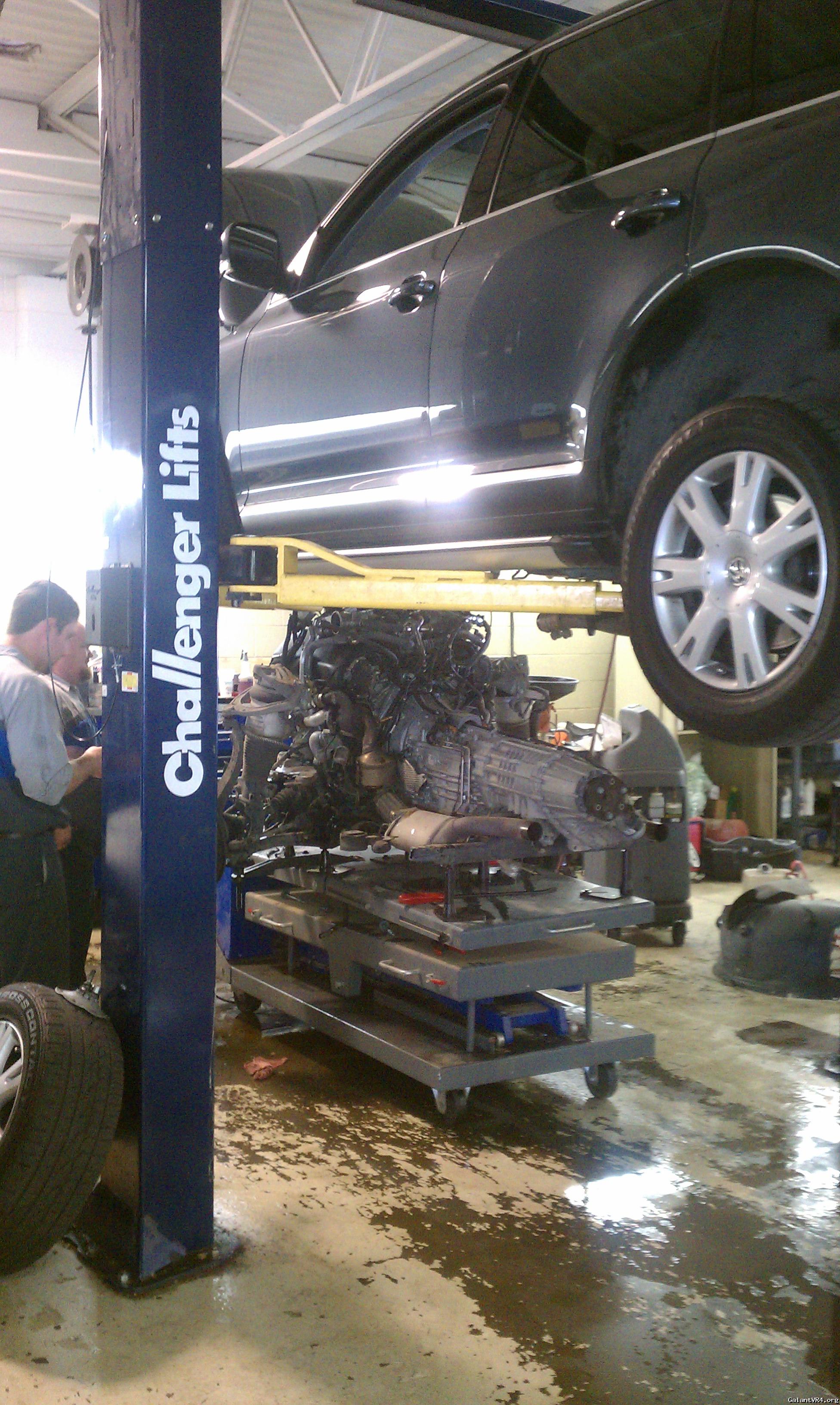

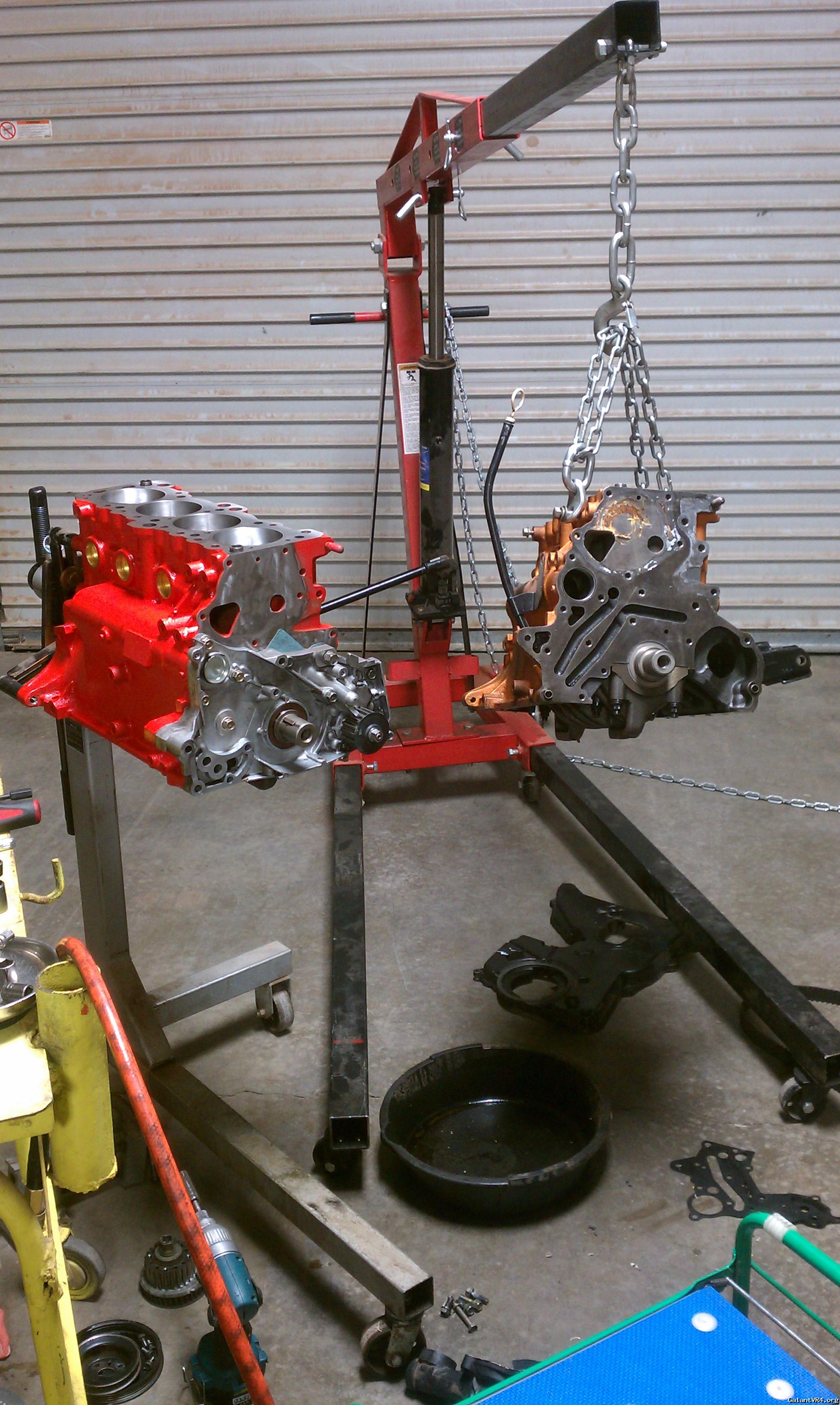

Anyone interested in replacing a power steering pump that is driven by the flywheel on a v10 diesel touareg? The snout of it drives the snout of the a/c compressor. haha. That's the first time that engine table has ever been used.

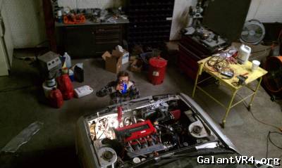

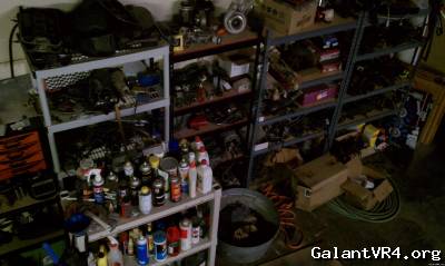

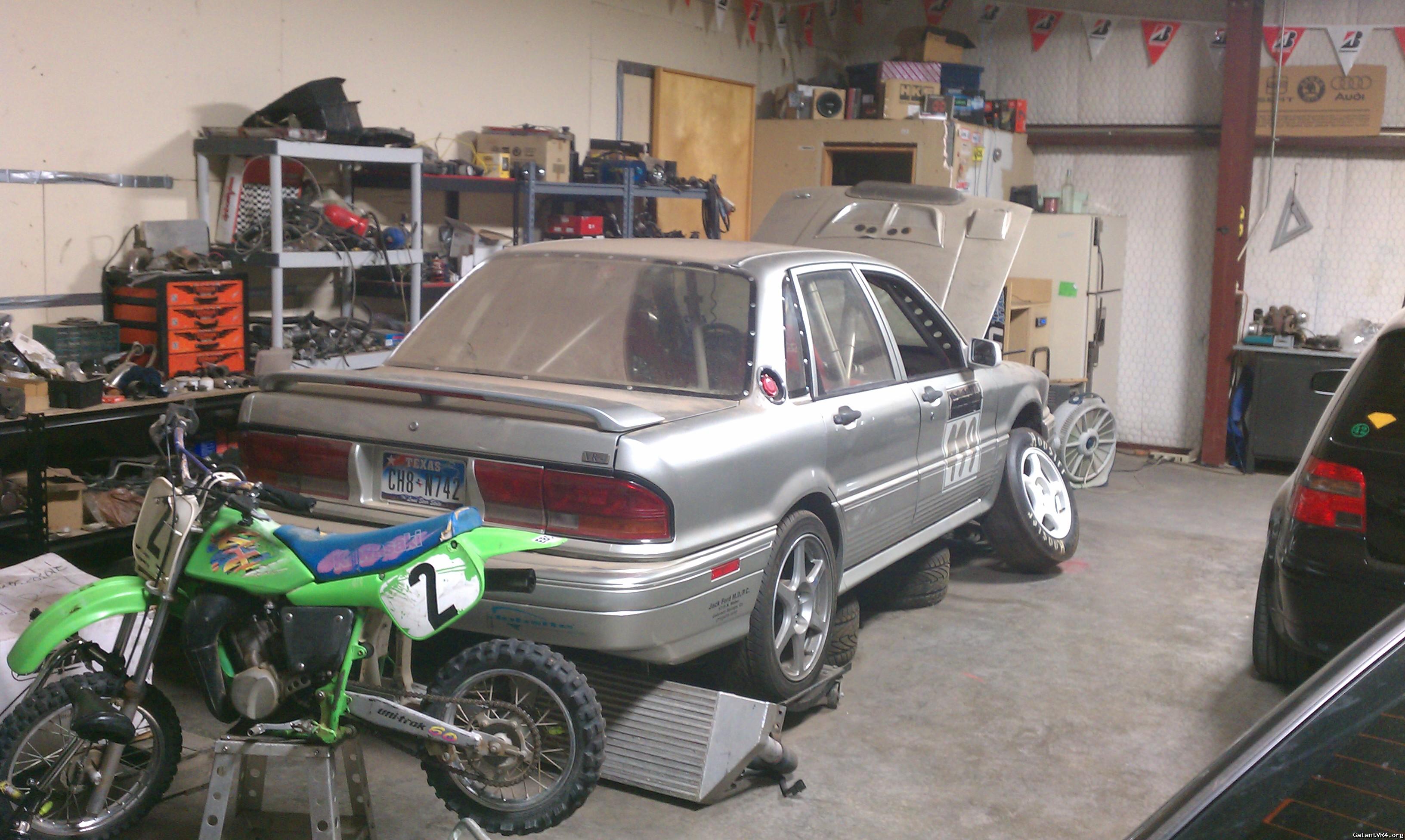

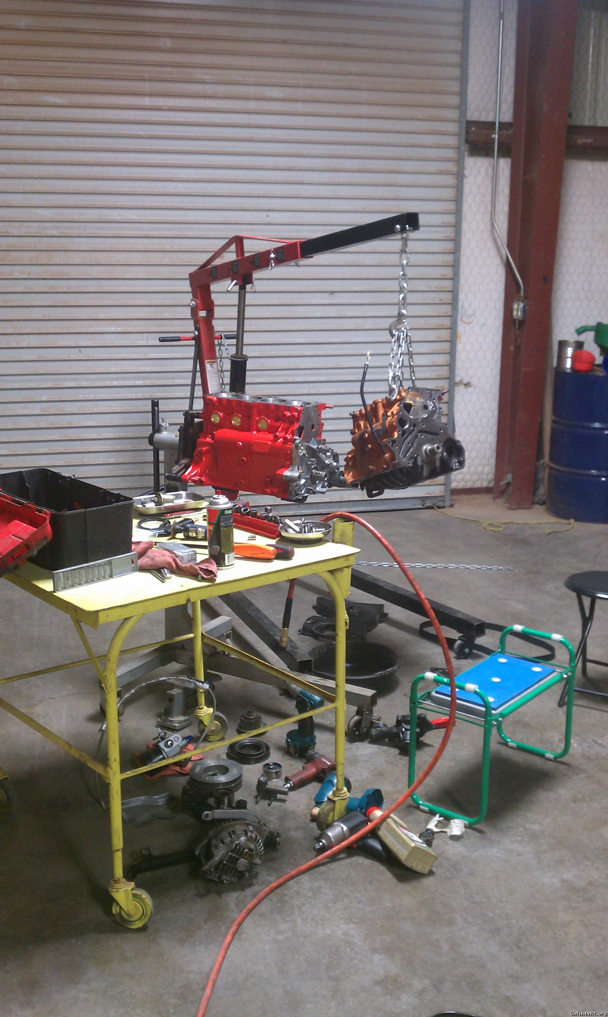

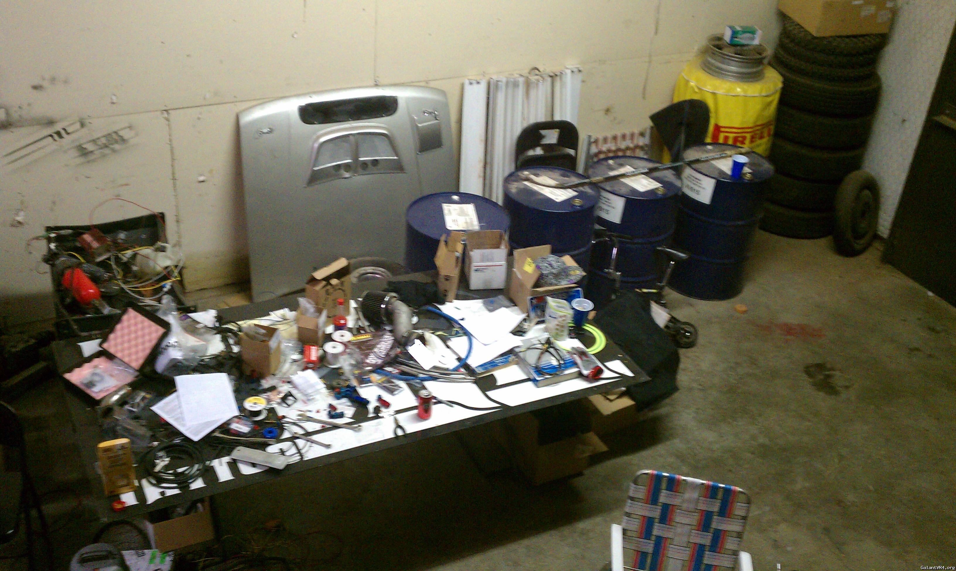

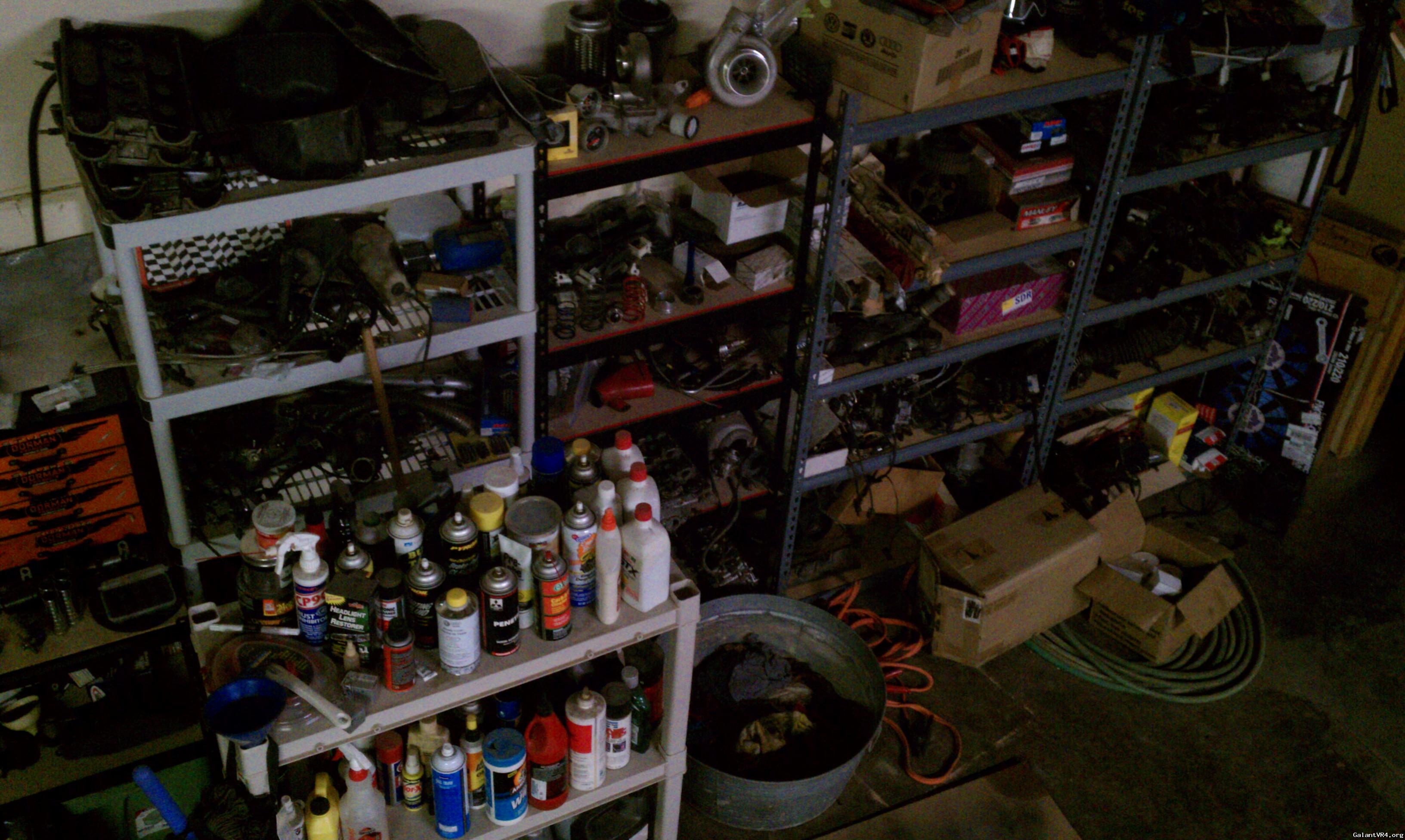

Some pics of my shop
I havn't really looked at those pics, so we'll see if I left anything embarrassing out. haha

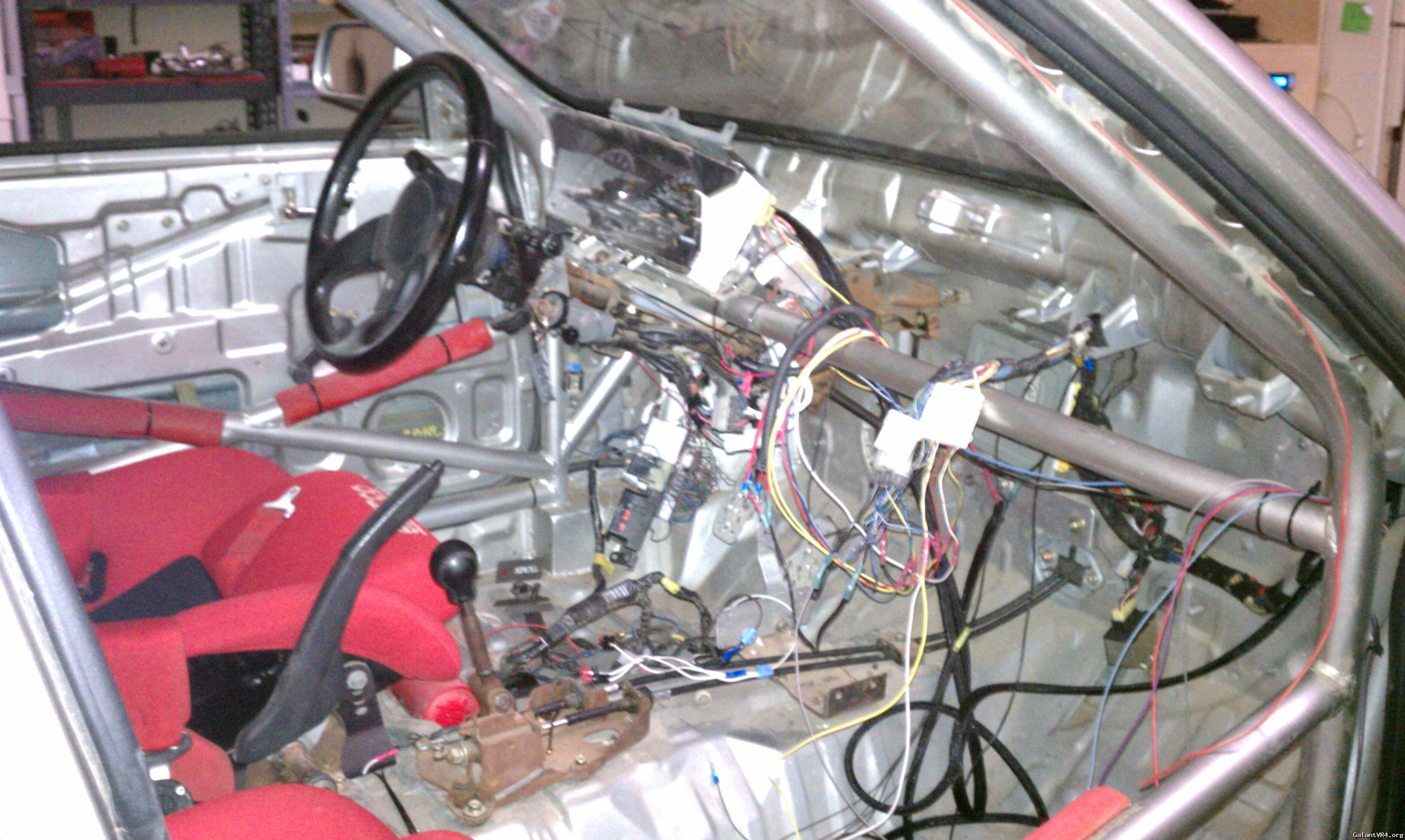

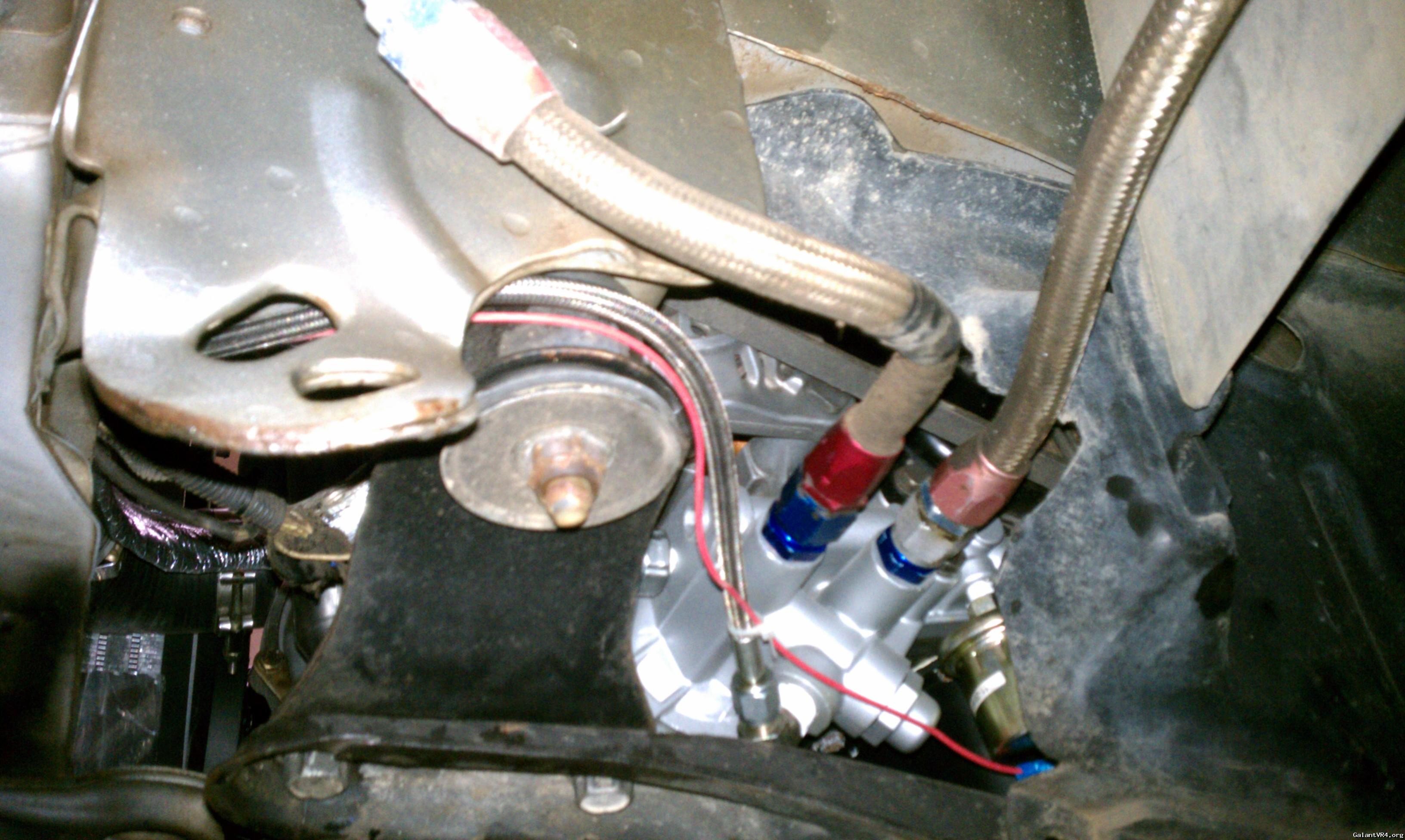

I got all the fuel feed lines made and mounted the fuel pumps. All fittings but one should be here today. Once they get here, the feed will be finished after I wire the fuel pumps. One last fitting will be here tomorrow to finish the return side. I should have the return lines made today when the hose gets here. Then I have to wire my wideband output to my ecm. I'm going to have dsmlink simiulate a narrowband signal to make the ecm happy. Then I need to wire up my cooling fan.

Enough fittings finally arrived yesterday to get one of the fuel pumps plumbed in. I attemped to start it with little luck. It ran(very poorly) for a few minutes. Off to the link forums!!

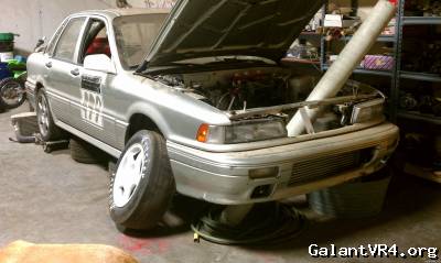

I drove it home from my shop today for the first time!!! Got it running alright for now. I'm so excited. I need to get new pics up of it with the stickers removed and lexan buffed.

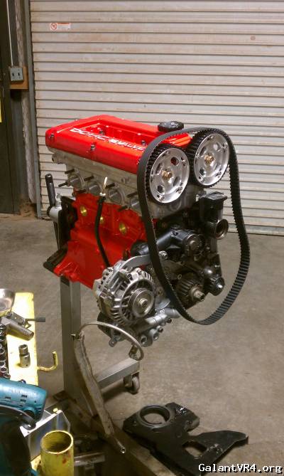

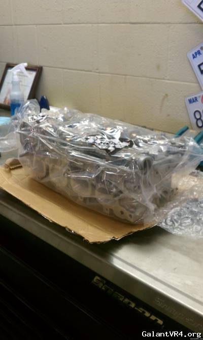

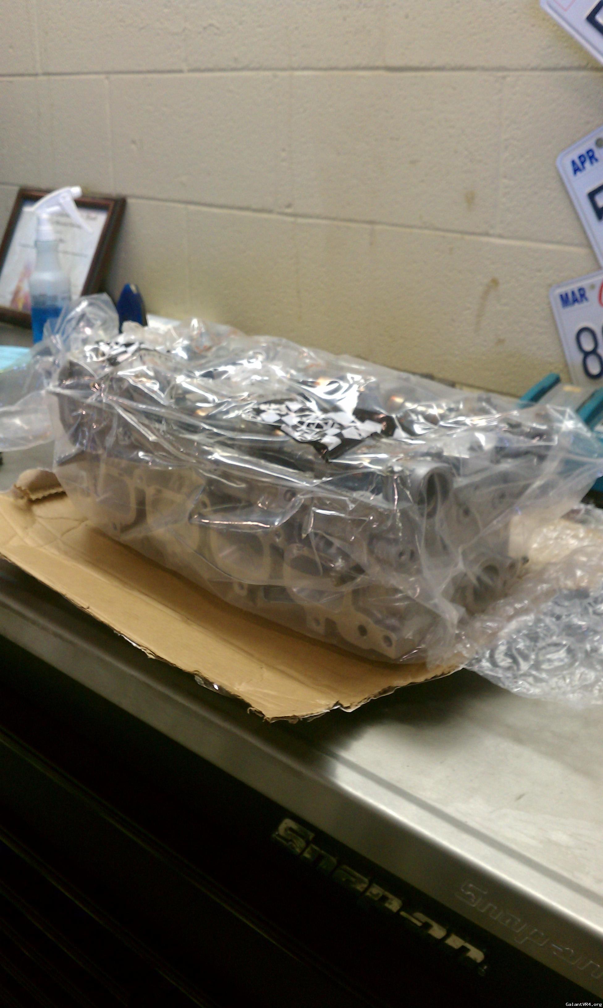

So I lifted my head on the dyno which I talked about in another thread. I didn't know the head had to be machined by a special machine that gets the head surface super smooth. I got a loaded bottom end and head from Class One in the Chicago area. SUPER place to deal with. Terry was SO very helpful. If you don't know, they build engines for Mike Reichen and Yusuf Begic. Both have very cool white Evo 2s and both kinda fast /ubbthreads/images/graemlins/smile.gif
This past sunday I ordered new head studs, head gasket, tbelt and many other misc gaskets to get the engine together and put it back in the car. So hopefully I'll be driving it again before too long.

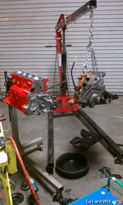

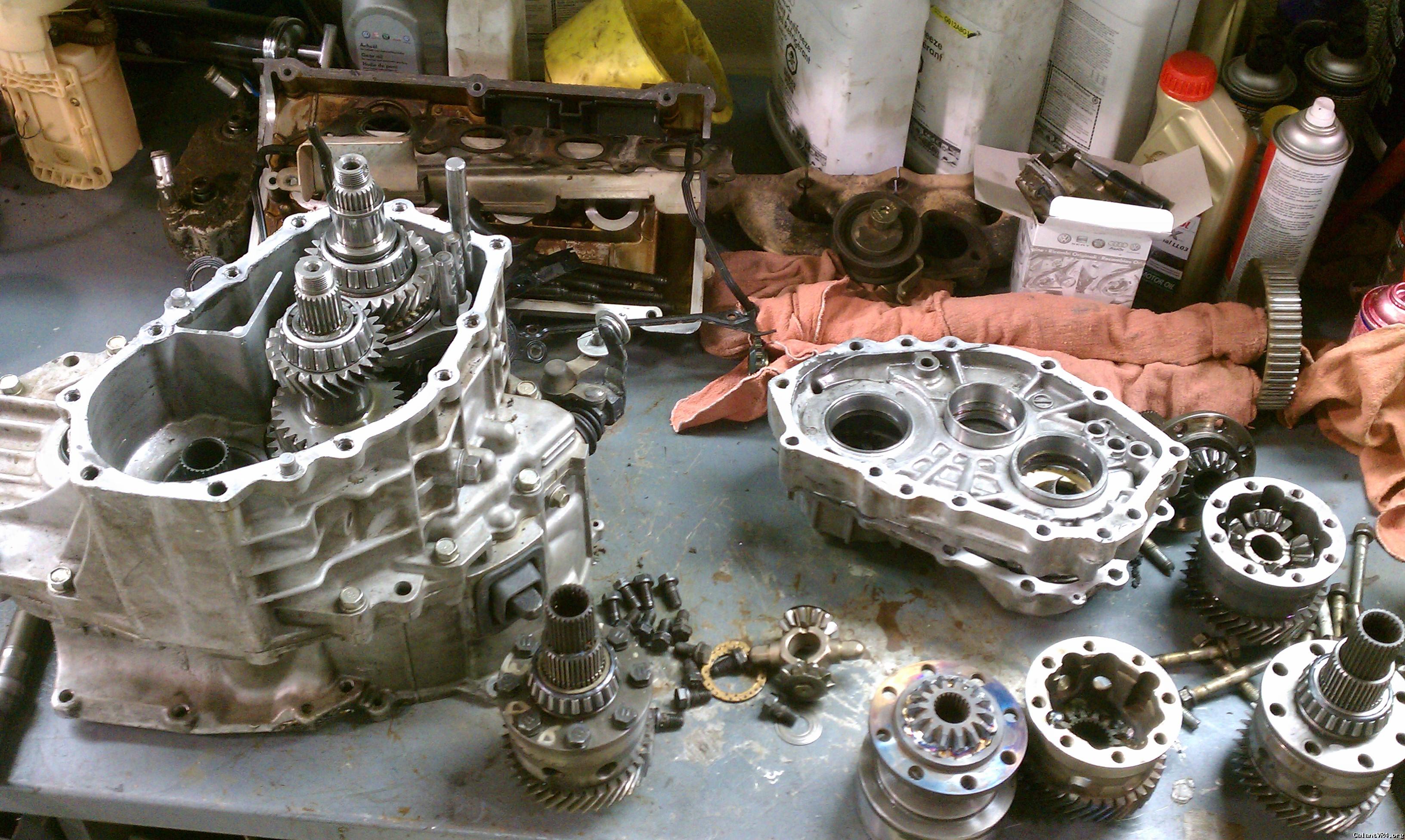

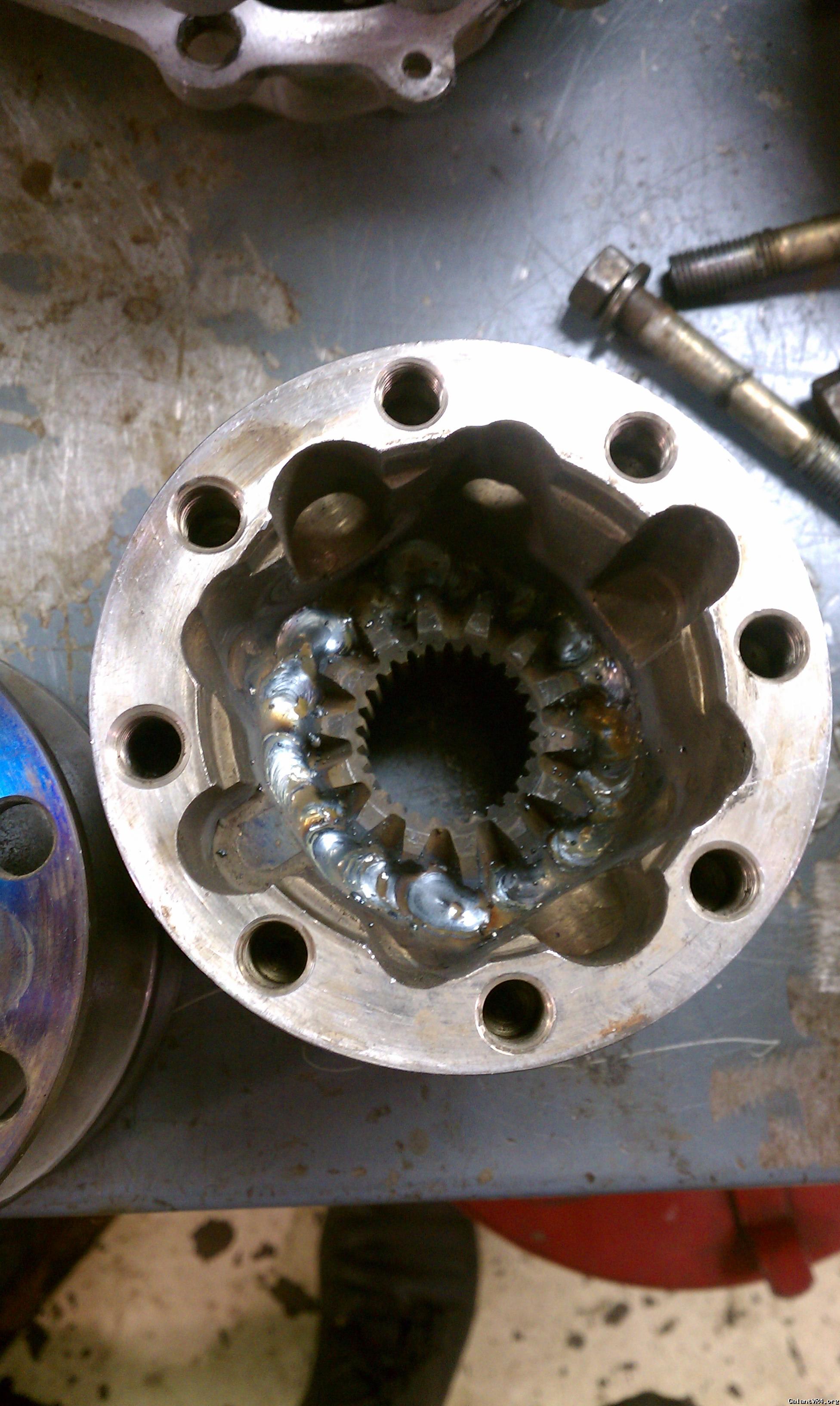

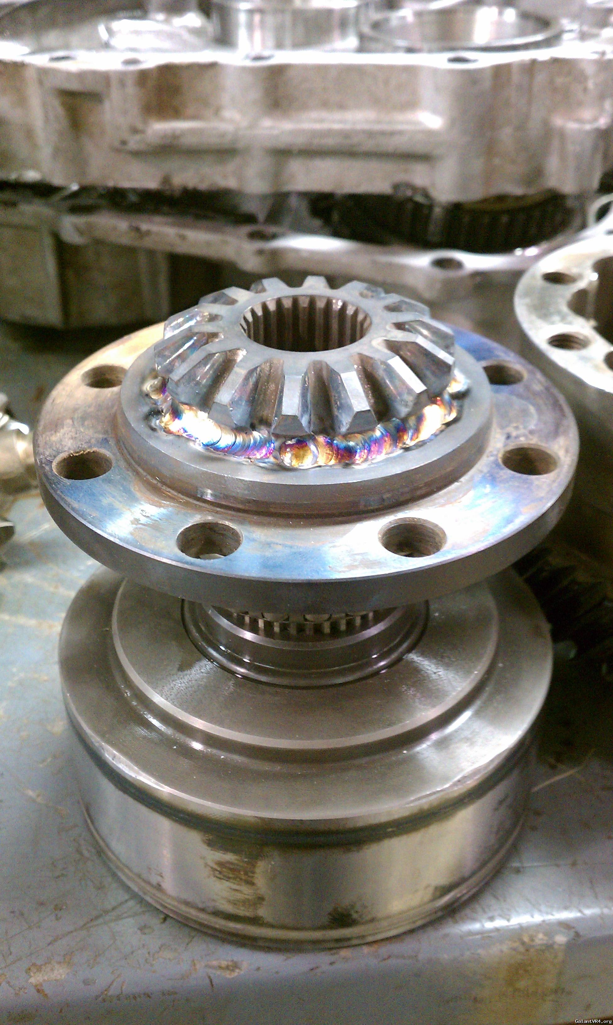

Got most of my gaskets and fluids in this week. I plan to have the bottom end on the engine stand tonight and maybe a completed long block tomorrow night. I had my ccenter diff welded today and ordered a VCE from shep.

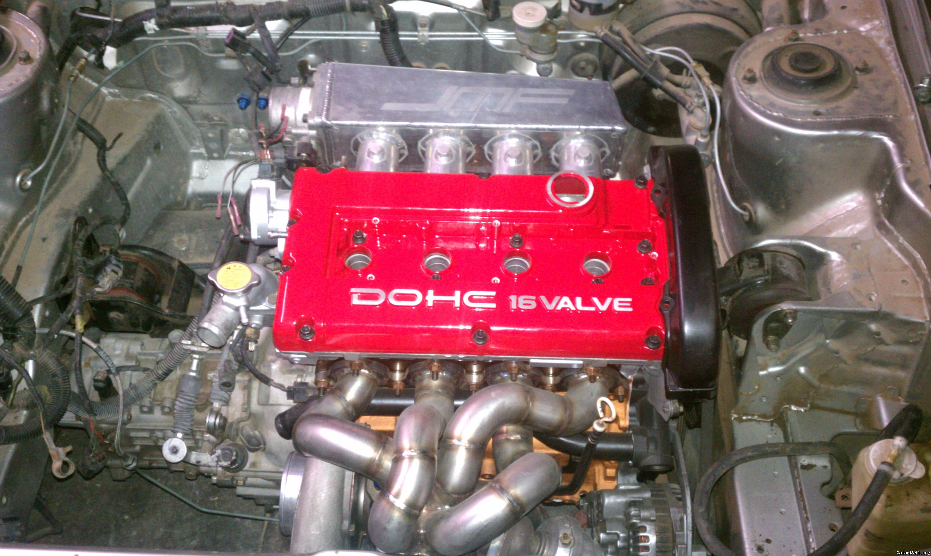

Quoting Ben:

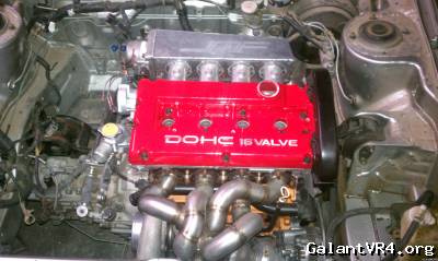

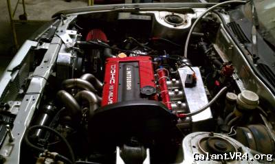

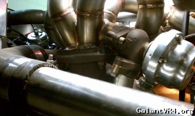

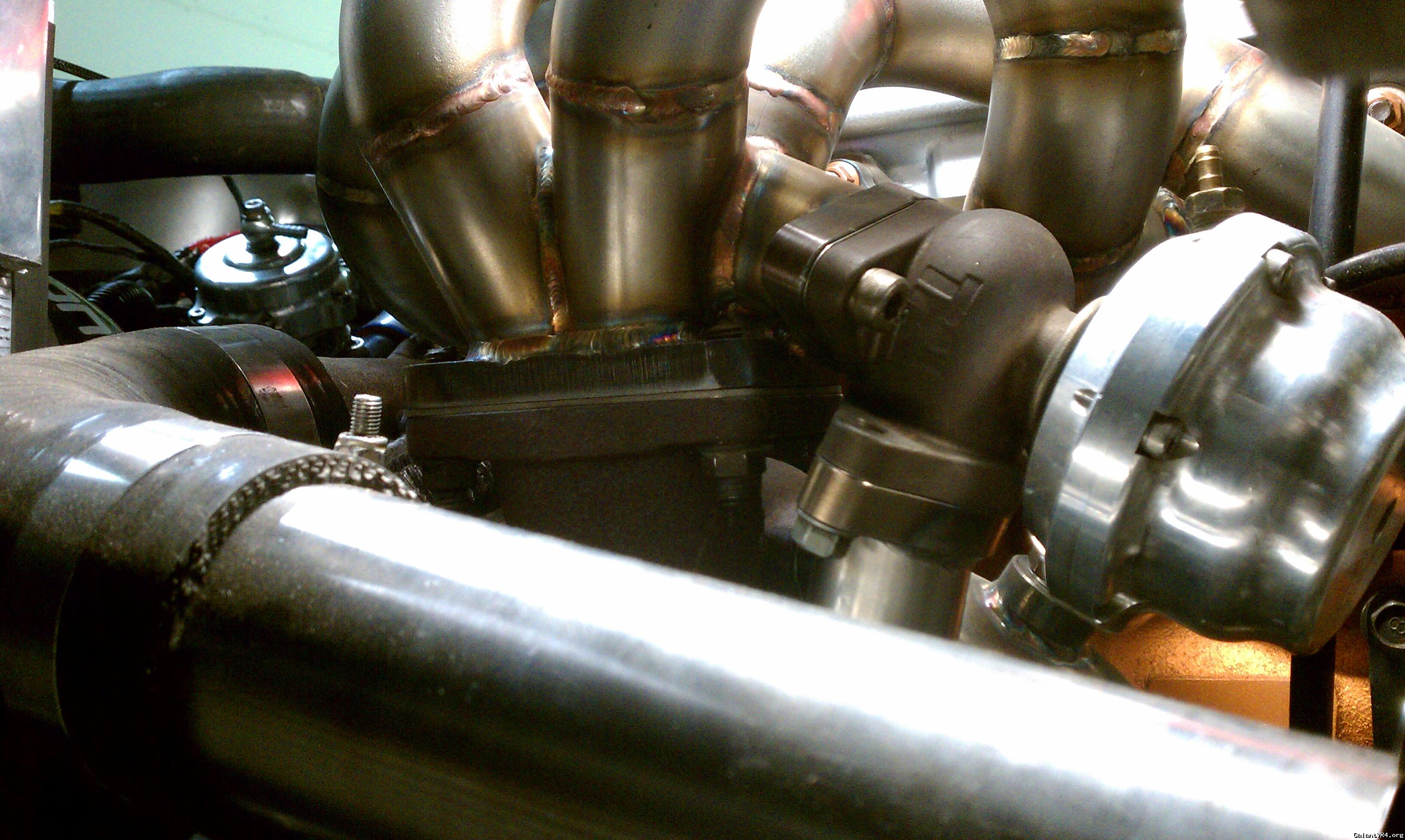

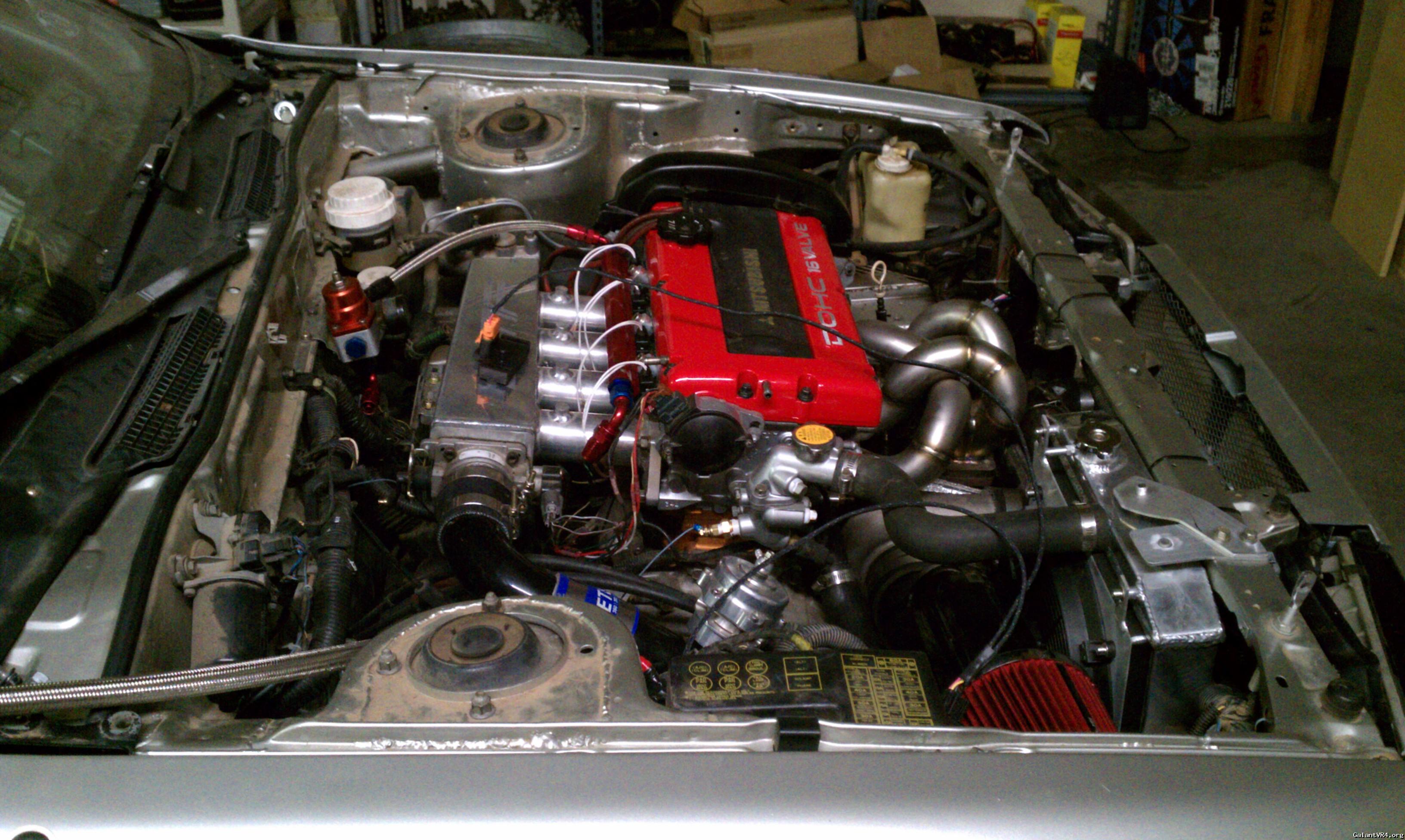

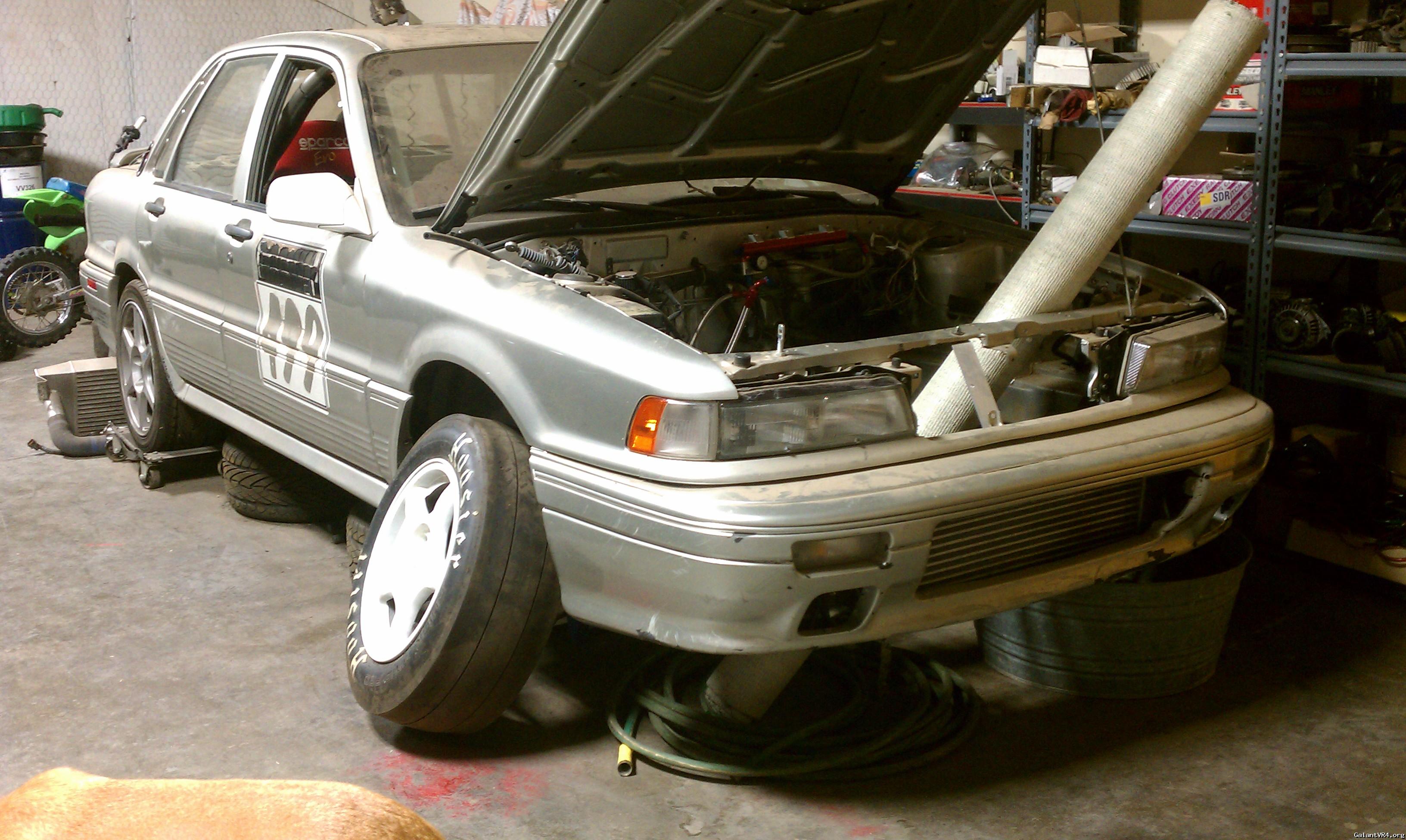

I put the manifold and turbo on. And found out why people clock the compressor housing in a different direction. haha.

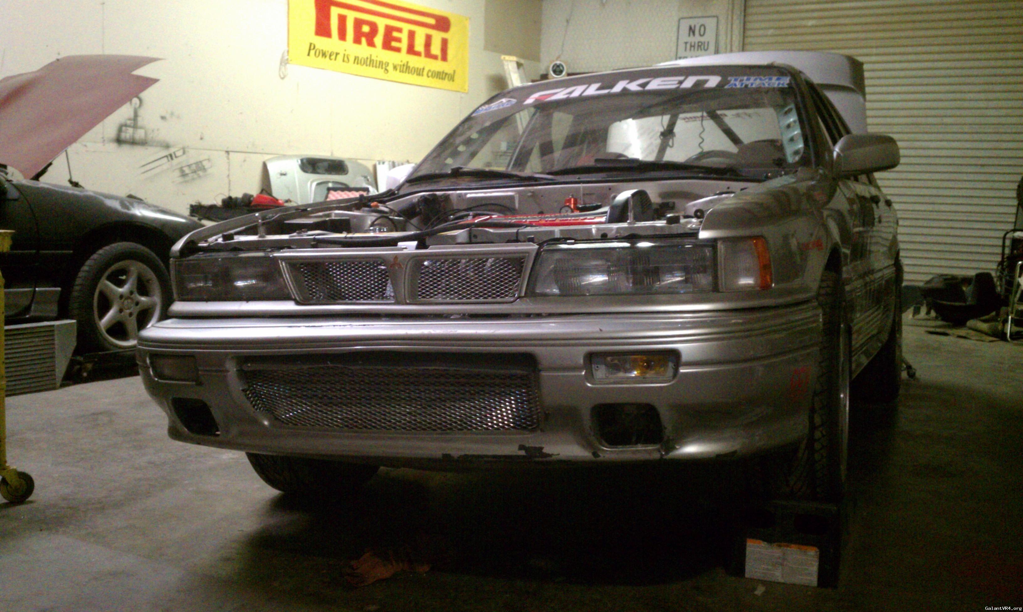

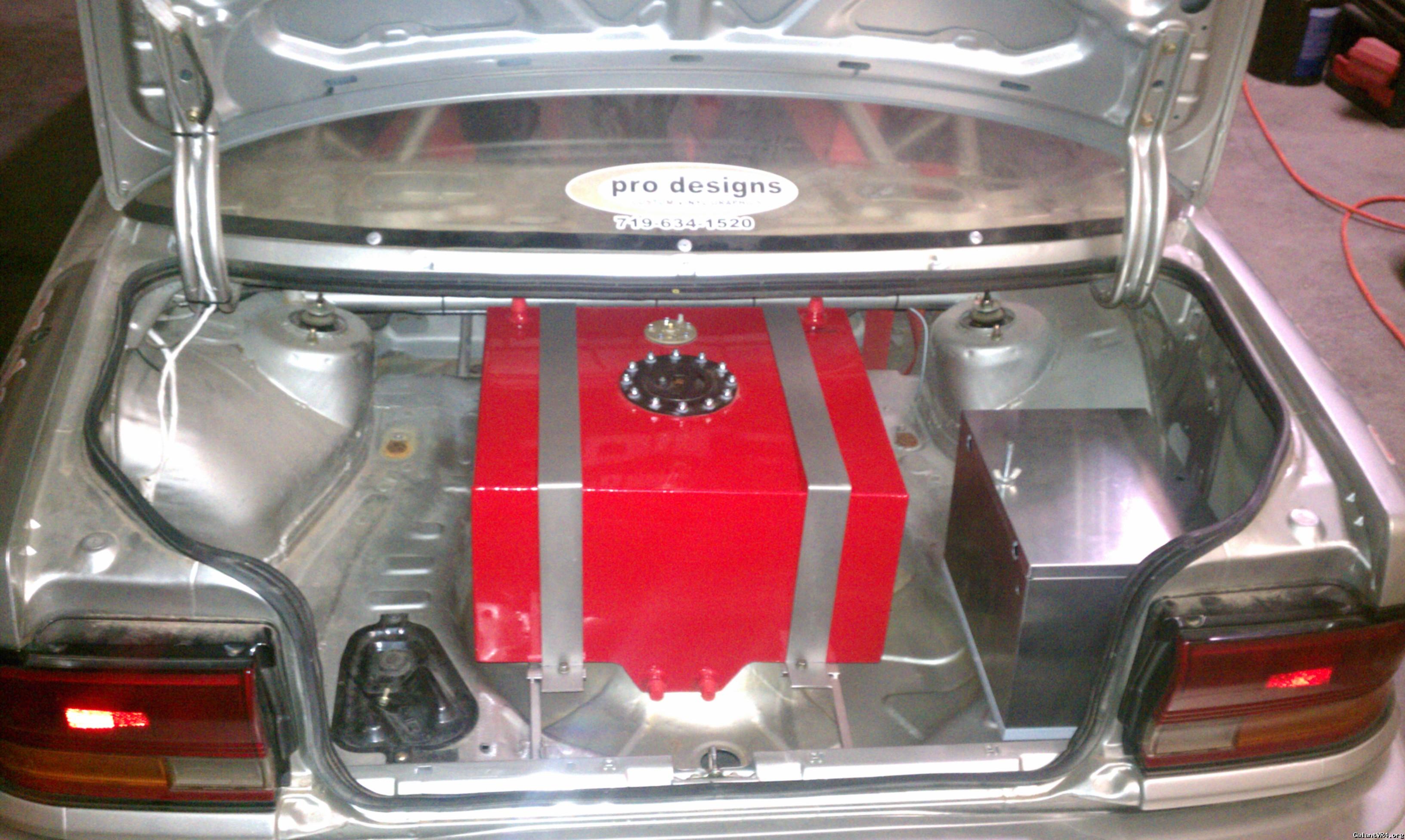

I'm thinking about builing a tubular front end. Get rid of the lower core supper and front cross member and fab something to go in it's place to mount the IC, radiator, front motor mount and front bumper.

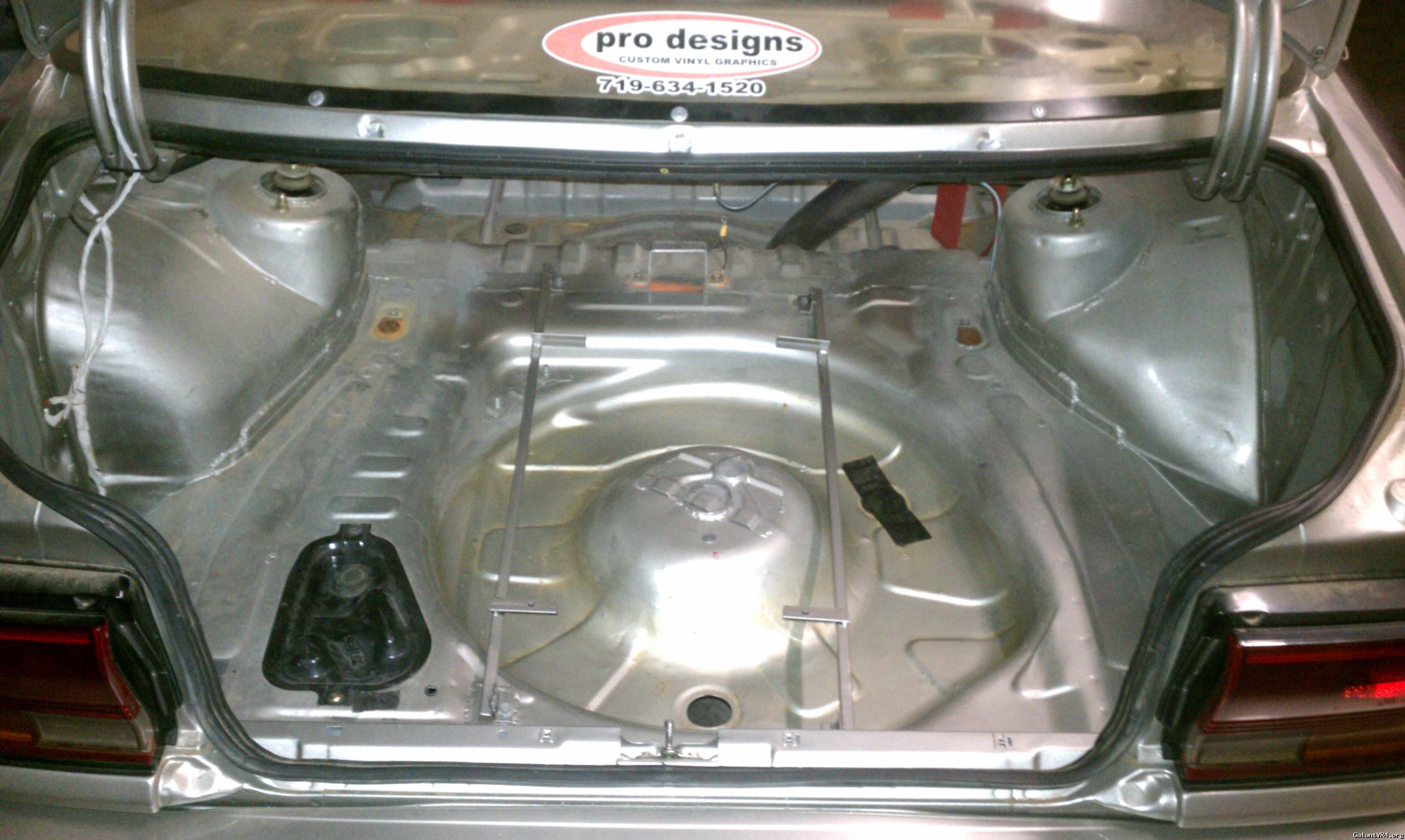

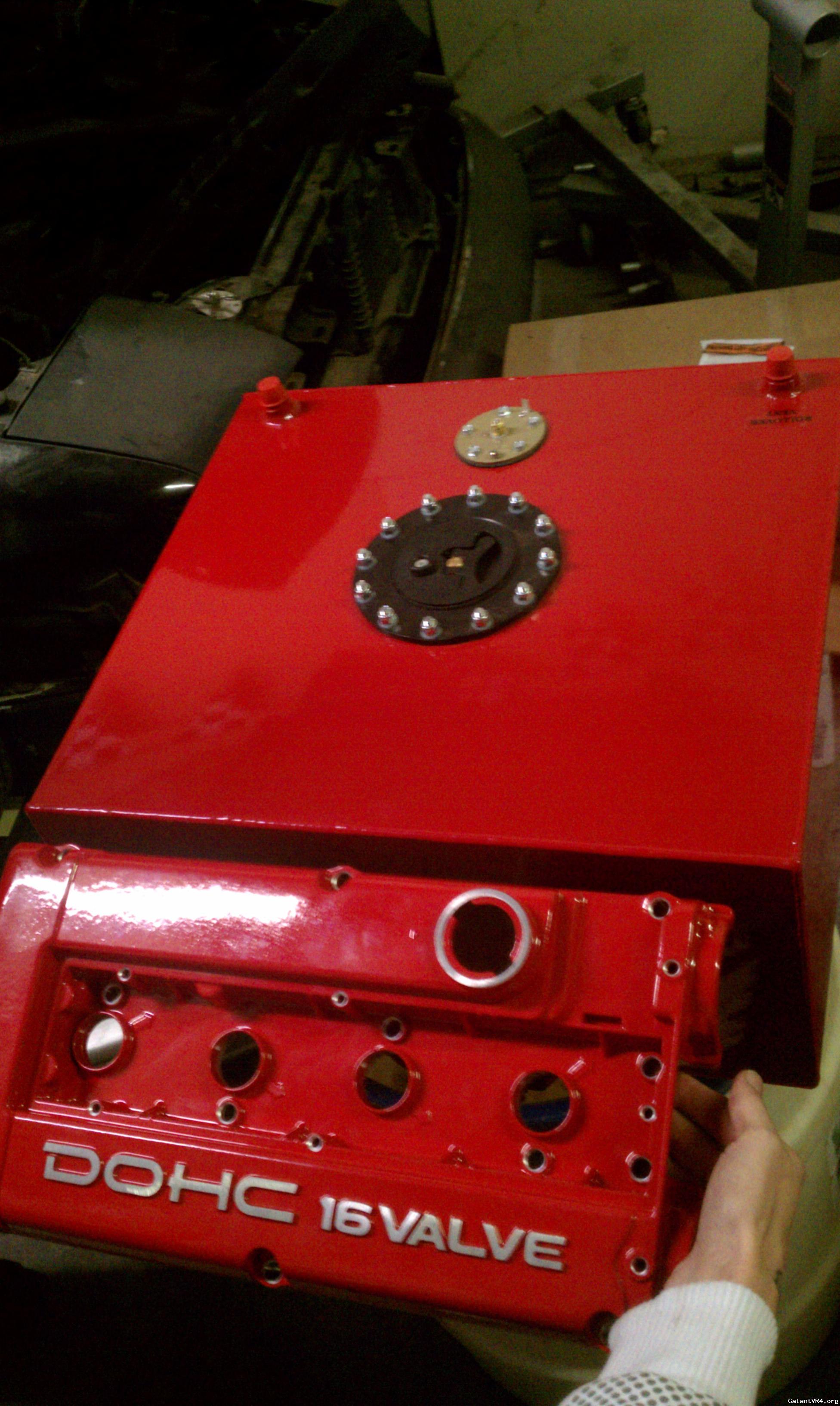

We'll see. In the mean time, I need to build my fuel cell mounts.
I wish I could find some pics of Wes Hess's red race car. I didn't think of taking pics of his tubular nose when my buddy had that car. /ubbthreads/images/graemlins/frown.gif I never thought I'd need to build something like that.

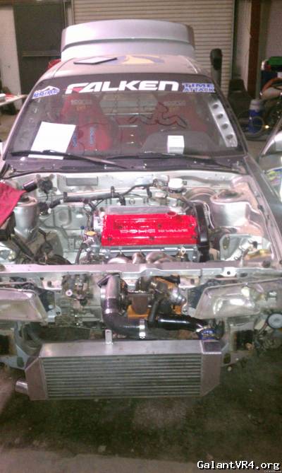

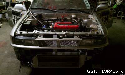

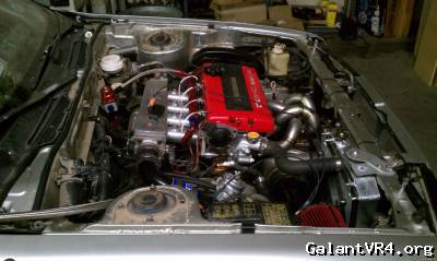

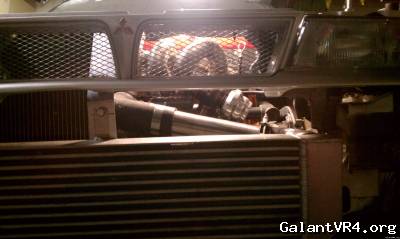

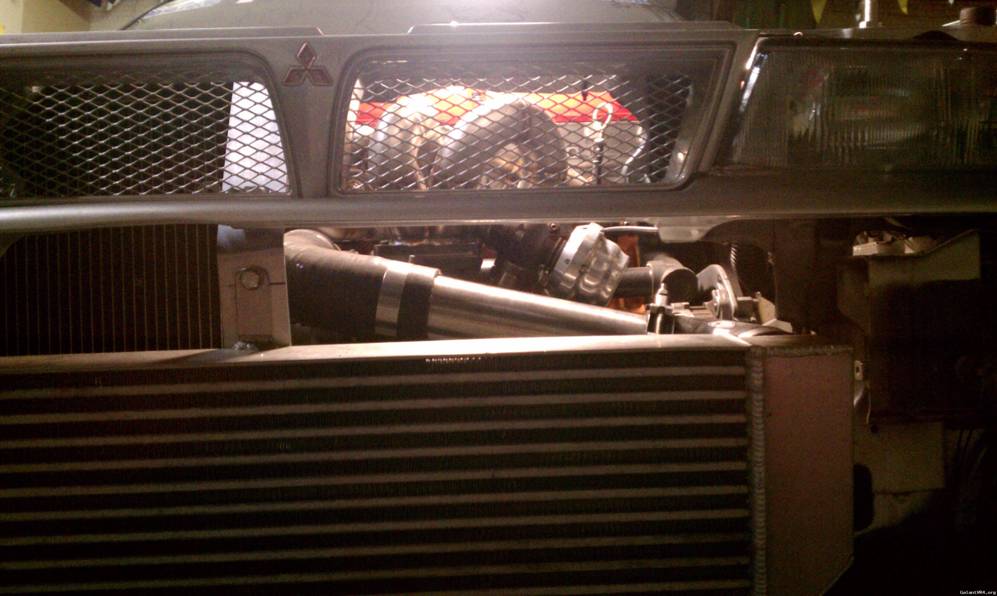

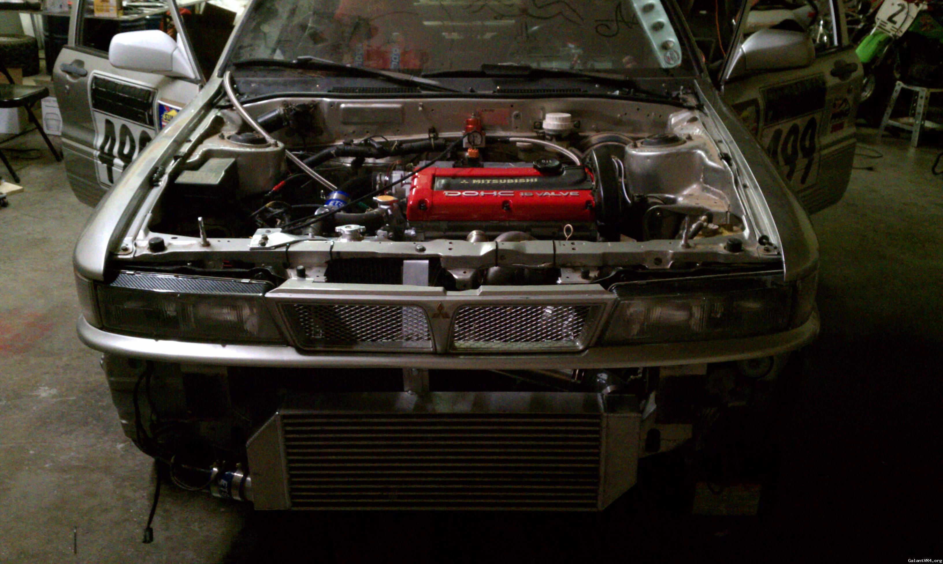

I was able to fit everything in the nose wihtout having to do any major modifications. I have a new radiator though that I can't wait to get it mounted with some pics!!

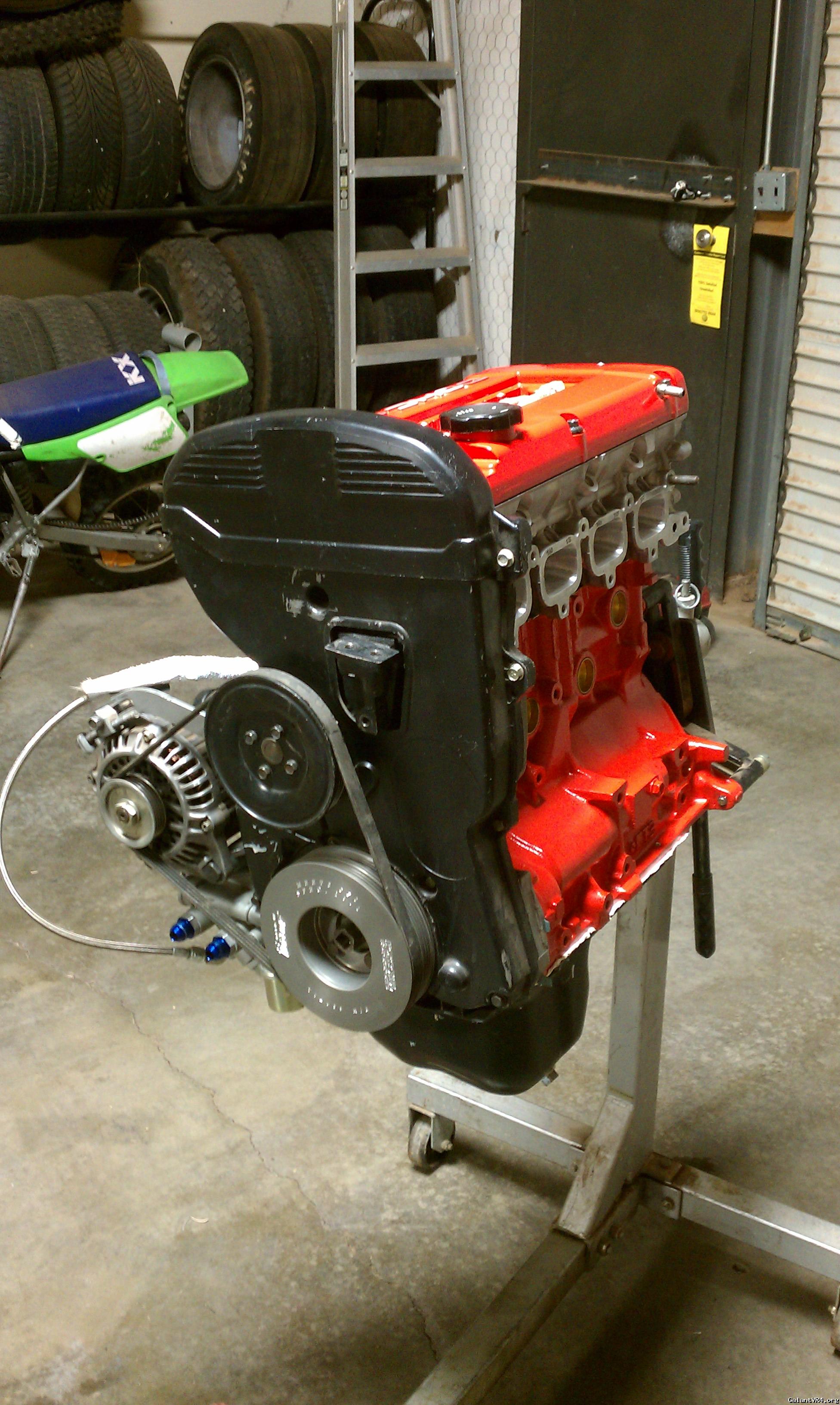

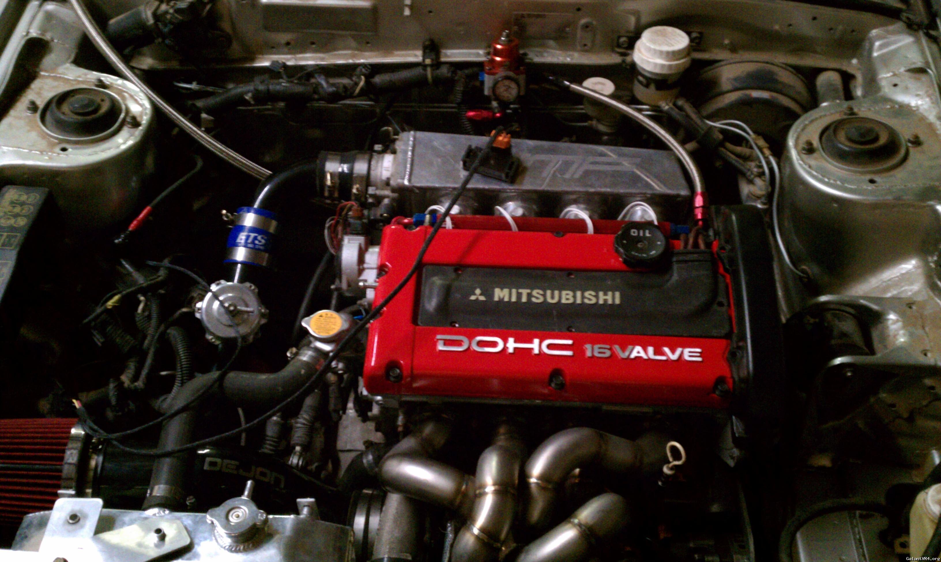

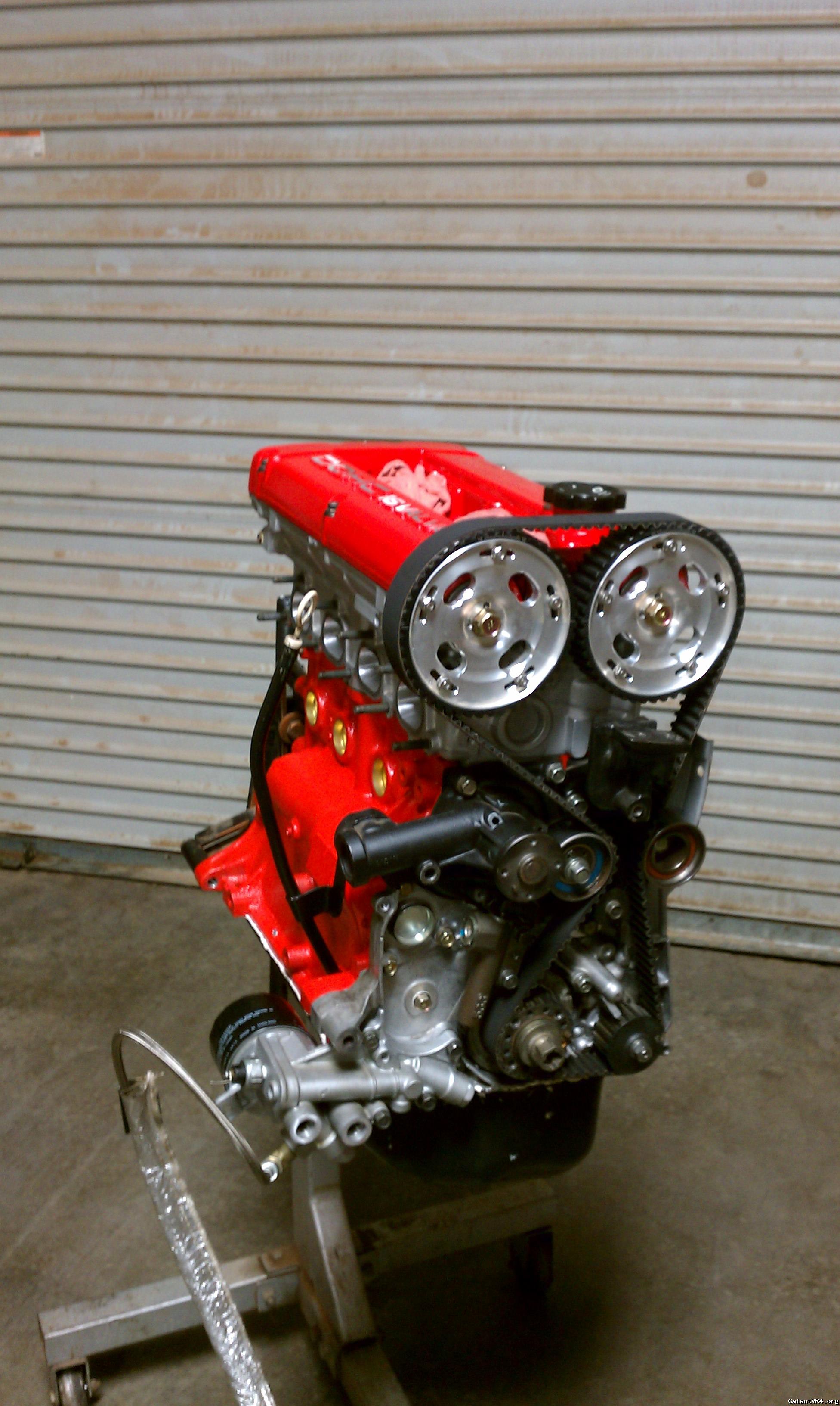

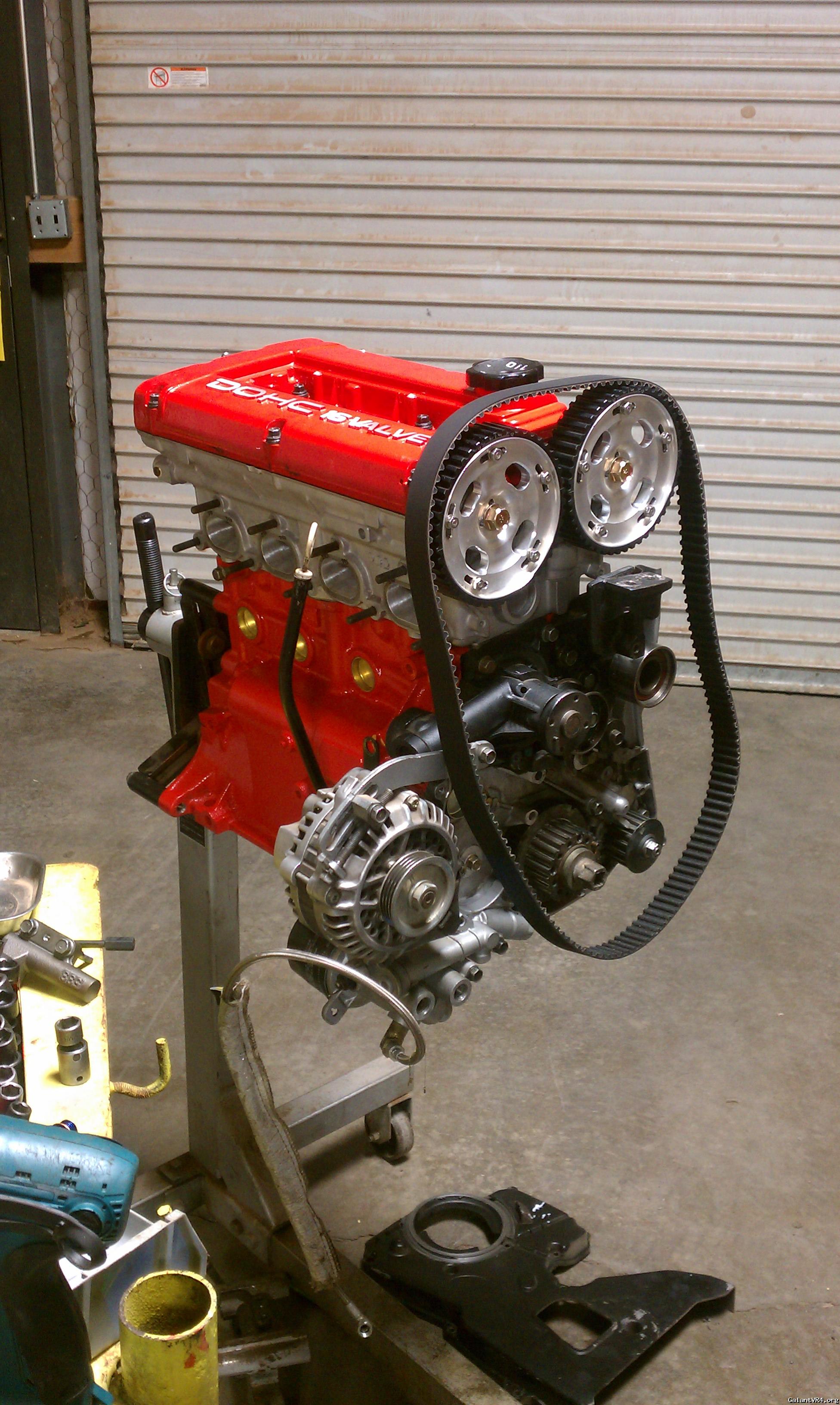

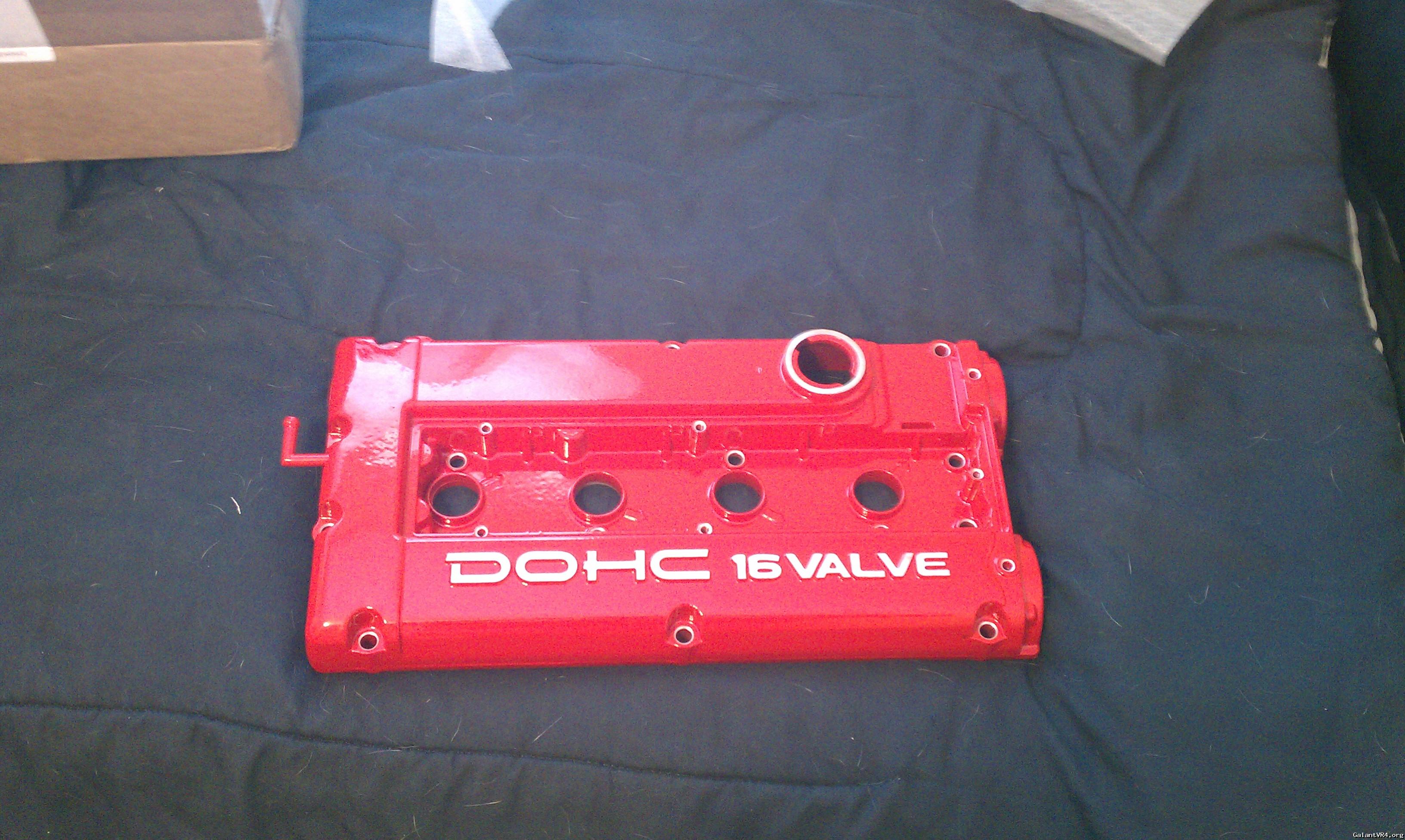

Looking good, Ben. Love the color scheme for the new engine.
Make sure to let us know what you think about the welded diff. It's never far from my mind...
Ben
Jan 14, 2009
199
Lubbock, Tx

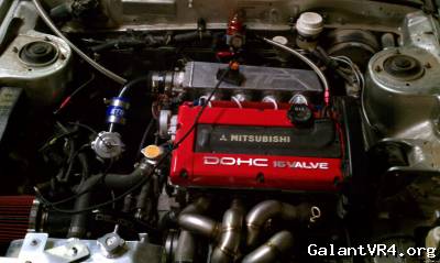

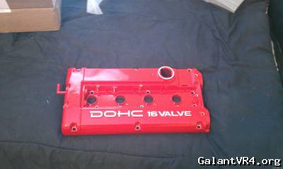

I actually planned none of that. I had the red valve cover from the last engine and I just painted a few things on the front of the engine black when I put it together the first time. I had no idea what color the block was going to be and it just happen to be pretty close.
I can't wait to launch this thing with the welded diff, but I have nothing to compare to. The last engine only let me have 300 miles of fun and I never launched it. Also I dont think I'll be putting e85 in it for a while.

I now have a welded center diff and waiting on my VCE from shep. Will be here Tuesday.

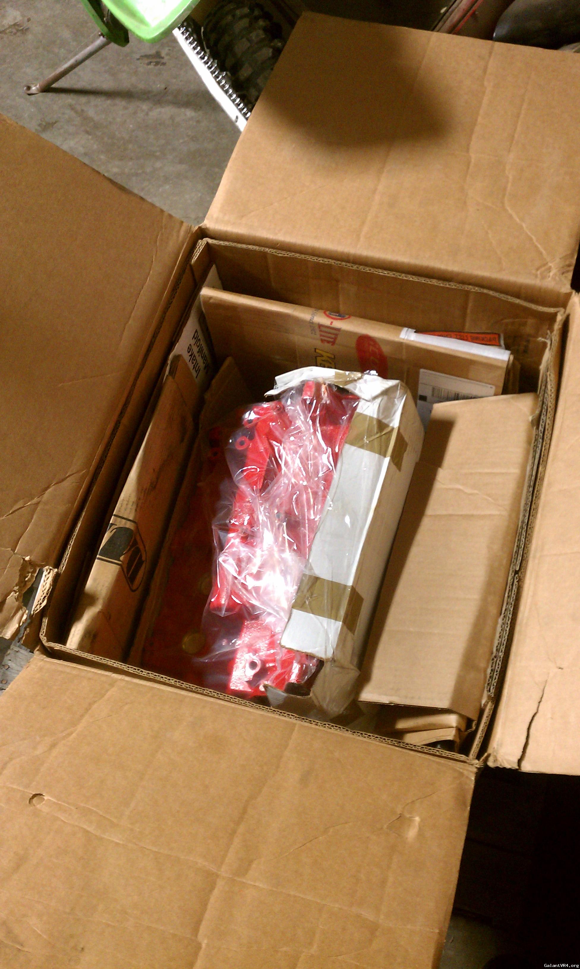

I have a new bottom end and an assembled head from Class One. I talked to Terry at Class One and told him my goals and what I'm going to do with the car. He worked his magic, sent me a bill and here it is. He said this setup should will work for me unless I decide I'm going to shoot for 1000-1100 HP and I'm far from it.

I have to mount my new radiator and get a SPAL pusher mounted and wired in.
