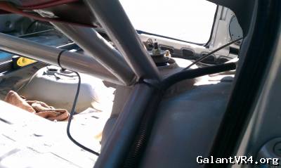

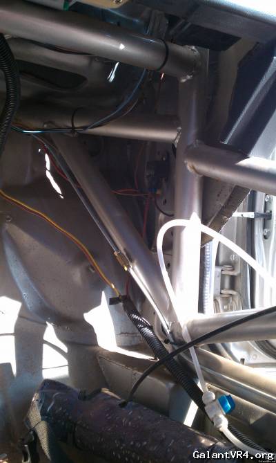

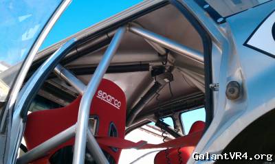

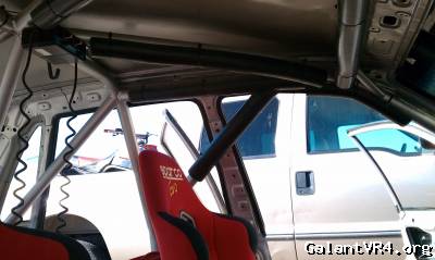

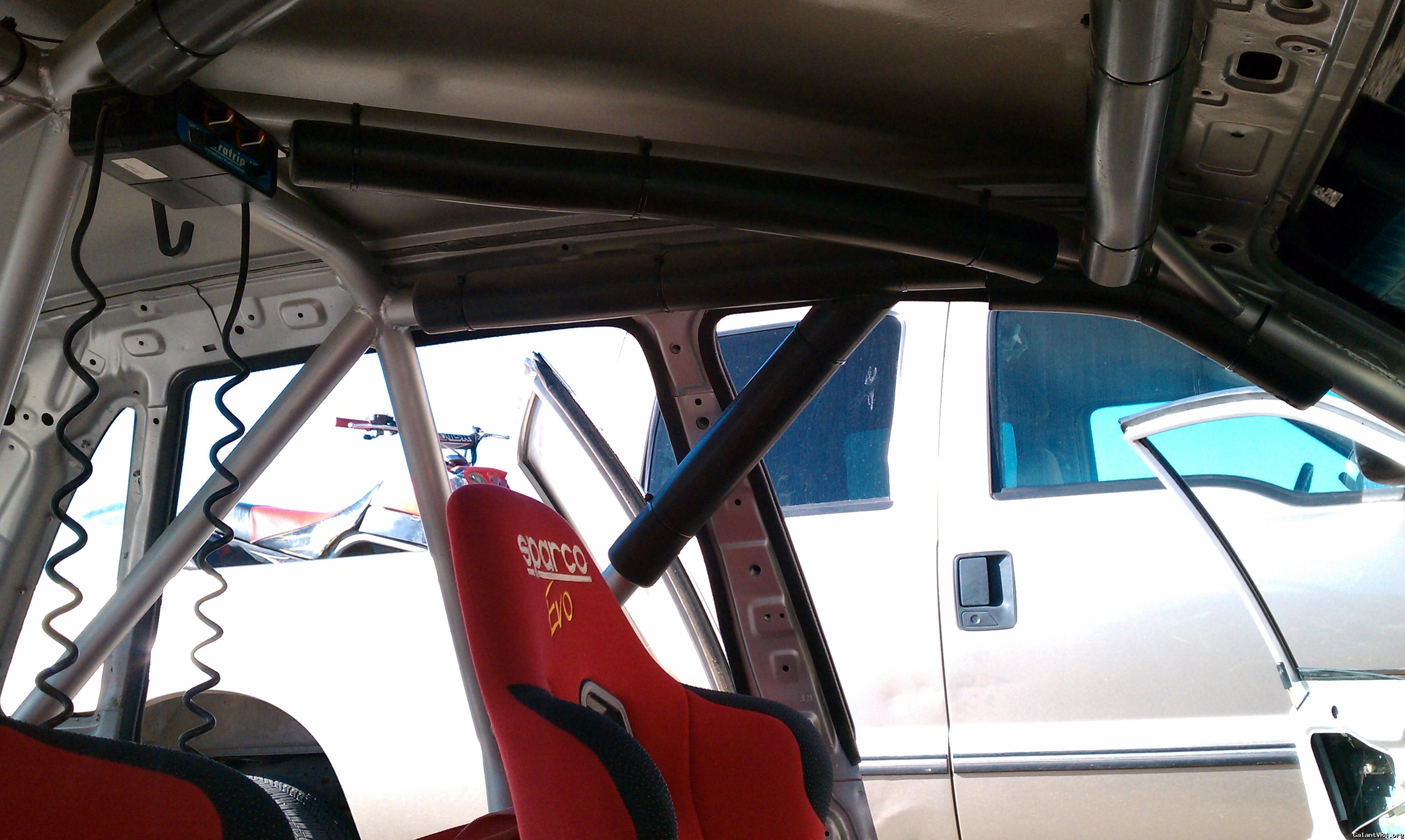

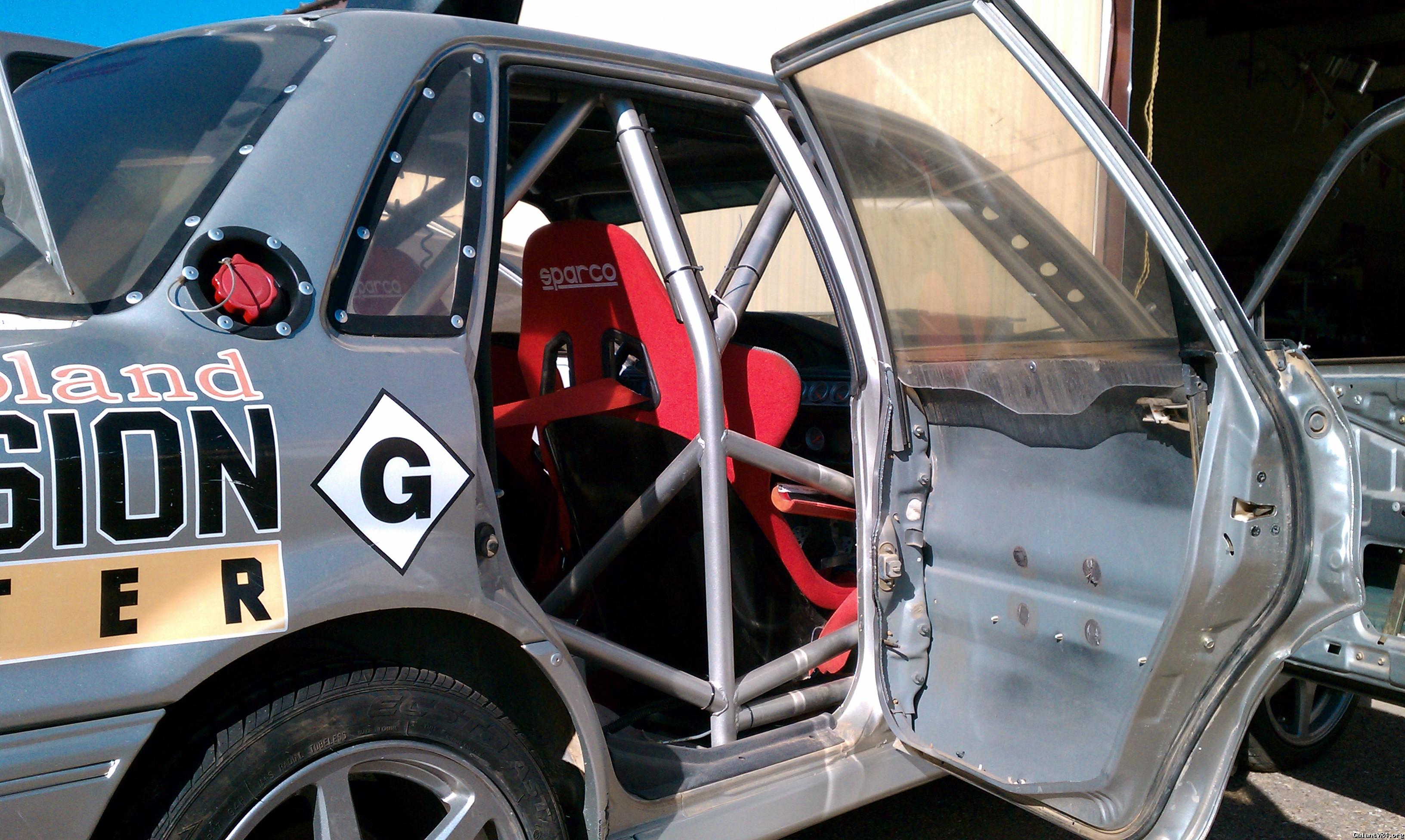

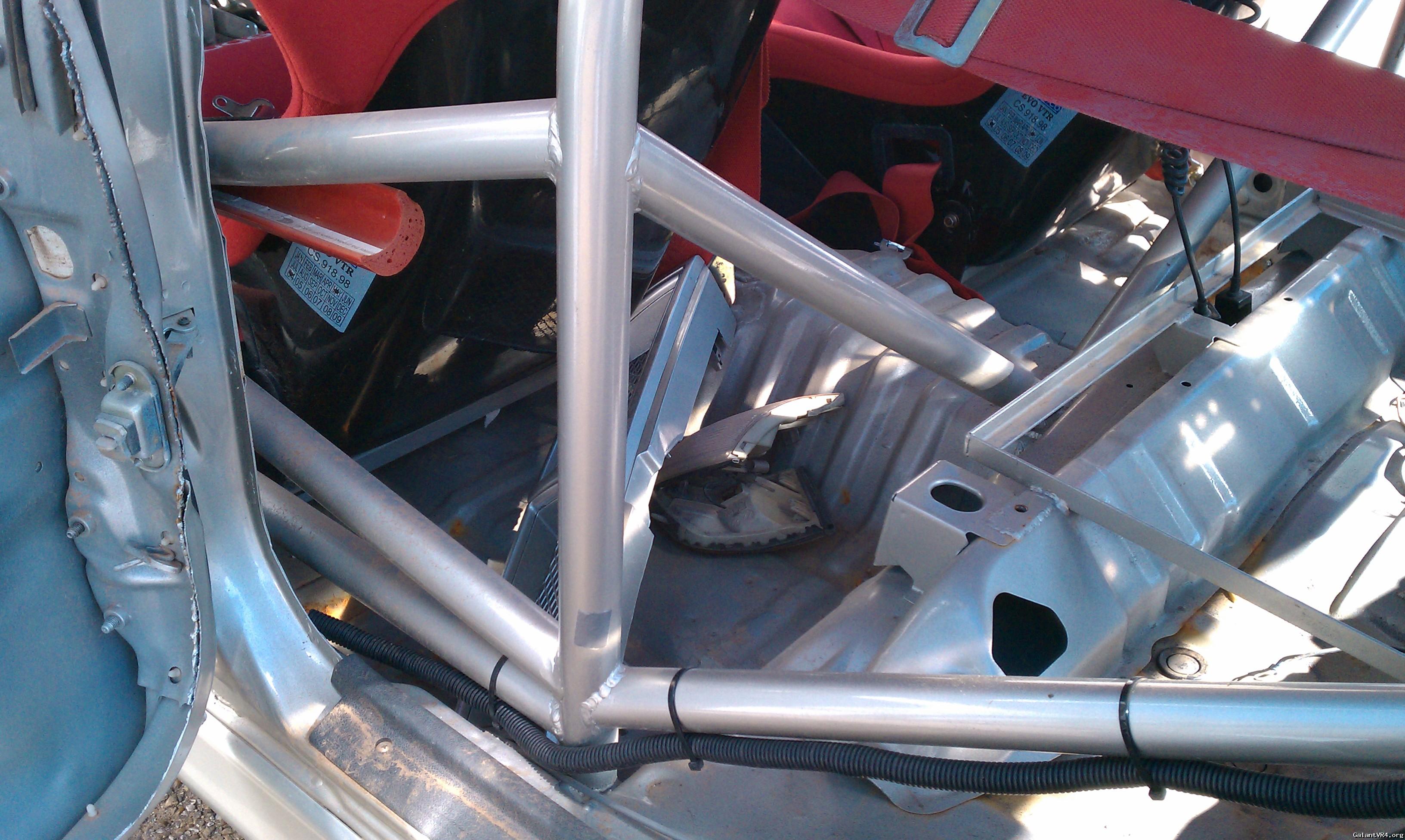

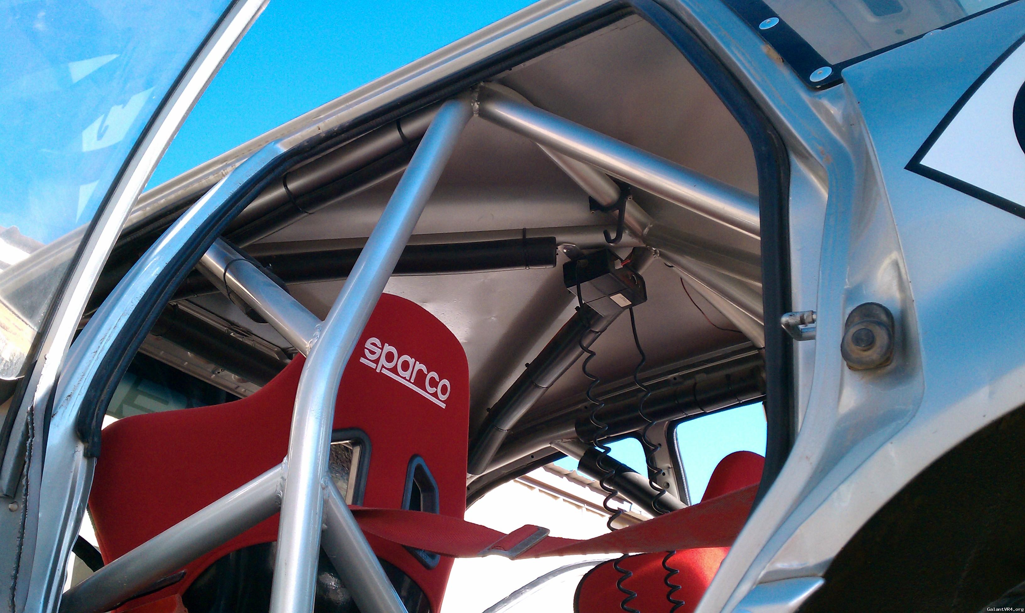

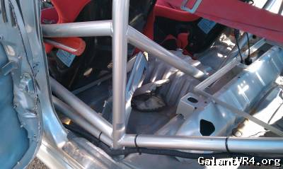

Hey get about a million shots of the cage, the cage in that car I heard is so badass. and distance shots ain't working.

Will do. It will be dark by the time I get off work tonight. I'll do it tomorrow.

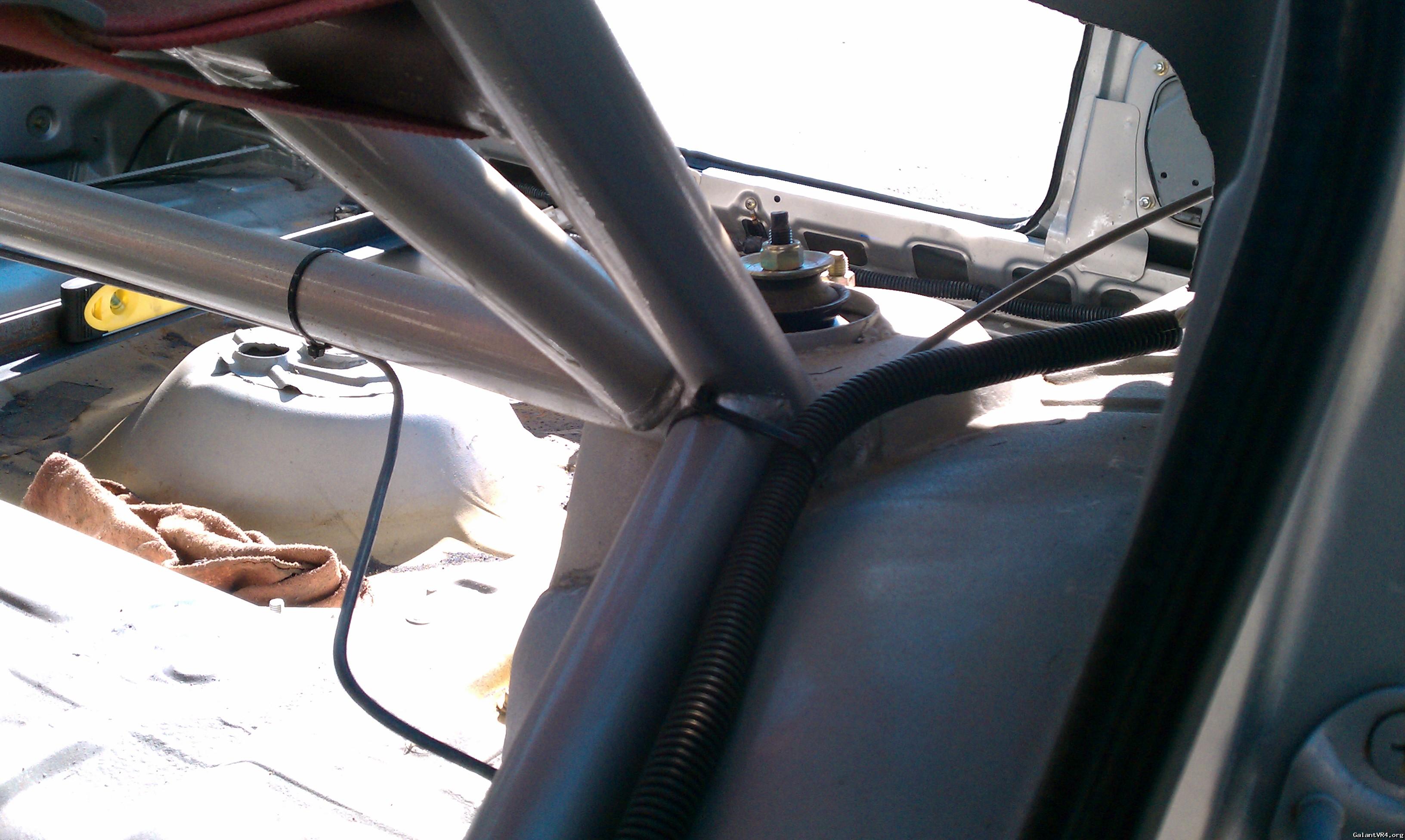

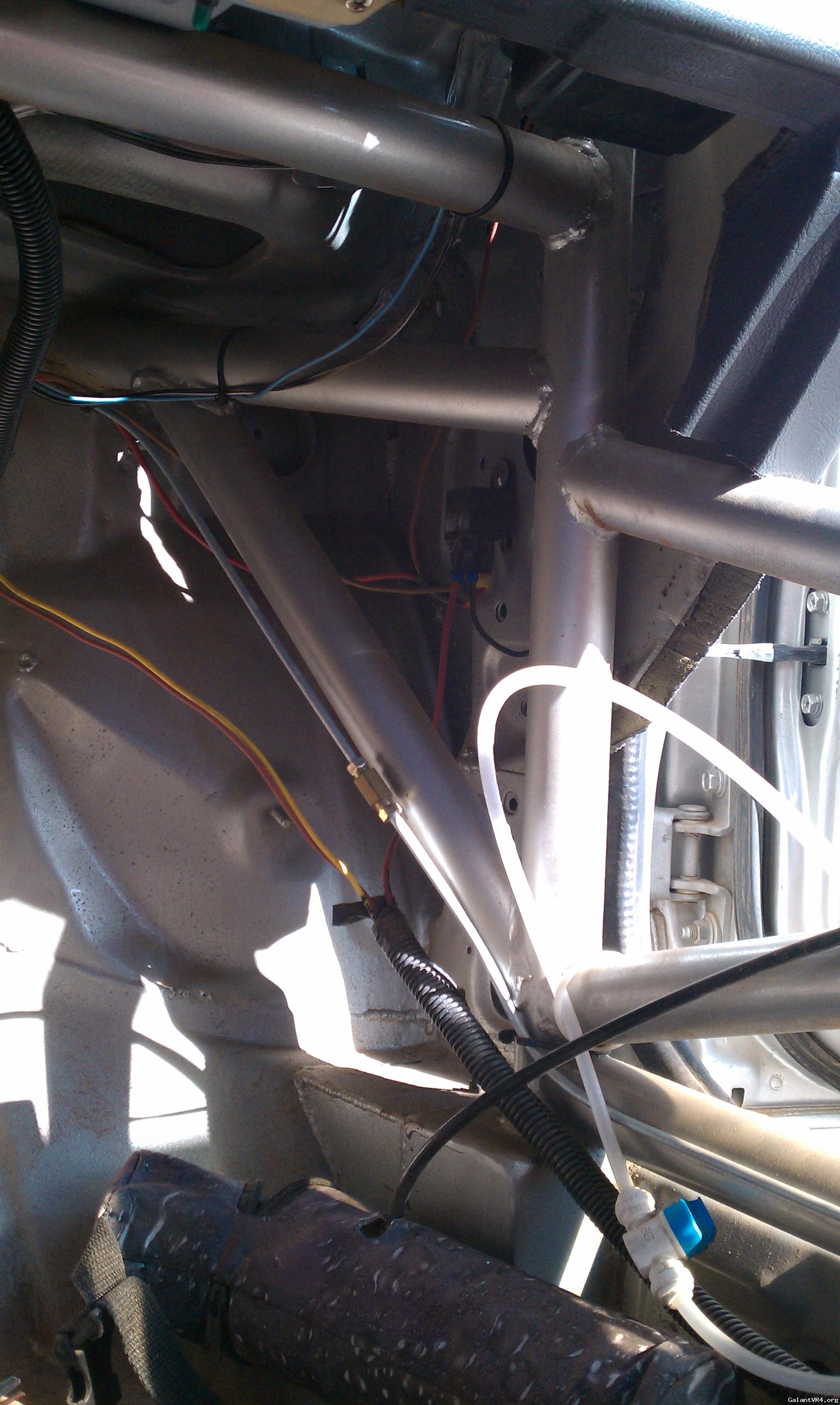

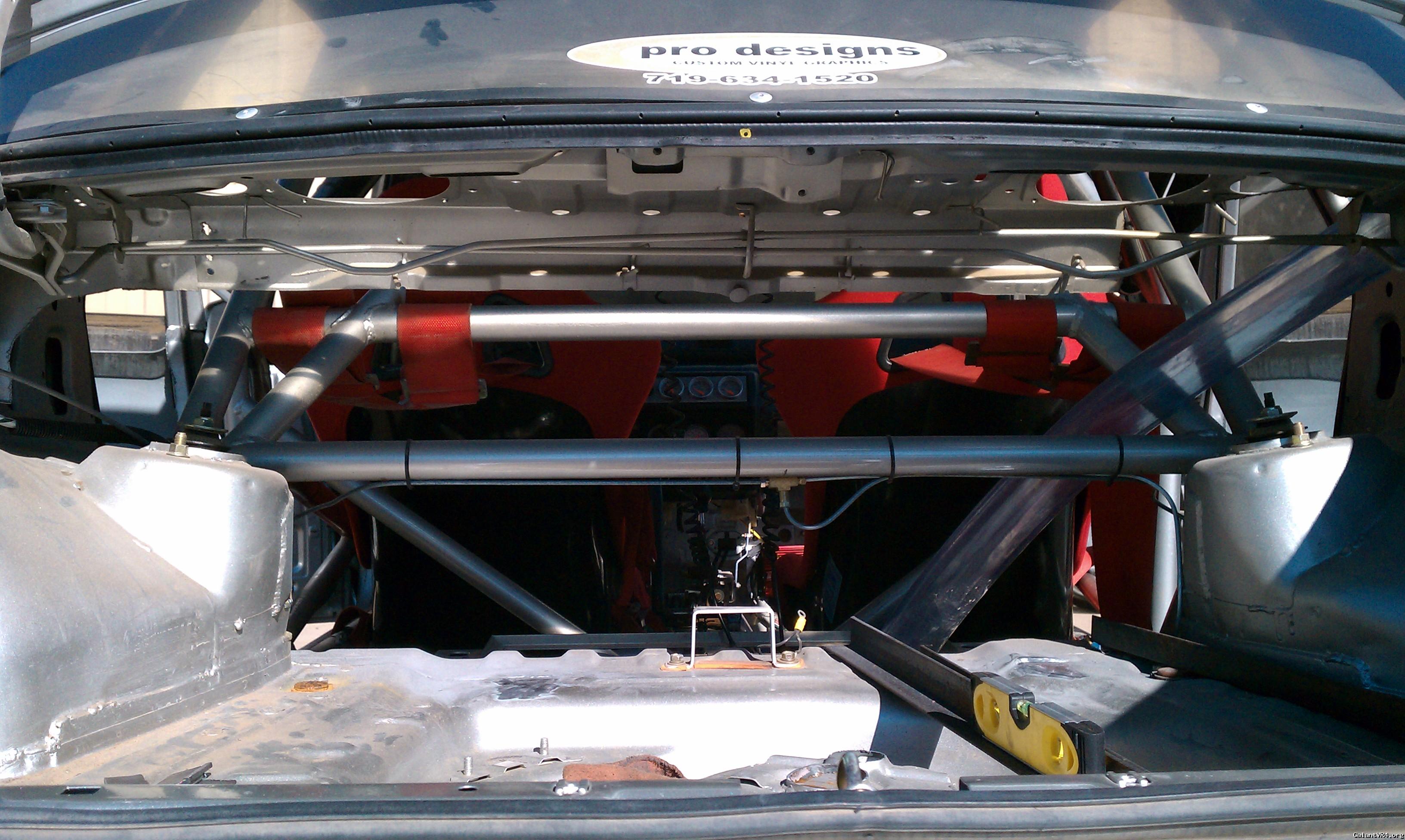

DR1665
Oct 19, 2005
4,644
Iowa City, IA

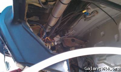

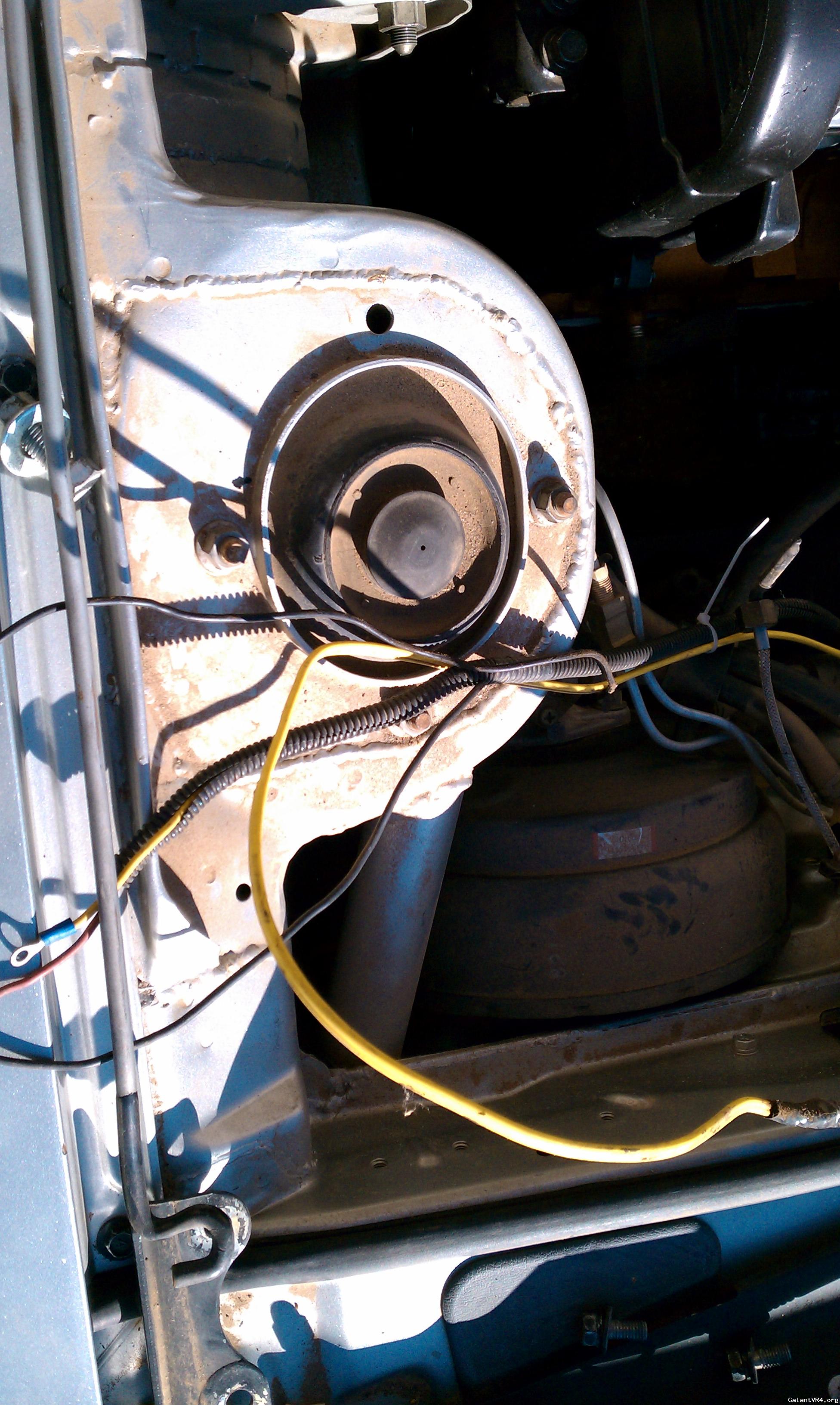

Wow. Through the firewall to the turret without losing the brake booster. Nice!
I also like the way the rear turrets are tied into the main hoop/harness bar by way of that box section.
Gonna be nice to finally have a cage in mine.
