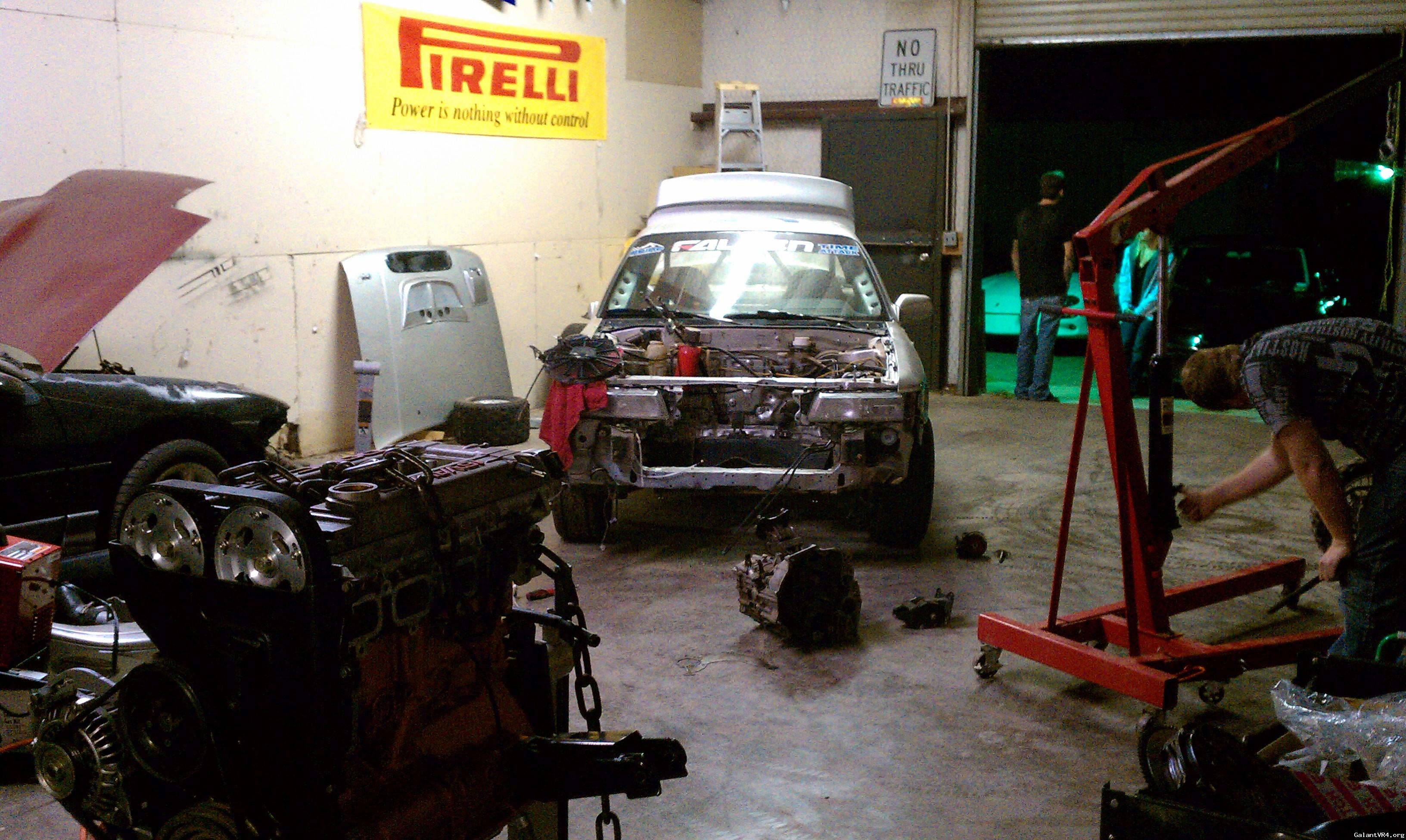

I have had this rolling chassis for a year or 2 now, and I'm finally putting it together. I'v been out of the dsm world for a few years now, ever since I spun a rod bearing in my gsx. I bought other toys through the years because I was overwhelmed of the cost and work of building this car. Well, I finally decided to go through with it, and now I'm a month or so away from it running. yaaayyy.
Here's the car: click
People will get mad because I'm not going to take this car off road again. I can't. I don't have the time or money to do so. There is also nothing close enough to make it worth while for me. I'm not saying I won't do it in the future. I just love these cars, and I like to go fast. Unfortunalty, all we have here is a striaght line. Again, in the furture I very well may decide to get a smaller turbo and go around some curves. That would be fun.

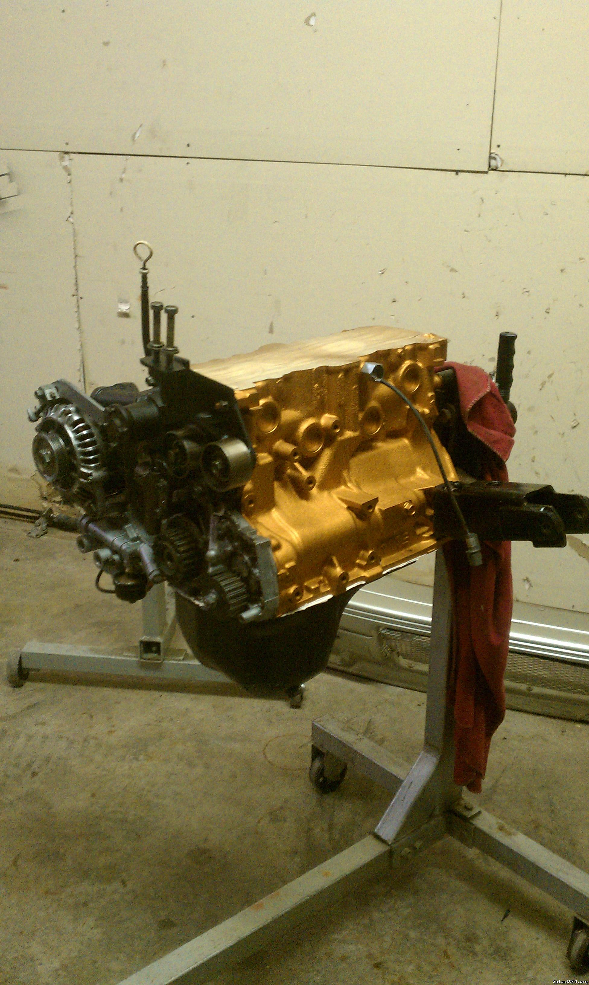

engine:
manley turbo tuff rods
ross 8:5 pistons
stock crank
FP 4R cams
fidanza adjustable cam gears(I had to degree my cams in, due to the head and block both being resurfaced)
ported head, but nothing major
supertech duals

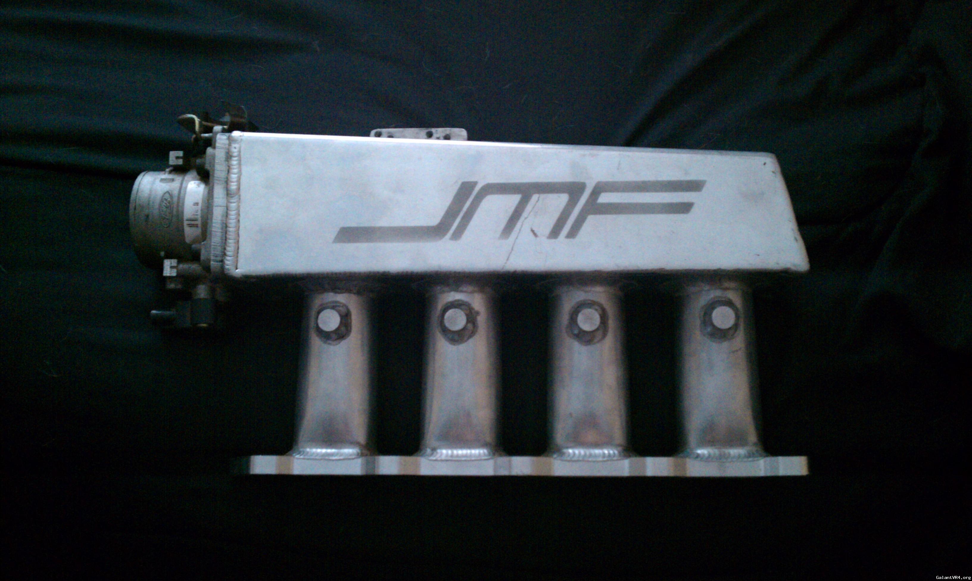

JM fab race SMIM with ford 70mm TB

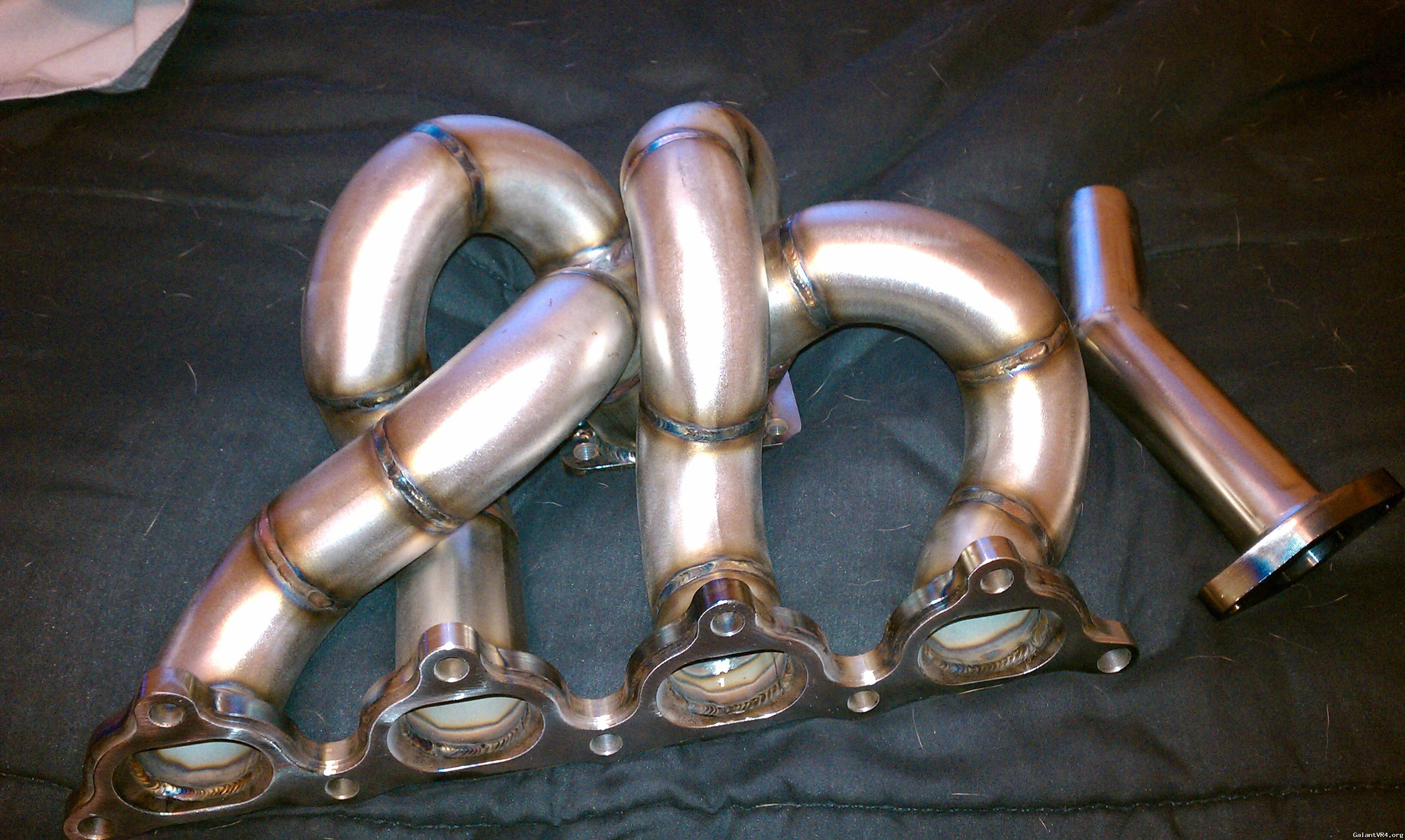

Punishment racing hand built t3 manifold/o2 housing and DP

Right now the engine/trans/tcase is bolted in the car. No manifolds on yet. I had to send the exhaust manifold back to punishment so he could ensure which one it is so the o2 housing will fit perfectly. When it comes back, it will have the o2 housing, downpipe, ngk wideband, my second wablro 255 and turbo install parts.

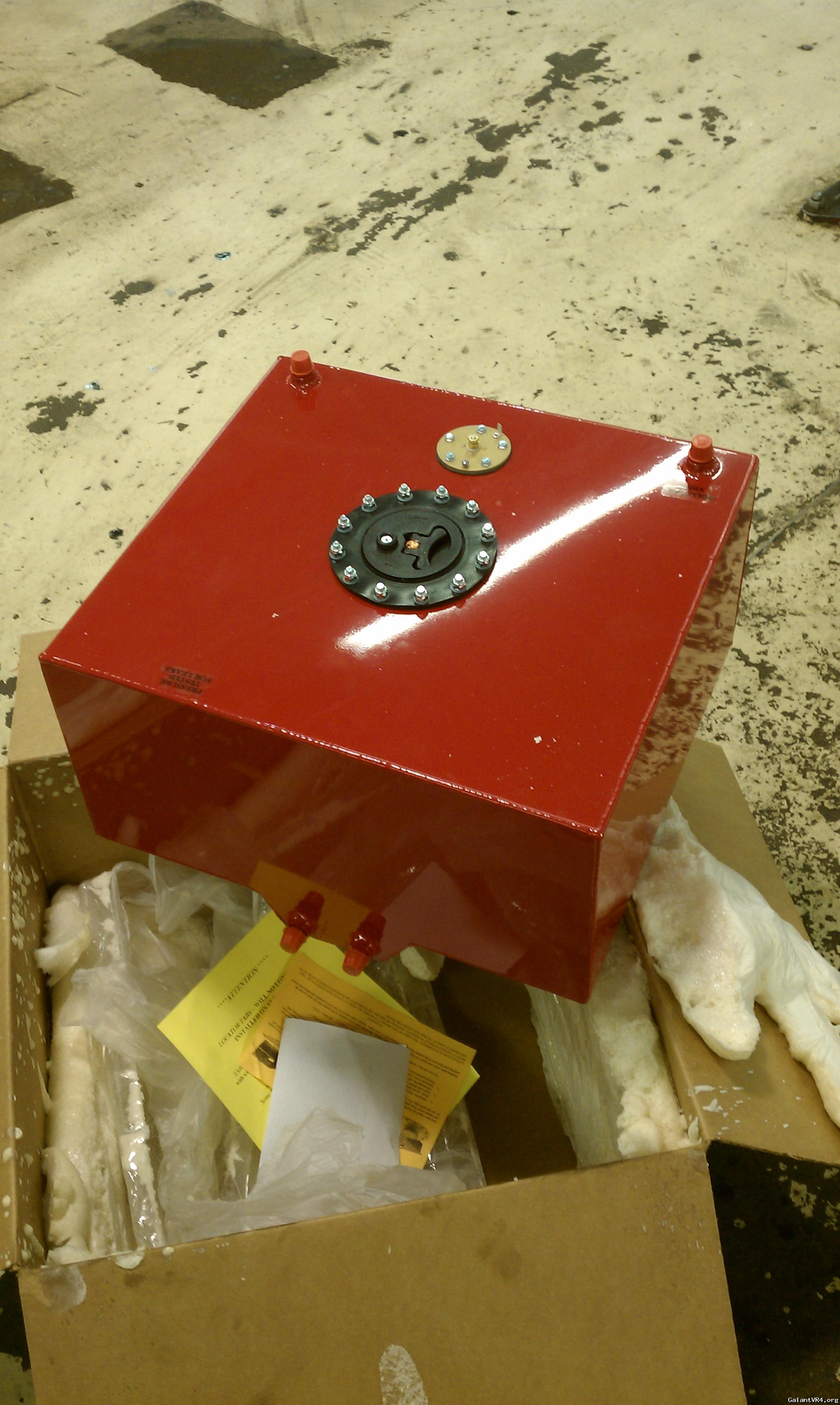

I ended up getting a 15 gal RCI fuel cell with a sump. 2 -8 outlets in the sump are going to feed 2 walbro 255s that will run parallel then into a "Y" to go up to the aeromotive fuel rail. I also have an aeromotive afpr that will be in the mix. The fuel cell is powder coated red from rci. It is a 2150abs part number. I was planning on putting it in the trunk inside the car and run the vent outside.

RCI will finish and ship out my fuel cell tomorrow. I ordered my aeromotive fuel rail today along with the fittings needed to hook this oil cooler up to the factory 90 oil filter housing. When my cell comes in, I'll take a fuel pump up there and my pressure regulator and buy all the lines and fittings I need.

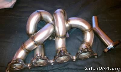

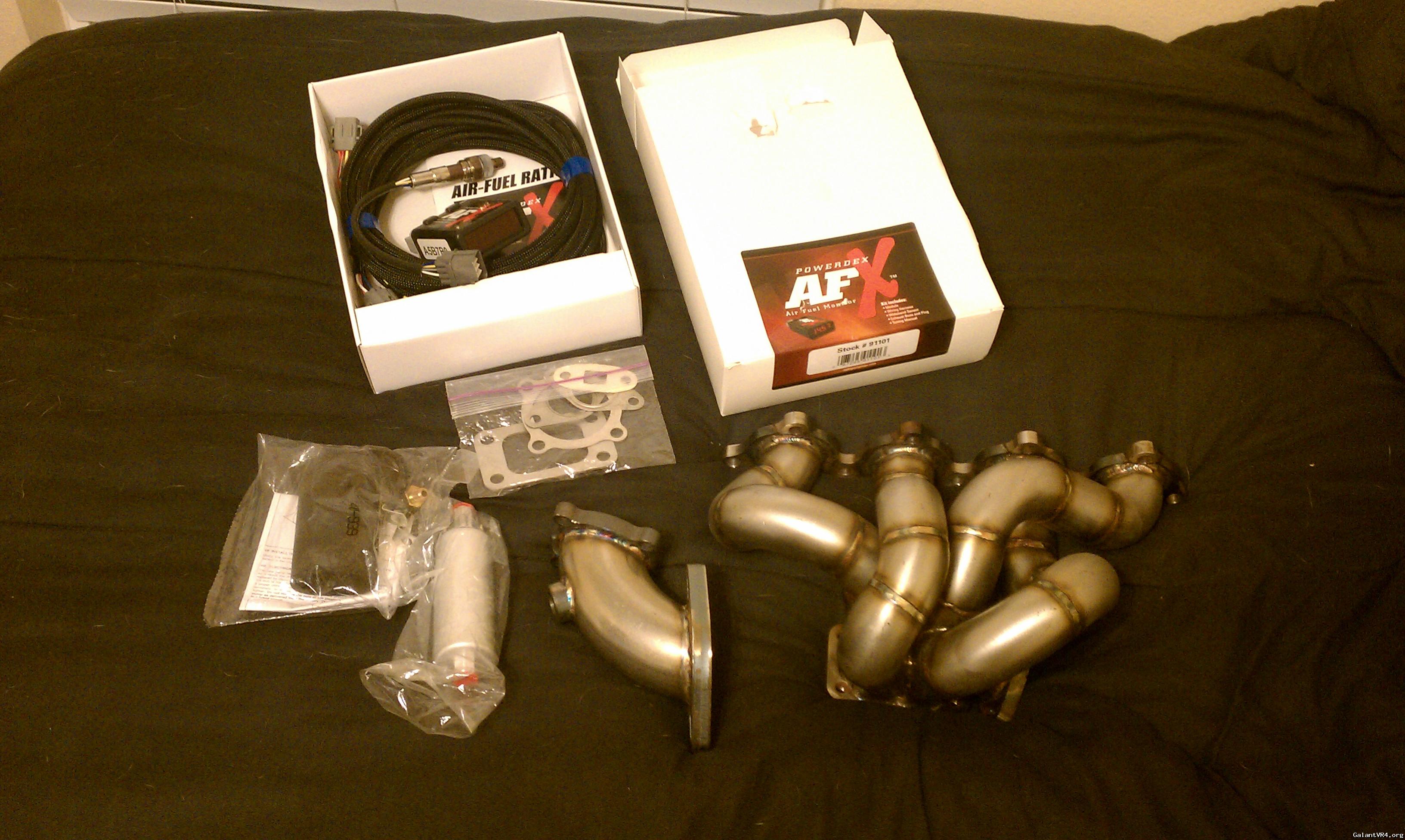

Got my exhaust manifold back from punishment racing today along with a new o2 housing, ngk afx, turbo gaskets and my second walbro 255.
off to my shop tonight to install the turbo. I'm still building the frame for my fuel cell. I have all the main components, I just need all the lines and fittings for the fuel system.
I really should figure out how to post pics.
Ben
Jan 14, 2009
199
Lubbock, Tx

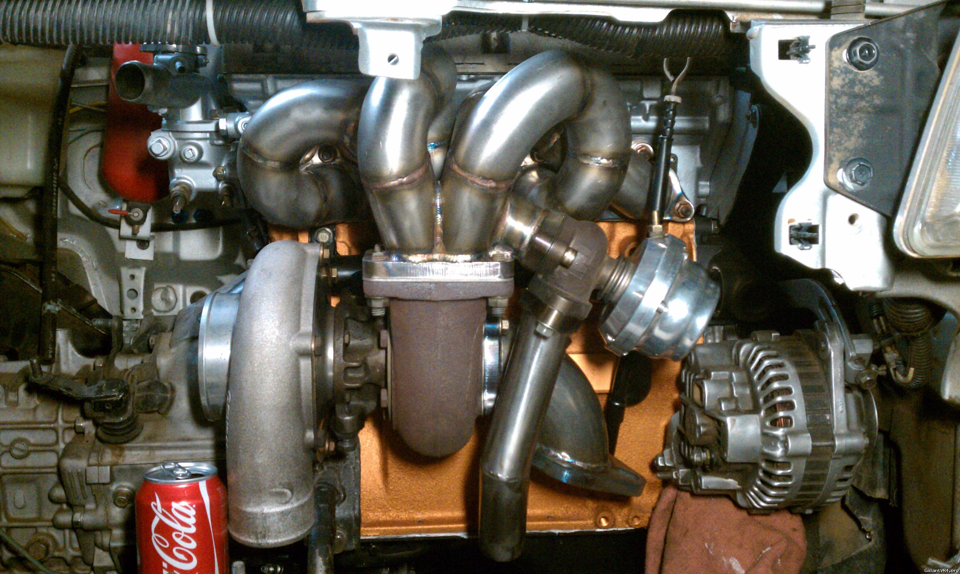

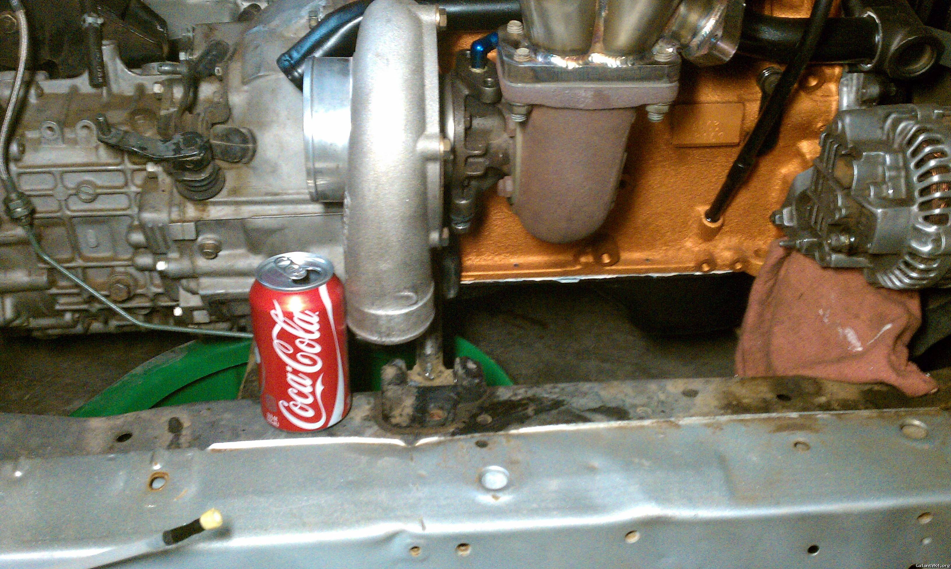

I put the manifold and turbo on. And found out why people clock the compressor housing in a different direction. haha.
I'm thinking about builing a tubular front end. Get rid of the lower core supper and front cross member and fab something to go in it's place to mount the IC, radiator, front motor mount and front bumper.
We'll see. In the mean time, I need to build my fuel cell mounts.
I wish I could find some pics of Wes Hess's red race car. I didn't think of taking pics of his tubular nose when my buddy had that car. /ubbthreads/images/graemlins/frown.gif I never thought I'd need to build something like that.

Well this SBR ig fmic is not going to work. I would have to postion to core really low. like 1/2 of it sticking out below the bumper cover. haha So I guess I'm going to email ETS and see what they have for me. I'm still going to have to do something with that lower front subframe. I don't see room to reclock this compressor housing, this Punishment manifold is pretty big.

Ben
Jan 14, 2009
199
Lubbock, Tx
Let me know if this works. This is my mobile uploads on facebook which has most of my galant pics.
a2vr4
Aug 13, 2005
1,551
Ann Arbor MI
This content is currently unavailable
either it isn't working or me not being your friend is causing the problem...
looking forward to seein more pictures!
