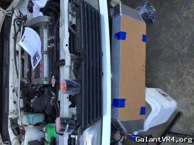

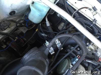

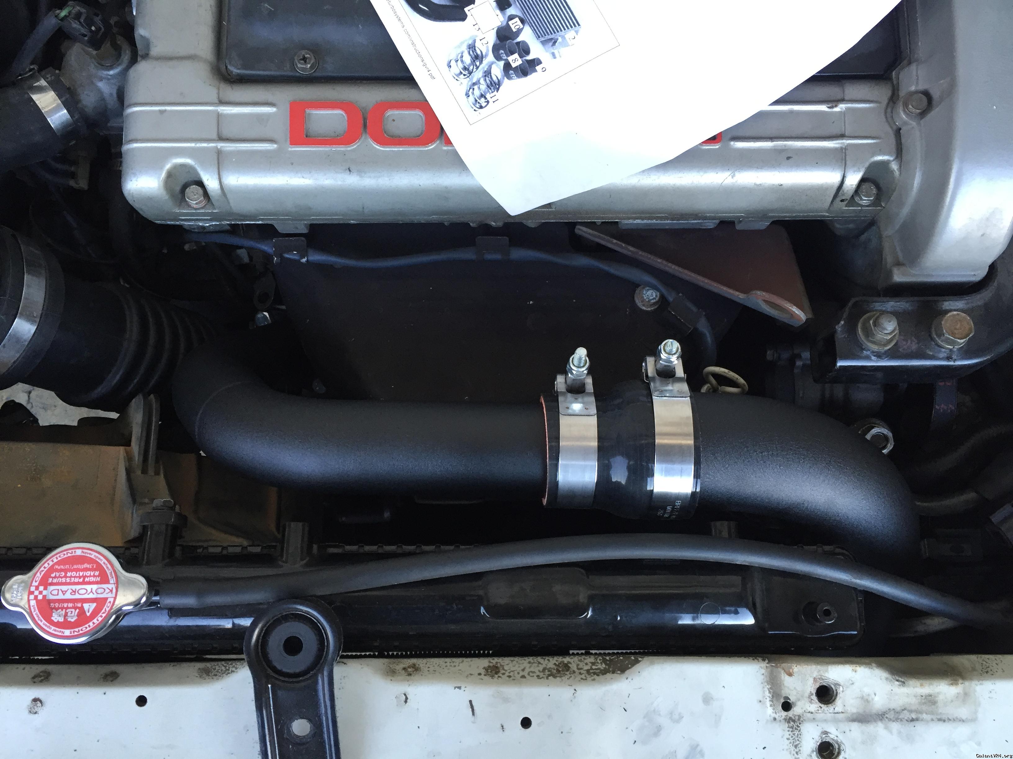

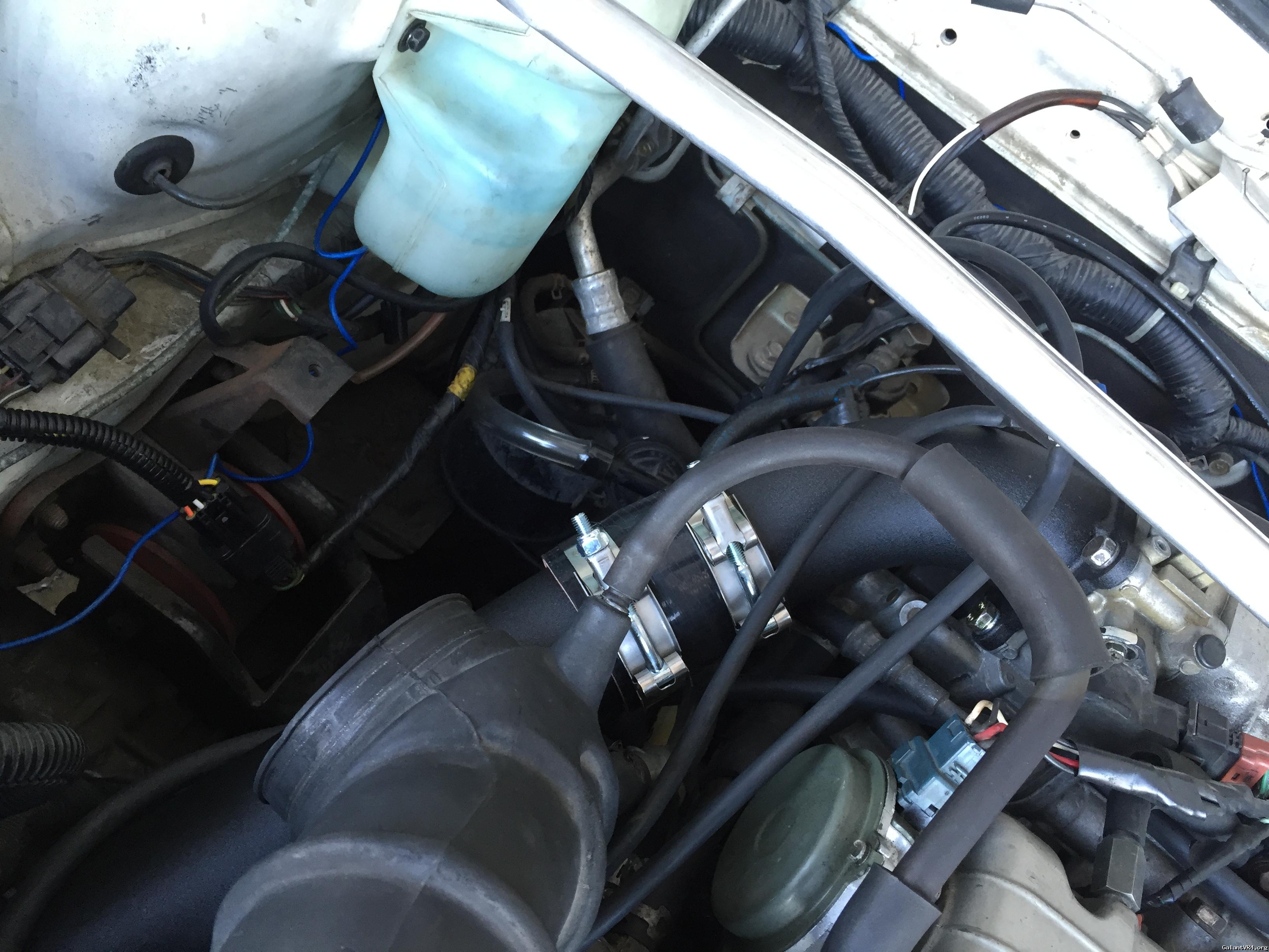

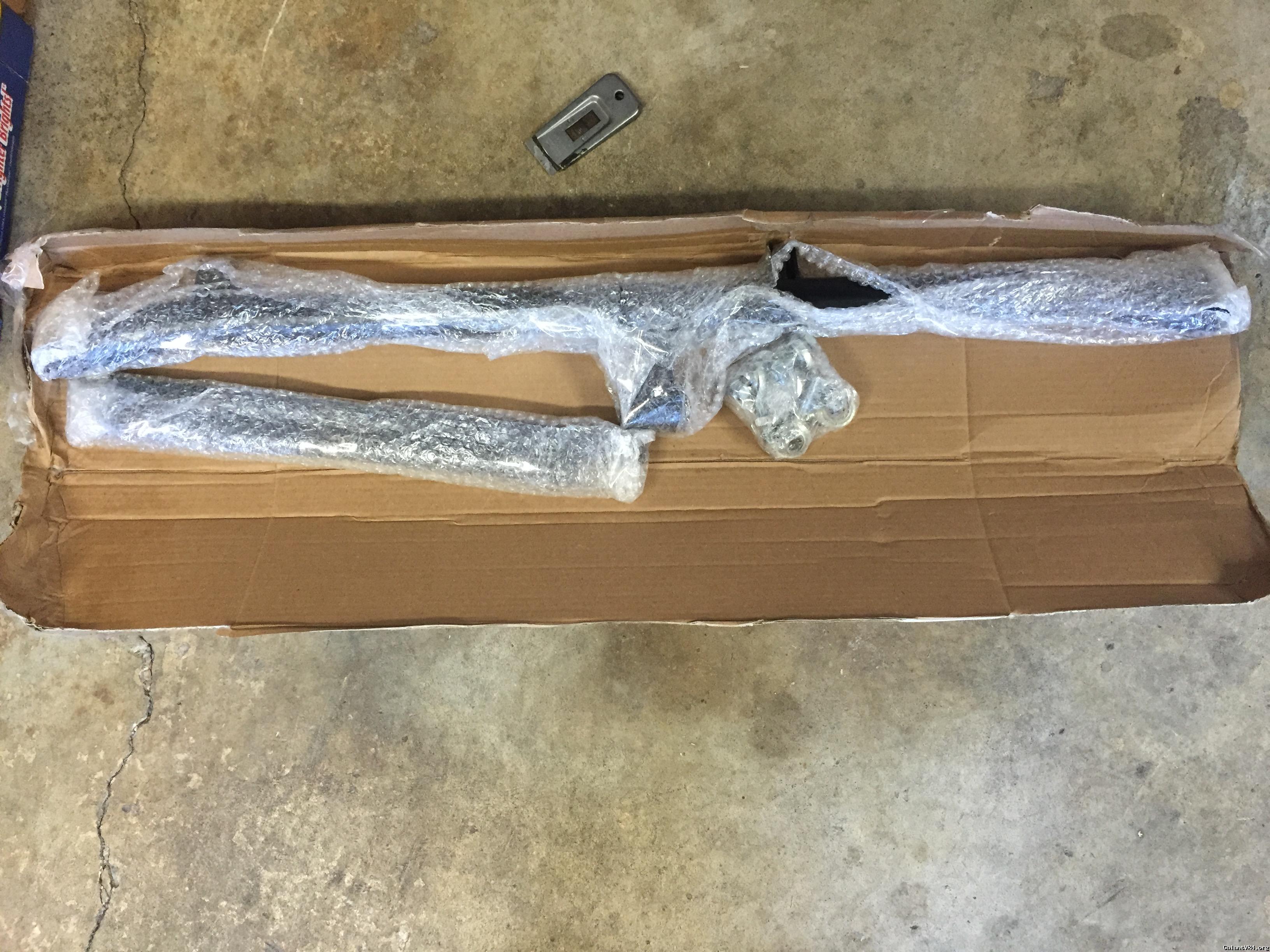

Ok had an ETS kit sitting for a couple months so decided to throw it on.
J pipe section

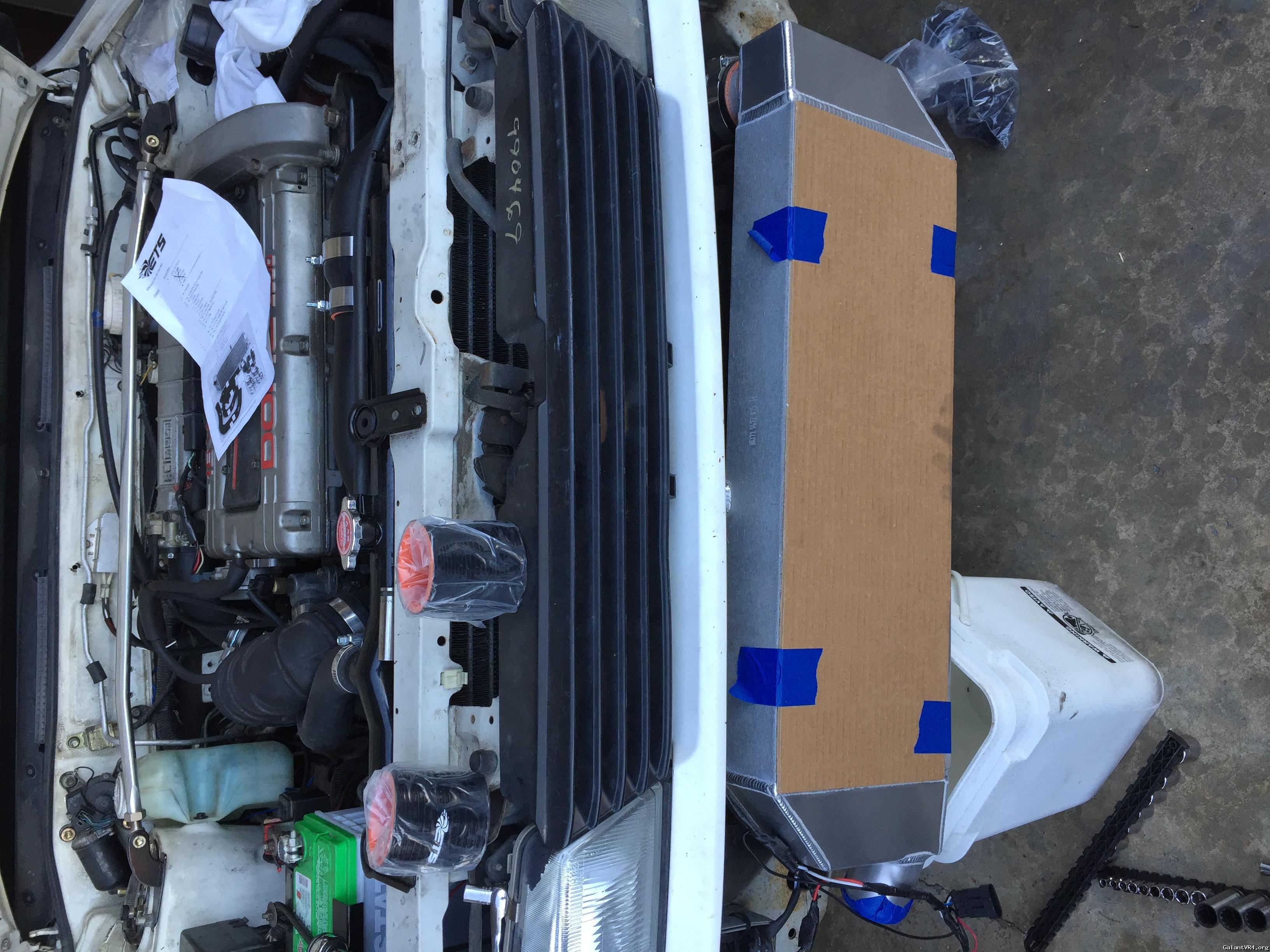

Intake side
And the intercooler
Thanks to Pot for getting me shorter bolt for the throttle body and working with me on getting shorter ones. Amazing seller!!

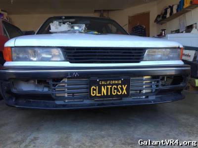

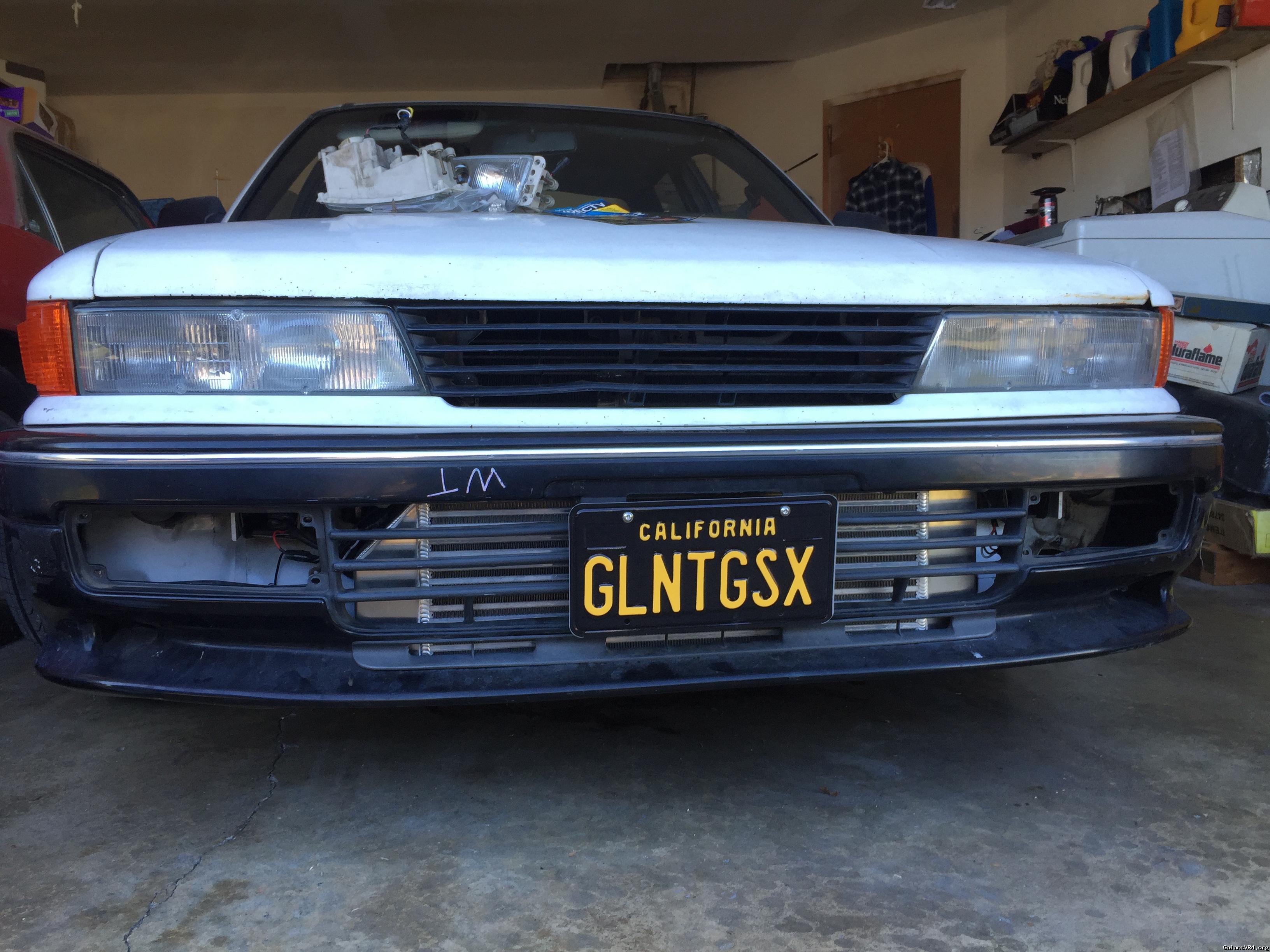

Well put the bumper on for the moment have to work on the bracket for the bumper it doesn't like the the intercooler!

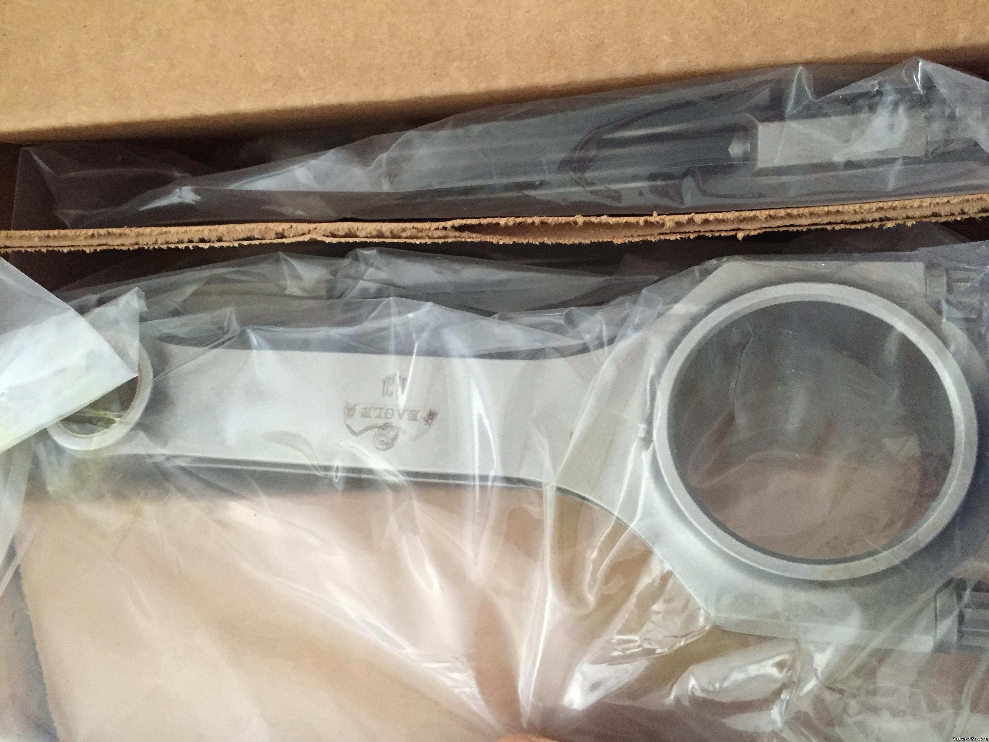

Got a decent deal on a set of eagle rods

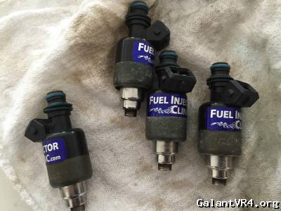

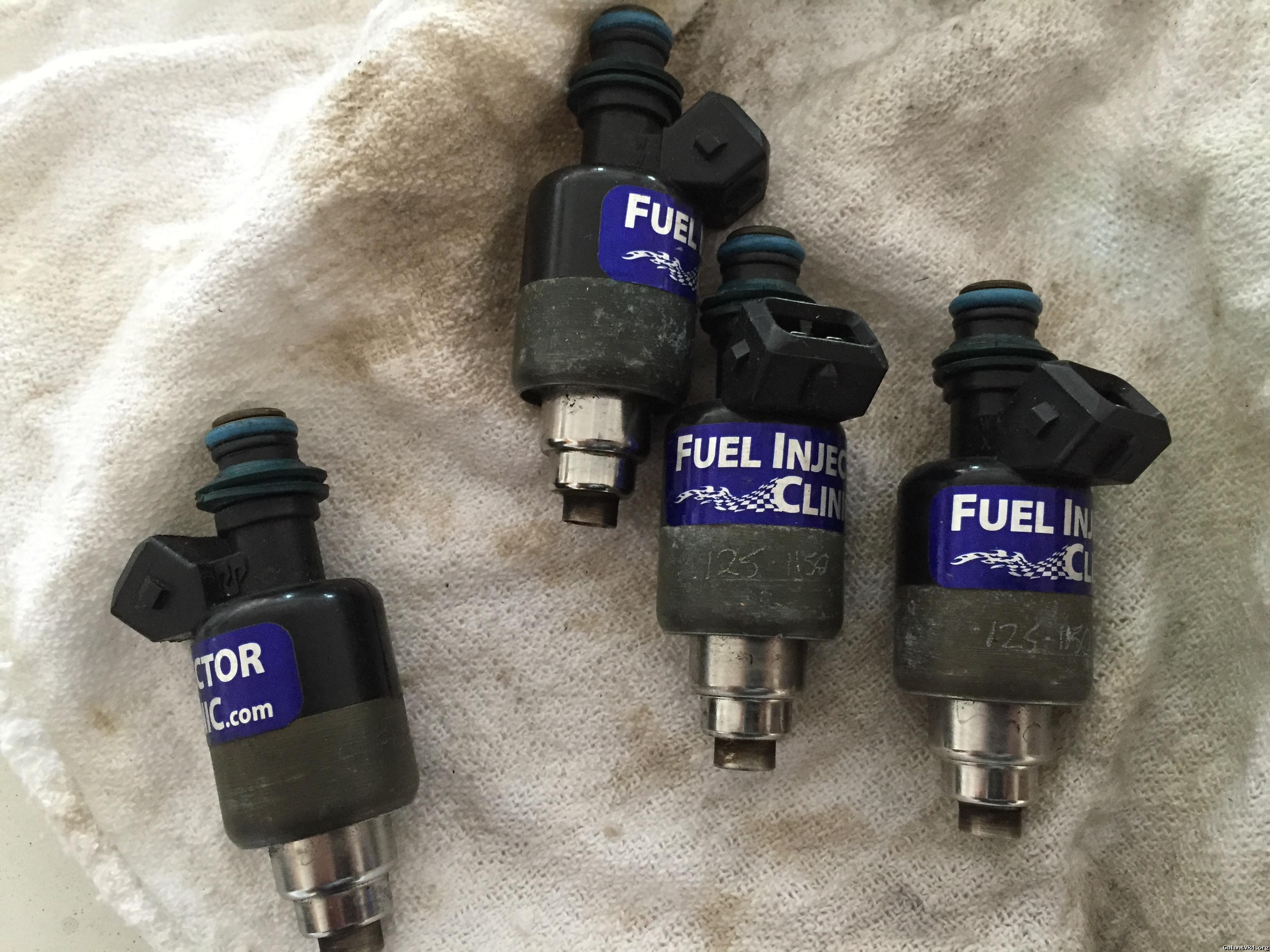

Bought a set of FIC 1150cc injectors

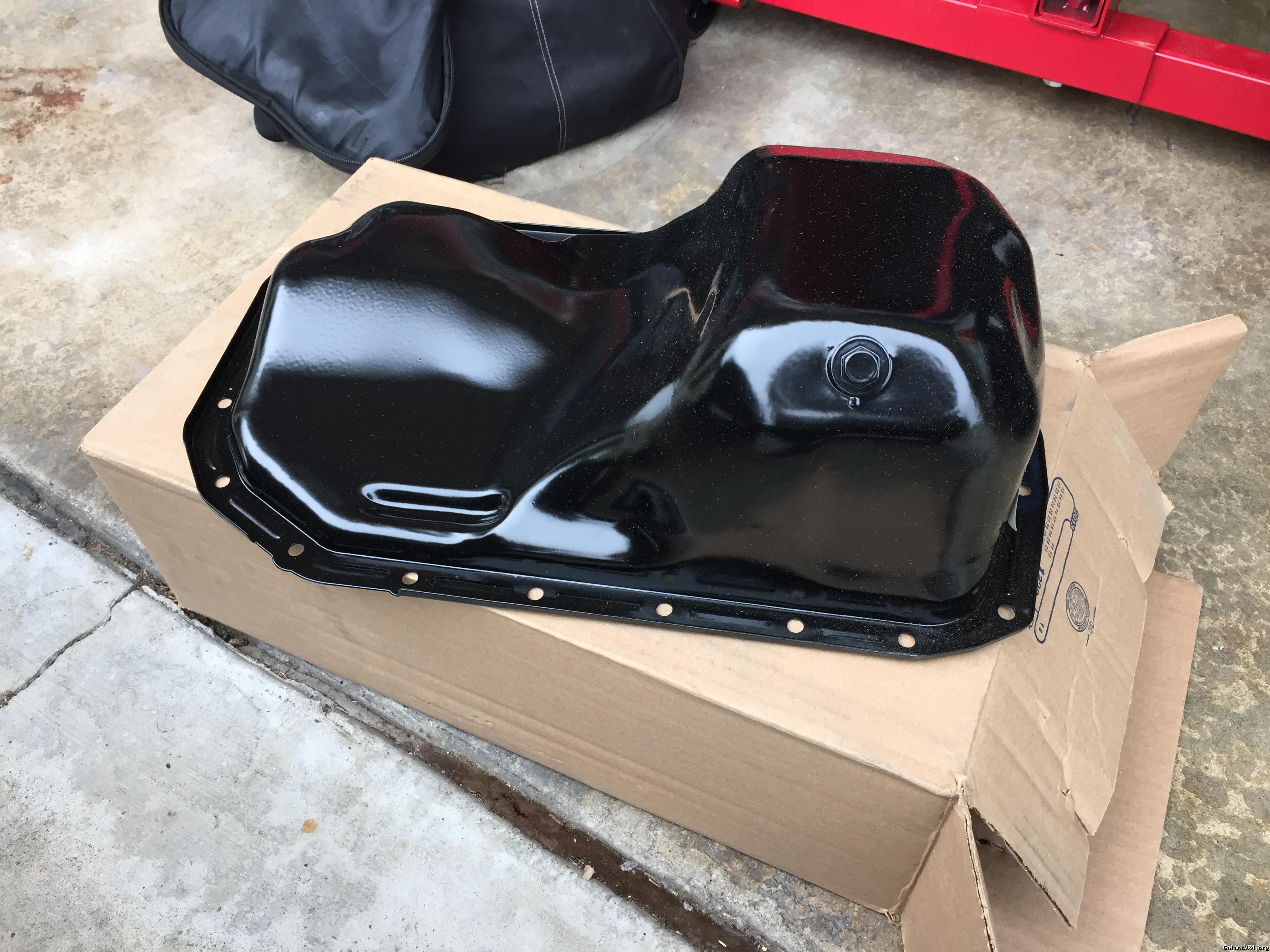

Oil pan was pretty beat up so got a spectra oil pan
Decided to spend a little bit of money so got a full Oem engine gasket kit, Oem timing kit with gates water pump, arp head studs, oil pan bolt kit, valve cover bolt kit, some other Oem hardware, rear main seal with separator, acl bearings, and wiseco hd pistons from JNZ. Then got a bare 6 bolt block.

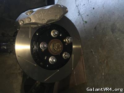

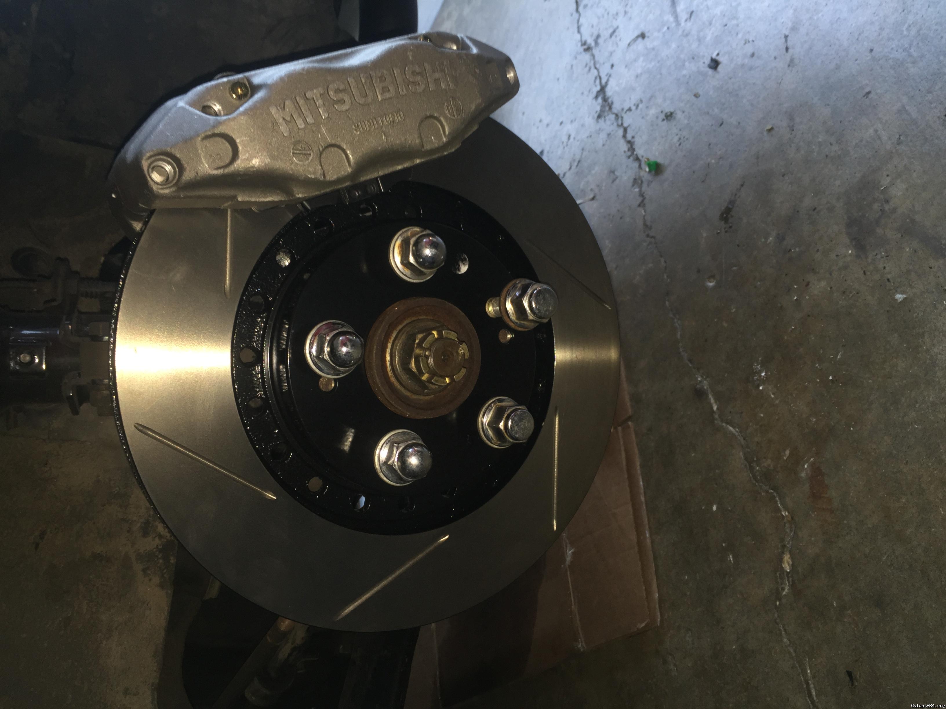

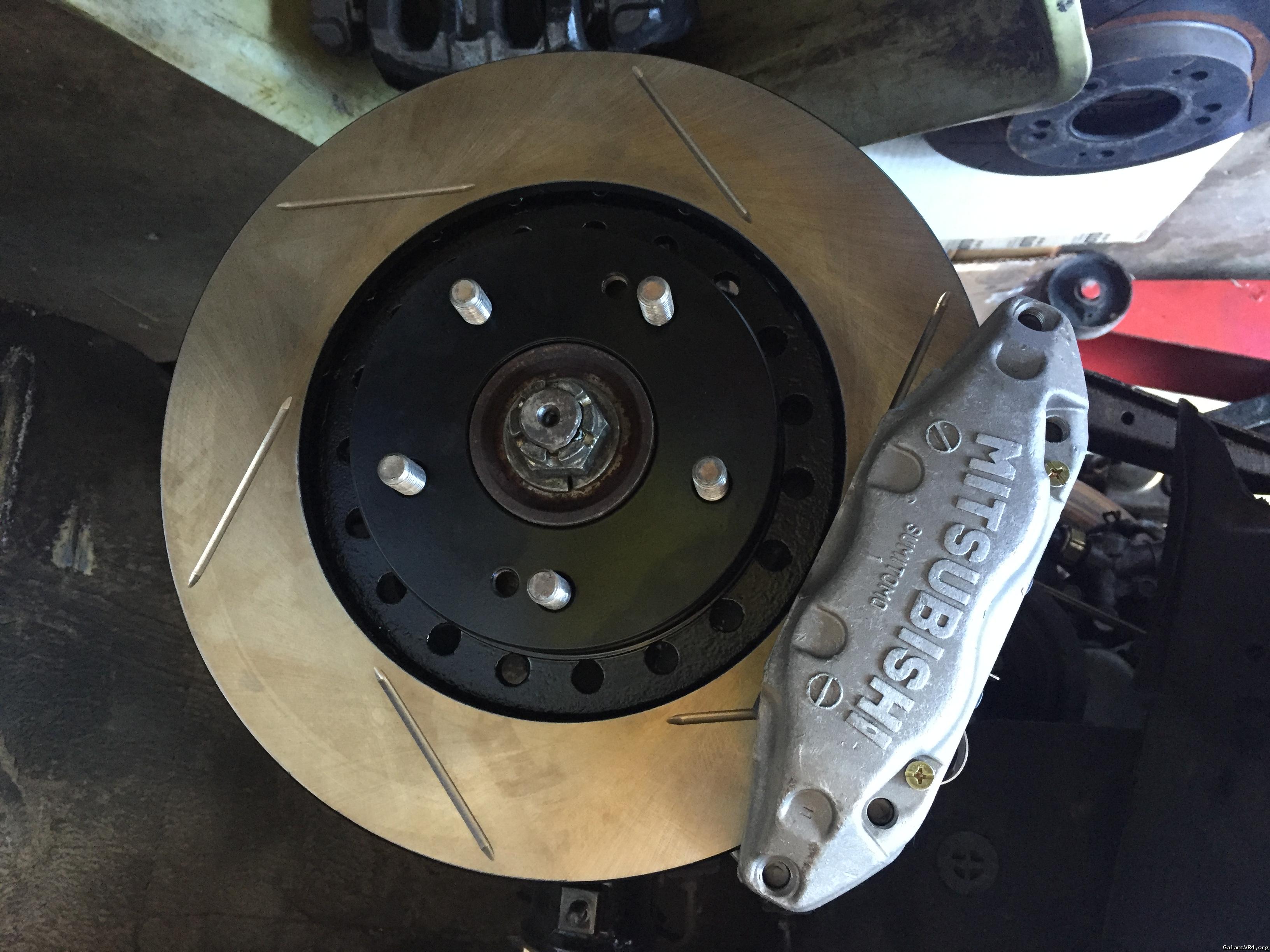

Installed the 1g 3kgt calipers from rockauto using tunersnation brackets and 2g 3kgt stoptech rotors. I have another set that need to be rebuilt but they were painted black which probably put up for sale if I can find the rebuild kit with replacement pistons. I think I like these unpainted a little better. Will have to replace brake line as one part cracked while trying to unscrew from the old calipers. I'll see if I get another set.

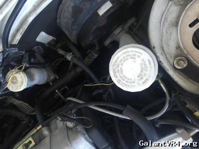

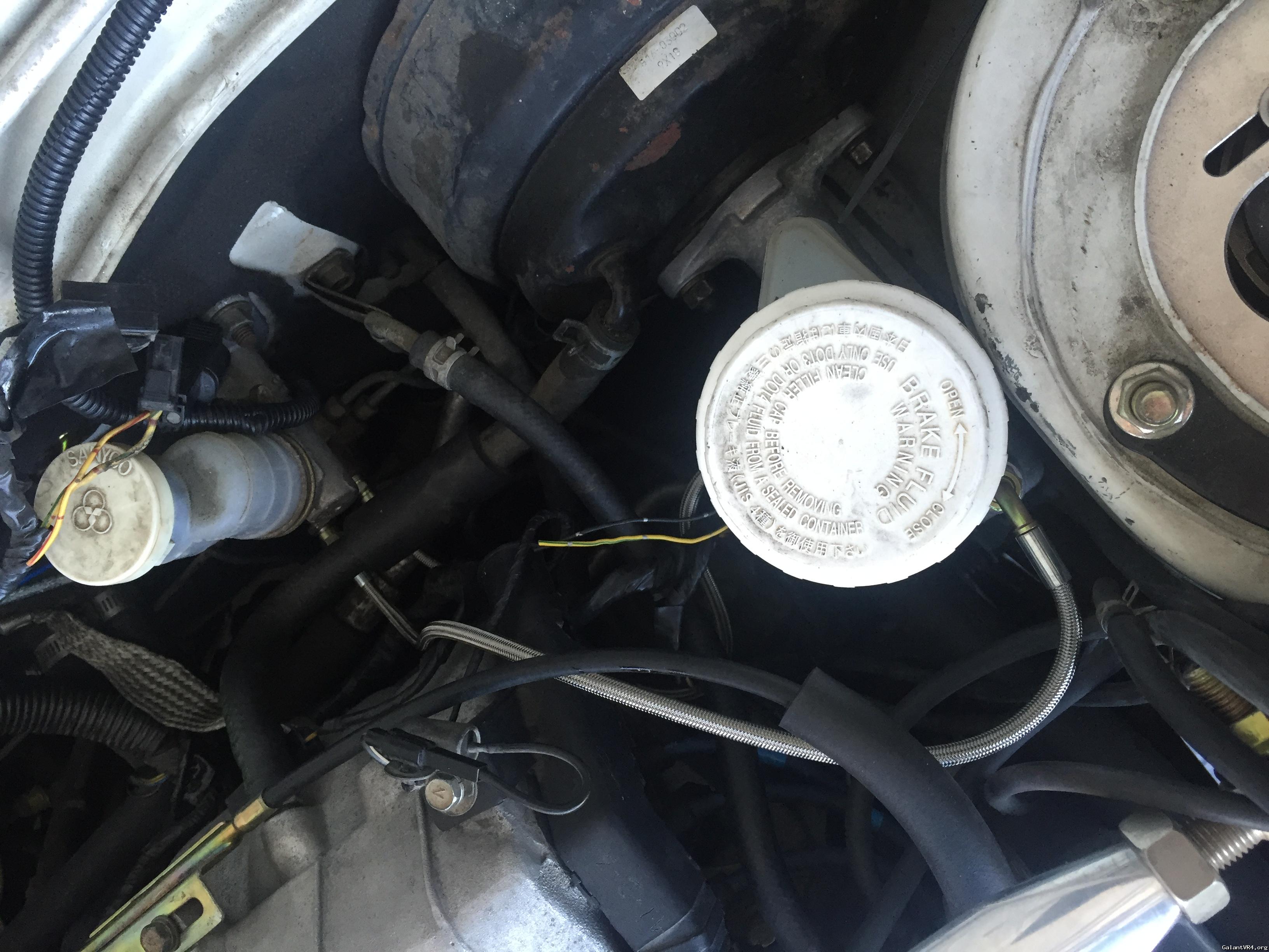

Then the 3g master cylinder went in. Followed the set up for Brett (GSTwithPSI) thanks for the idea!
Will bleed the brake either Monday or Wednesday.

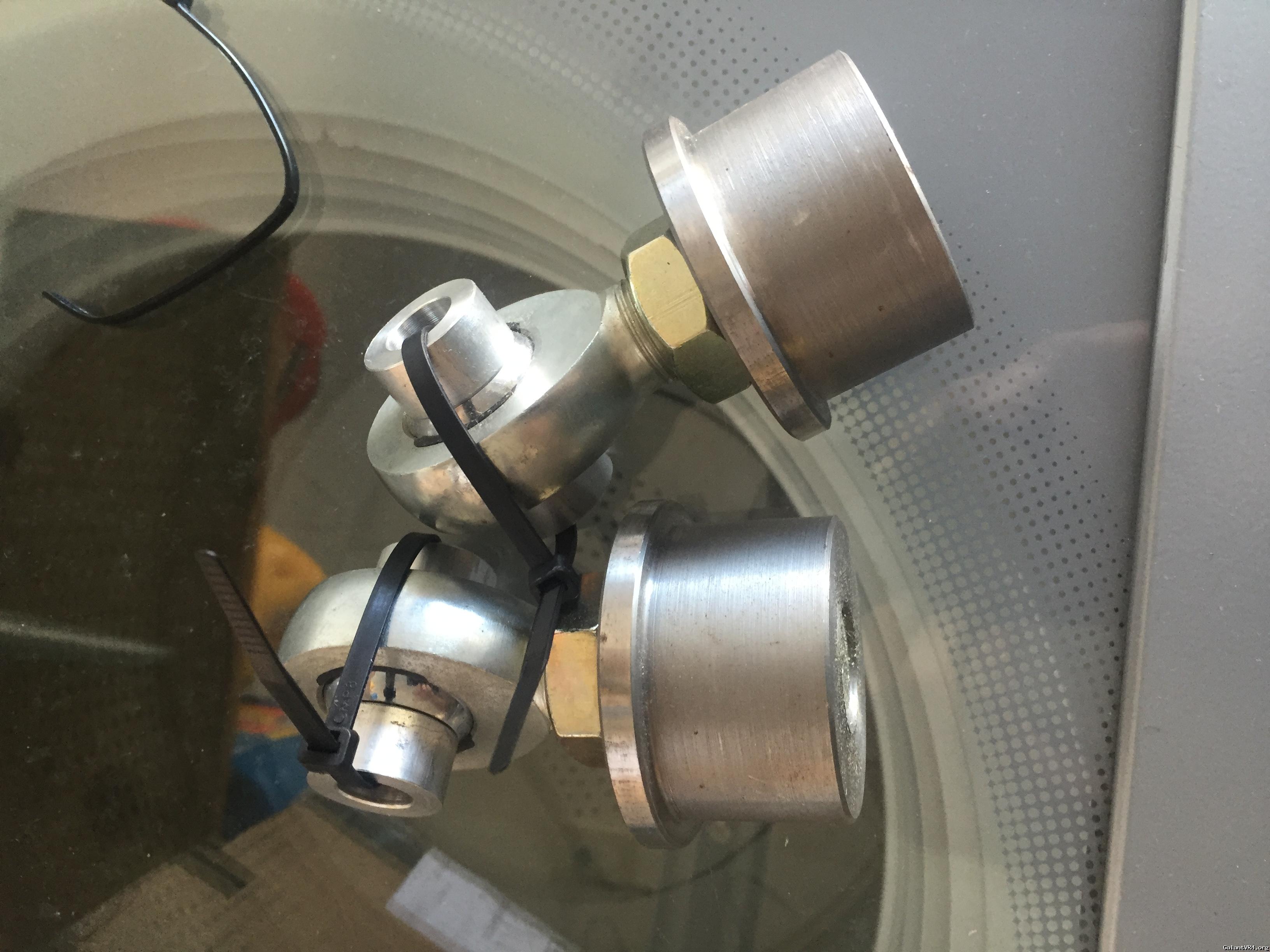

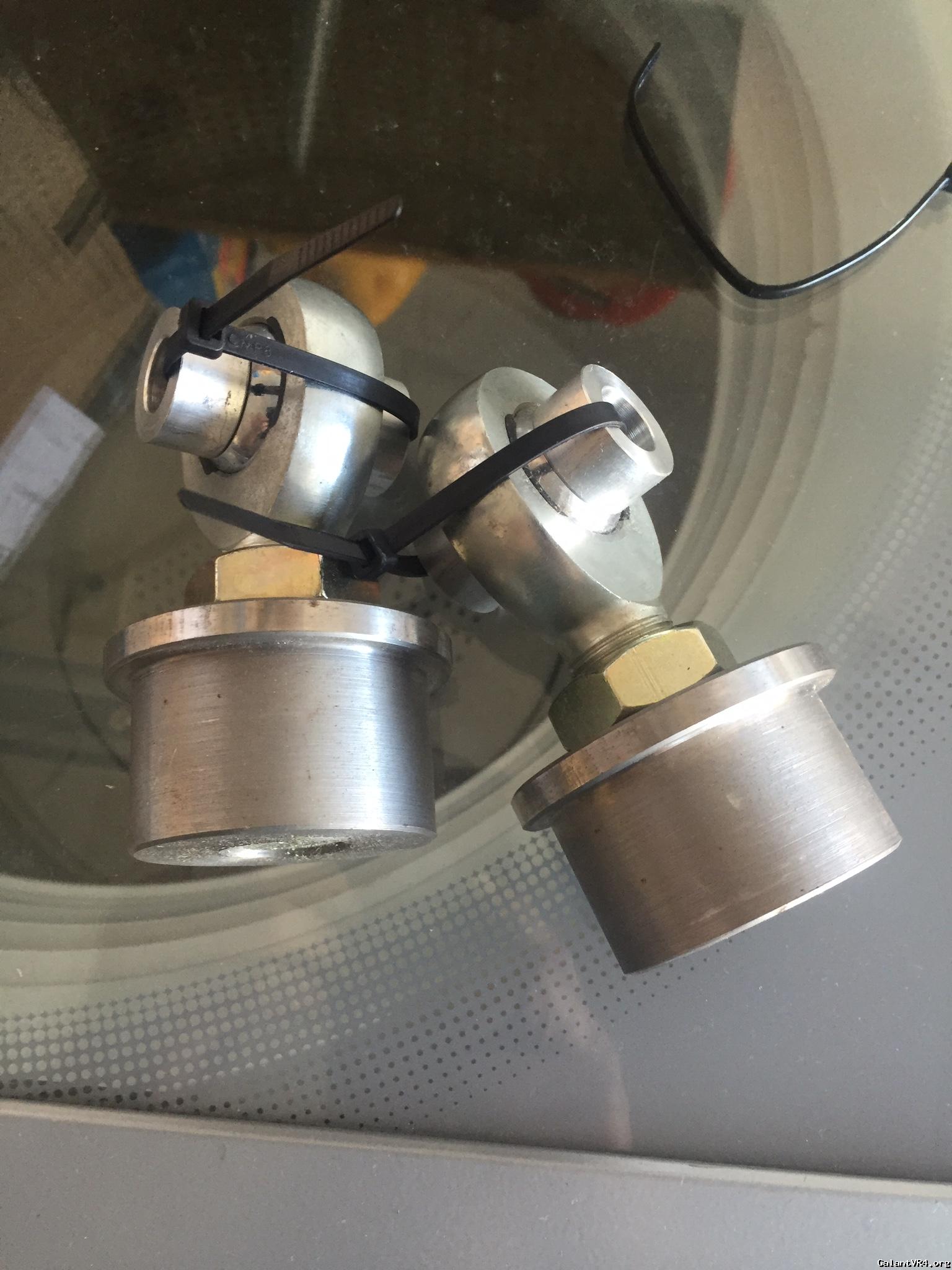

Got the Jay's rear toe eliminator in. Will have them welded onto a spare set of trailing arms that I will clean up and then paint.

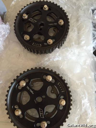

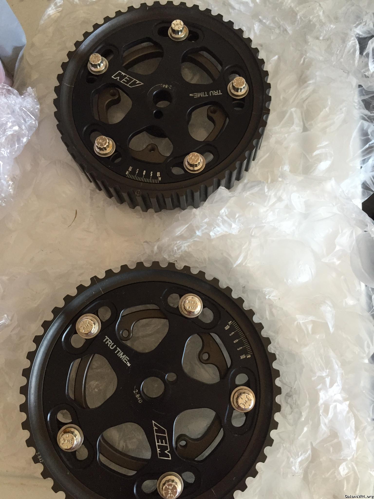

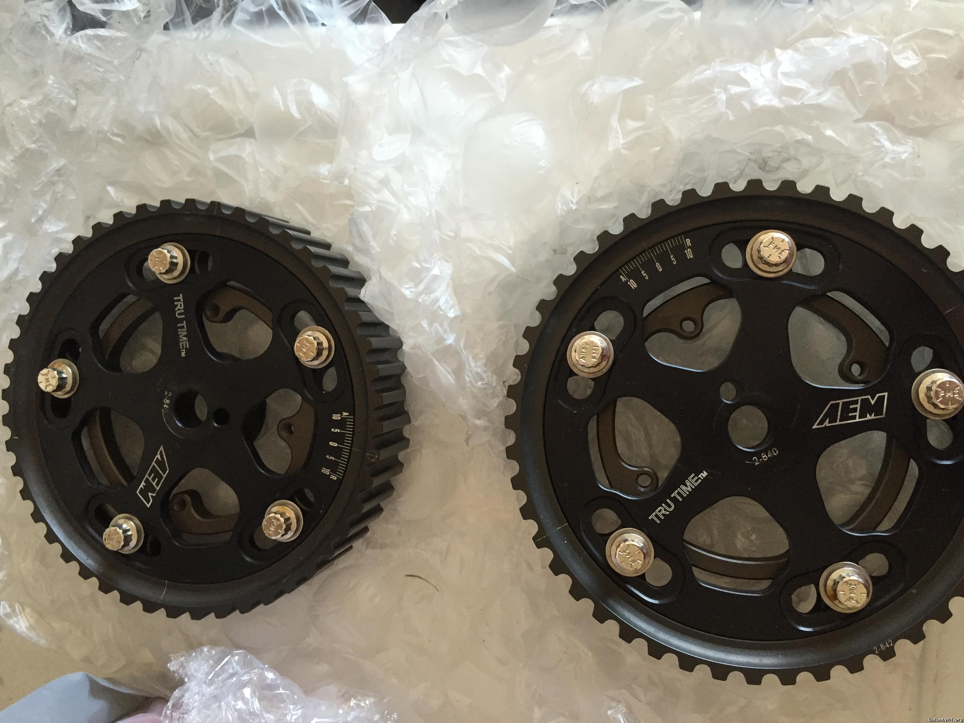

Got in a set of AEM cam gears also

Aem Cam gears have come a long way since mine came out. Those are very nice.
I like the clean metal look of the brakes too, but you best put a clear coat on those calipers before they turn brown.
Edit: do the brackets too.

3kgt brakes and 8g brake master cylinder have added a good amount of bite.

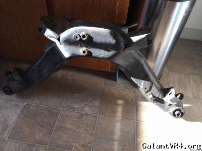

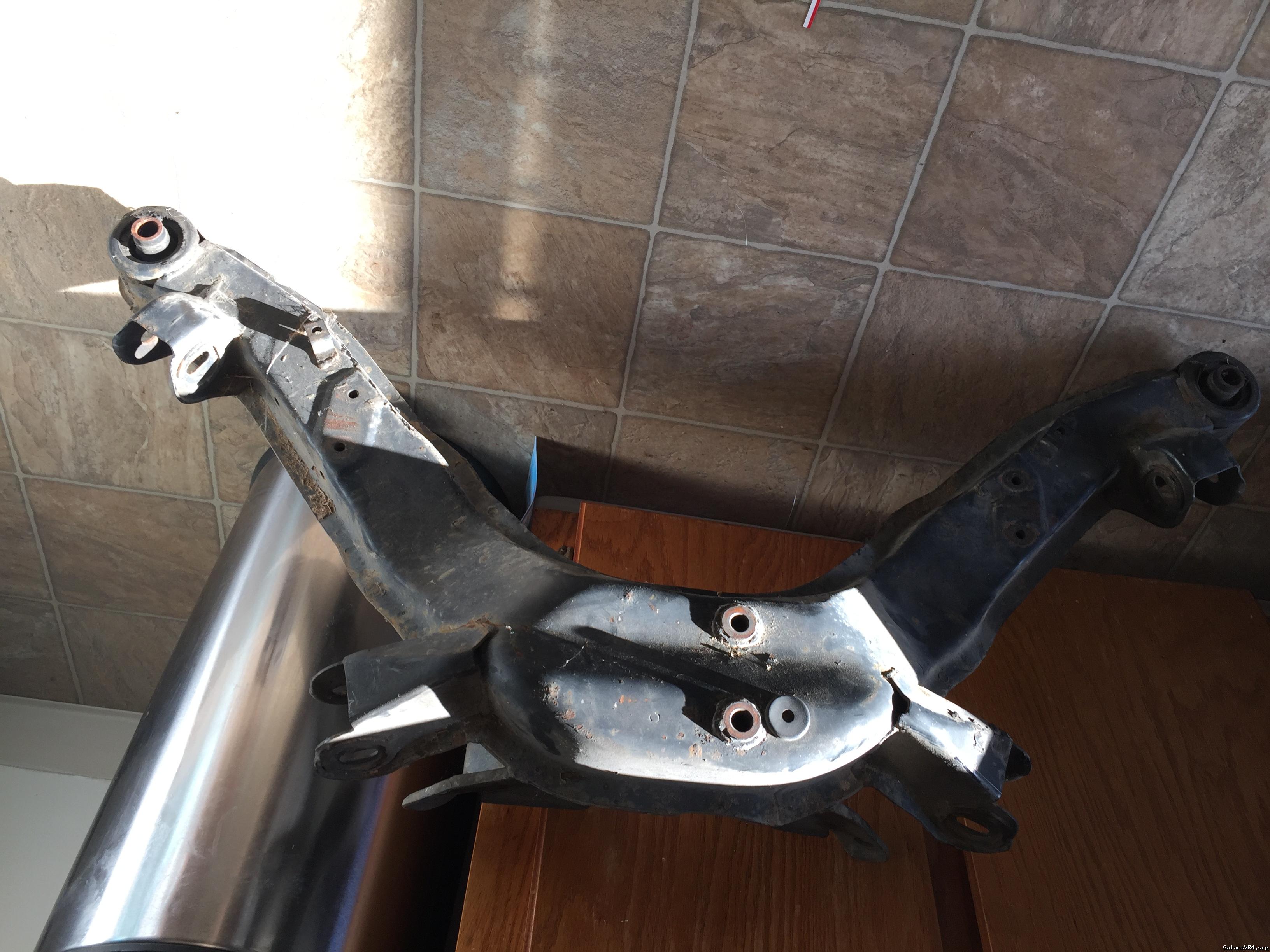

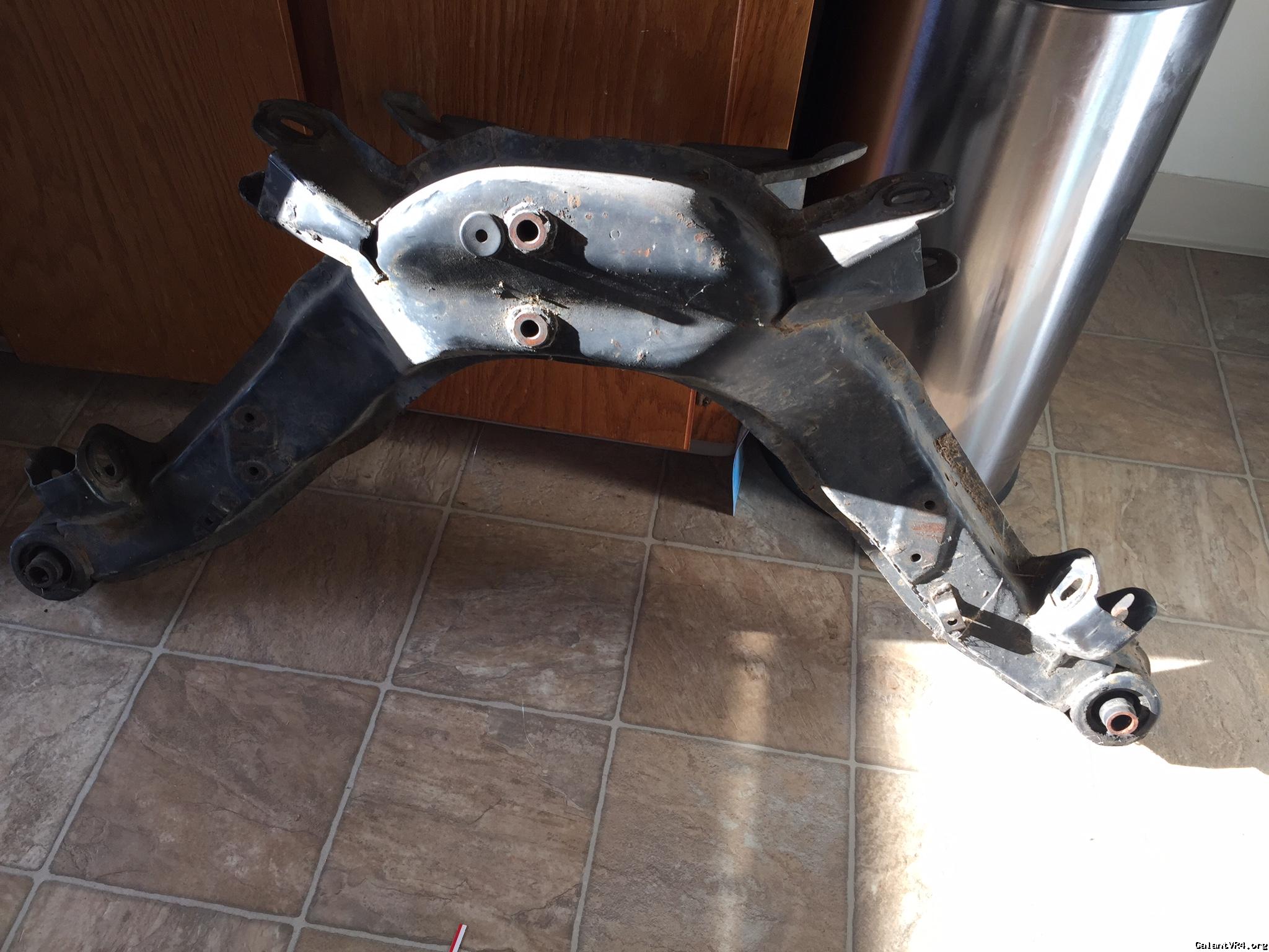

SSGdave gave me a spare rear subframe he had so will remove the bushings and either sand blast it or wire wheel it. Afterwards I will repaint it and put it away till I find some rear subframe bushings without the mustache bushings. Emailed boostx and I am waiting to hear back. Then I will clean up and repaint the trailing arms I have and install the Jays rear toe eliminators with new hubs and bearings.

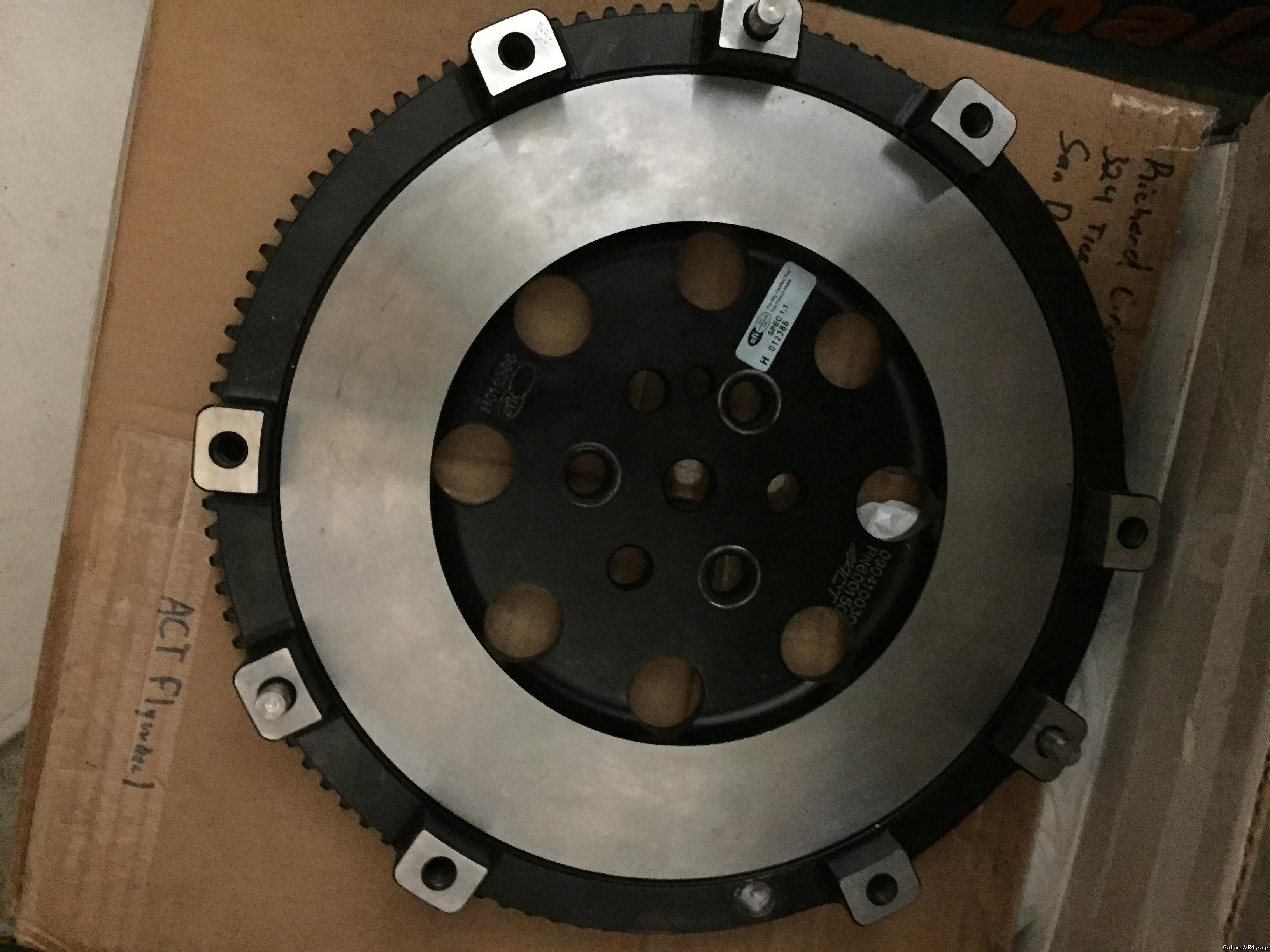

Got a ACT flywheel from street surgeon. FedEx sent to the wrong address. And Cory did an amazing job fixing the mix up!

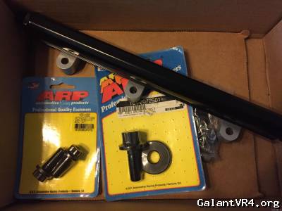

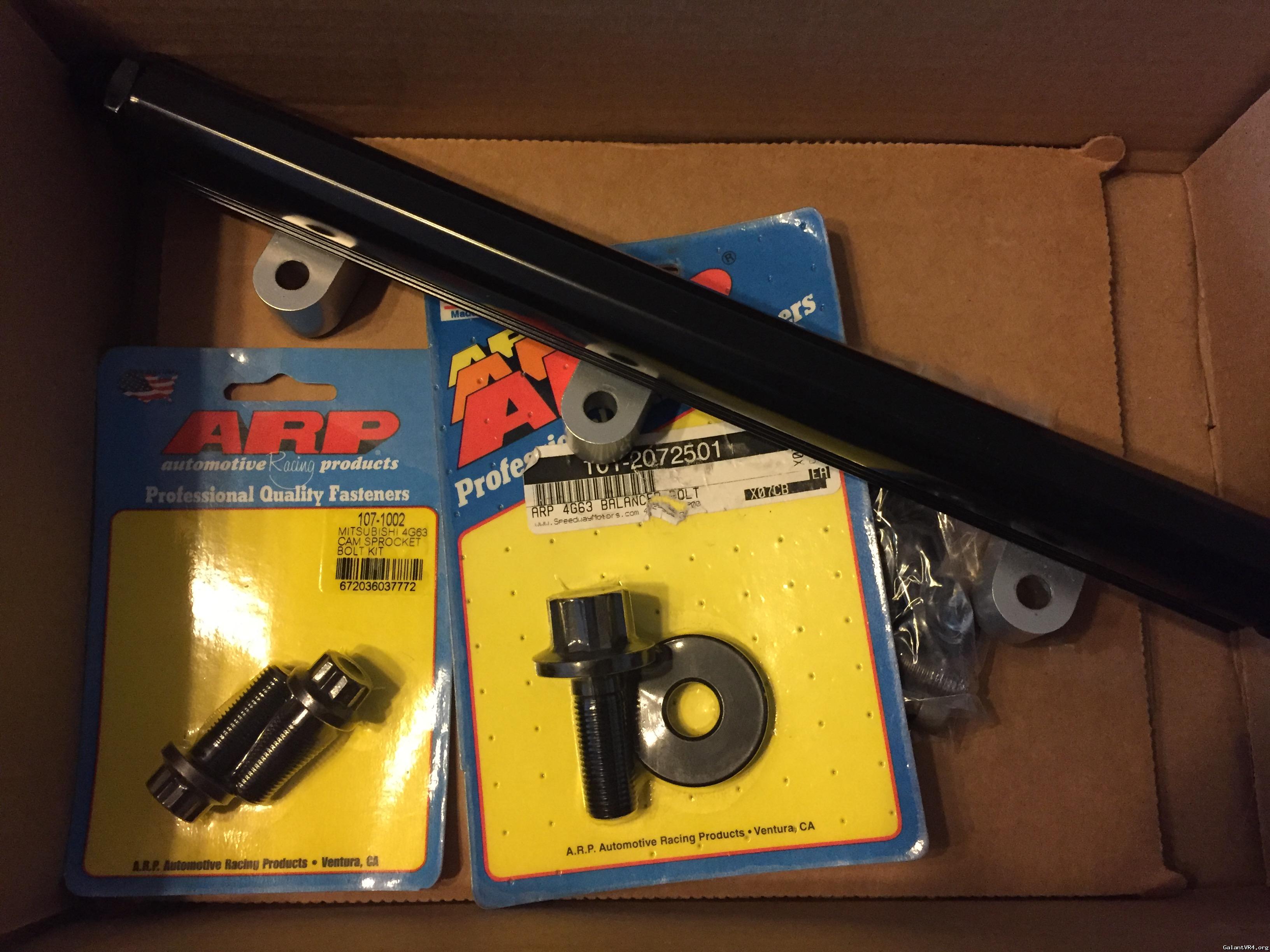

Then got arp crank and cam bolts and Aeromotive fuel rail from street surgeon.

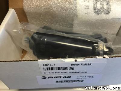

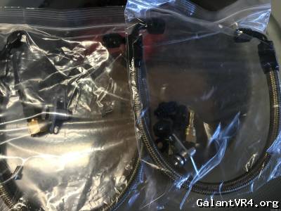

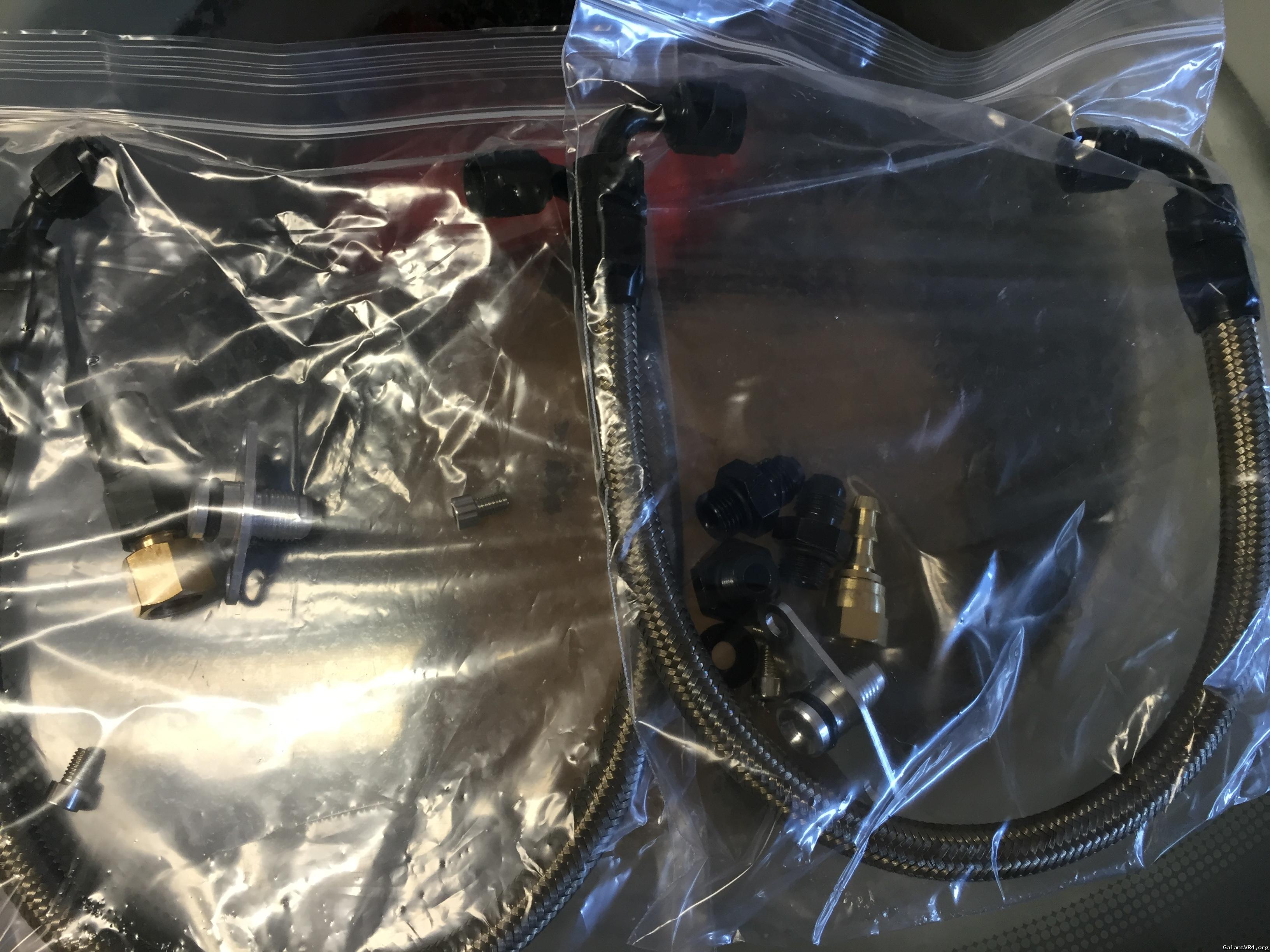

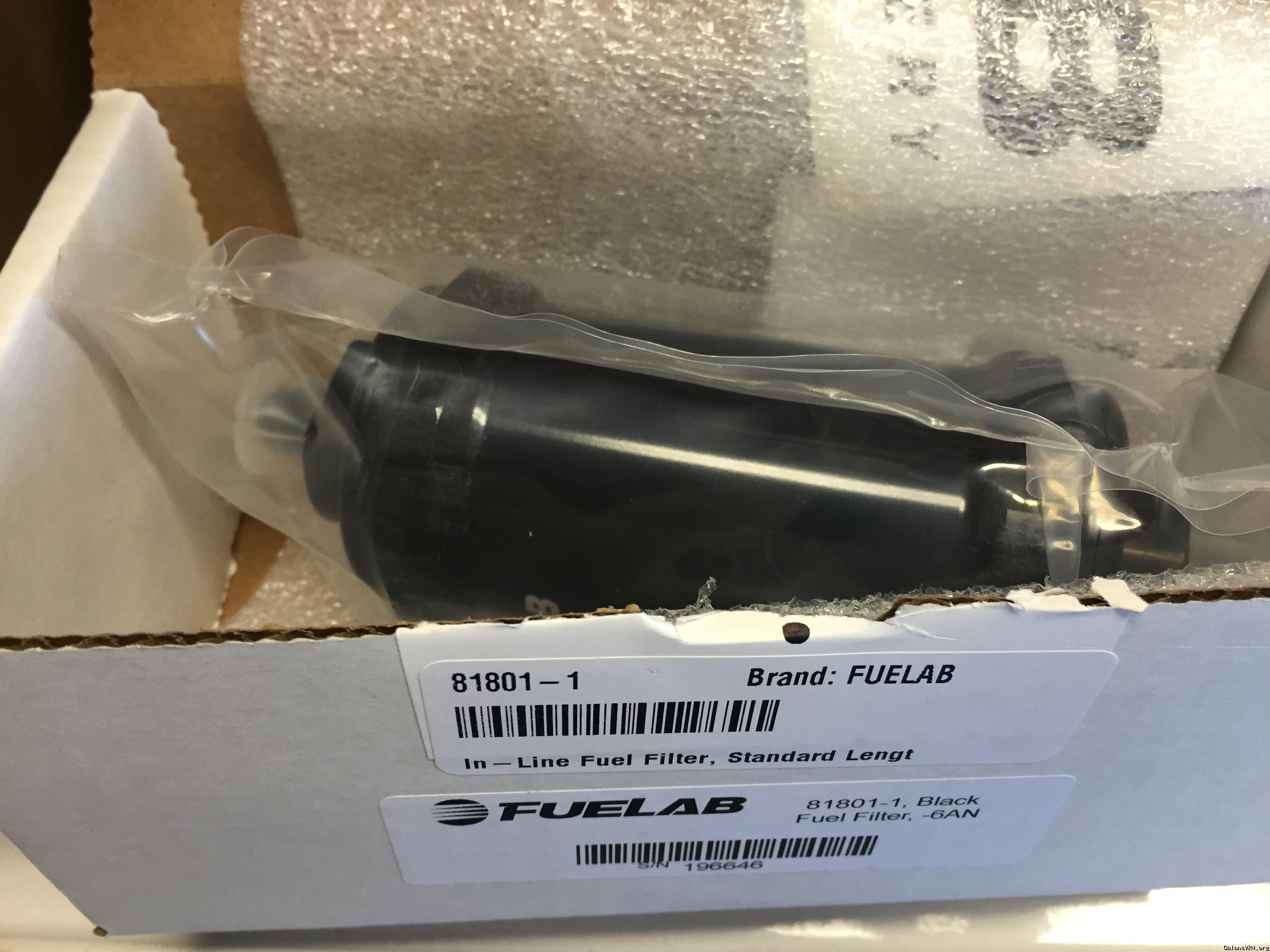

And then got a fuel lab fuel filter with lines

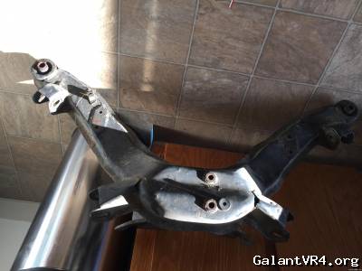

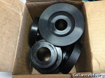

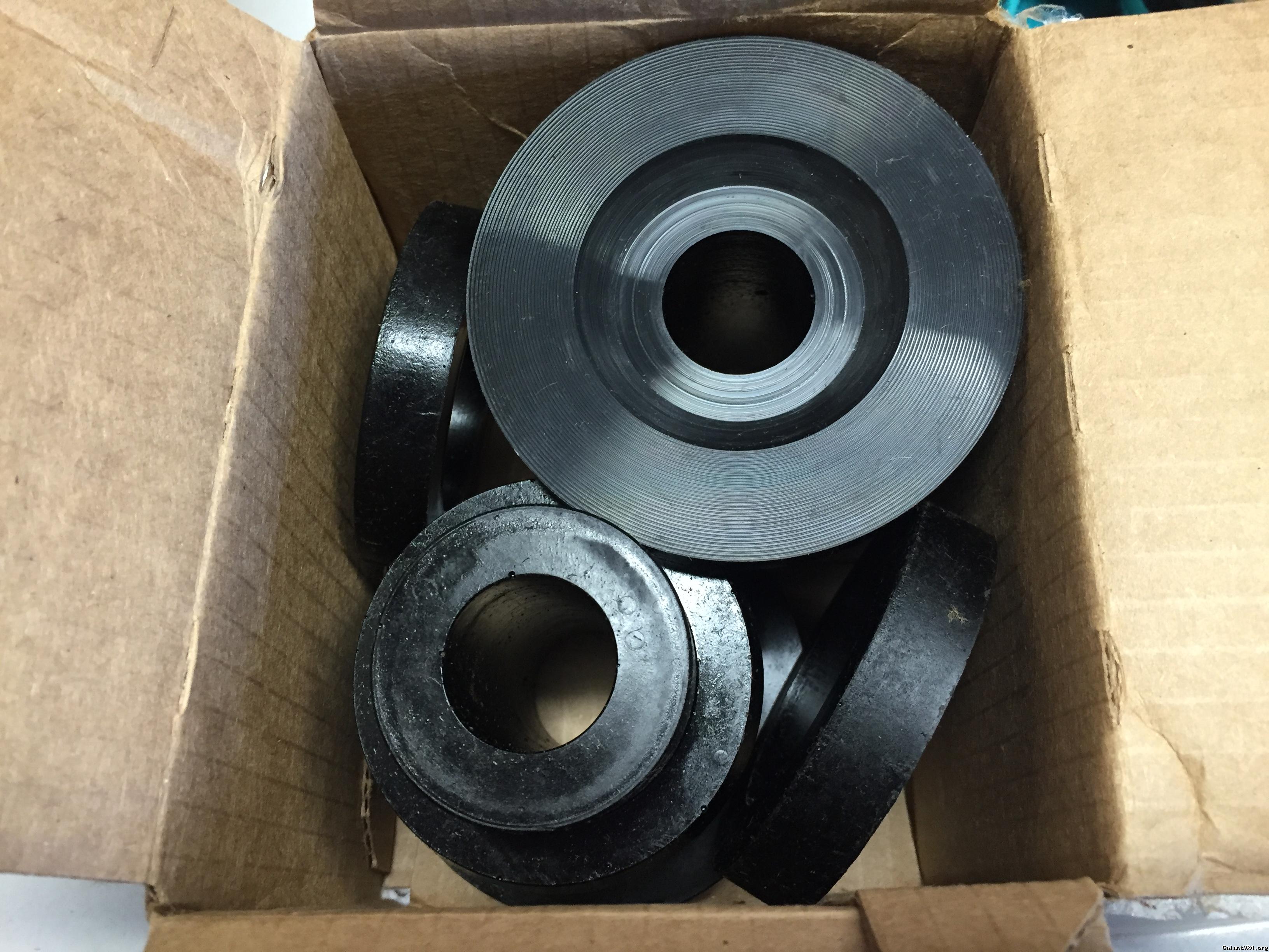

And got a hold of Jon (boostx) and got a set of rear subframe bushings
Here is the rear subframe I will be working on

So this week I had an injector squirt fuel out the top seals on the 1150cc injectors so replaced all the seals then took for a spin around the block. The car didn't feel like it was getting into boost so searched for loose couplers and couldn't find any. So drove the galant to my parents house to look in their garage. I ended up seeing that the cotter pin for the wastegate actuator was gone and the actuator was disconnected. So spent a couple hours fixing that and now it pulls appropriately.

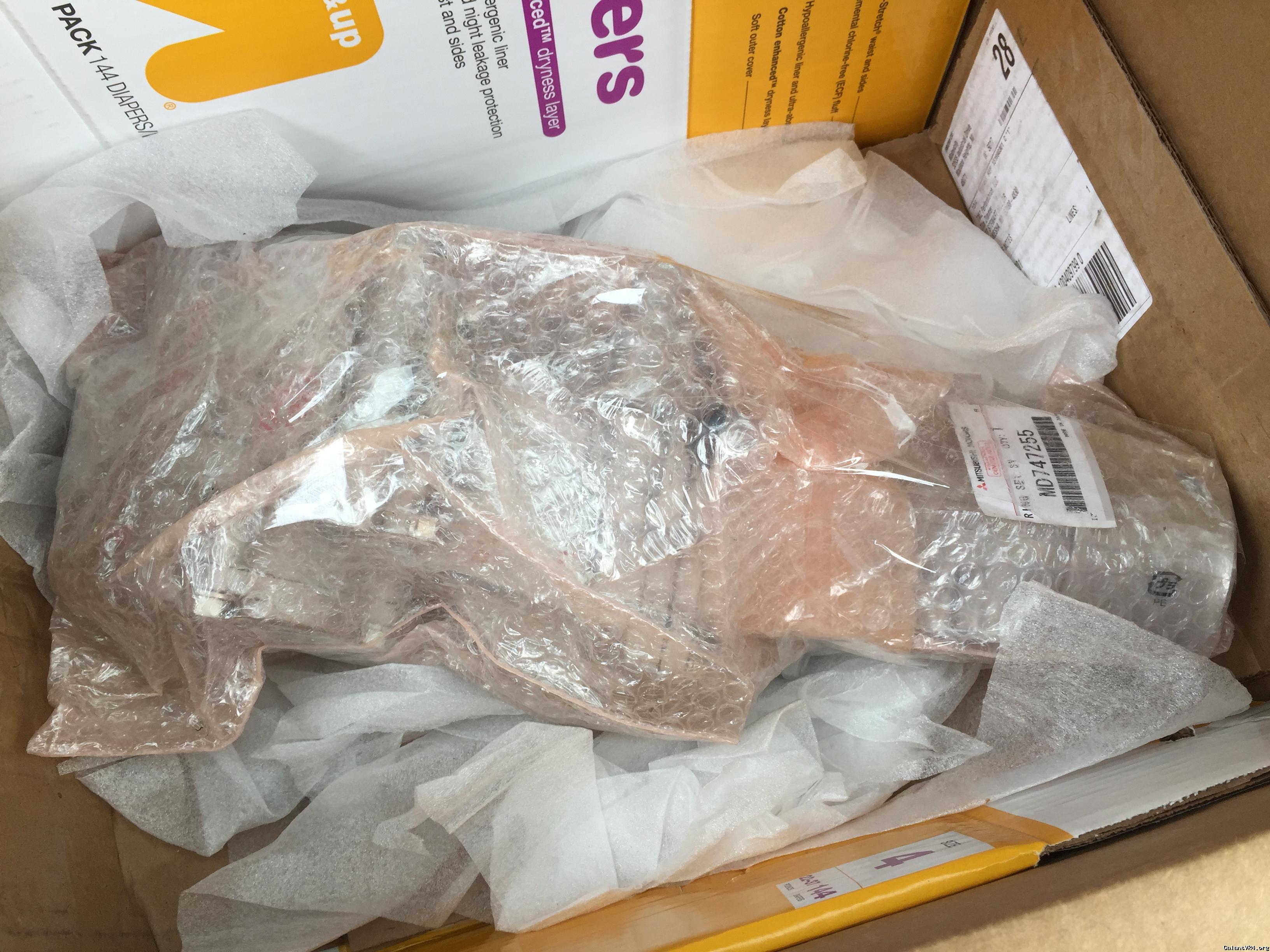

Some parts have come in!

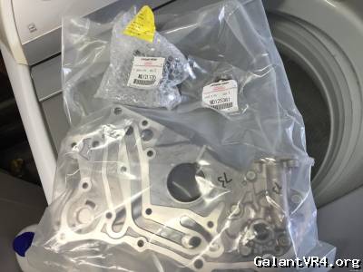

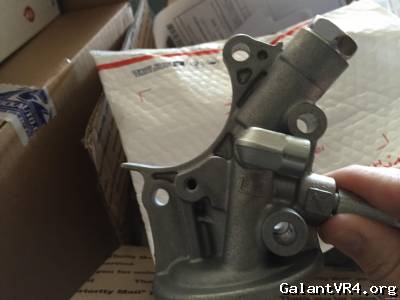

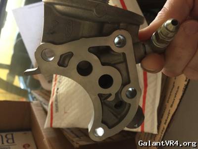

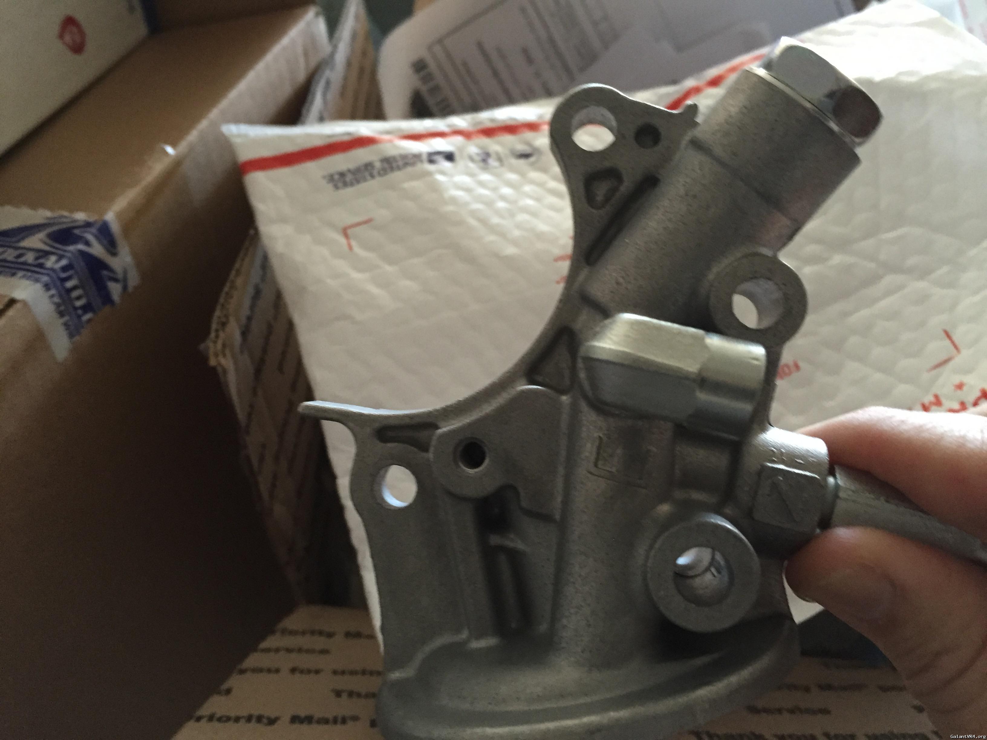

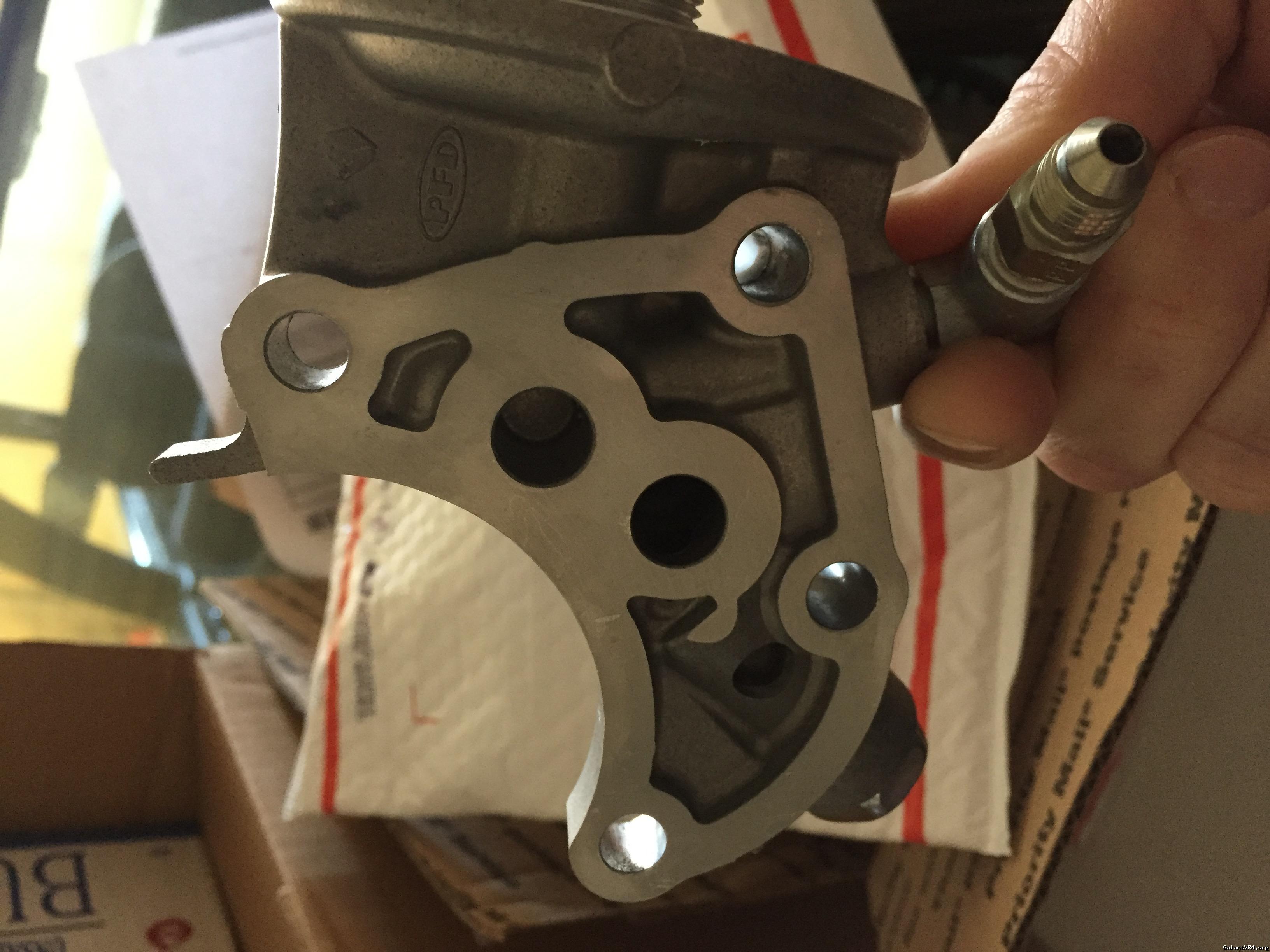

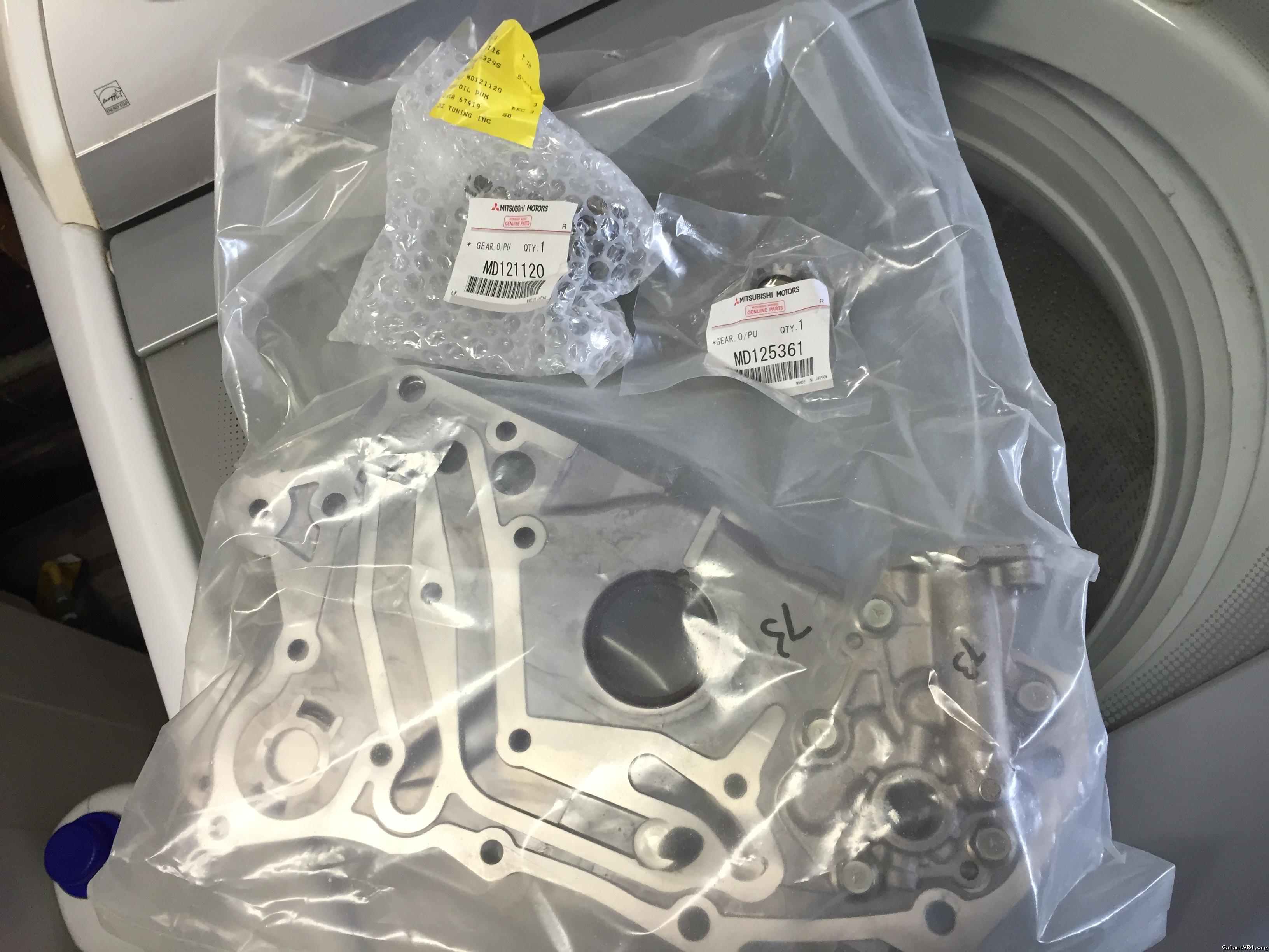

For the rebuilt block I ended up ordering a new oil pump with gears.
Along with this order got various hardware, new dipstick and tube, and a few other parts for the engine rebuild.

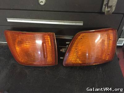

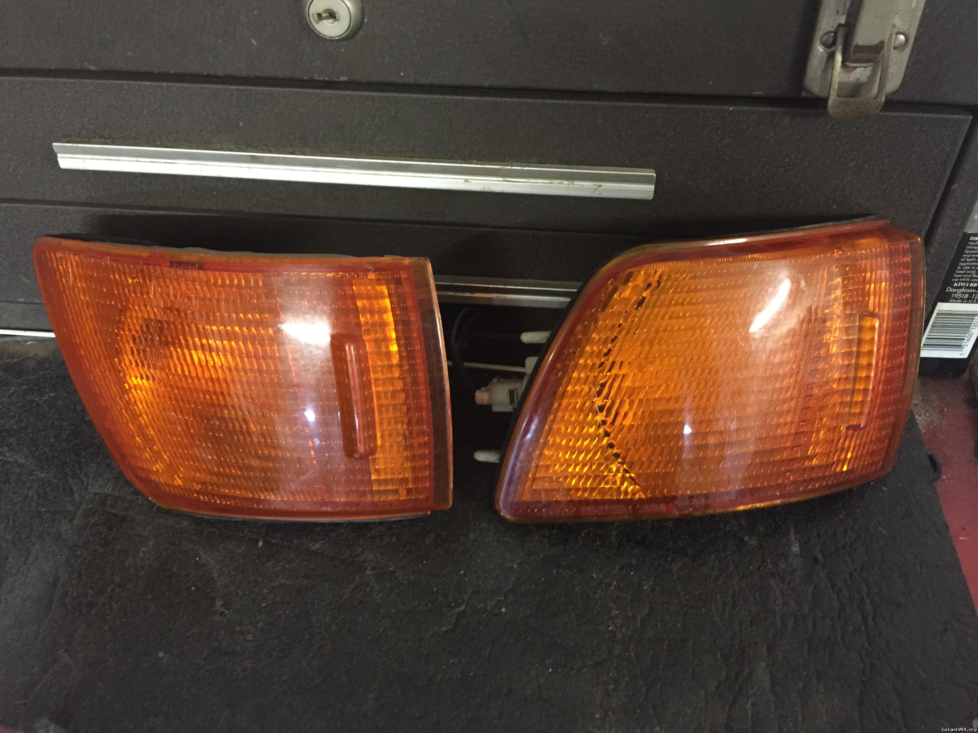

And a set of euro ambers from Ahmad. Hopefully they sit in place better than the depot ones that are on the car now.

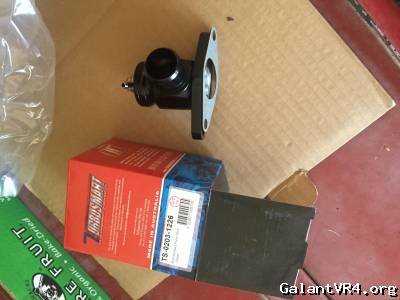

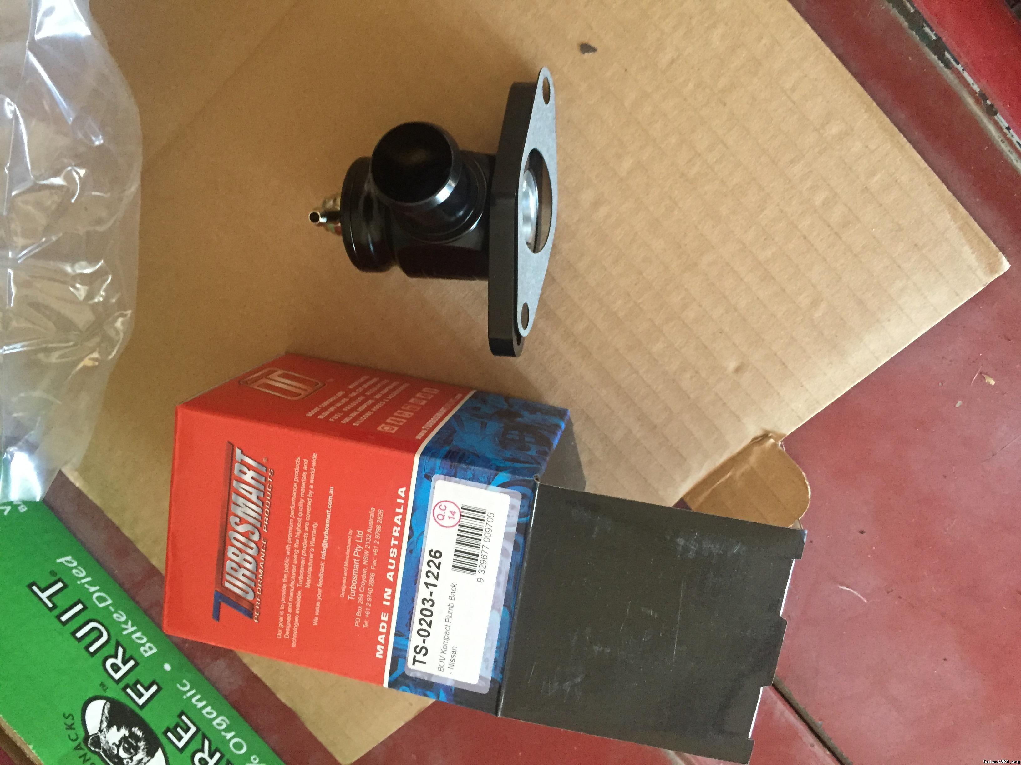

Got a turbosmart bov because it was a bolt on flange and its black
