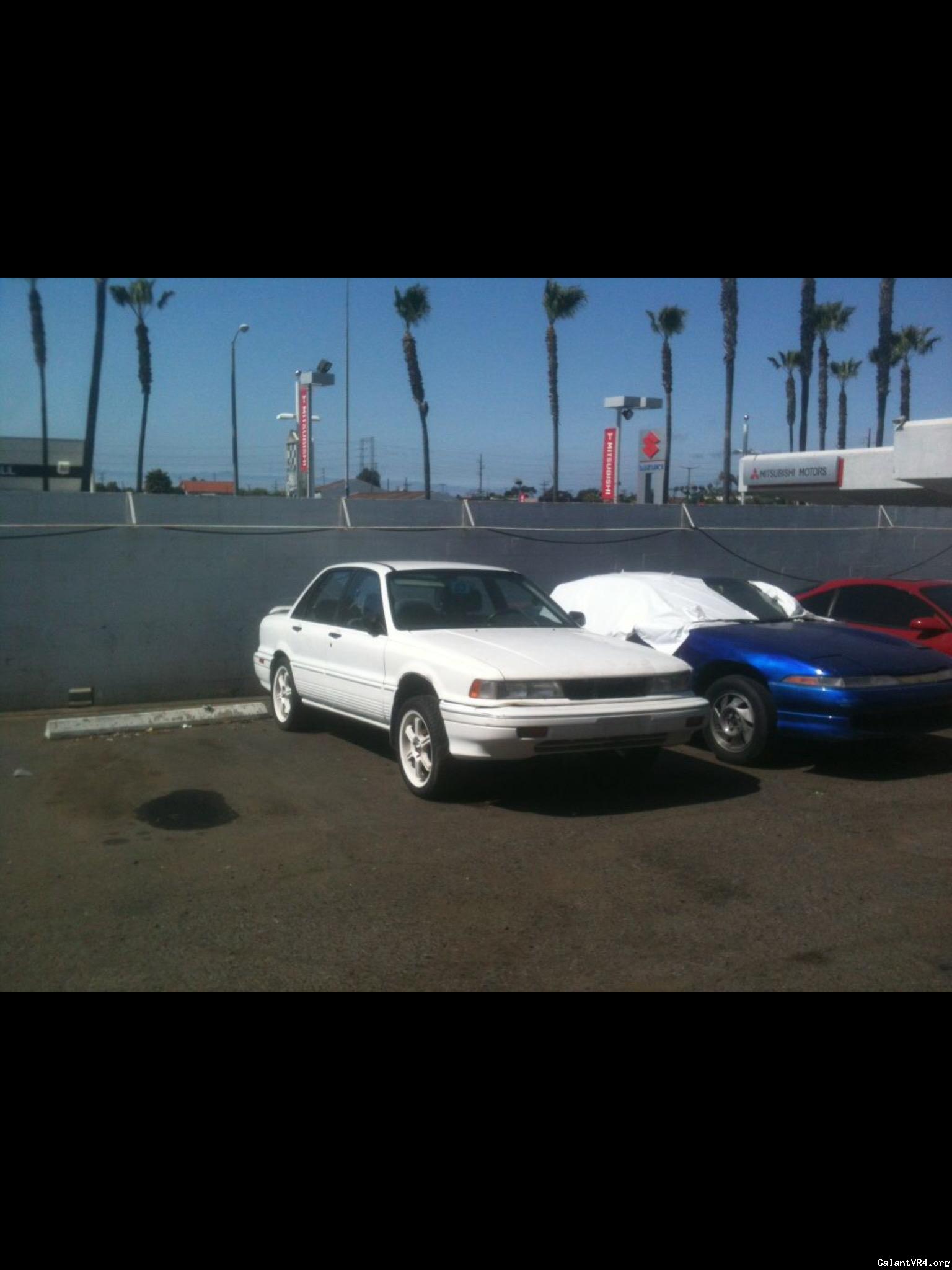

This is the day we had the car towed to the dealership my buddy worked at.

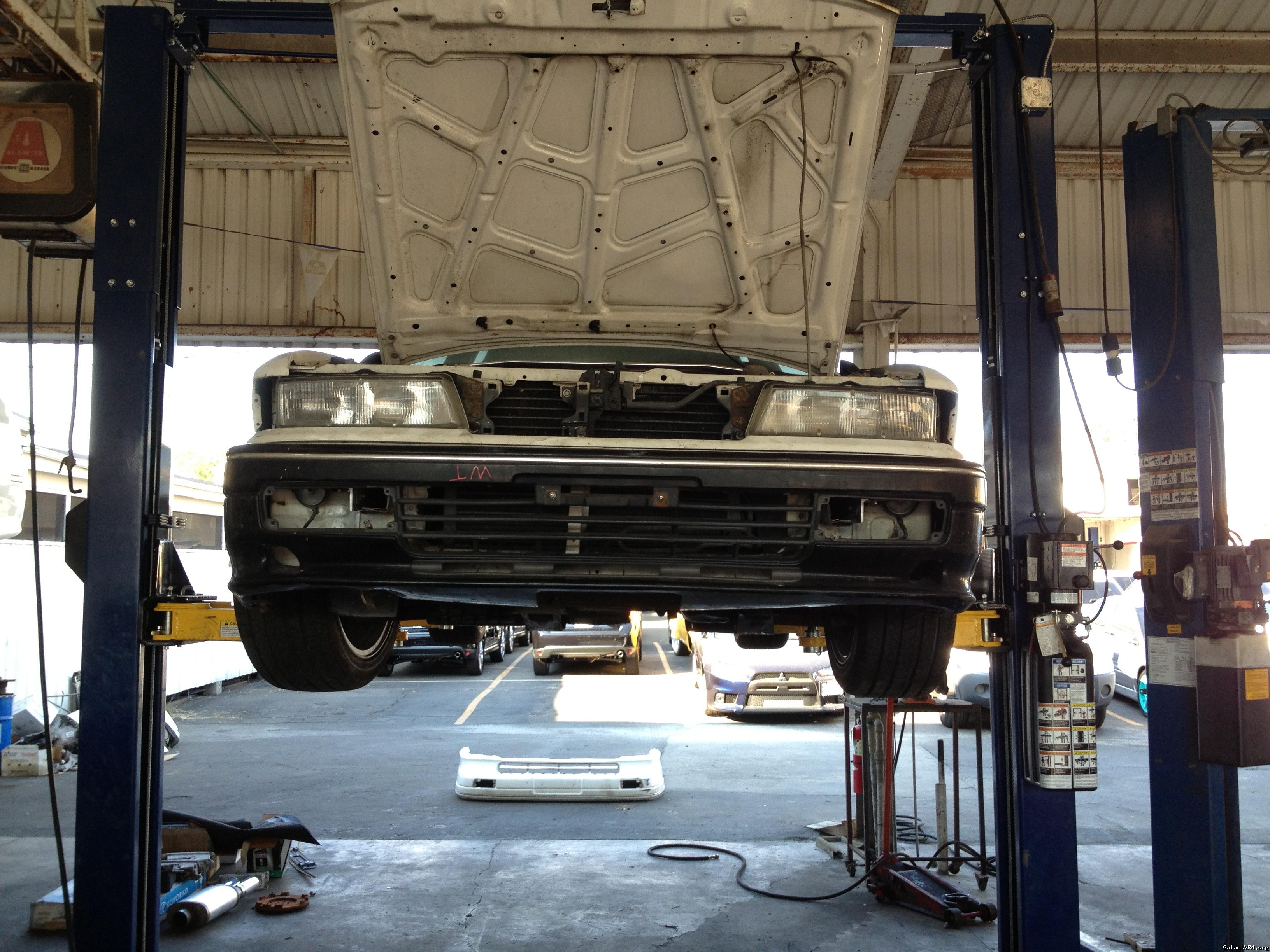

After some time he moved to a different dealership so it went with him. Here is a pic right before work started on it.

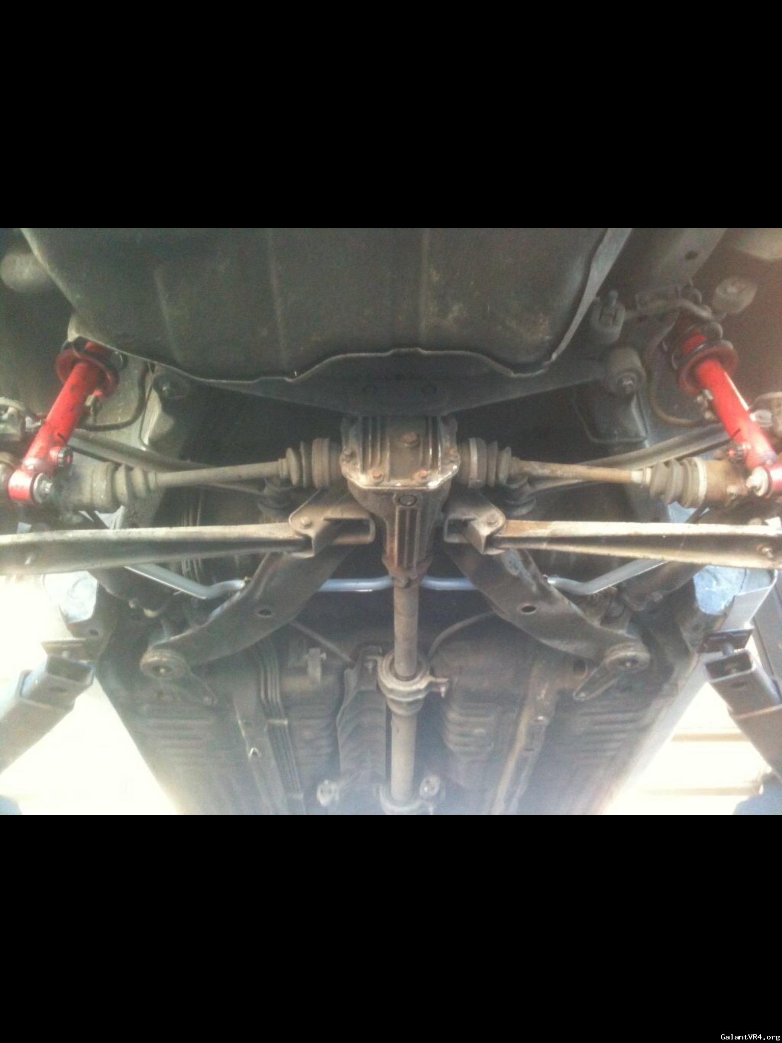

Whiteline rear sway bar (bobdole) in with agx and not sure what springs.

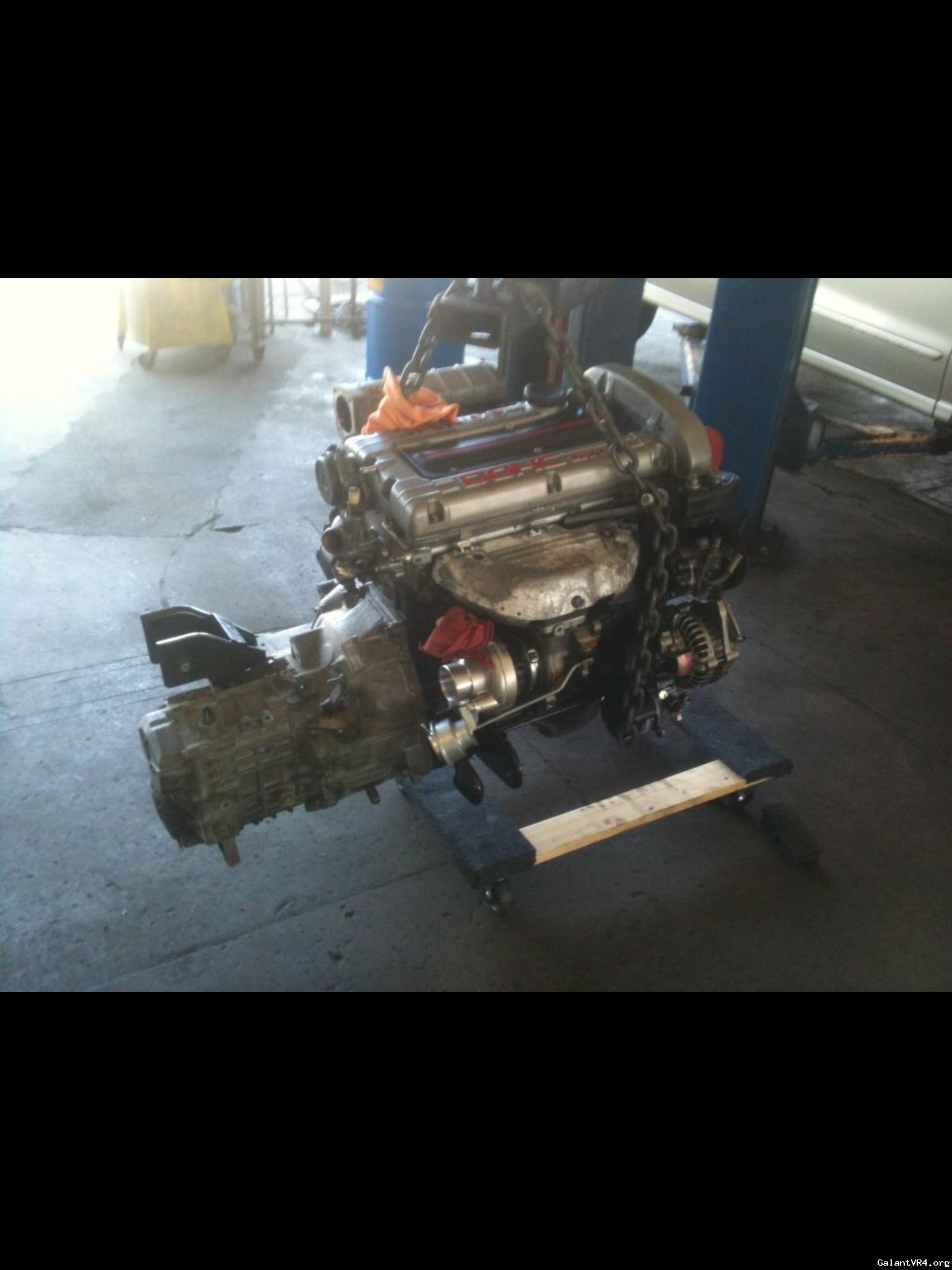

Using the GSX transmission

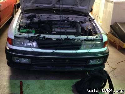

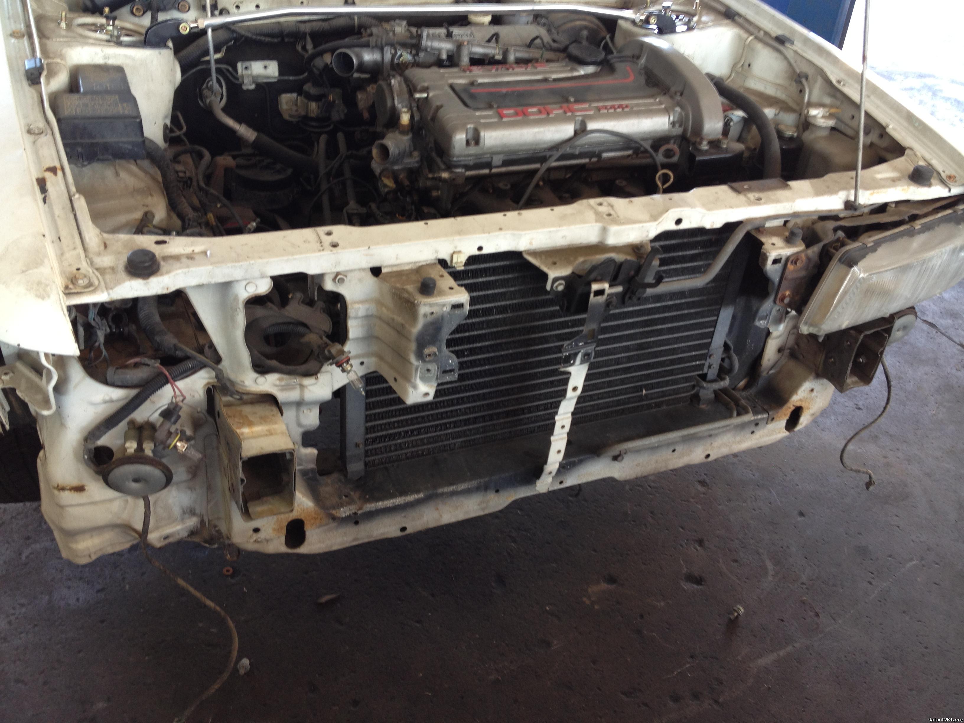

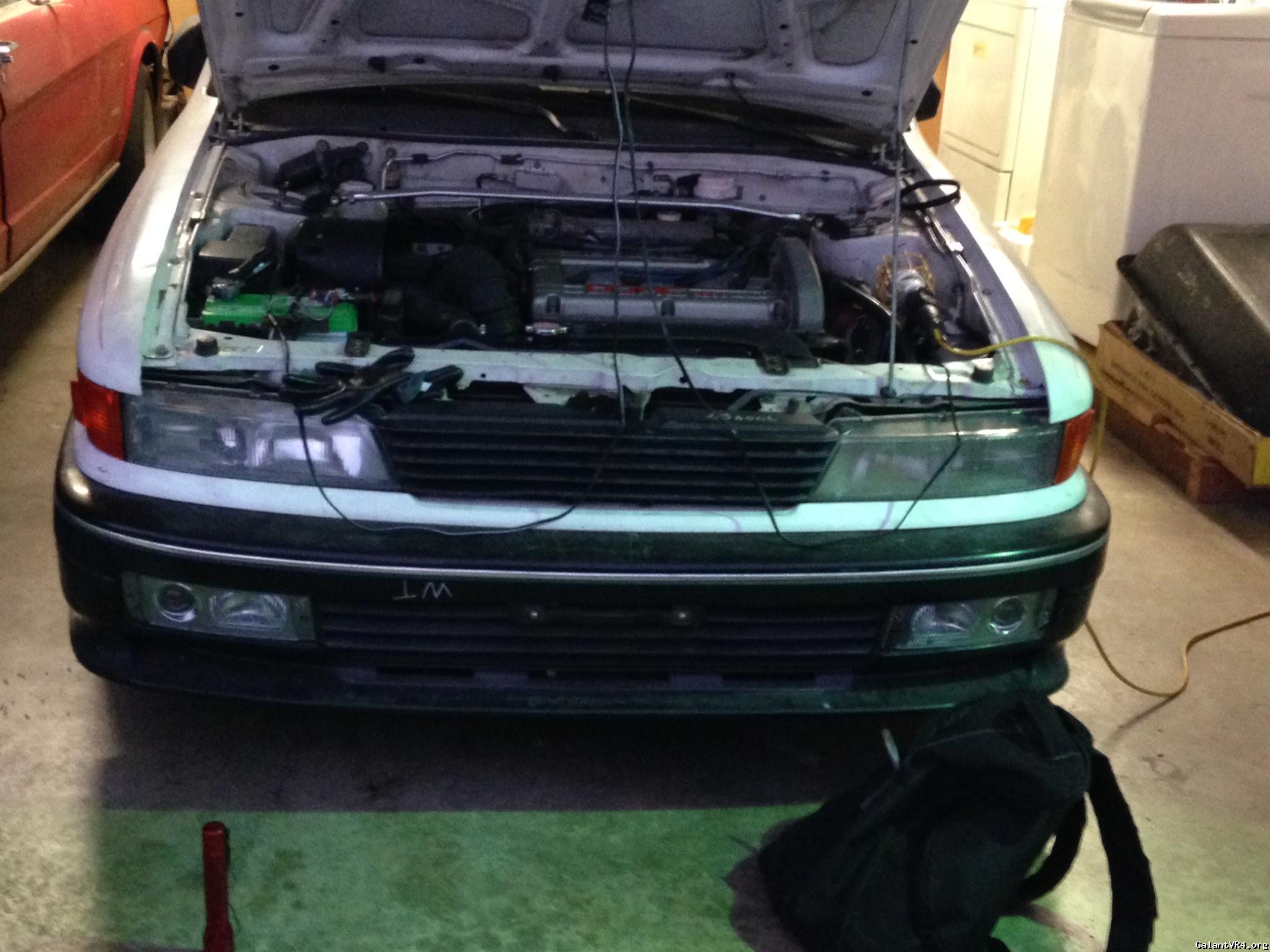

Engine and transmission are in! Ecu from DSMchips chipped for Evo 3 16g, Evo 8 injectors, and Evo 8 mas (can't remember the others)

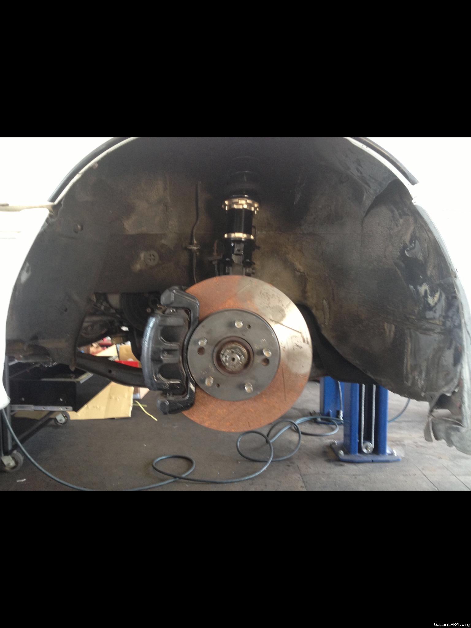

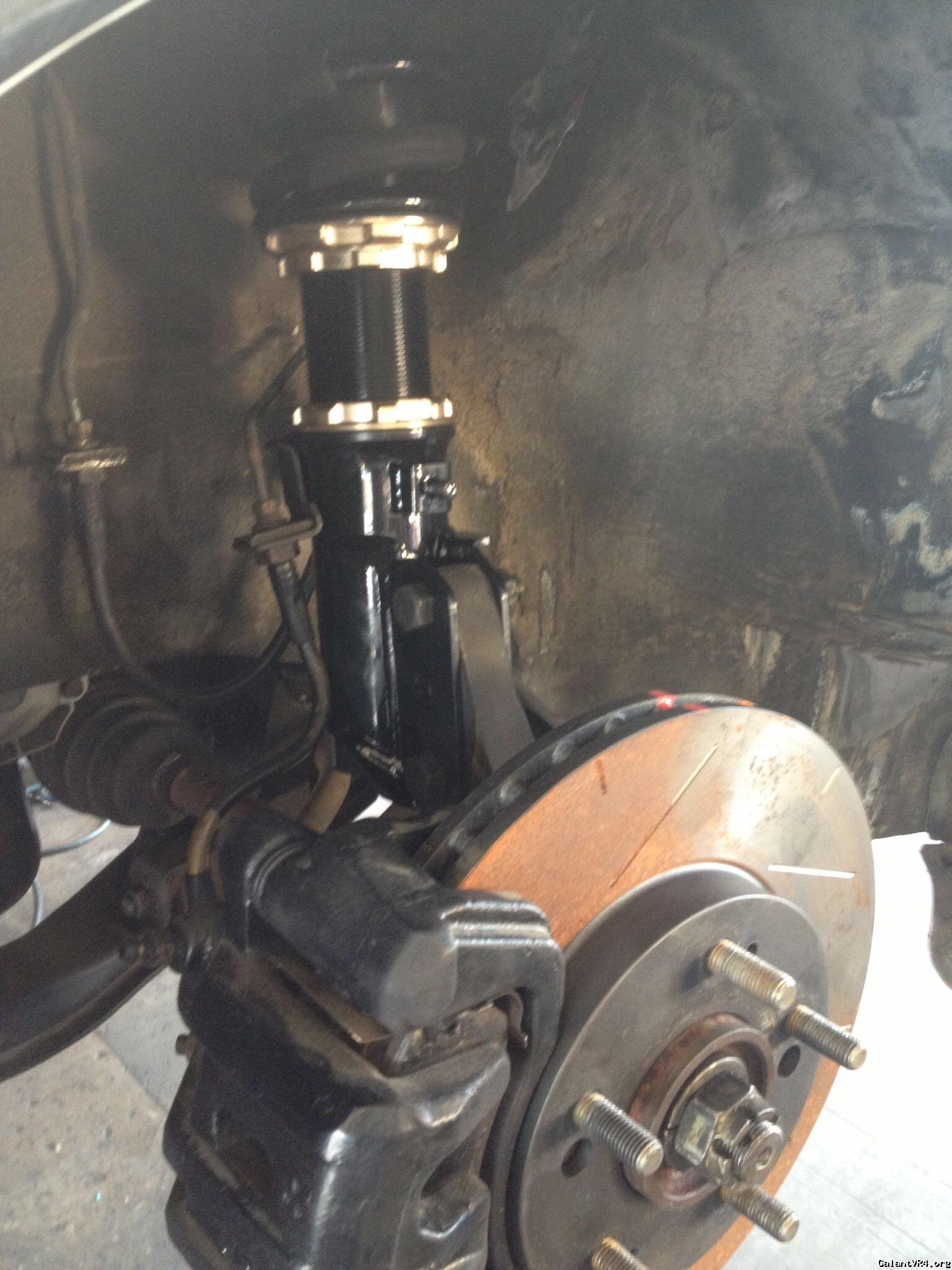

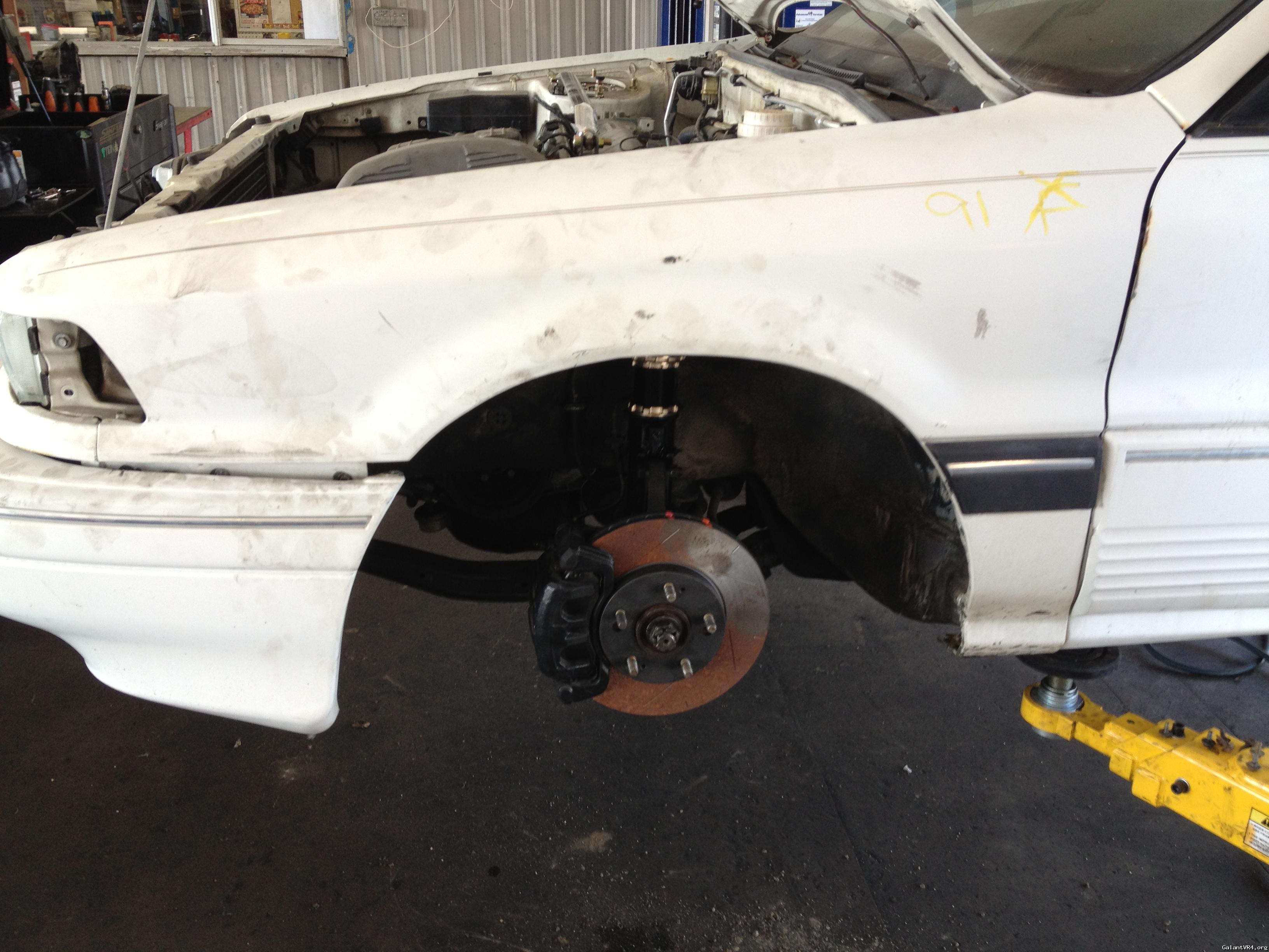

Ended up picking up 5 lug setup with fwd spindles and upgraded to vr4 dual piston calipers with dbs slotted rotors from JSchleim18's part out. Oh and changed my mind on suspension and got some BC coilovers (thanks bobdole!) Bearings and seals replaced.
Driver side fender was trashed, so got a replacement at junk yard

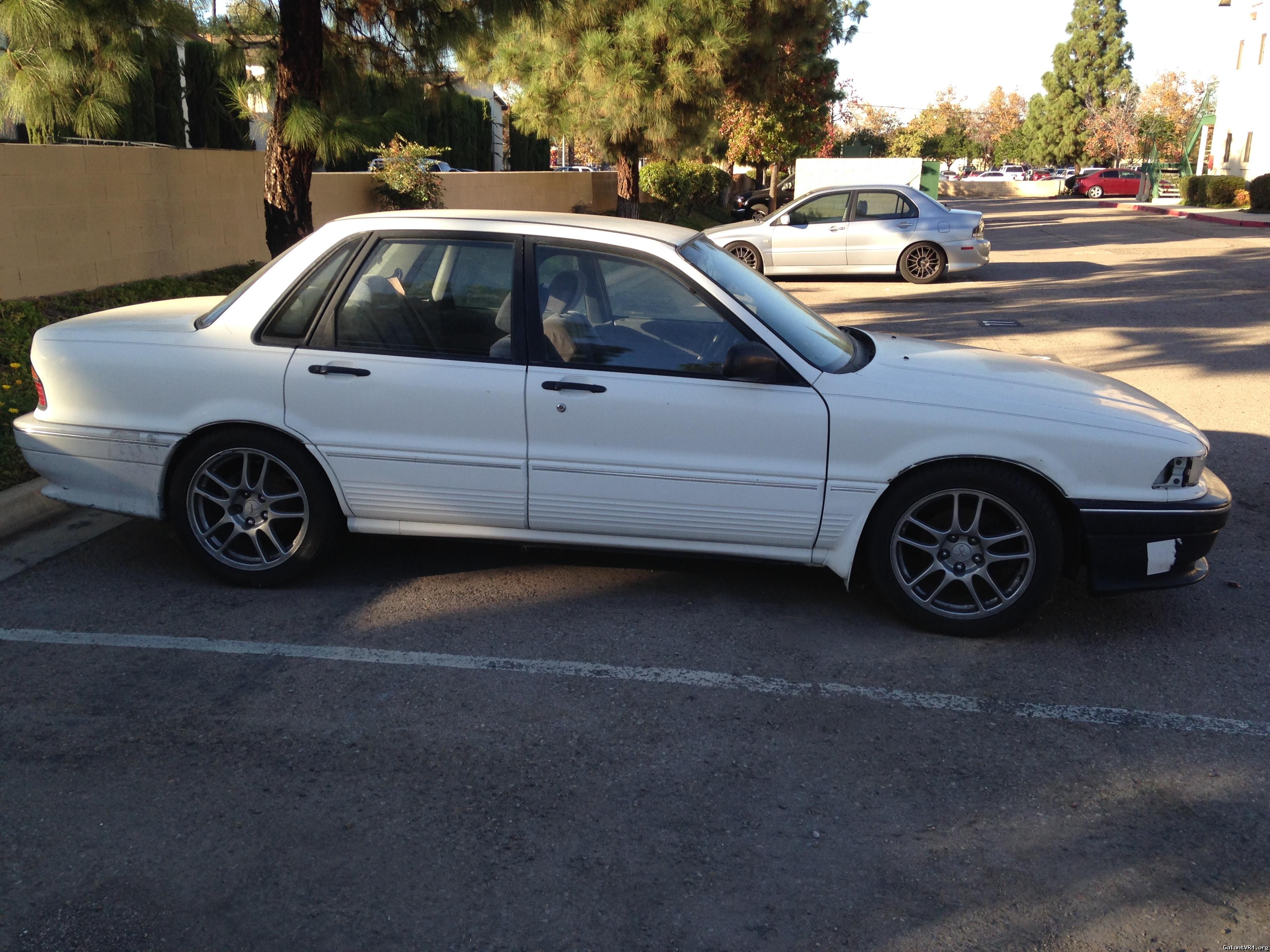

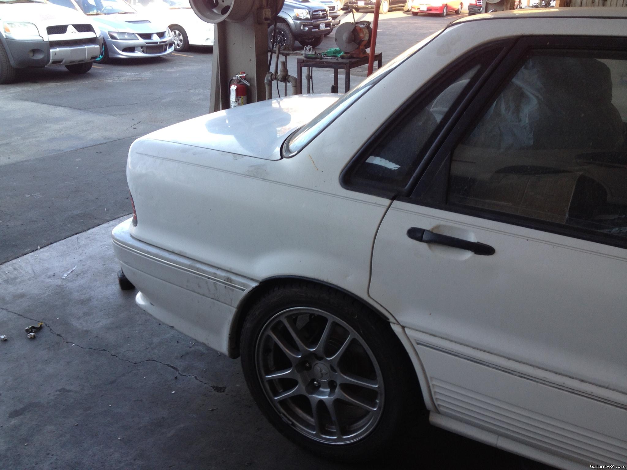

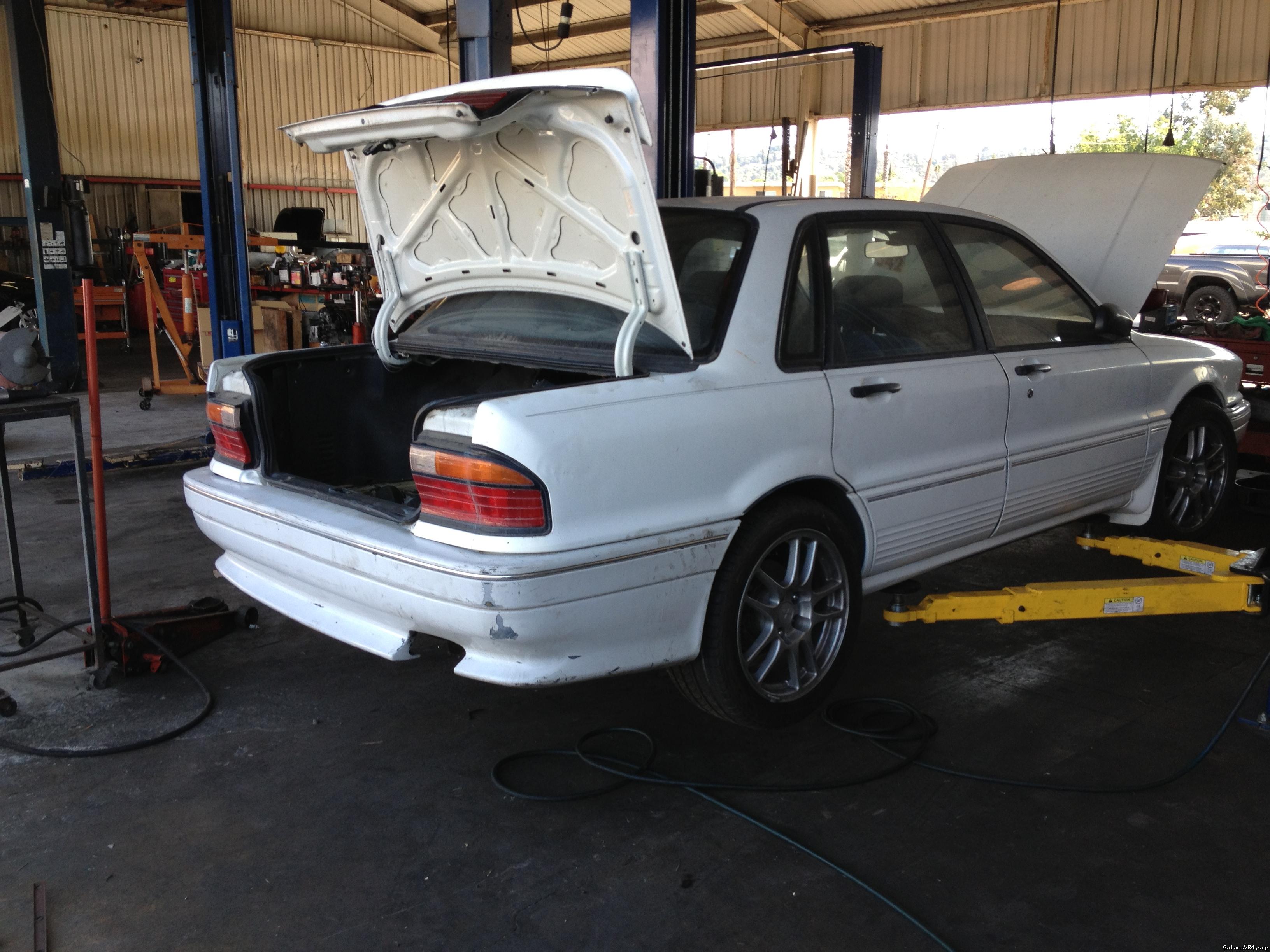

I got a set of BBS Evo wheels for cheap for my IX so the galant got the enkei wheels. And a wingless trunk waiting to go on.

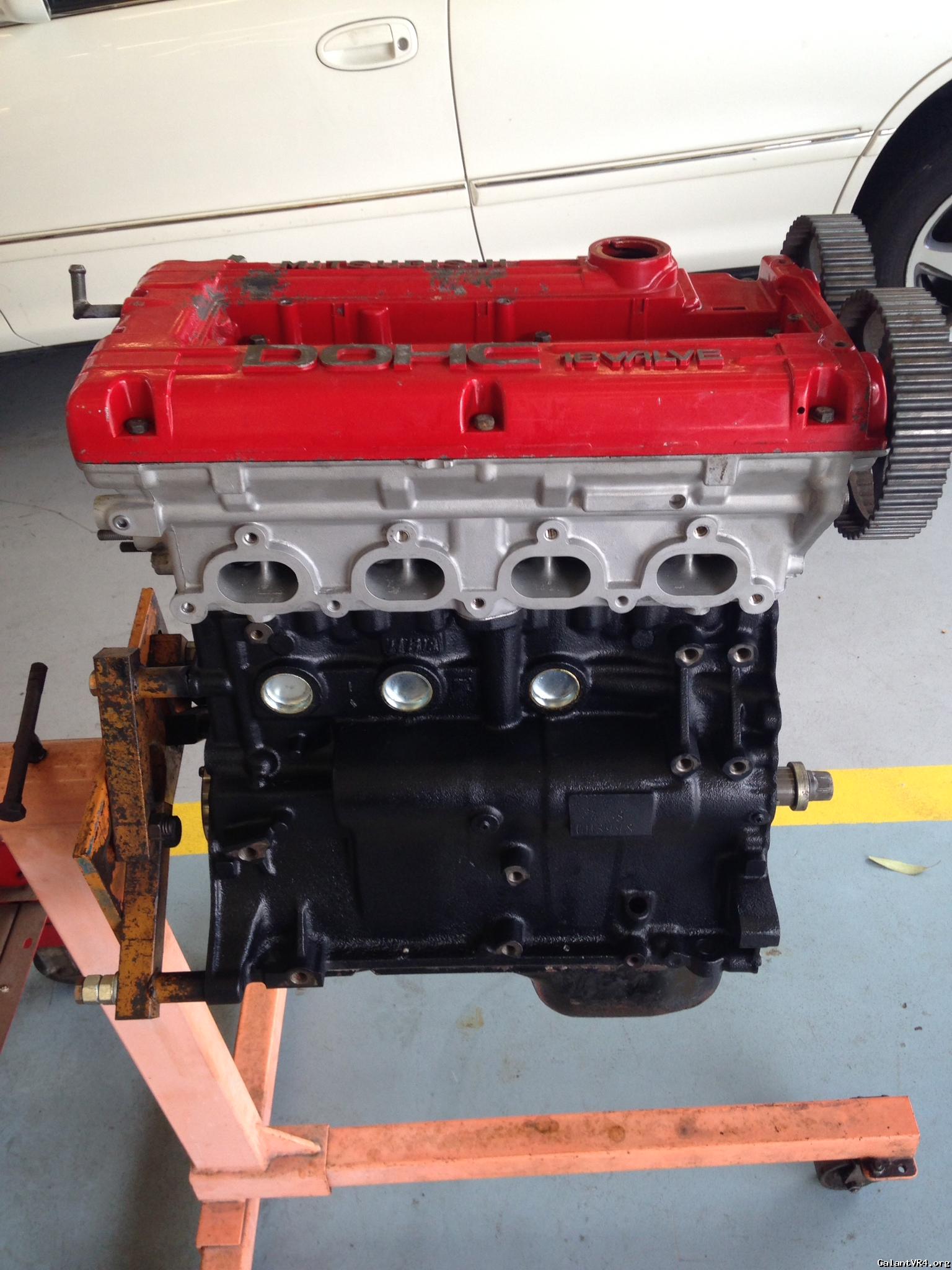

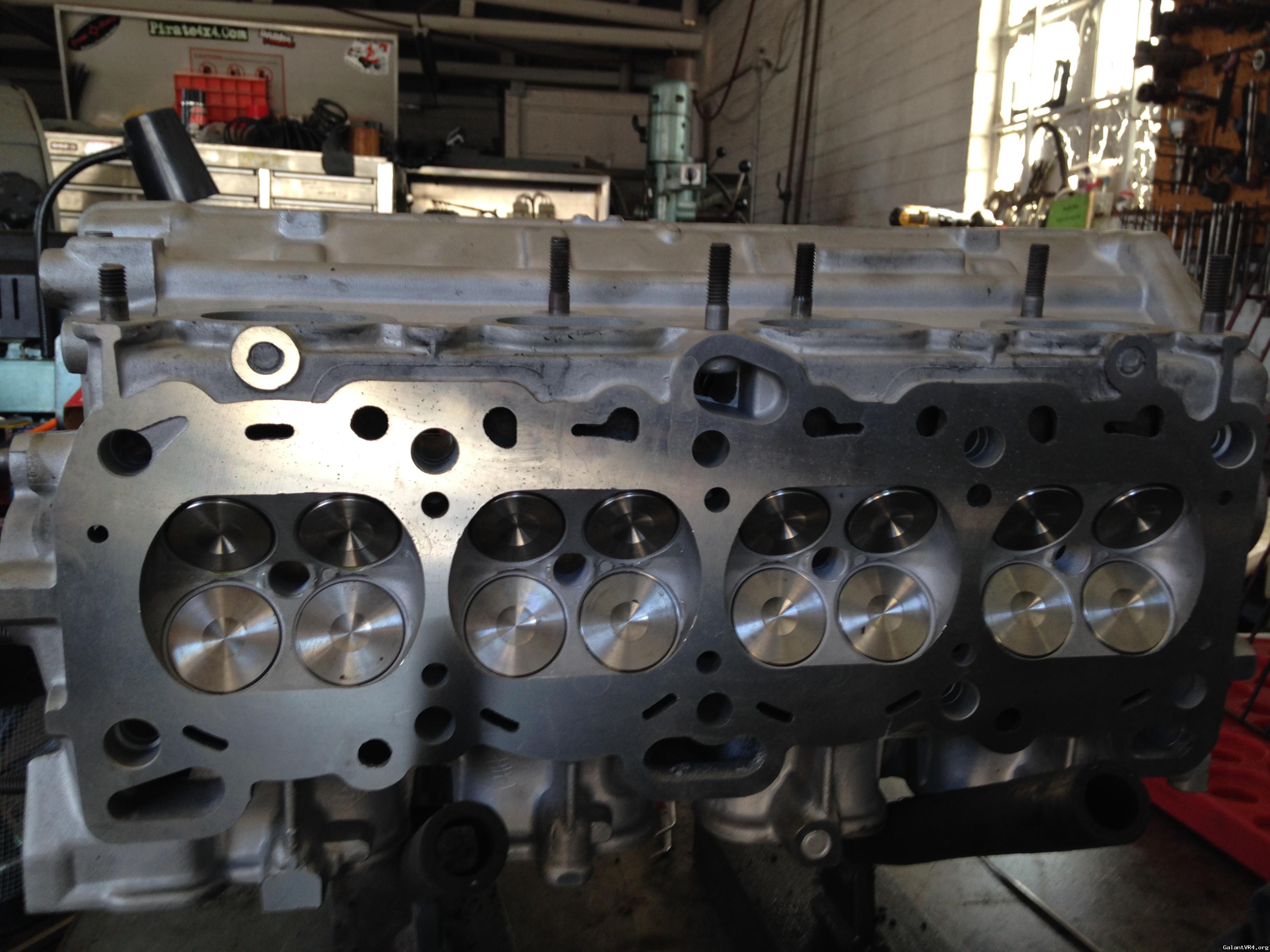

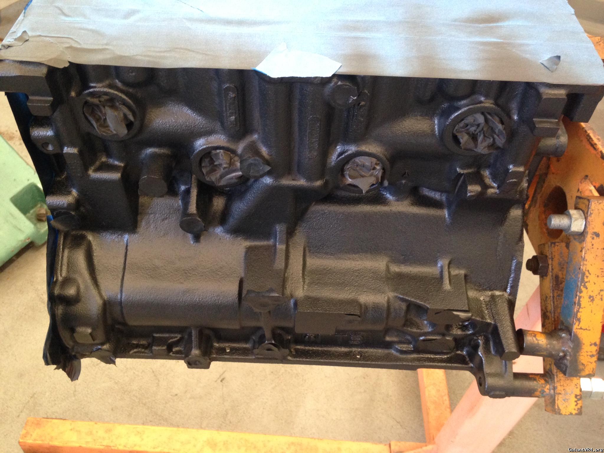

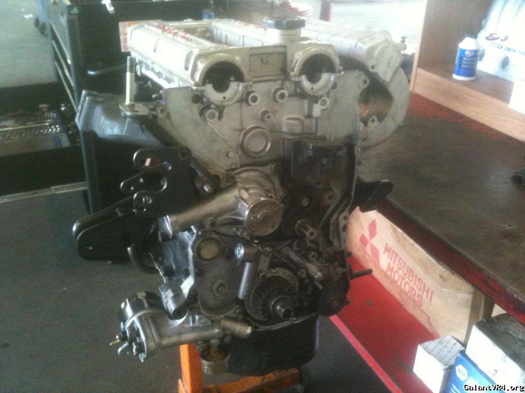

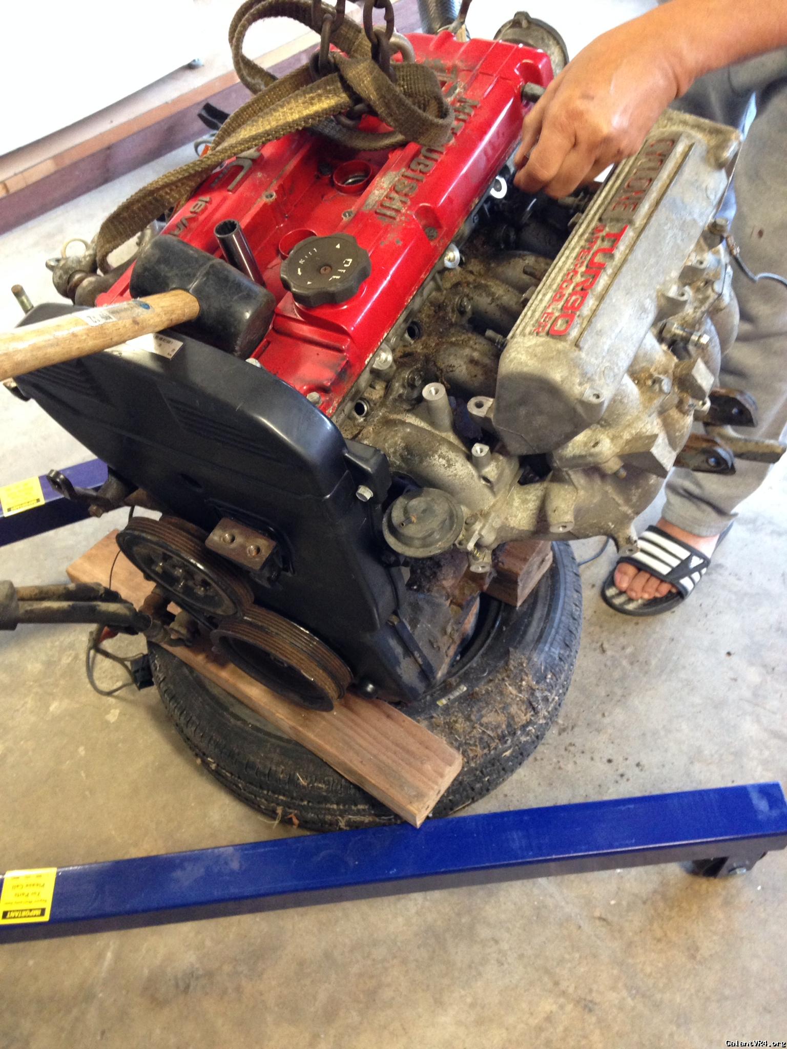

During this time got a spare engine and attempted to rebuild it in a engine rebuilding class

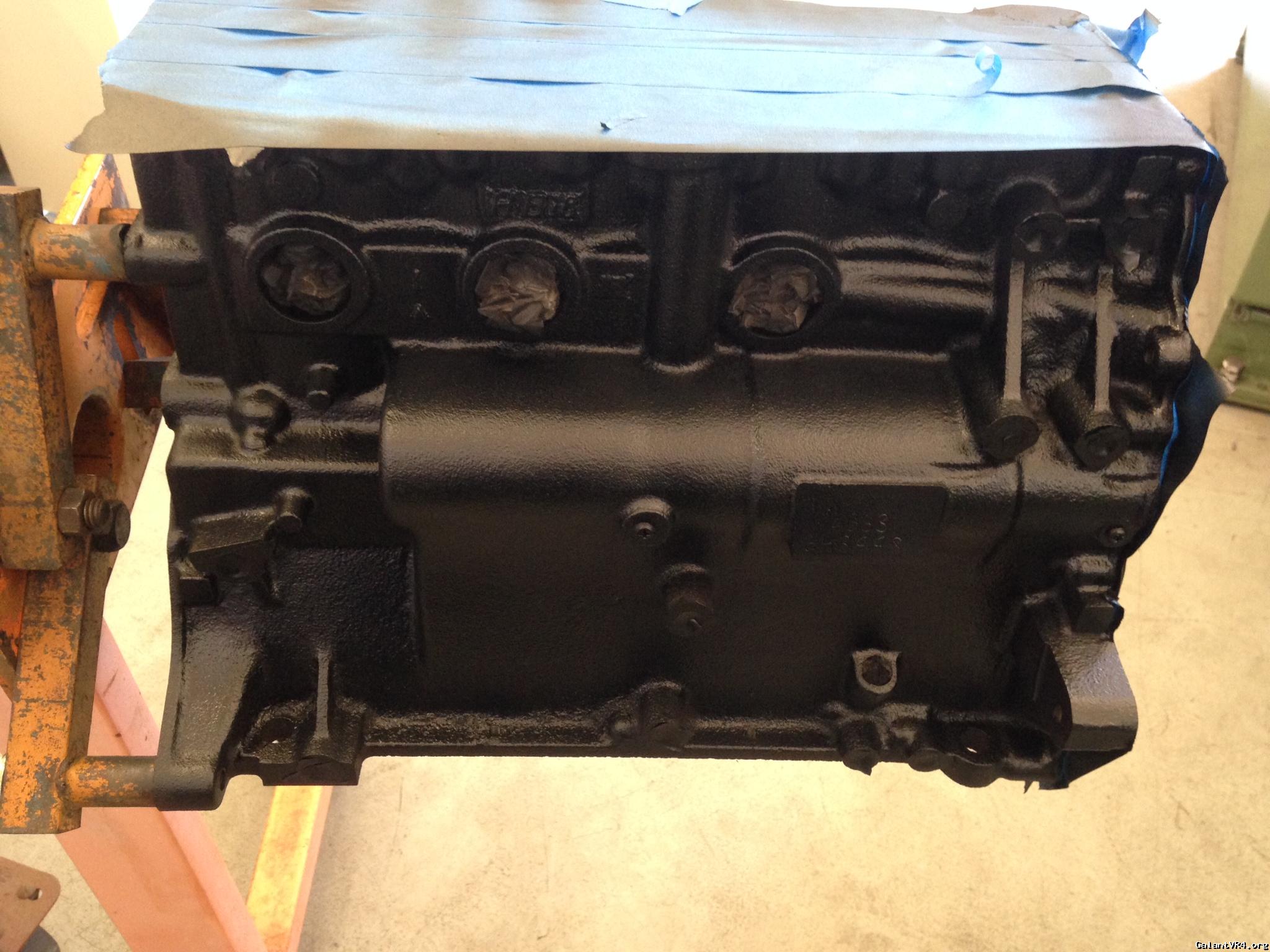

Painted and baked the block but thinking I should have done a different color!

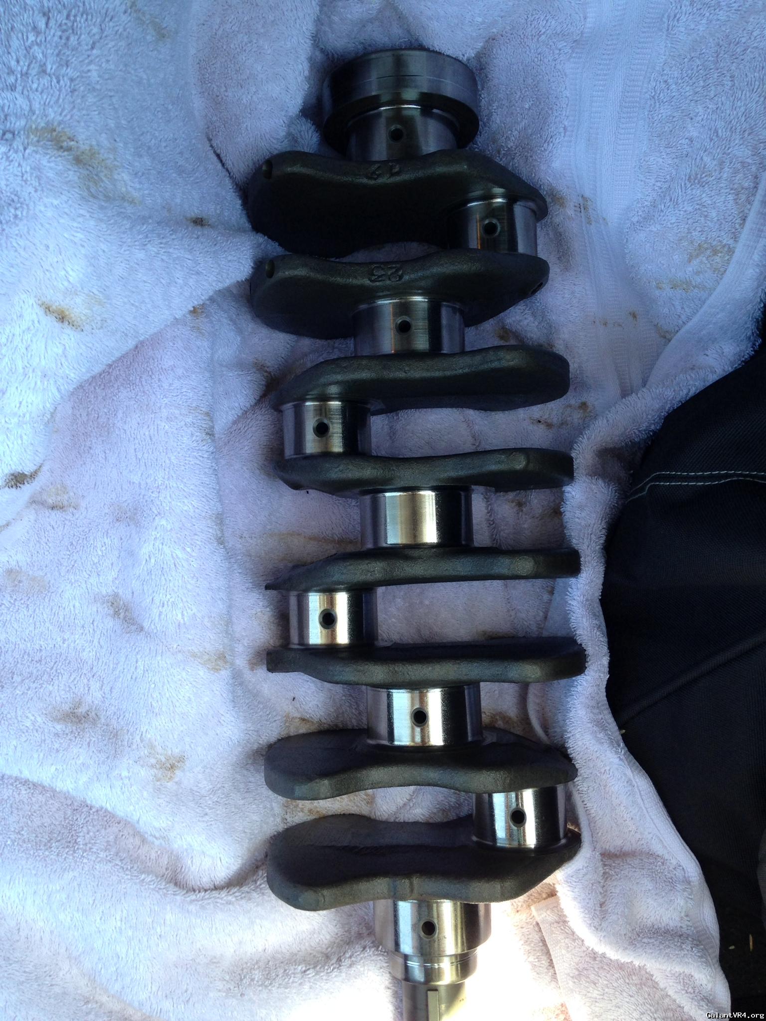

Polished the crank

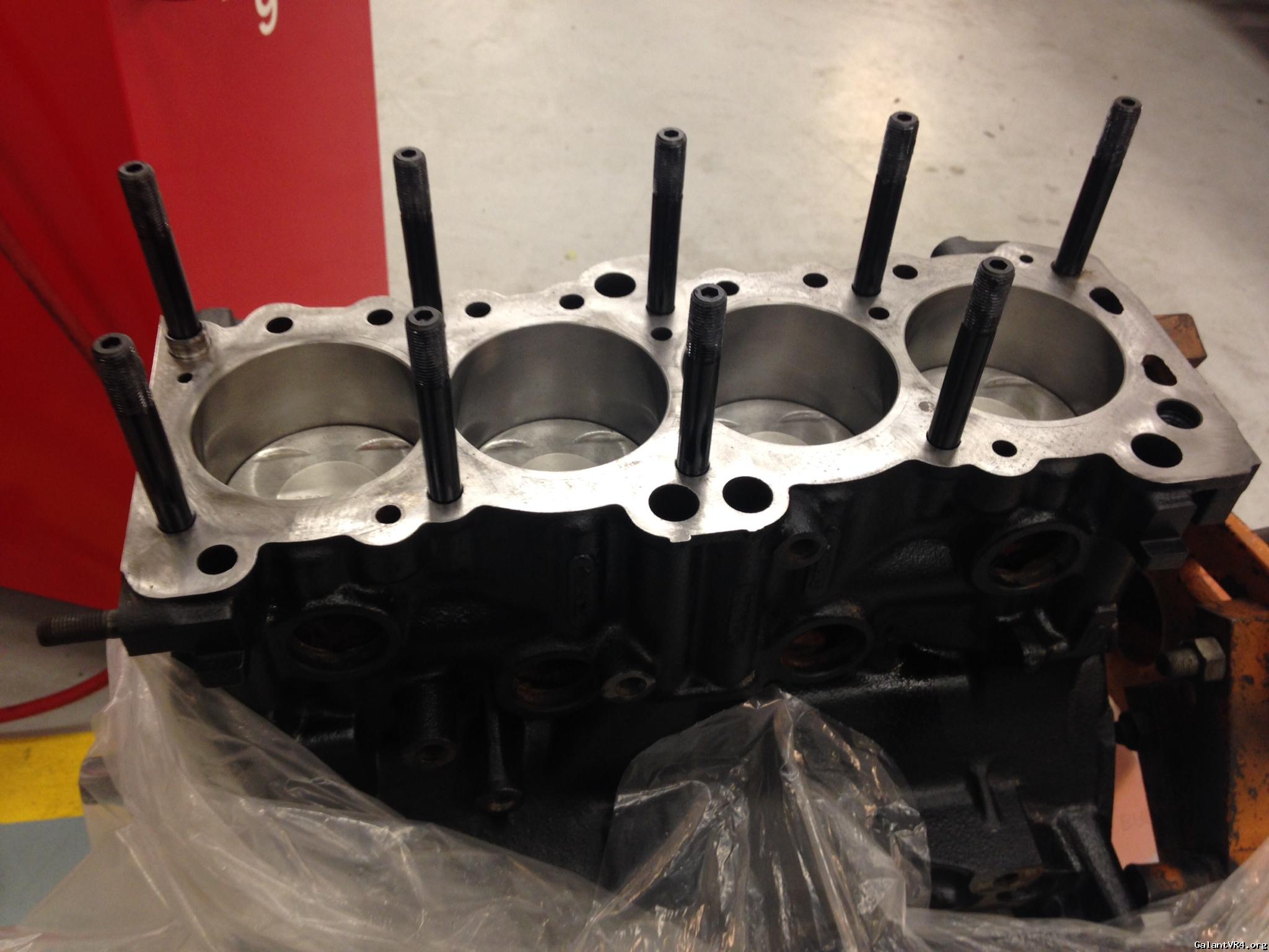

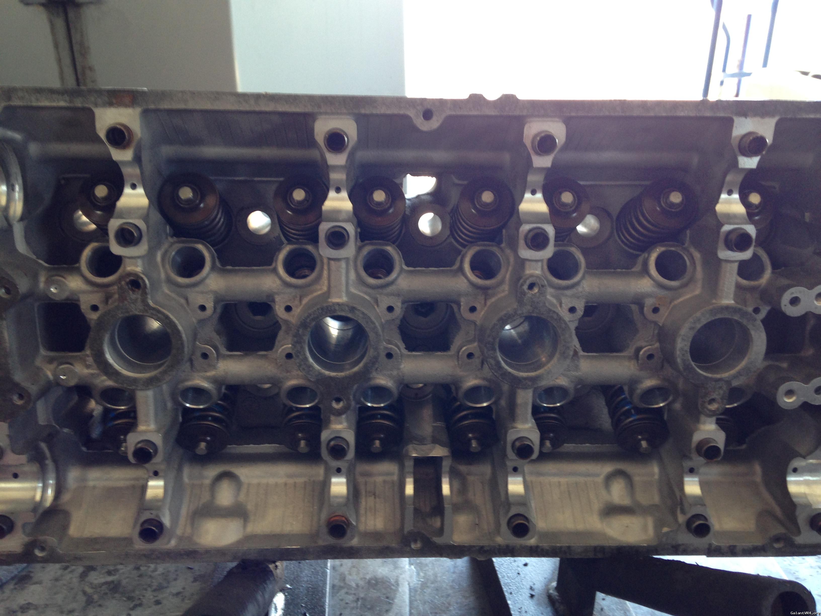

So went with parts from Dale bogusSVO like stainless valves, NPR pistons 0.020 over, arp studs, BC springs, viton valve stem seals, new rod and main bearings can't remember the brand, and can't remember the others parts but also got tons from JNZ
So I didn't get any pics of the bottom end cause I broke a total of 3 rings. 2 in cylinder 2 and 1 in cylinder 3. I think it was shitty tools I should have bought my own. But here is a pic of I believe to be cylinder 2. So this engine is on the back burner for now till I figure out what I will do with it.

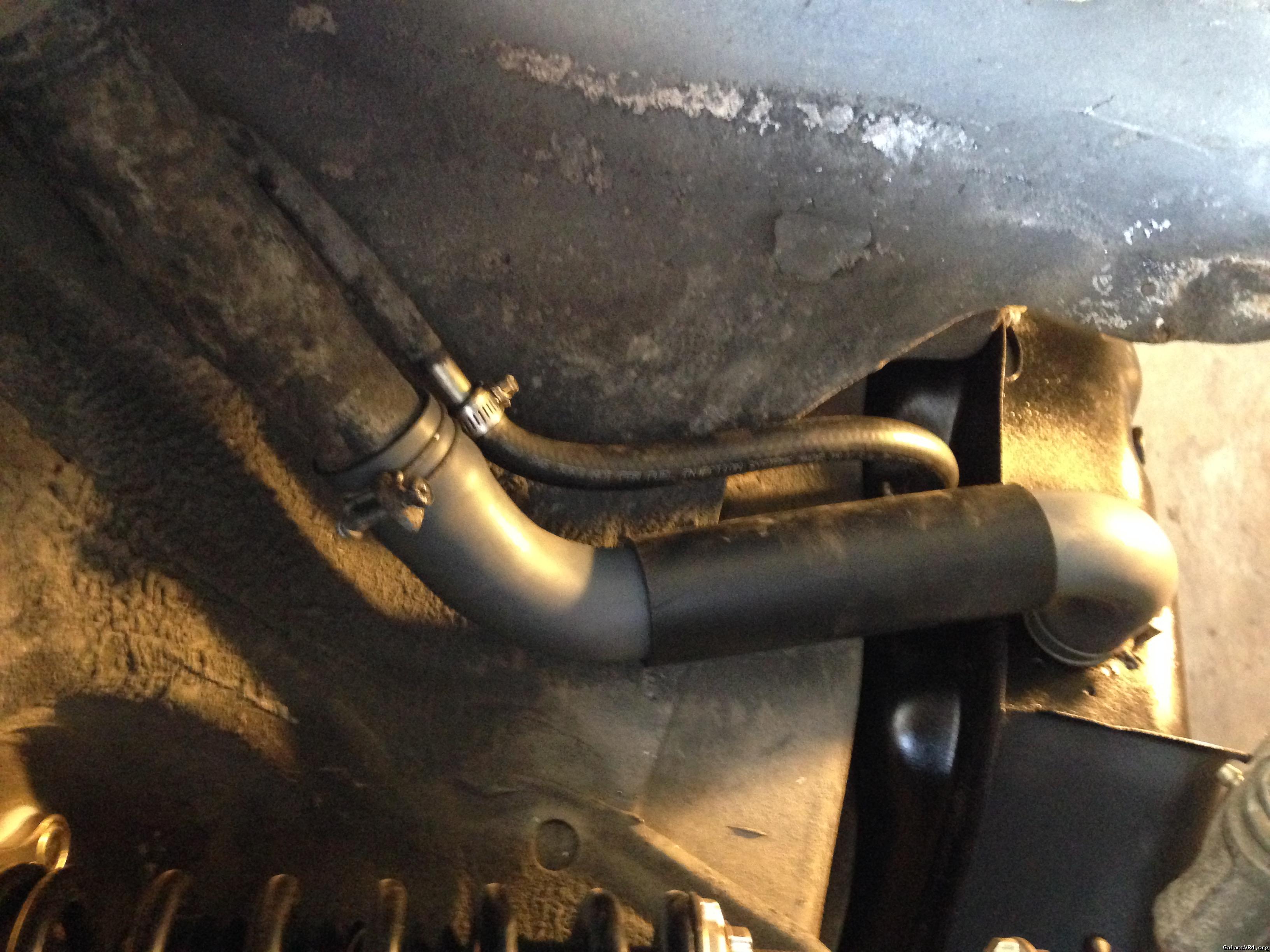

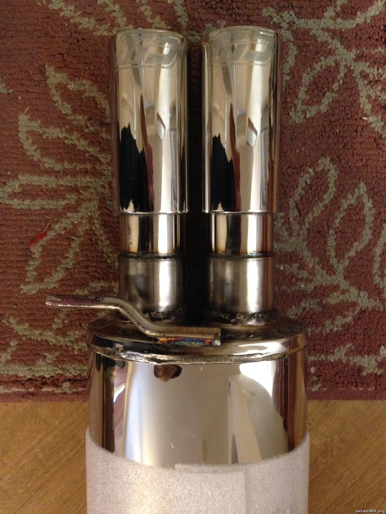

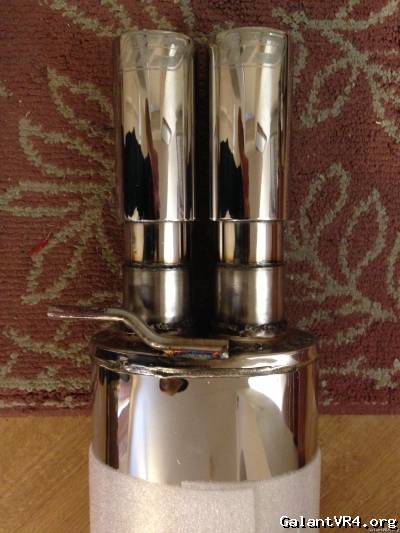

Got a CMPE 3in turbo back

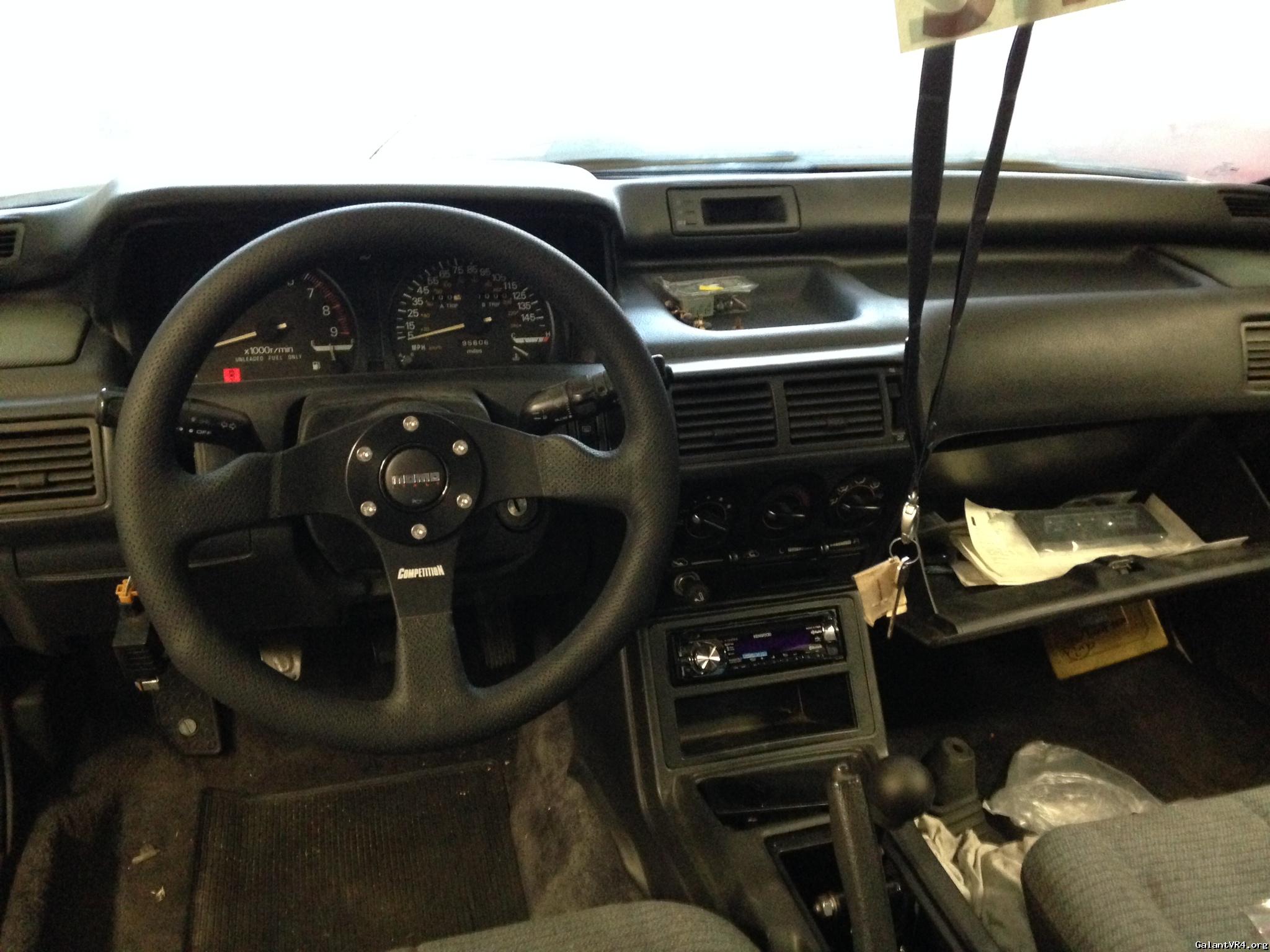

Got a Momo steering wheel and ken wood radio as a gift. Also installed JNZ short shifter.
Installed 89 underdash and glove box but no pics.

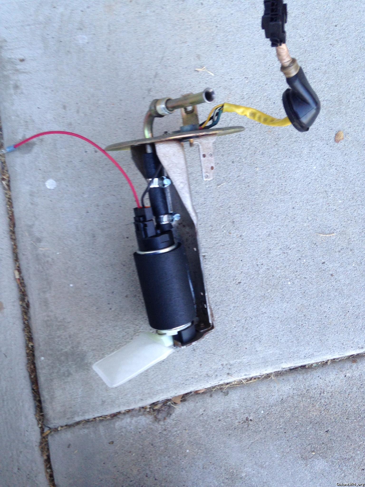

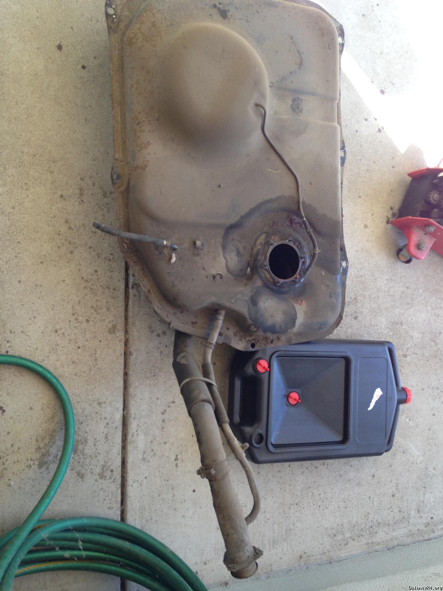

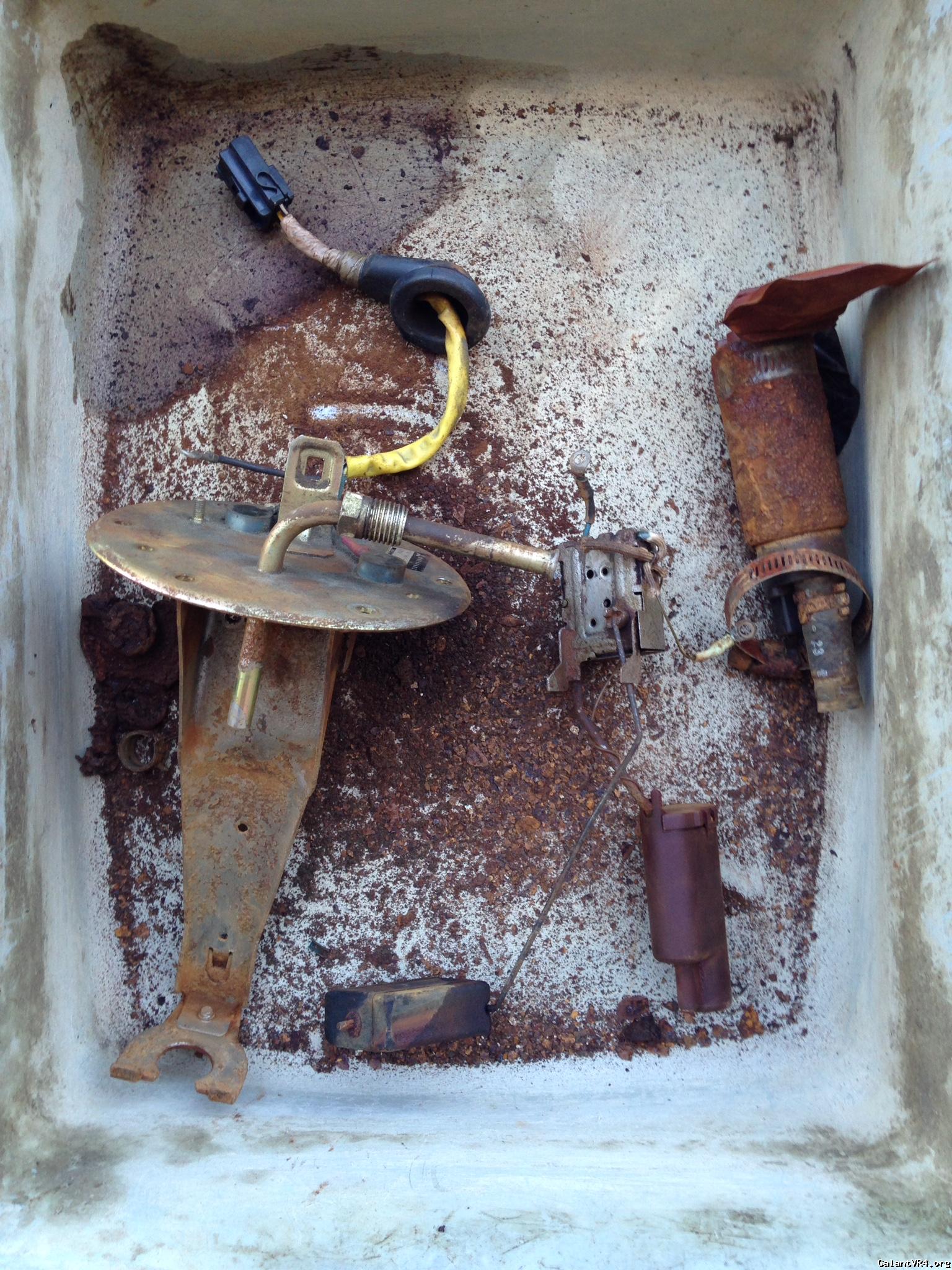

Started working to get the galant started and it would only crank. So took a peek at the fuel pump and here it is.

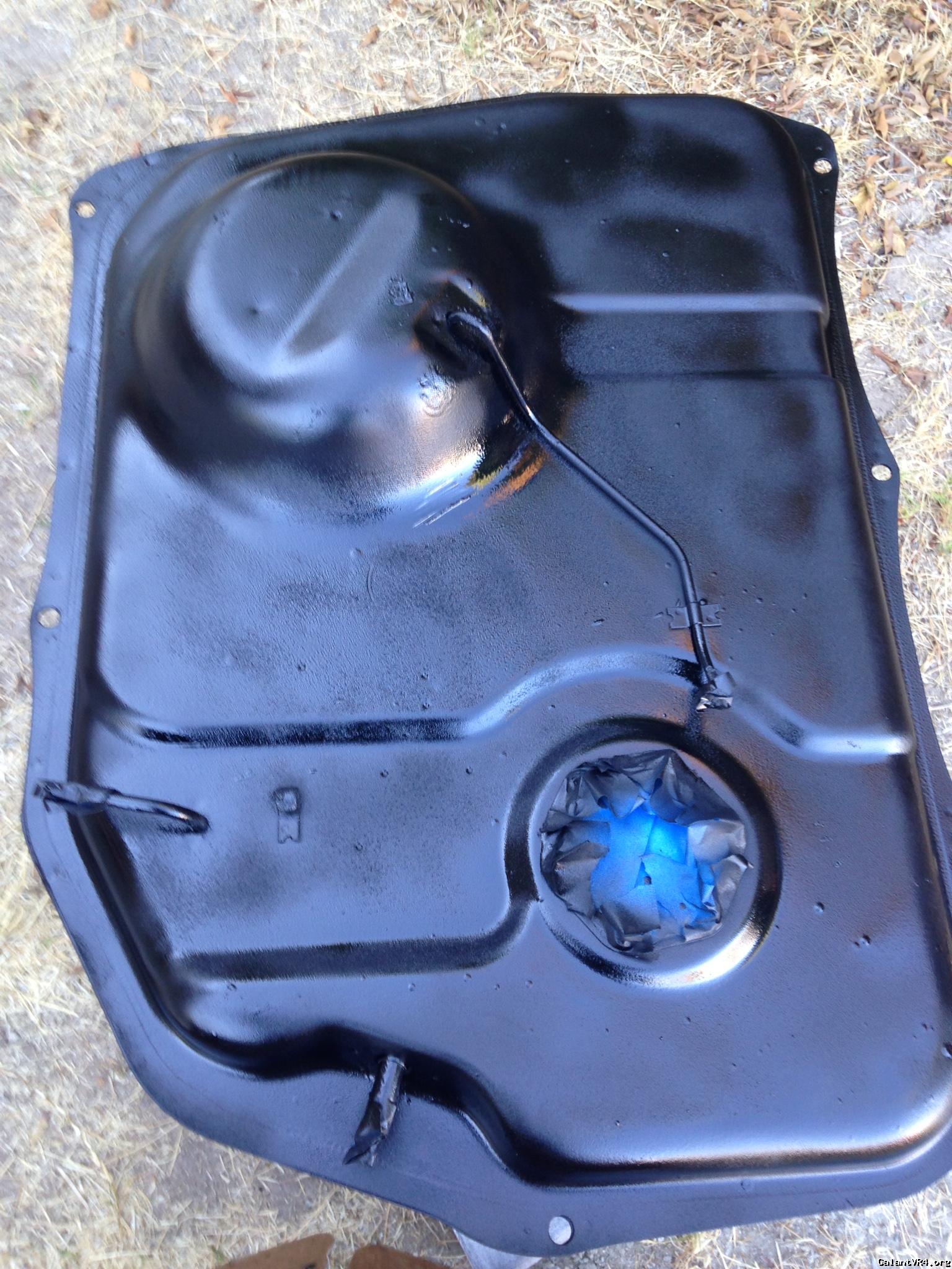

So emptied the tank and dropped it off at a radiator shop to get acid dip, cleaned out and recoated.
Got the tank back after a couple weeks.
Painted the tank with a couple cans of epoxy paint
New filler hose and cleaned the fuel hanger then put on a walbro 255 form JNZ.

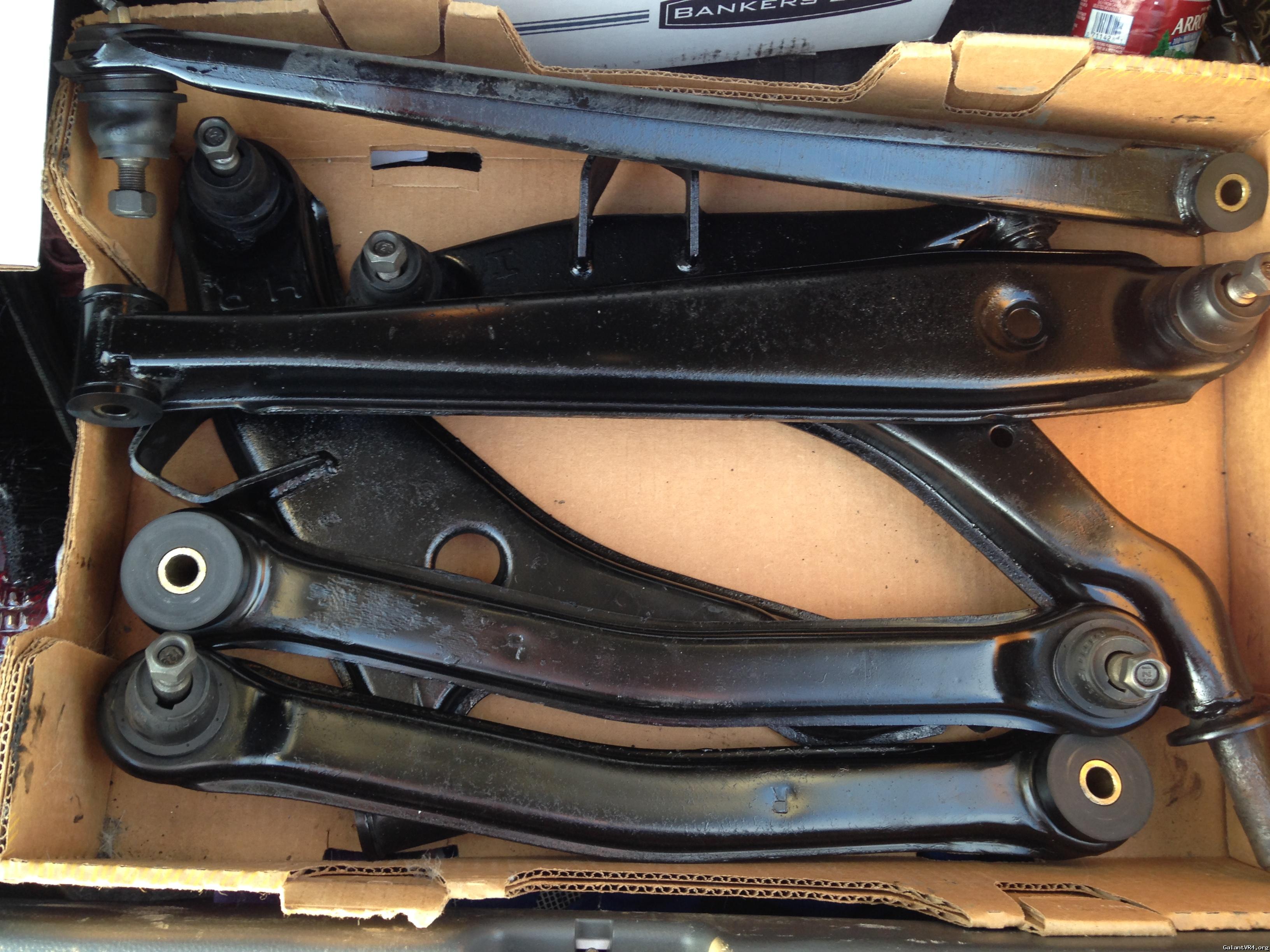

Then pulled all the control arms. Had new bushings and balljoints pressed in. And painted the control arms with epoxy paint.

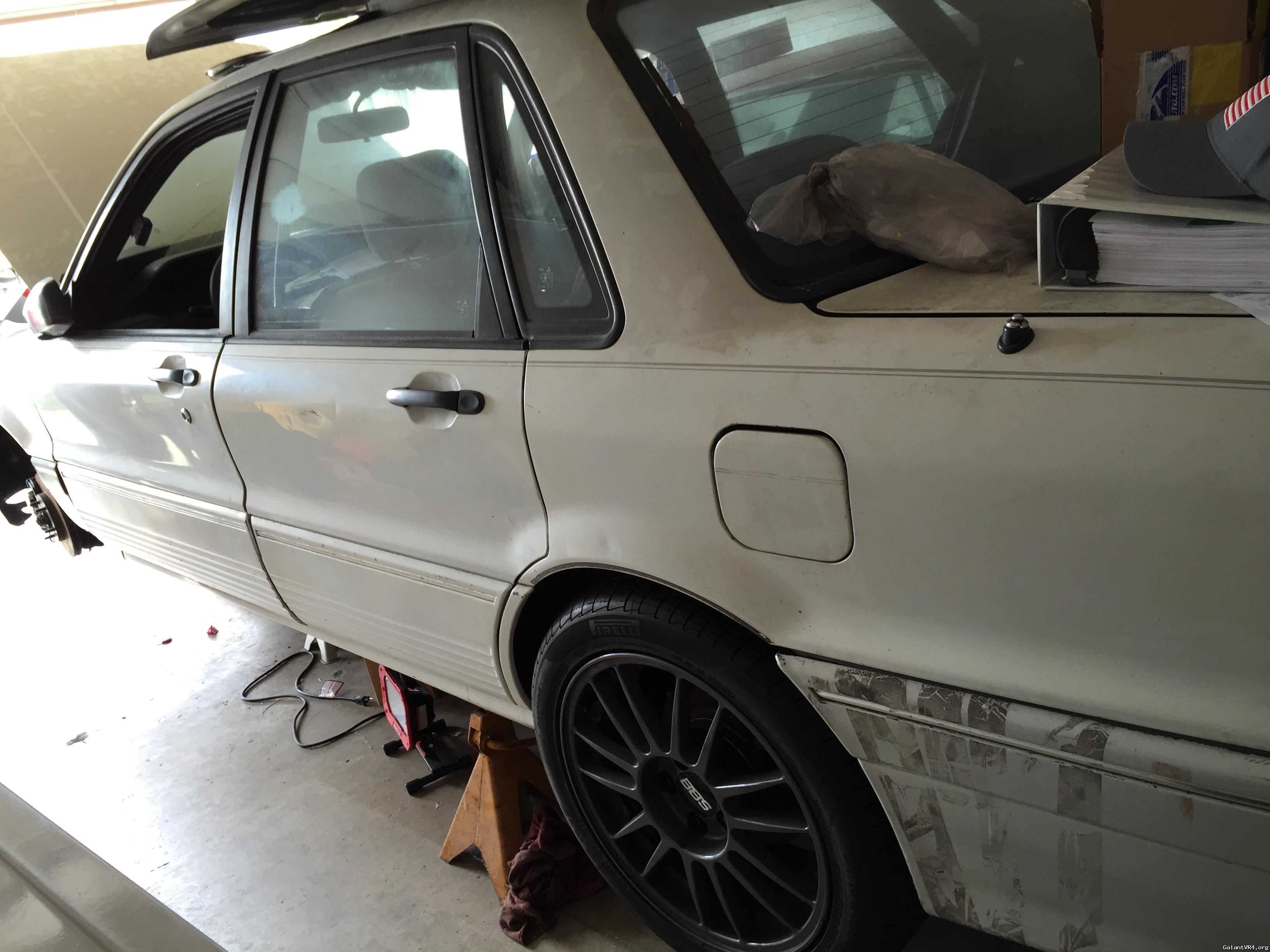

While the front control arms were out I pulled the steering rack that was junk and tried to put in a new steering rack I had. But could not so the car sat for a couple months while I attempted multiple time to put in the rack. So in that time my Evo had the front seats stolen and vandalized, so I pulled the BBS with new tires off the Evo and they are now on the galant.
