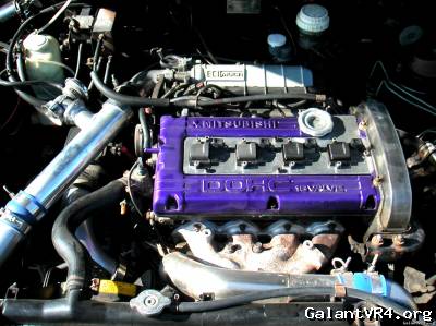

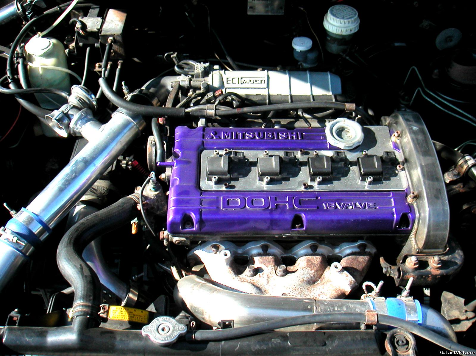

Just going through 957 that i picked up couple weeks ago. Wanted to ask the org what they'd do to tidy up/fiddle this engine bay, or if they see anything glaringly wrong. I've also never seen the intake routed that far back.

Get a heat shield for that exhaust manifold. Your BOV needs to be recirculated as well, or purchase a proper blow through setup.
Besides that, get a non-cruise cable if you can live without it.

Either get a better exhaust manifold or get a nice heat shield, then change the intake manifold, then an HKS timing belt to match the purple valve cover if that's the color you wanna keep. Not necessary but an all aluminum radiatior would also be nice.

oh jeez, the bov never really caught my eye...the isc/idling has been the primary concern right off the bat..thanks for the note. heat shield is on my original list to get. is there a reason for the cruise cable removal or just for cleaning up space?

can you explain about changing the intake manifold? also down the line im pretty sure that purple will be changed, definitely not a color i wanted.

I see mention of an intake manifold. I don't see anything wrong with that one. SMIMs are a little expensive, might cause problems with passing visual inspection for emissions, and require some modification to the intercooler plumbing, since they generally lower the throttle body significantly. Sometimes this can be quite the undertaking. It's definitely not just a "bolt it in and go" type of mod, from what i've seen. I'm in full agreement on the exhaust manifold or heat shield, though.
I'd FIRST fix the wiring on top of the water neck. It looks atrocious and the pigtails can be had at junkyards for basically the price of admission. If you need one that's not crispy, take one from a radiator coolant temp sensor. Those wires are usually in good shape.
The oil cap looks horrendous, so i'd replace that "HELP!" oil cap from VatoZone with something decent looking.
I'm not sure why your throttle cable is taking a dive at the end of the fuel rail, but that doesn't look too kosher. Looks like it would cause some resistance, at the very least. I'd prefer to have it straightened out a bit. A non cruise cable is a good idea, as was mentioned. Personally, I don't much care for the miniscule reservoir on the clutch master cylinder. I'd replace it with one from a DSM, if it were my car. The L shaped engine mount bracket could use cleaning up and re-painting.
I can't really see anything else.

Removing the cruise control is mostly for space savings and if you never use it, "why keep it?" sort of thing. I never liked cruise control, even on long trips I didn't use it. The bpv like others mention needs to be recirculated, unless you are running a blow through setup (GM Maf) or you have converted to speed density.
The routing for the intake intercooler piping is normal. I agree though, there is no reason to change the intake manifold, most do it for bling factor IMO (how many people actually require the need for a smim?). Changing to the HKS timing belt just for color matching is a waste of money, but you already mentioned that valve cover color won't be staying.

Although you can't really see it in your picture, an ABS delete really cleans the engine bay up too. I found the lines and prop valve for $5 from a local pick and pull. Cruise delete basically serves the same purpose, just less clutter.
The heat shield and BOV recirculation are for function, not just to look pretty though.

i was wondering how you guys were able to see some of these details cause i thought the pic was small, til i realized it blows up more haha.

also is there an easy way to tell if the exhaust manifold is 1g or 2g? i want to make sure to get the right heat shield first time, unless it doesnt matter

I've always referred to is as Sheet Metal Intake Manifold. Runner lengths can vary. The increase in plenum volume is usually the key.
DSM heat shields are the same for 1G/2G. The 2G manifold looks thicker and tighter together at the collector. It's been a long time since I've had one though, so a quick Google picture search would probably help you better.

I'd change too much to list but if you're having idle issues I'd start by testing the coils on the isc. It's an easy test, the problem is new isc's are $135. If I remember. There's a website with drawings and instructions somewhere on the net, just search for it.
Smim has always been known to me as sheet metal intake manifold, specifically the first gen Magnus manifolds.
20/50 weight oil is probably fine for Chicago summers but definitely too thick for winter.

Can clearly see there is a MAF under the IC plumbing. That BOV most definitely needs to be recirculated. I can't believe i missed that.
FYI, i tried running with a 2g maf at the track.. with the BOV recirculated, and without. When it was not recirculated, it added a FULL second to my 1/4 mile ET. I went from mid 13's to mid 14's. It's bad. No matter how much you might like the way it "sounds"... DON'T f***ing DO IT!
