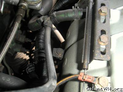

Quoting EMX5636:

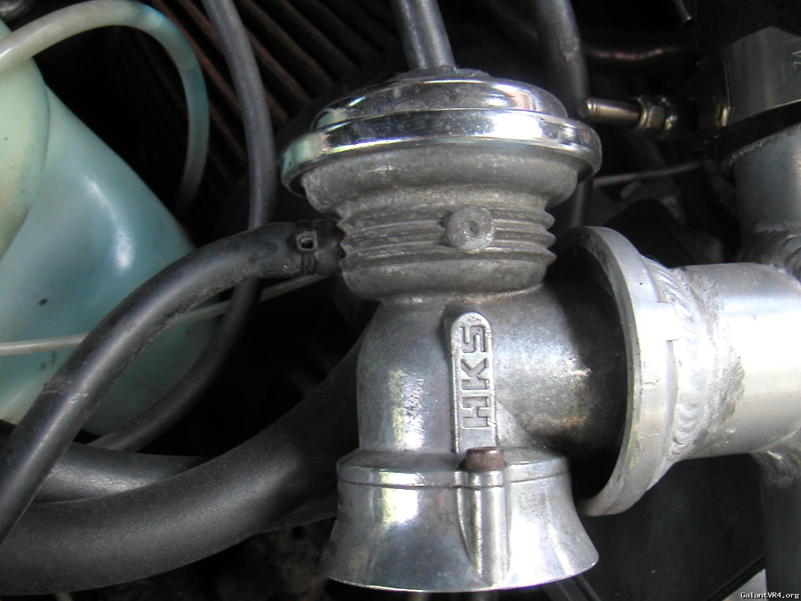

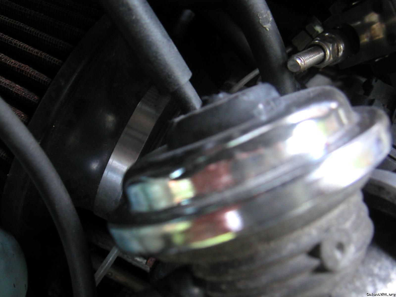

If that's the back of the HKS BOV in your first post, that port doesn't need to be connected to anything. It's to make it "fast acting" like the secondary port on the Greddy Type-S and if you Dodge Garage mod the stock 1G BOV.
hks bov

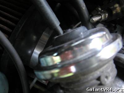

the top of bov where it's busted off
i traced the vacuum hose from the side of the bov, and it is indeed plugged into the intake manifold. i was confused earlier cause i traced it wrong.

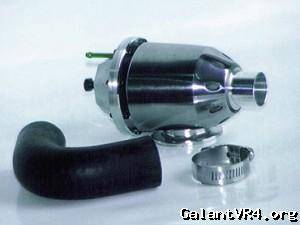

The bov isn't welded. HKS valves install using basically a snap ring. If you want to use a different BOV, you will need a flange welded on. They sell recirculation kits for the newer style HKS valves. Look at this pic, it shows the recirculation kit, and how it attaches to the piping.

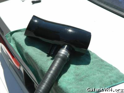

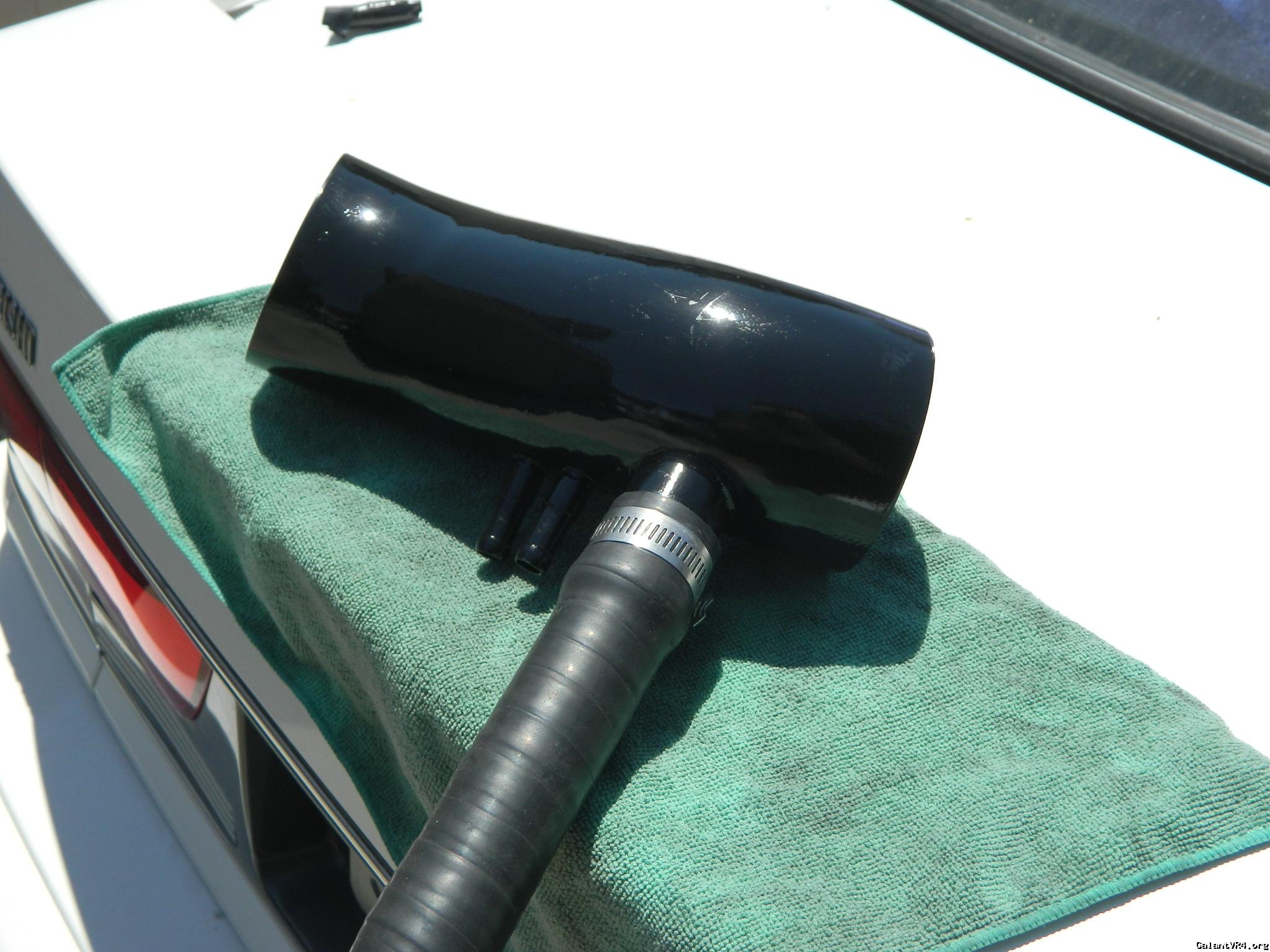

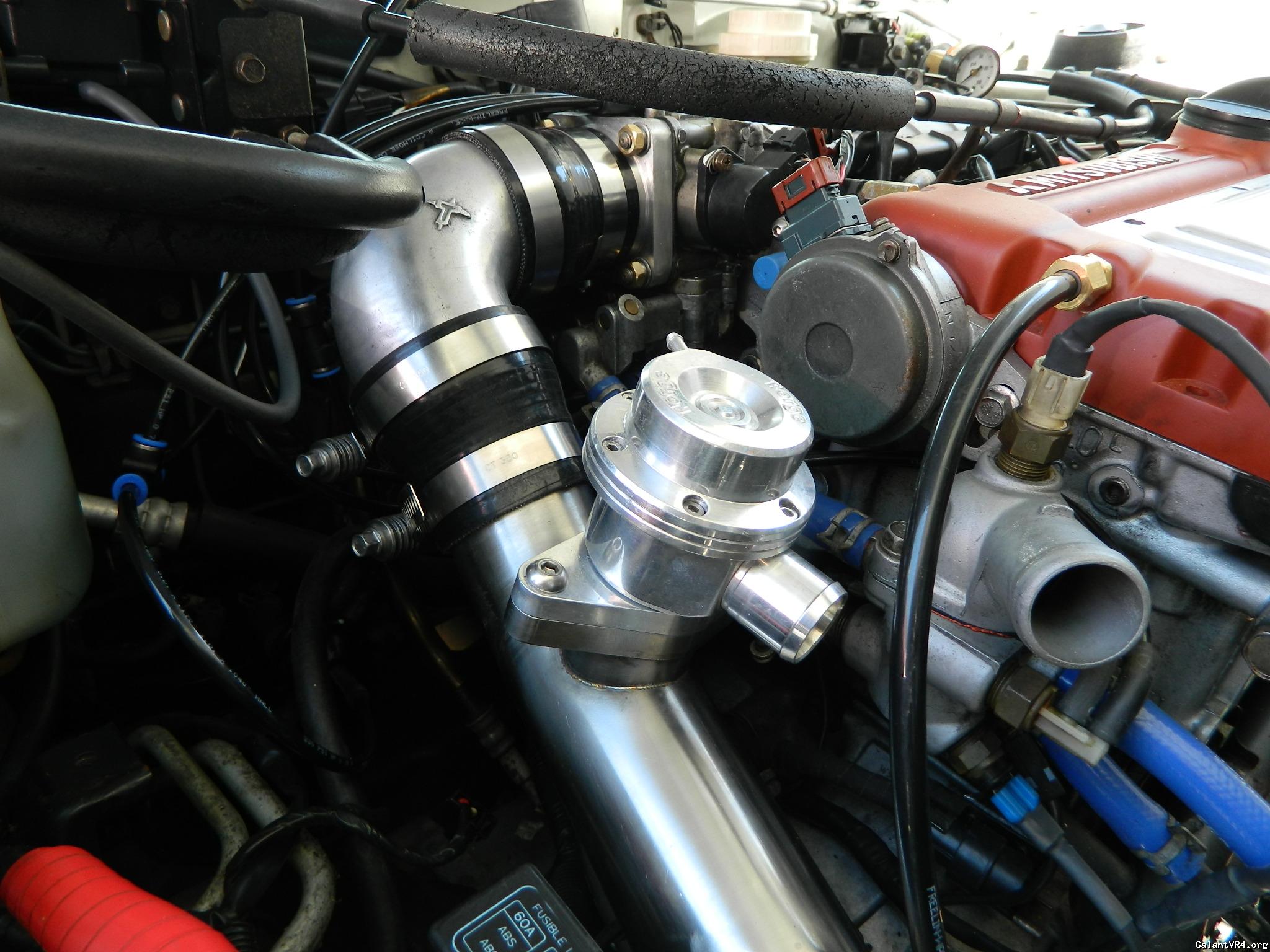

I had an FP (iirc) 4" intake tube that had nothing on it and added a few nipples, one of which was the BOV recirc and the other two smaller ones were the PCV air intake (that goes to the side of the VC) and the other is that line that comes off the charcoal canister. I wanted everything hooked up and functioning. I made them on the lathe and had them welded up and it came out pretty nice. The tube was originally powdercoated but of course when you weld it needs to be stripped down to bare metal in those areas...so, I repainted it with glossy black rattle can and it came out decent enough (still needs some polishing/waxing)...Here's a pic:
If I understand your question about the BOV mount, if it's similar to an oem unit (that uses a mating flange/gasket), then you'll want that flange welded onto the pipe and the BOV attached to that with screws...Originally, my plate was welded right onto the pipe with a thin plate and I didn't like that (was a crappy weld and seemed warped to me), so I made a standoff tube and a thick mating plate. Here's a pic for reference (yeah, the gasket isn't there yet, as it's still in mock-up stage):
Anyhow, you can't tell in the pic necessarily, but the intent was to have that recirc hose go straight into the intake tube, which is does.

Use can use flexible hose instead of thick rubber for the recirculation hose. Then it won't matter where the intake is within reason.
JNR
Apr 23, 2004
9,848
ca
Yeah, that's how mine was setup when I first go it, as far as the intake and the BOV was mounted in a different location, so it had to come up and around, which IMO sucked. So, when I started from scratch on the design, I wanted the shortest and straightest path as possible, which this is. Hard to tell, but I am using silicone hose that only came in blue (yuck), so I wrapped it to match.

another thought...since i have the older HKS bov on there now, would you think its as easy as remove and install a newer one without any flange changes? All i see new are the SSQV's. Again, trying to do things as simple as possible so i can get this baby recirculated. I've also been looking for a 1g bov already mounted on a straight hard ic pipe...gonna go with whichever is easier find.
JNR
Apr 23, 2004
9,848
ca
Judging by the picture, it looks like your HKS BOV just needs to have that 'horn' piece replaced with a tube and it appears it's held on by two screws, so making something shouldn't be too difficult. May be able to weld a tube on, but IMO not the best idea since I bet it's cast alum. and I personally don't like messing with things like that as it kind of ruins the piece. Changing the horn with a screw on piece though wouldn't since it can be changed back...

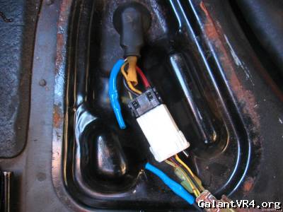

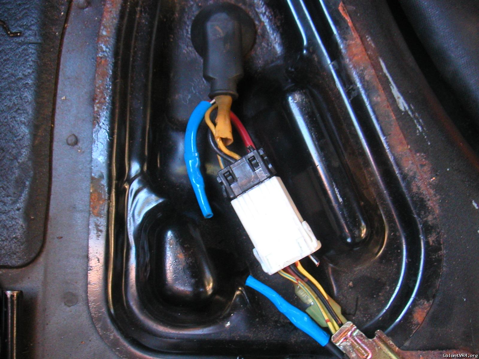

-tried to take a look at the fuel pump and i've never see one rewired before, but it looked questionable:

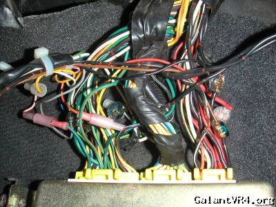

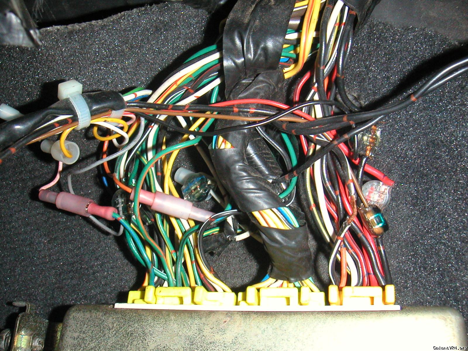

-took shots of the ecu wiring harness. i see one part of the wire exposed that i will get taken care of asap, but overall this looks pretty messy:
i half smile, as i forgot that these cars make you actually think!
