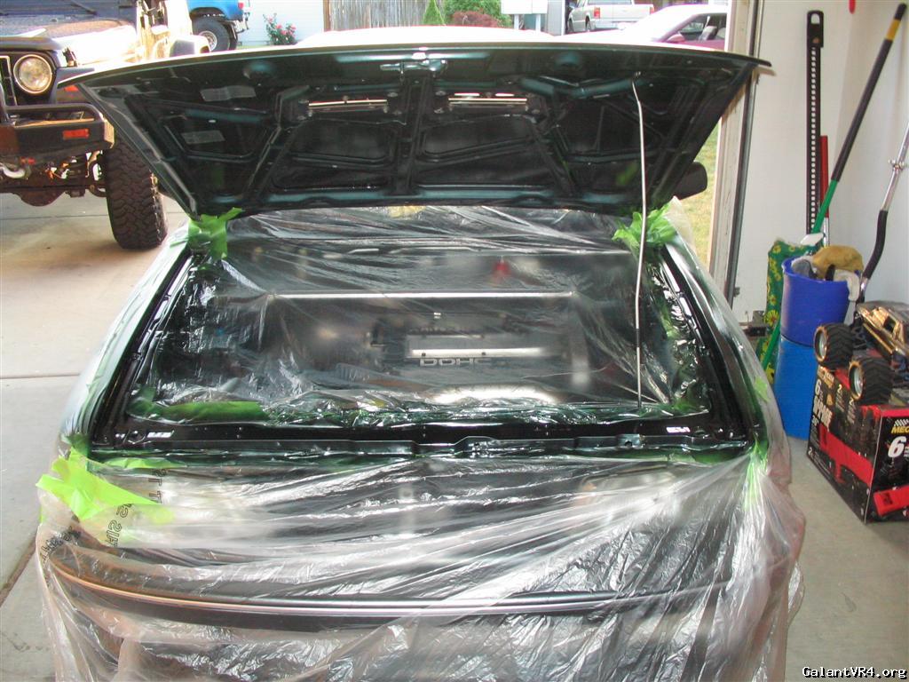

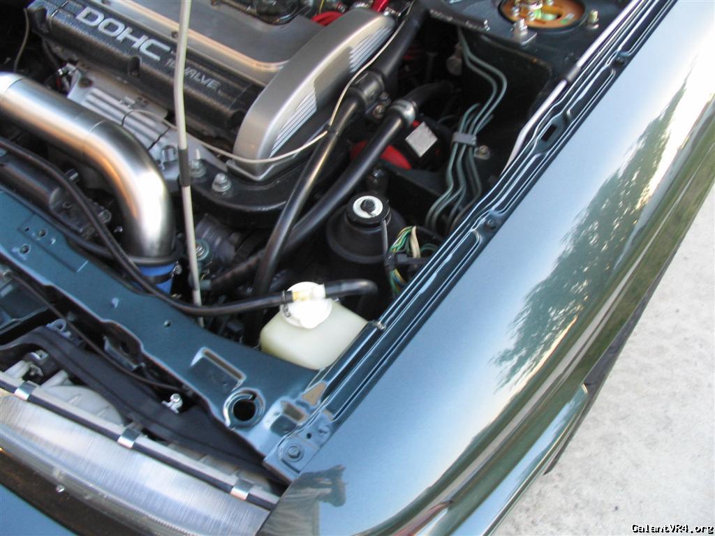

My local autobody supply place can mix me up aerosol cans of whatever color code I bring them. I did my hood and trunk jambs as well as the OE battery area back in '07 with it and it turned out great. The factory paint in those areas isn't exactly super glossy and perfect anyway, so getting it to match perfect isn't super important, IMO. Unless you're going for an all out Pebble Beach restoration job.

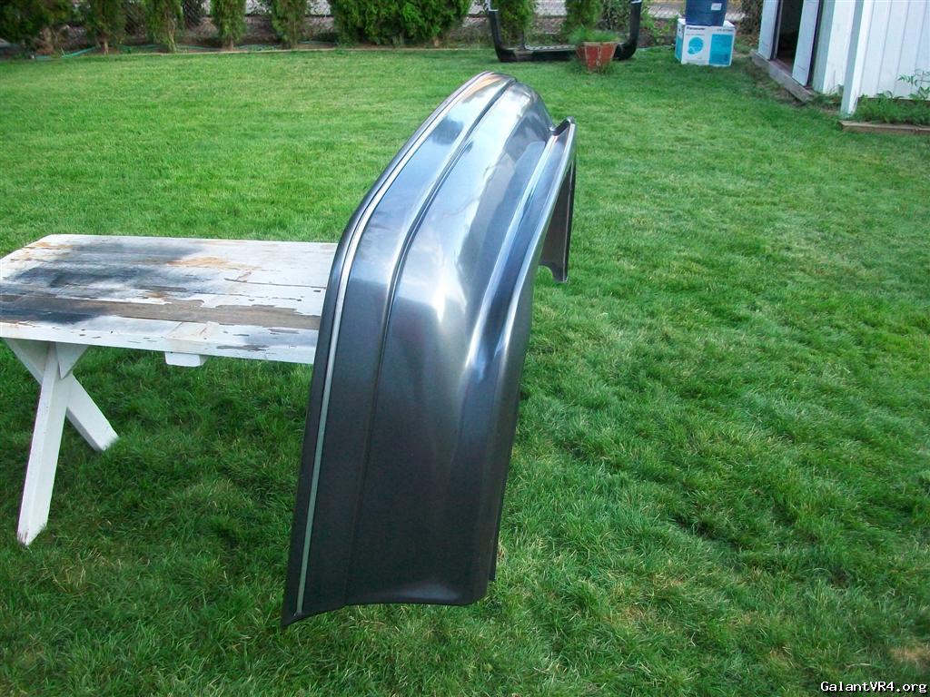

Hell, some people may remember I did both JDM bumpers for 503 with the same stuff but mixed to KG color code and nobody could even tell they were rattle canned.
