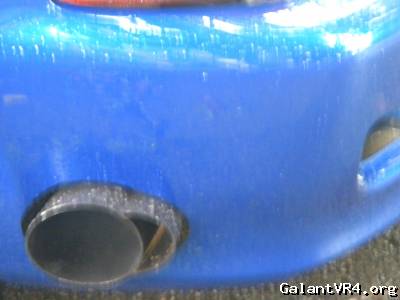

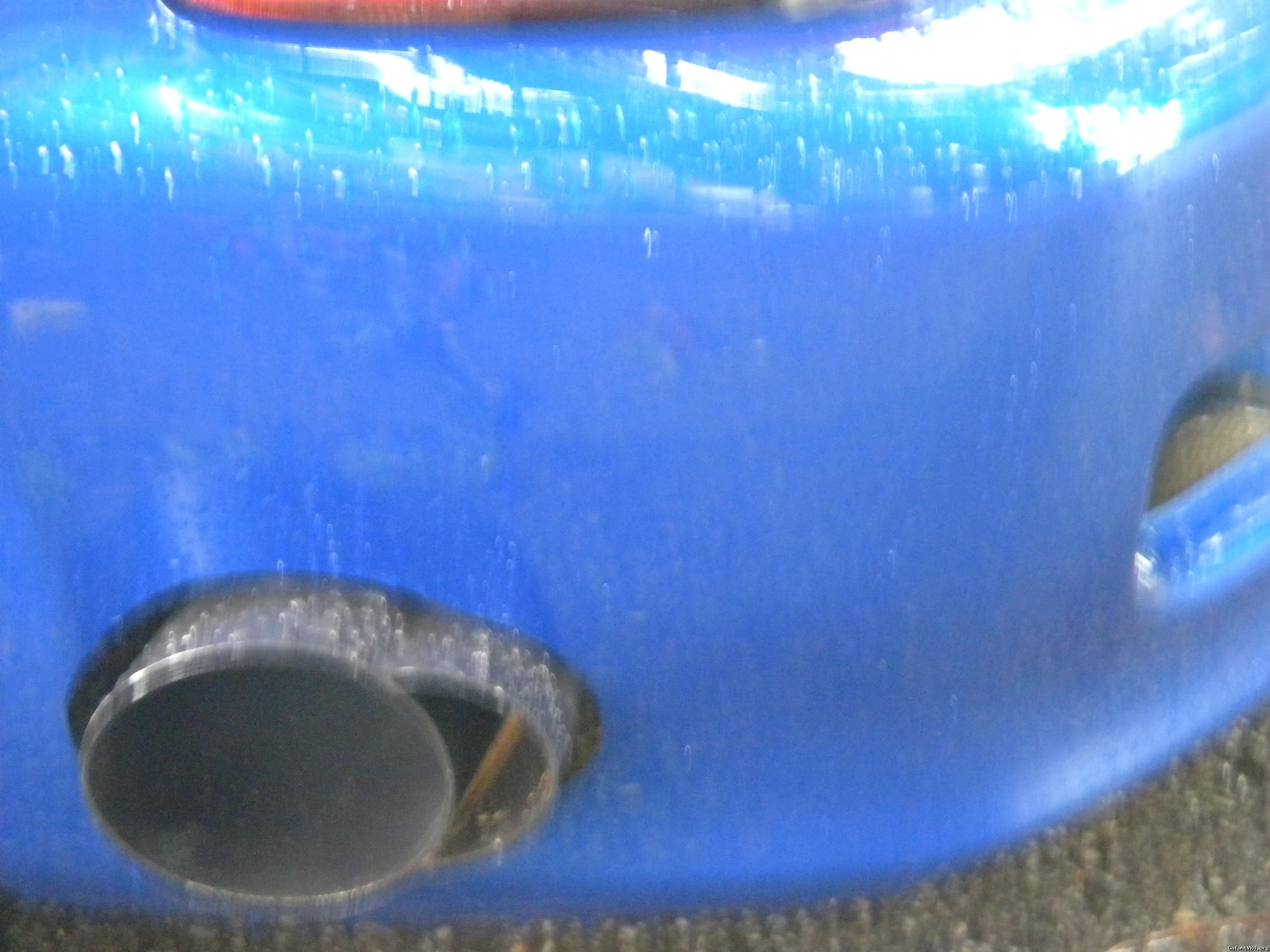

Well I did this car over the summer. Messed with some seat brackets for it today. 3 to 3.5 to 4 inch with the small half moon being the wastegate. Took 3 days to build the exhaust system that ended up being less than 14 lbs. When the cars is debuted locally or should I say its broke off a bunch of checkbook builds I'll post up the data.
