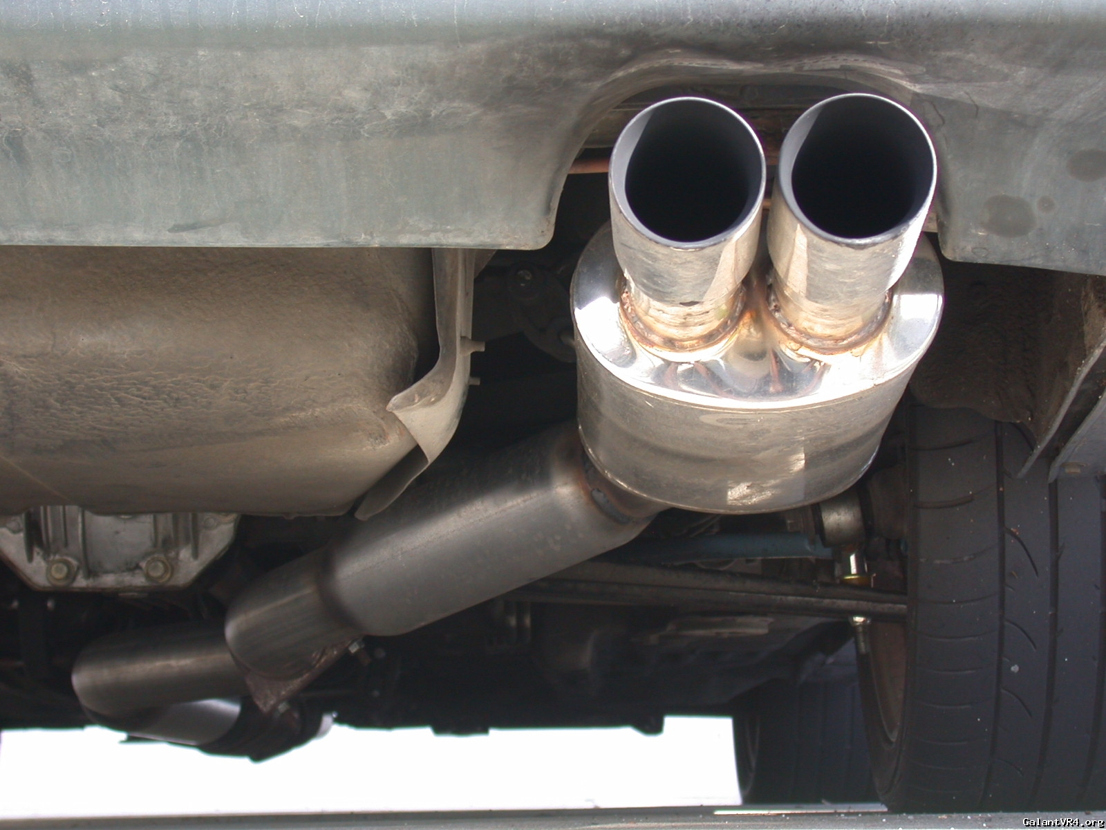

Any suggestions? Also, I haven't found any decent sources for exhaust tips. I like the 4" double-wall tip I have now, so it would be nice to have two smaller versions for a dual outlet. It looks a lot like this.

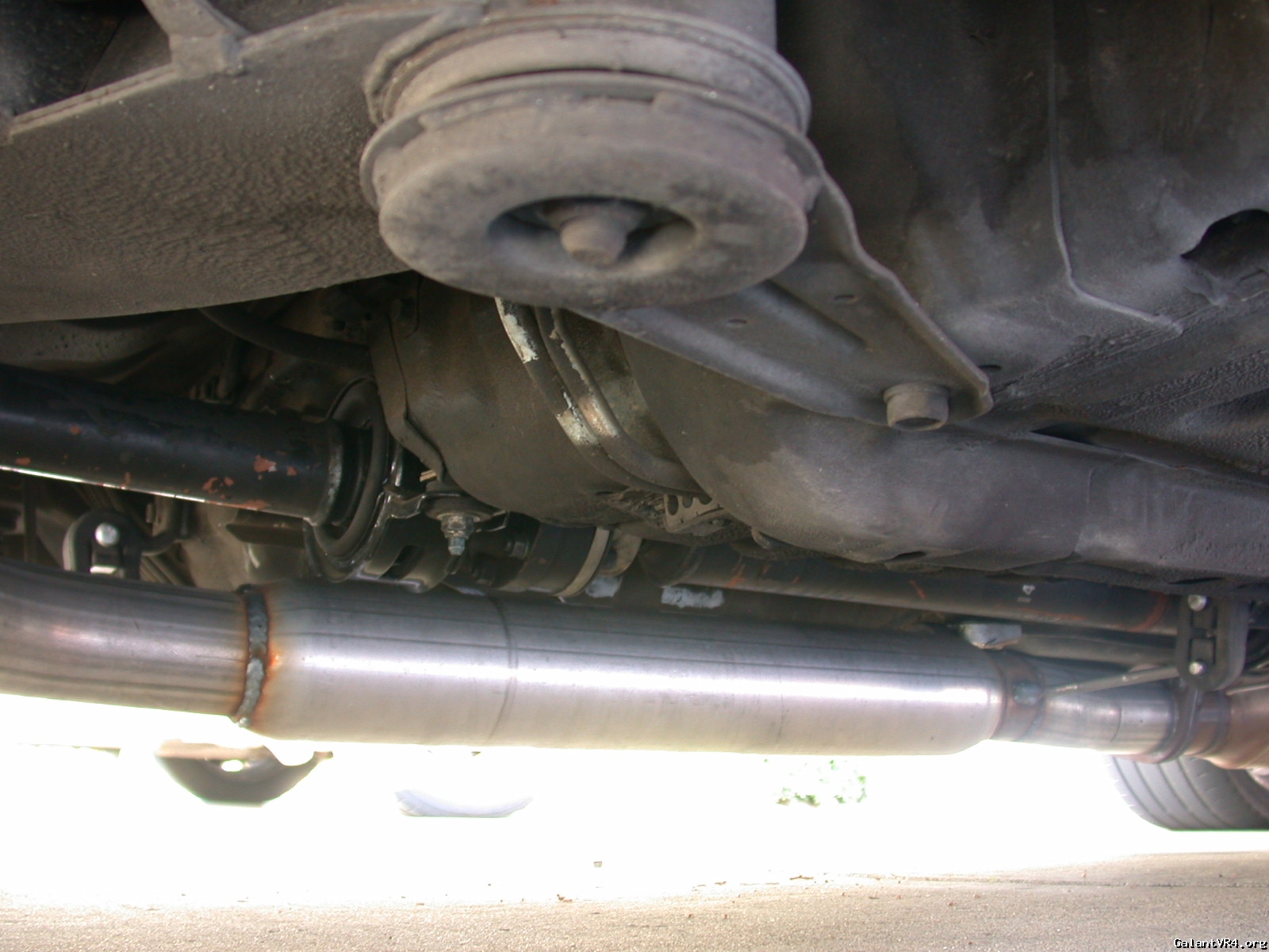

I just put two Summitracing resonators in a custom 3" exhaust that has no cat and a Magnaflow muffler. I used a 18" and a 12" and it sounds great and I can actually have a conversation in the car now. they are a strait through design so they don't kill the flow. Price is cheap too.

I have a magnaflow cat, 14" resonator, and muffler on a 3" exhaust. I don't daily drive the car, but I think the resonator helps A LOT.

I used a dynomax bullet straight through muffler as a resonator, a 3inch turboback, and a 3inch inlet, 2 x 2.5 inch outlets borla turbo XL muffer. It sounds really nice and the volume is reasonable for a 3inch catless turboback.

I have 2 resonators and a magnaflow twin-tip on my car. The resonators are different sizes, one is fairly small, the other is like a small cannon muffler. Before I got the magnaflow I basically had an open pipe (ebay muffler ), and the car was reasonably loud when accelerating. The magnaflow actually made the car slightly louder at idle, which is annoying in traffic and worrying around the police, but other than that the car is fairly quiet. Even at full noise I suspect the majority of the sound the car makes comes from the front of the car.
You can definitely talk with the windows down, up, etc, and hear the stereo at a reasonably quiet volume.
I think with another, appropriately sized and placed resonator to kill the drone at idle, the car would be perfect.

I added two resonators, 24" and 12", which are of straight-through perforated-type from RRE.
I also use a 3" catalytic converter. So, basically 1 muffler, 3 feet worth of resonators, and a cat. You can bet it is quiet.
