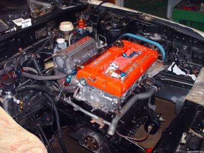

The new snail is in, i just picked up am FP Red and FP o2 housing for 40mm wastegate, the compressor housing is jet hot coated black.

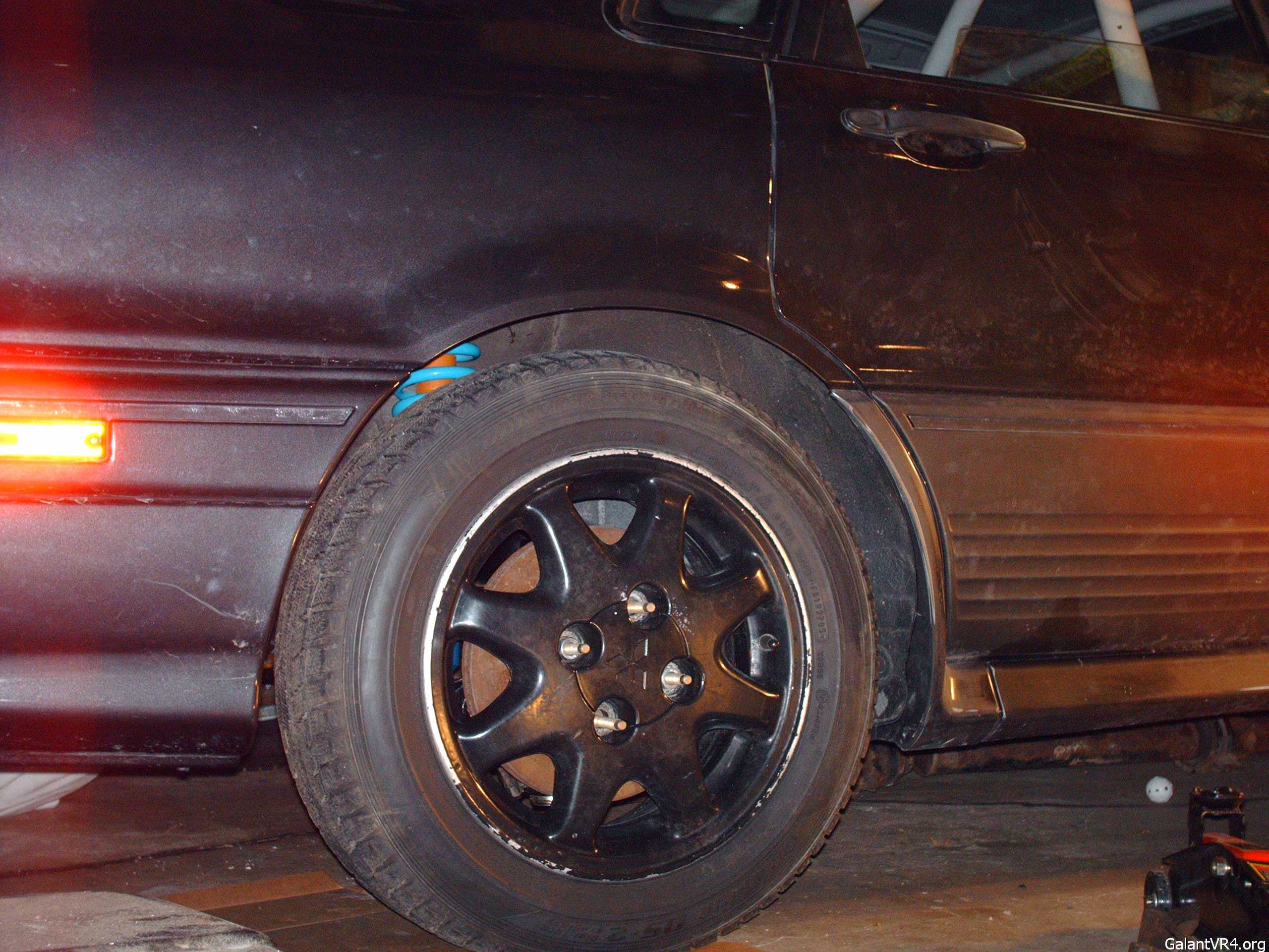

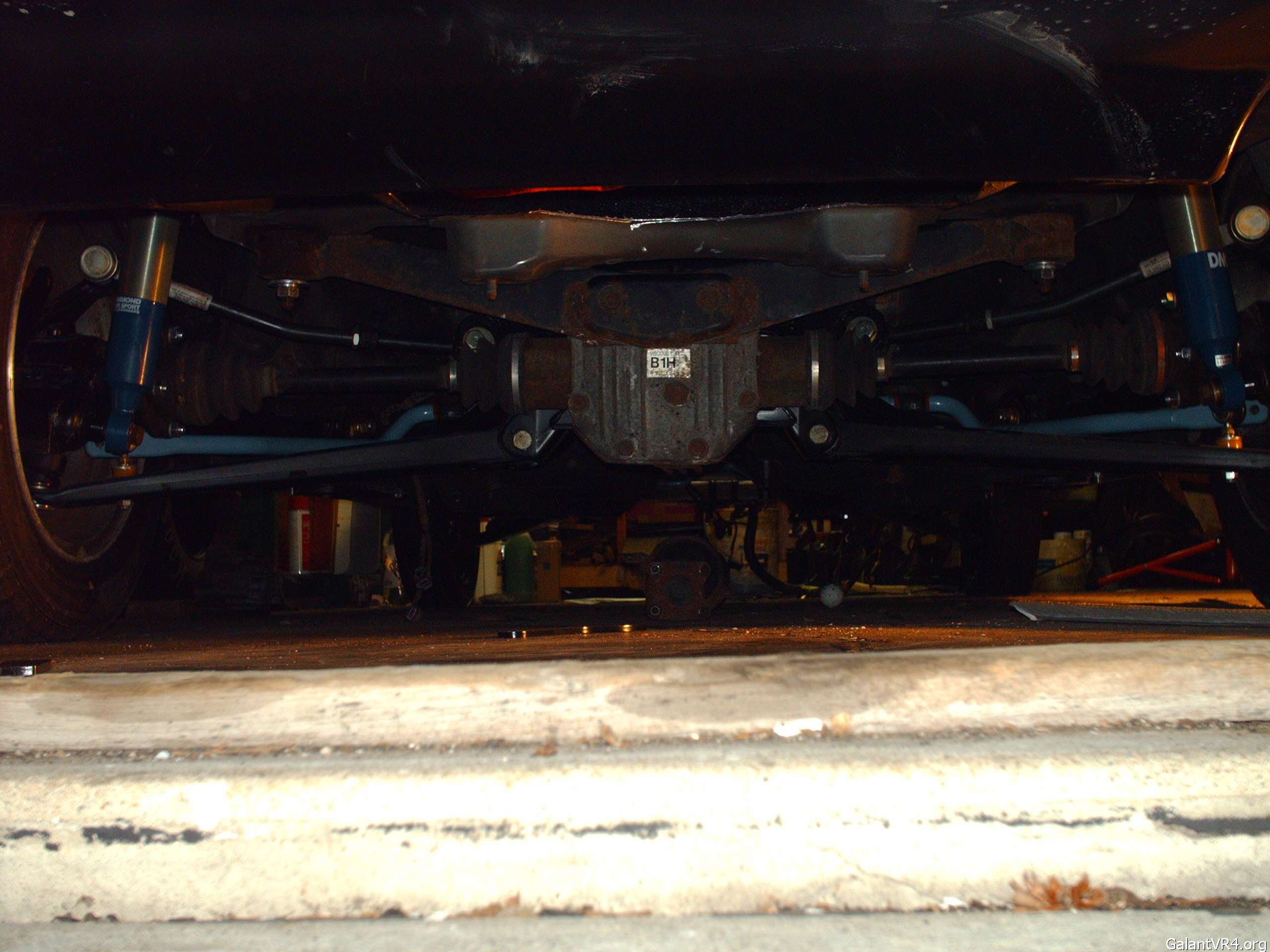

suspension mock up with zero weight in the car should i jack the car up? or leave it on the ground?

I read it, Pat on head, Now get back to making that car kick ass. /ubbthreads/images/graemlins/grin.gif Oh, & I like the suspension lower. /ubbthreads/images/graemlins/cool.gif
^^^^^^ me too. mine is about a half inch from the fender well and it looks low but not slammed

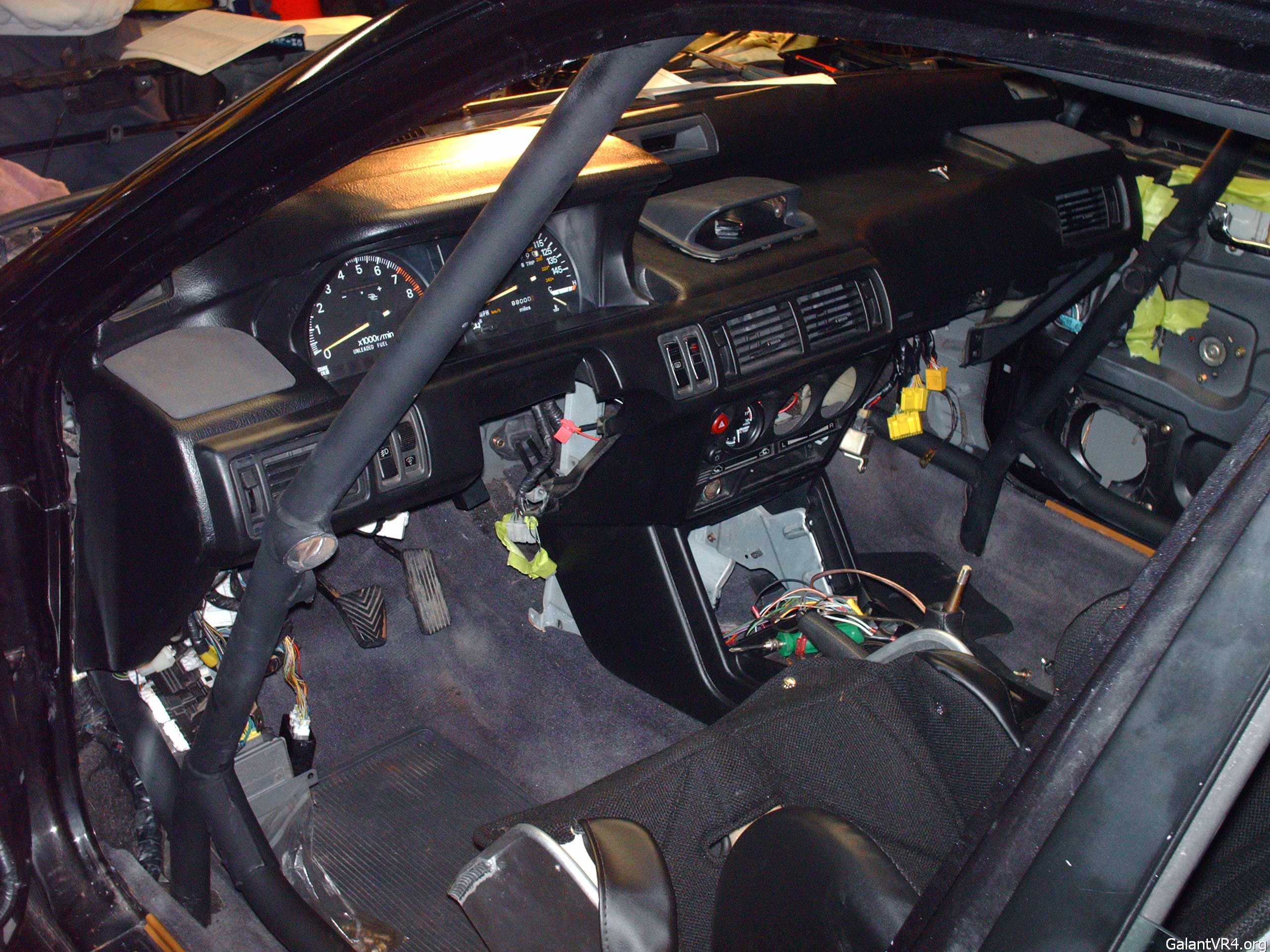

alright so as i said the stock harness was going to go back in. well, consider it done. i just have to mount it to the driver side under the dash, and a few grounds, wire the trunk lid and she is done!
and to whoever did the cage, please dont do another one, from what my buddy and i can tell it sits off center? the pass. side rear and driver front sit closer to the door handles than the driver rear and pass. front. can't open the driver door or passenger rear door!?!?
cage is cut, no more front cross bar or T sections/door bars so now i dont have to dukes of hazard my ass into the car everytime i want to get in. it is also rattle canned flat black and looks UBER sexy.

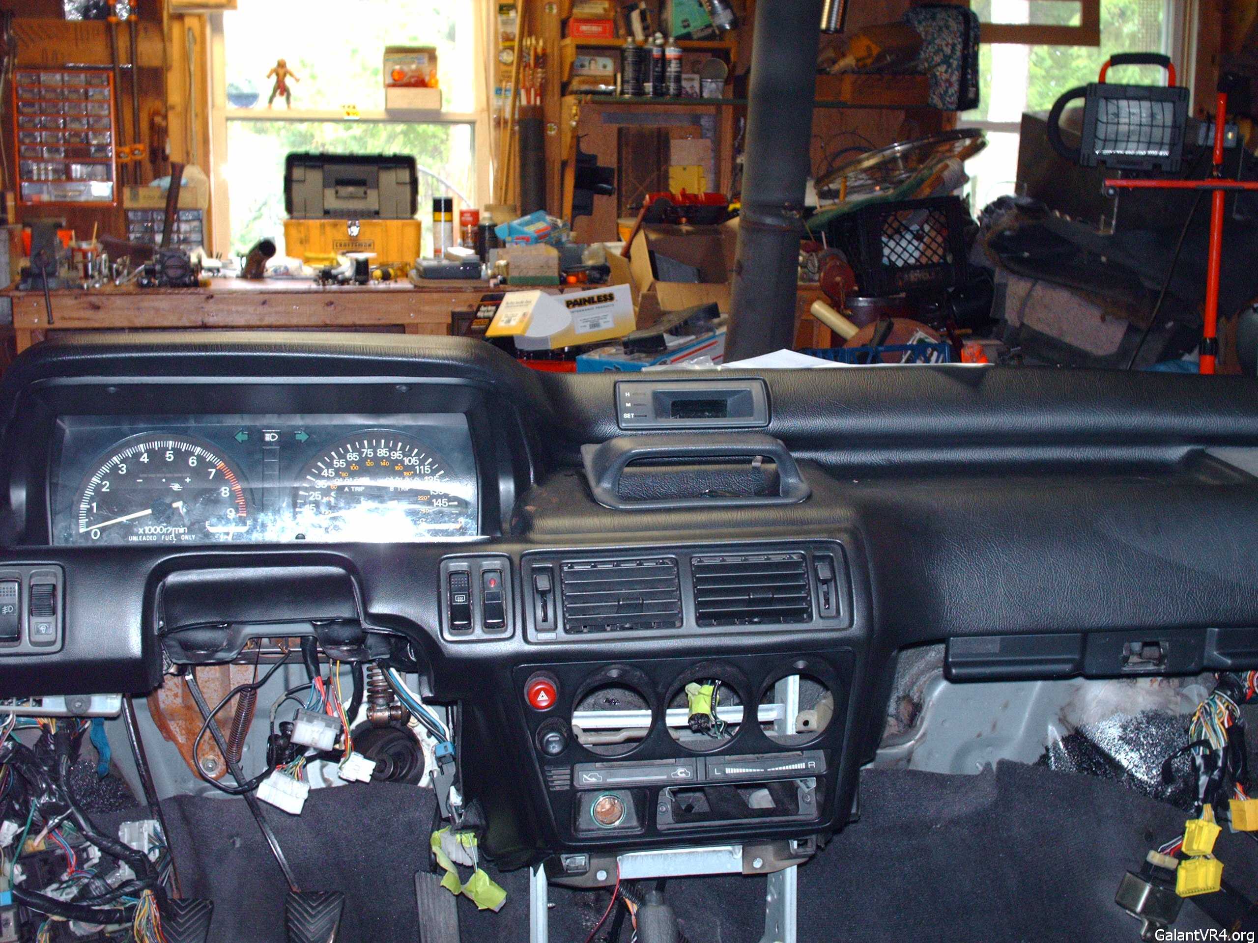

carpet, yes carpet is in! center consol and dash are in.

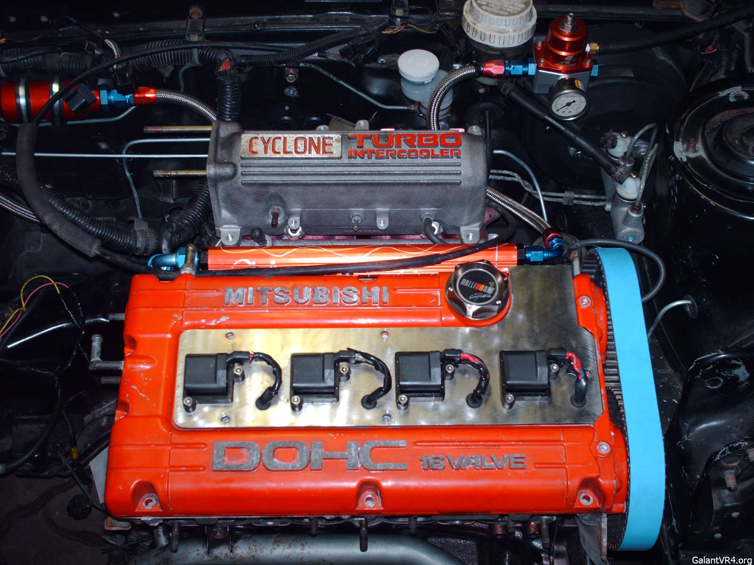

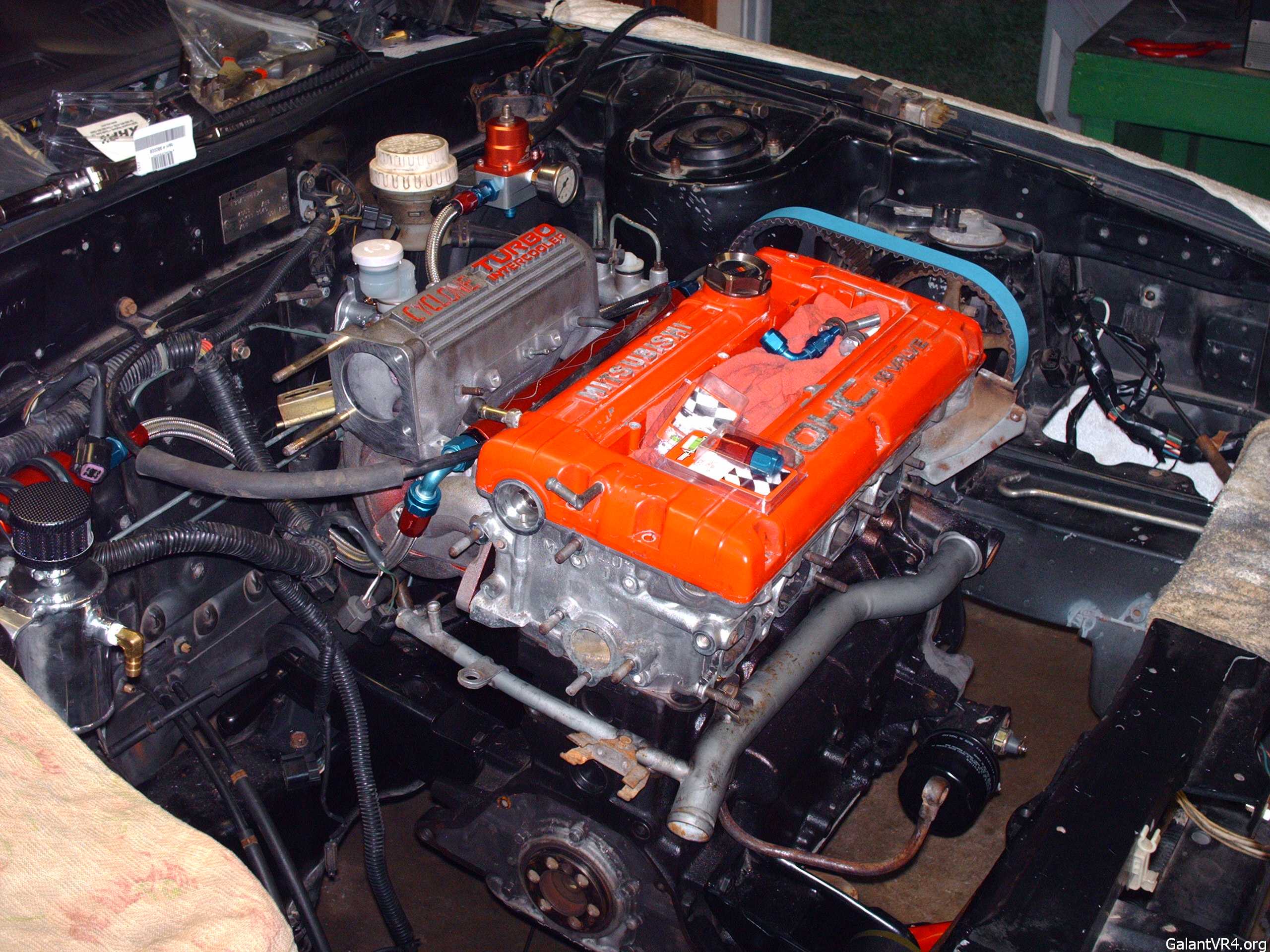

as far as the motor, tomorrow i am cleaning a cyclone intake manifold, and will be running that, cutting down the steps that are on it that are between sections. i need to get a front cover, kevlar timing belt and cams.
STILL NEED A TRANNY THOUGH!

alright well here are a few pics of the dyed interior...

also checked for cyclone intake manifold gaskets... jnztuning.com doesnt carry them anymore. Mitsu discontinued them. so, i will be making my own, perhaps making a stencil to help anyone who may need gaskets.

my buddy has my rear subassembly and is fabbing up some caliper brackets, i should have it back very soon.
