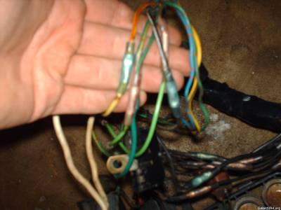

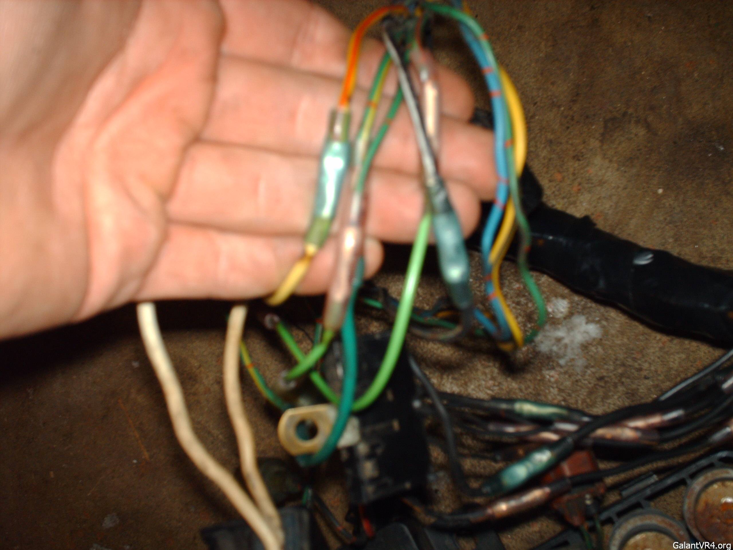

decided to say screw it and am just going to strip. splice the wires on the old wiring harness fix it be done with it, i get all the connectors and wires for free from work.
would it be a good idea to run thicker wire for the grounds? is it possible?
thanks

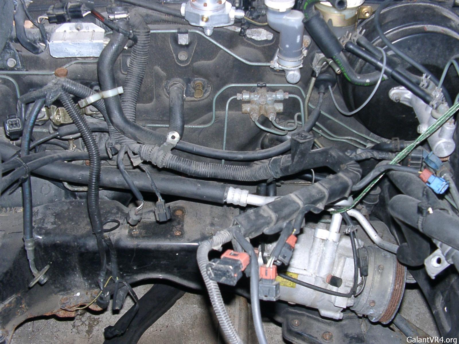

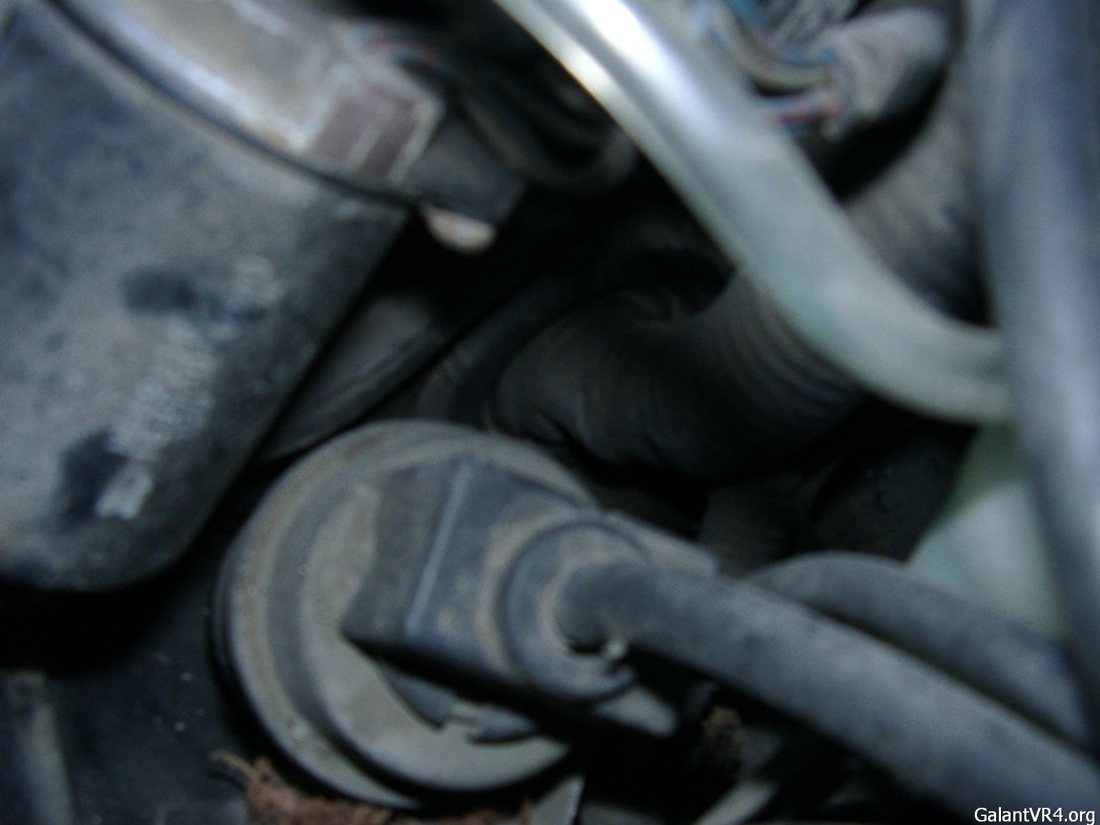

Entry point into engine compartment, under cruise canister:

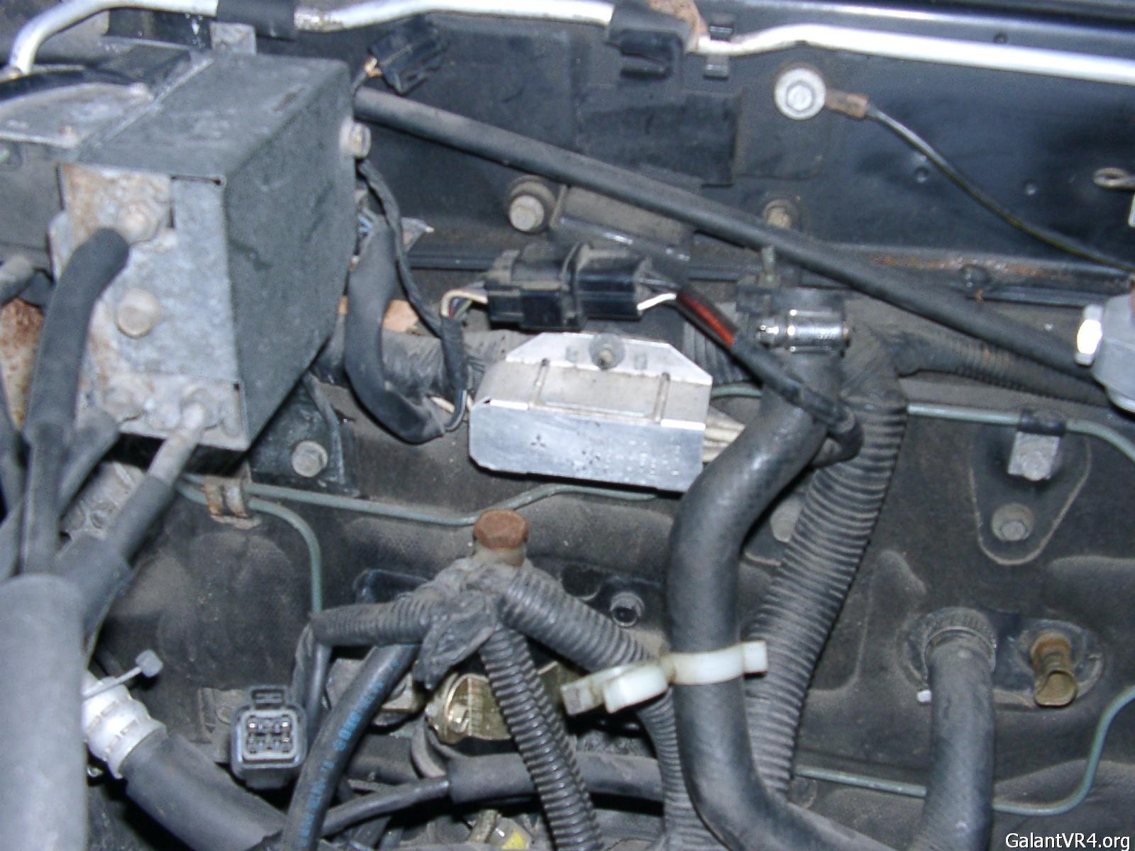

Harness routing behind resistor block:
General harness layout:
