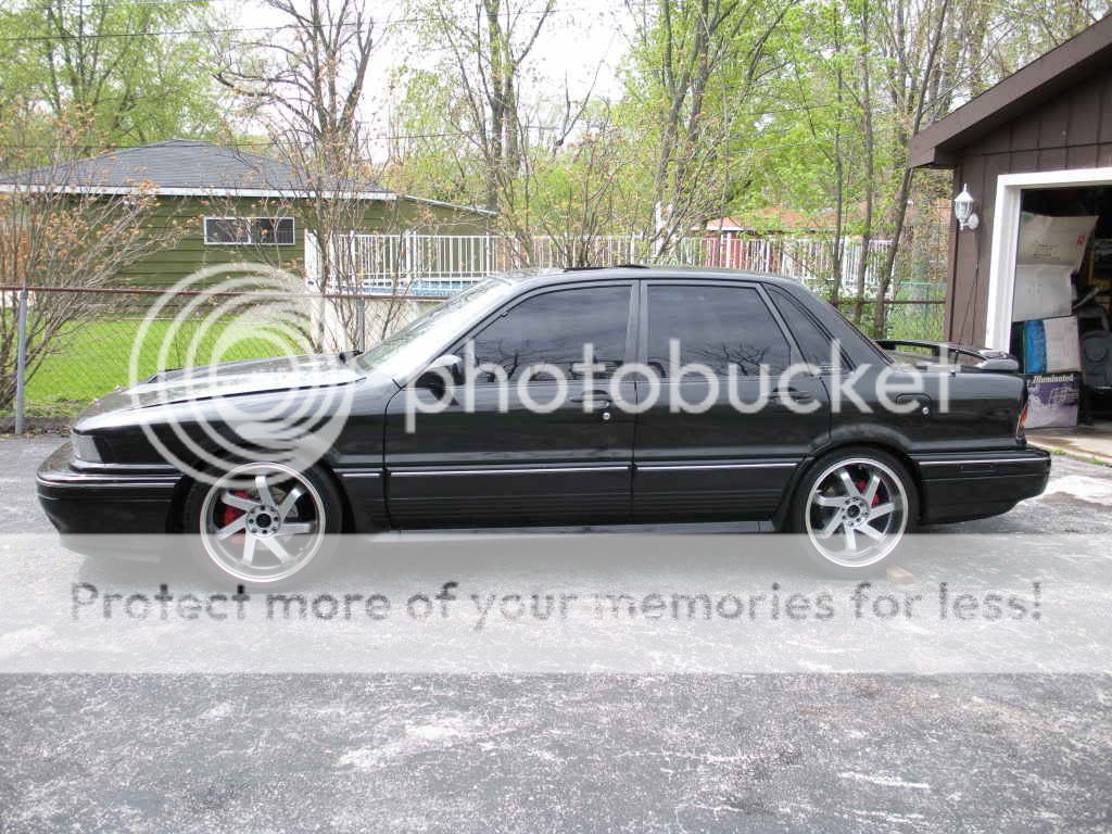

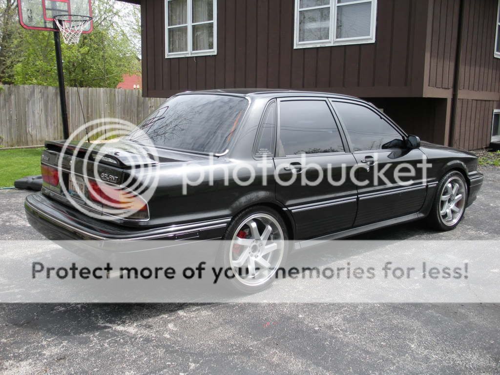

I love those wheels, what are they? What are the mods?
boostin4door
Oct 7, 2006
150
Chicago, Il.
Their BSA's got them 4 years ago.I don't think their made anymore. Their 18's and alittle heavy but I like them. I also have a set 15" Rota Slips in Blk.w/polished lip..
Mods...The usual stuff. Built:Wiseco/Scat-Rod combo,ARP's w/Cometic HG,Dejon SMIM,63mm ported TB,Holset HX35 Turbo w/Dejon 4" IntakePipe,FP Exhaust Mani.,280 Cams w/HKS cam gears,2.5"IC piping,Forge recirc. BOV,CXRacing 30x10x3 FMIC,Built trans.w/ClutchNet 4 puck clutch,Keydiver 3 chip,AEM WB,FIC850's,SAFC,Re-wired 255 Wally,-6an line from trunk to return w/K&N fuel filter, AeroMotive AFPR,Coil-on-Plug setup,CandyRed Powdercoated valve cover,front&rear strut bars,RRE catch can,Battery in trunk w/kill switch,Apexi Ground/stabilizer box,Hallman,custom o2 housing w/dump,full 3" exhaust w/3.5" HKS Dragger Muffler,1g shifter w/EVO knob, Suede Rally steering wheel,Slotted/cross drilled rotors,SS Brake lines,KYB's w/1g springs, etc.....

Looks great. I really like the wheels.

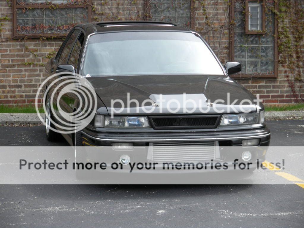

I was wondering about the front bumper, specifically the intercooler opening. It's kind of hard to tell from the pics, but did you have any work done on the opening to mask or hide the cuts from removing the slats in the opening? If so, what exactly was done? I have a spare bumper cover that someone had already cut the slats out on, but it doesn't look that great as it sits. I've been debating on sticking with a modified USDM cover or somehow getting my JDM bumper to fit with my intercooler setup. With your pics, I'm leaning more towards the US bumper.

Very sharp car...the exterior ties together perfectly...looks like a fighter jet in those shoes too...great car!
11,982
The only thing I don't like about those wheels is that the spokes "twist" the same direction on all four wheels, so on one side it looks like they're twisting forward and on the other side it looks like they twist backwards. That would absolutely bug the sh*t out of me being so OCD. /ubbthreads/images/graemlins/blush.gif

The car is a Tenn. car, it has zero rust! I got it 3 years ago. I daily-drove it one winter and that was it. It was really clean when I got it. It has the usual door dings and road chips on the front that yo really can't see in the pics. But, it has the original paint.
The front bumper was cut out by Longtime GVR4.org member, Curtis. He really cut it out nice! In regards to the crash beam,We just marked it & took it to a muffler shop and they cut it out with a torch. I then painted it gloss black to blend in and to prevent rust. It really lets a massive amount of air to the core. I have no AC so theres plenty of room. It also lets alot of air to the alternator, you know those don't like heat. The fog lights are some Walmart $19.99 specials ;-) Their 55w's, have glass lens,& are really bright. I wanted a light that was round like the stockers & filled the hole.
The JDM bumpers look clean, I would use that since it's rare & you have it already.

Thanks..I debated along time about the hood at first. At the time there weren't many CF hoods for the 91'-92' Galants. My OEM hood had three big dings in it also. The stock hood is VERY heavy. Alot of guys don't like the 'Vader'hood & I wasn't crazy about it at first.
I got it for 2 main reasons: weight & underhood heat(FP header,although it is Ceramic coated). Probably wouldn't have got it if the car wasn't Nile Blk. The CF goes well with the paint IMO.
I know HighRev is making some kool CF hoods & trunks now.
