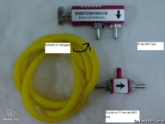

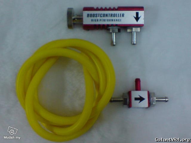

hi.. all guys.anybody can help,i need some installation diagram univesal manual boost control for ref.below is a pic mbc will install to my car. /ubbthreads/images/graemlins/confused.gif
I think you may have it the wrong way. The IN is from the J pipe and the out goes the the wastegate. I would not use the T fitting. I stay away from using the BOV line for my boost controller.
