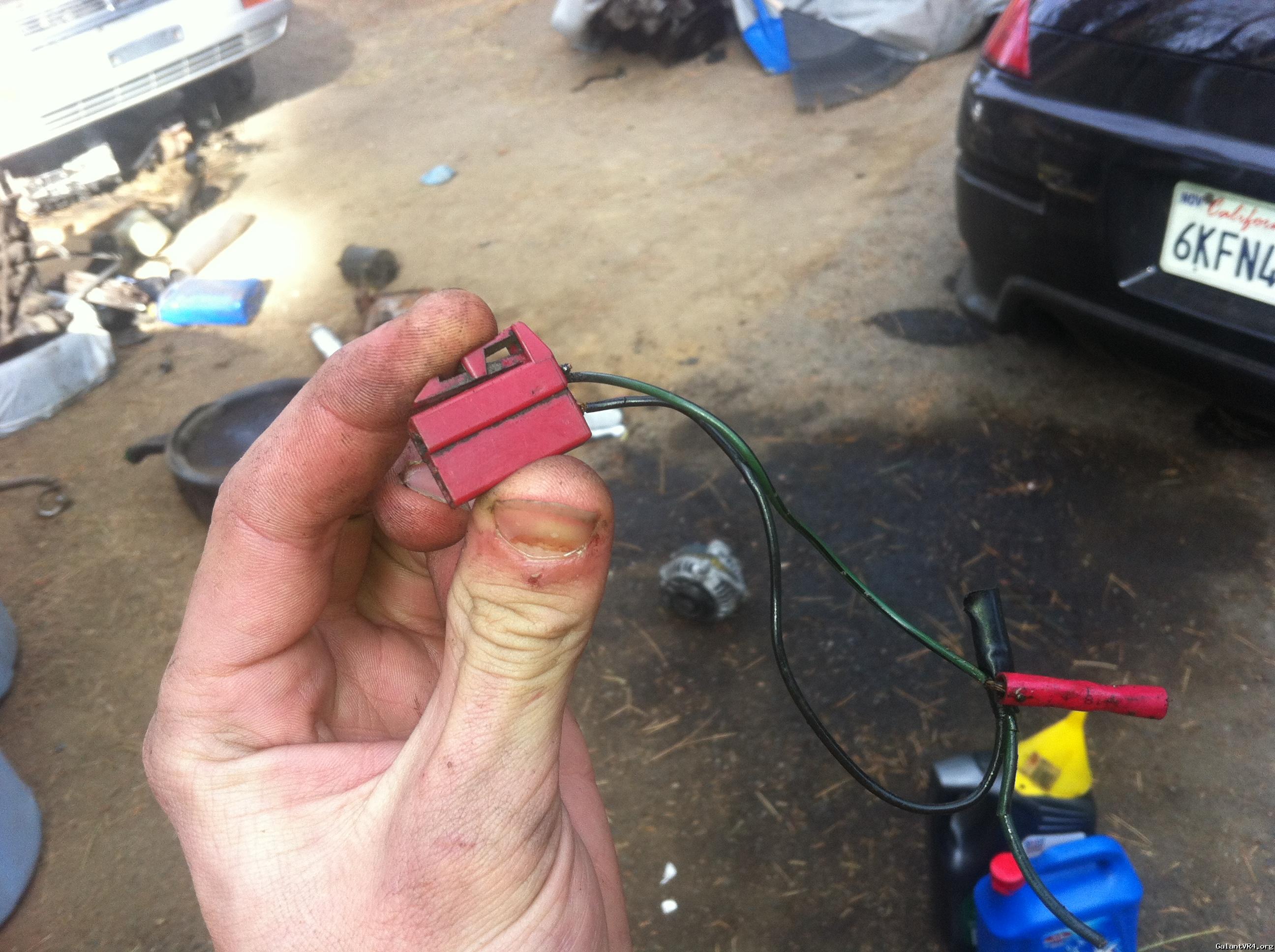

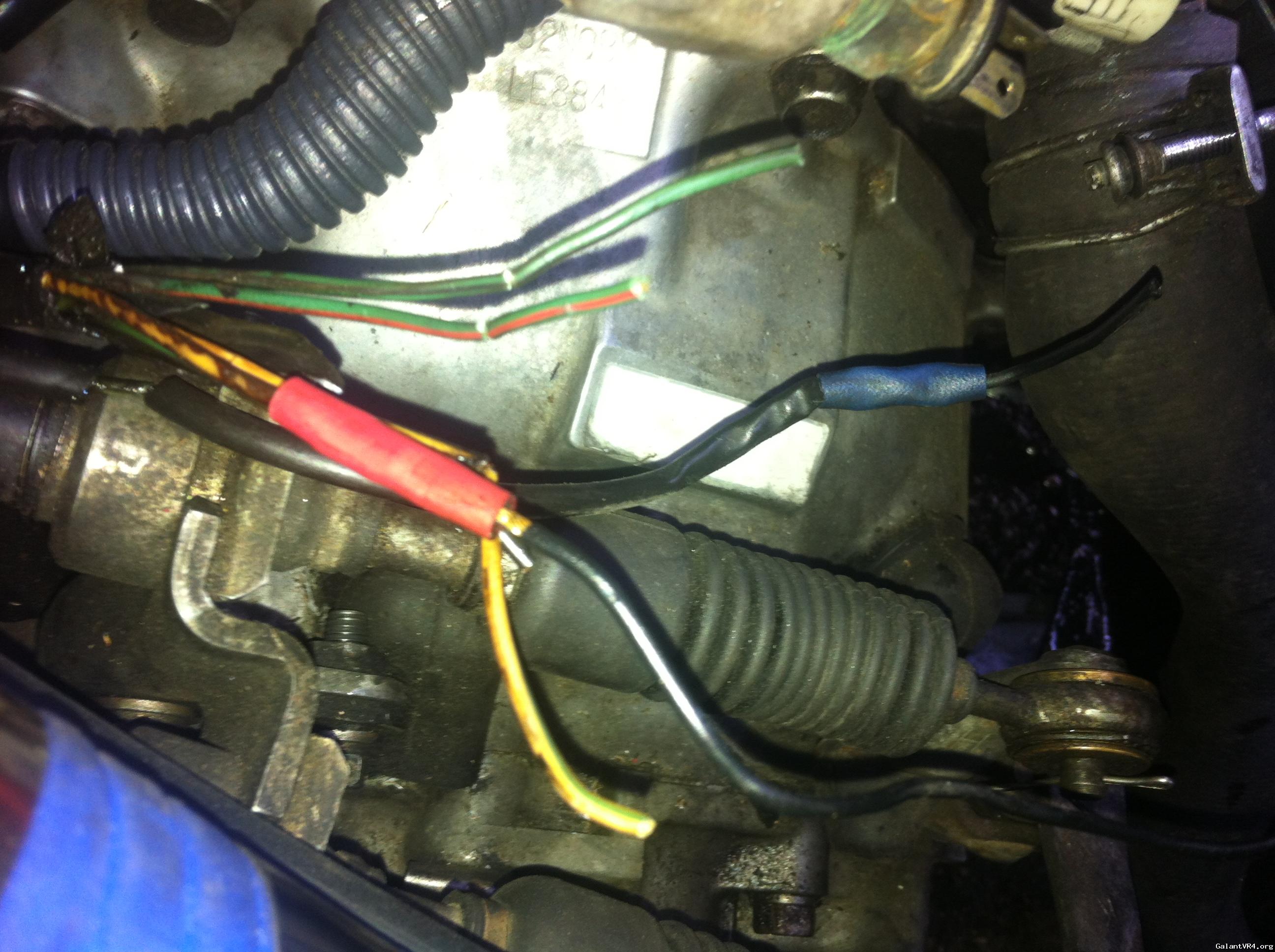

omertaitalia
May 7, 2009
422
Downtown Los Angeles CA/Lake Tahoe,CA
connected the engine coolant temp sensor (green with black stripe,yellow with green stripe), start car and it sits a 2k rpm then just dies?
