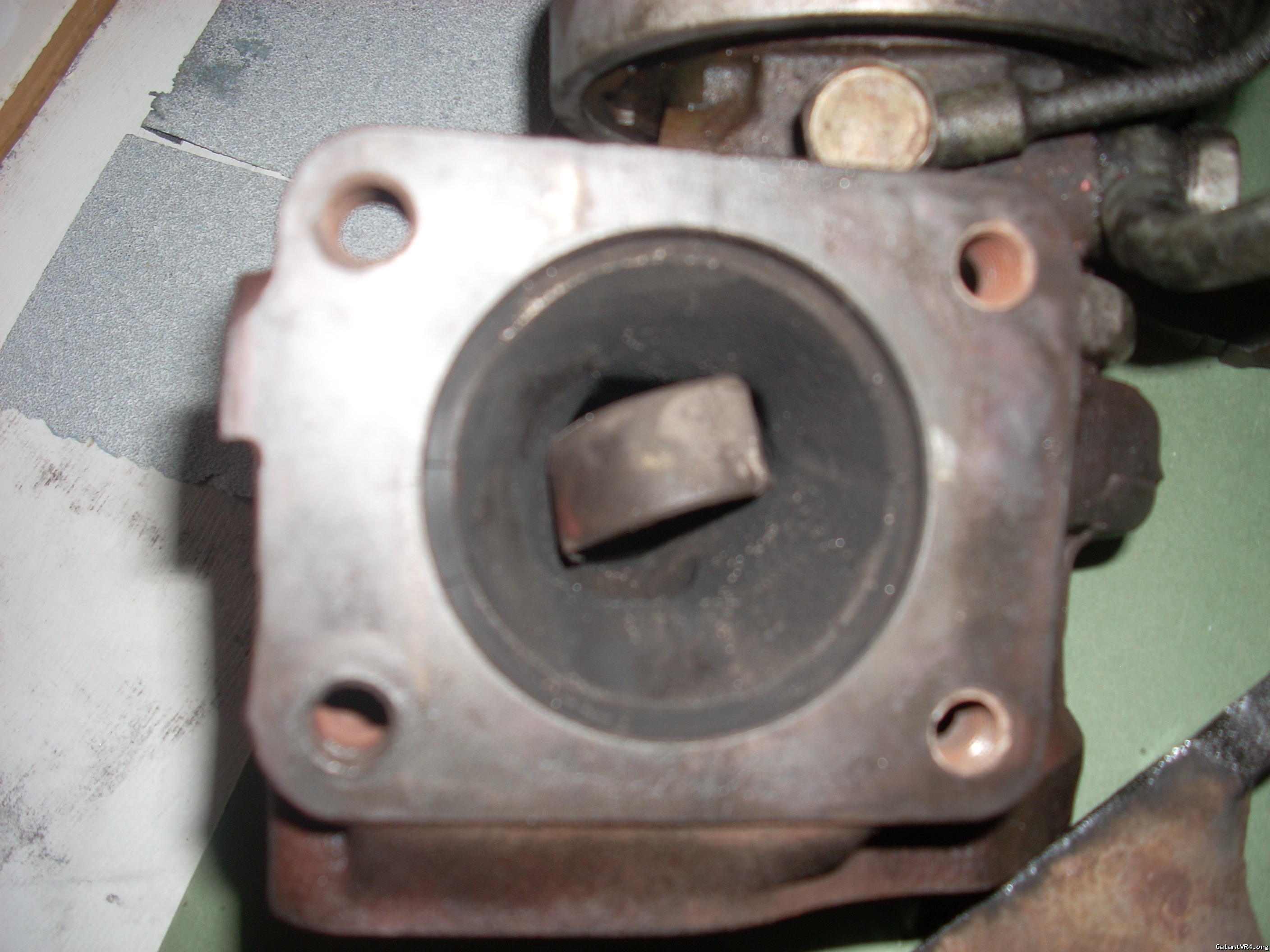

look what i found in my turbo!!!!
/ubbthreads/images/graemlins/dunno.gif :mad:any one know what this is!!!!it was just sitting there when i took off the manifold i always knew the car should have been quicker! think this will make a difference in performance then!?

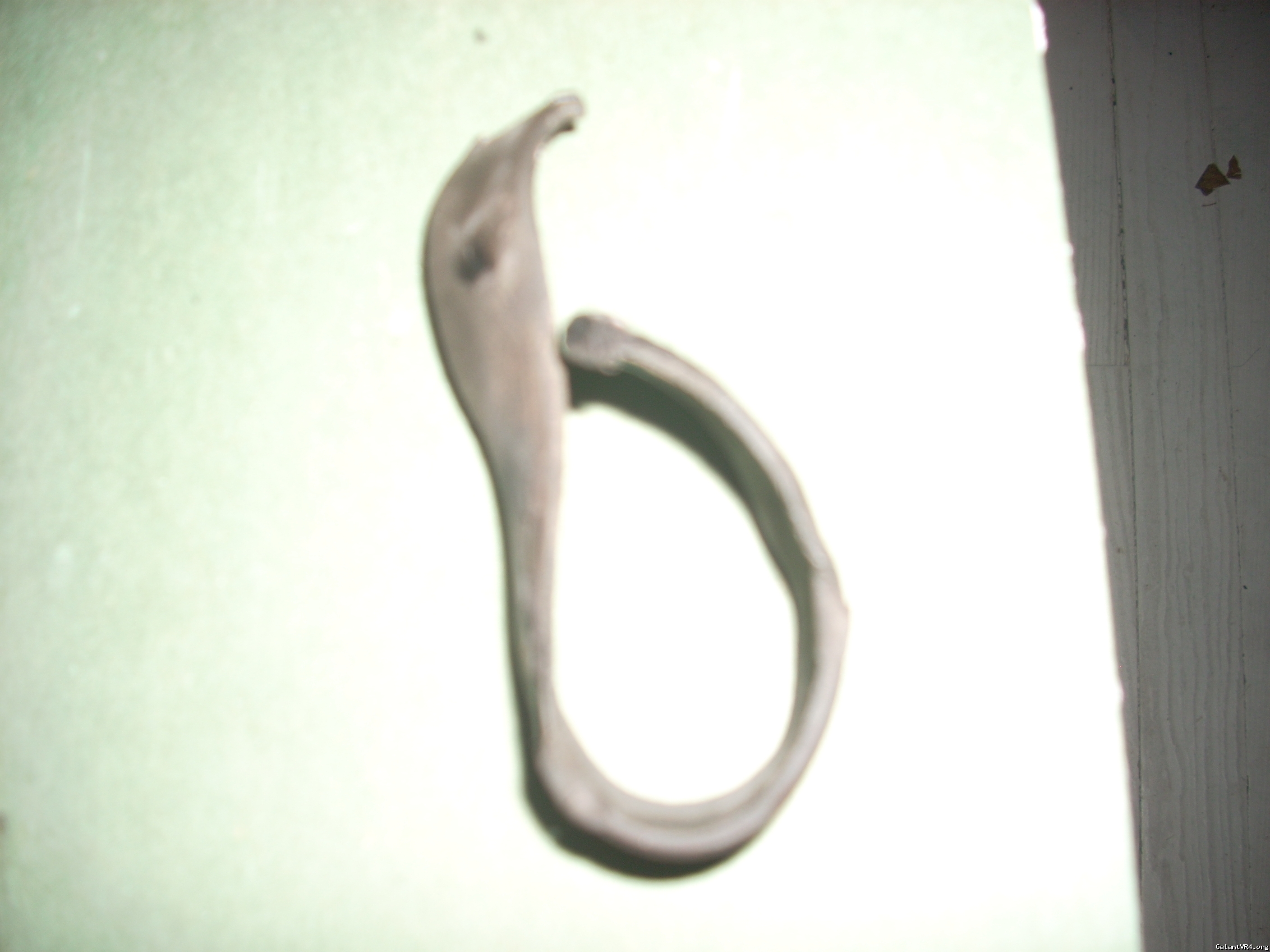

It looks like the ring that sits between the exhaust manifold and exhaust housing (on the little lip) to keep the gasket from blowing out.
Flip4G63
Aug 28, 2007
1,163
Abilene Tx
looks like the compression ring. stock cars came with that. it fits into that ring on the turbo and mani..
IIRC its called a compression ring. i could be wrong though.

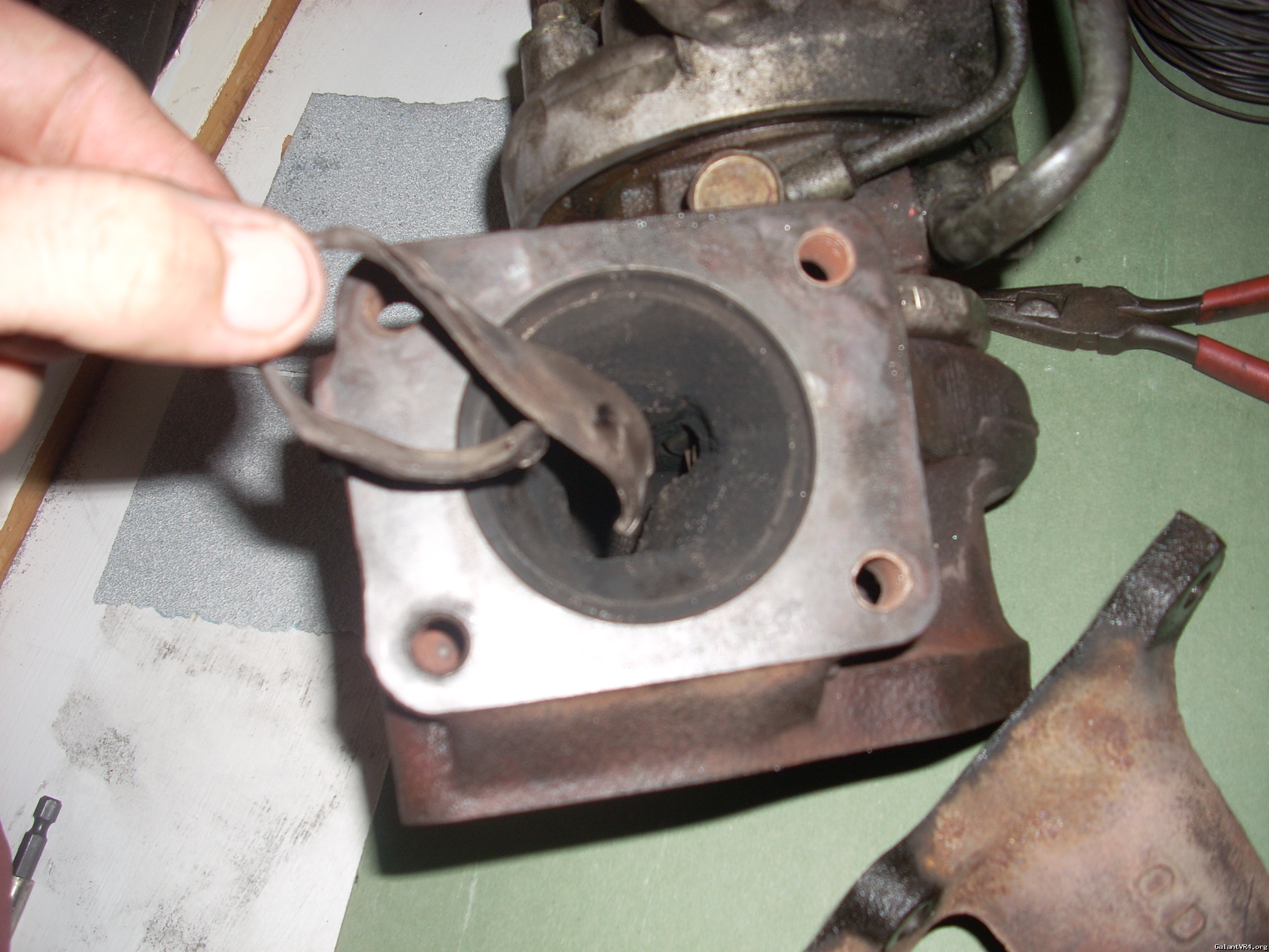

looks like some one installed a turbo wrong. and smashed it down in there while tighening the 4 bolts.

WTF MAN! That will hurt performance. Now you have to port the housing and trash that ring.

just think, every time your turbo spooled that piece of metal came one step closer to getting sucked in..
its been in there since i bought the car! so iv never felt the full potential of the 16g that was set at 20psi when i bought it and never felt quick! iv been spending a good bit of money trying to make it quicker,fmic,hard pipe,keydriver chip,they never made much difference,so I'm just waiting for my new manifold to put on and cant wait to take it for a spin! should be different car! /ubbthreads/images/graemlins/grin.gif

Holy hell you're lucky it stopped where it did!

I meant that it blocks the flow when it is down inside the turbo like that.
I would never reuse them. Do a mild port job on the output of the manifold to remove the old ring seat and also remove the ring seat on the turbo housing. Get a high quality aftermarket "thick" one piece gasket and you should have zero issues.
