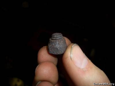

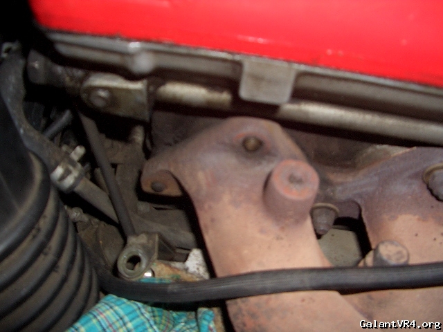

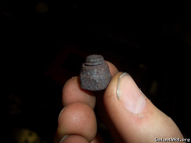

pretty sure i've found the issue:
fell off when i removed the heat shield
yeah...
I've got all the parts i need to drop the turbo and replace all my exhaust studs. I'm still looking for a local DSMer to lend me a hand, though. /ubbthreads/images/graemlins/frown.gif
