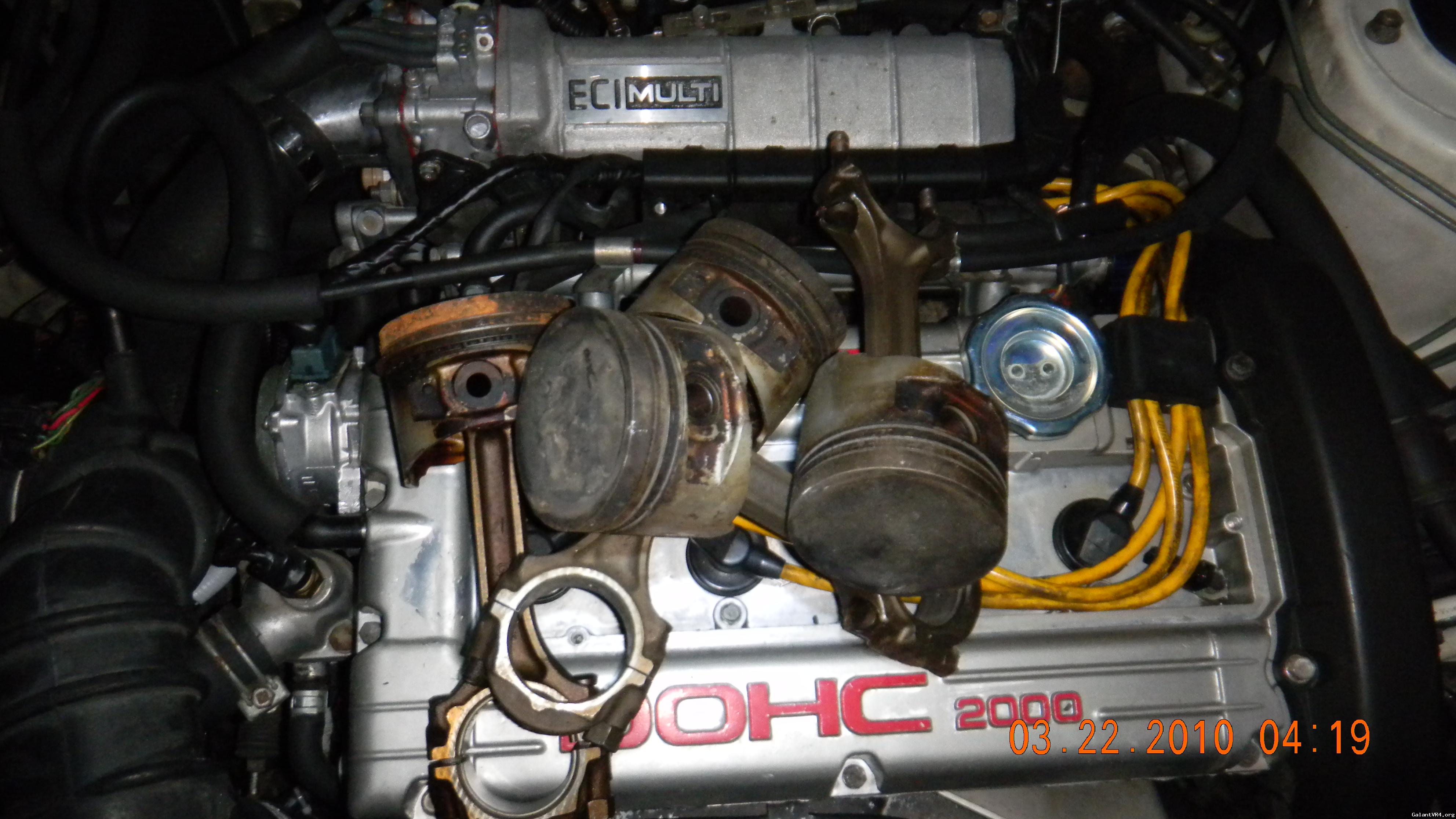

+1 wrist pin /ubbthreads/images/graemlins/banghead.gif . tear it apart and inspect it. it doesnt sound good, try not to drive it.
to help you the best i can, you can have this set or just 1 for free. just pay shipping and paypal. good luck sir!
i would just use them as parts... got them on ebay yearrrss ago for a nt to turbo build.
