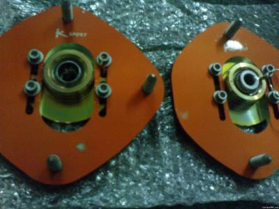

since making spacers did not work. I think I will modify the shock absorber it self. I sent ksport email two days ago about shipping it & no answer yet. I have been informed by them before that these are for there shock & not any other. this is why I asked before buying.
the original spacers are two each side, What about modifying only the bottom spacers only?

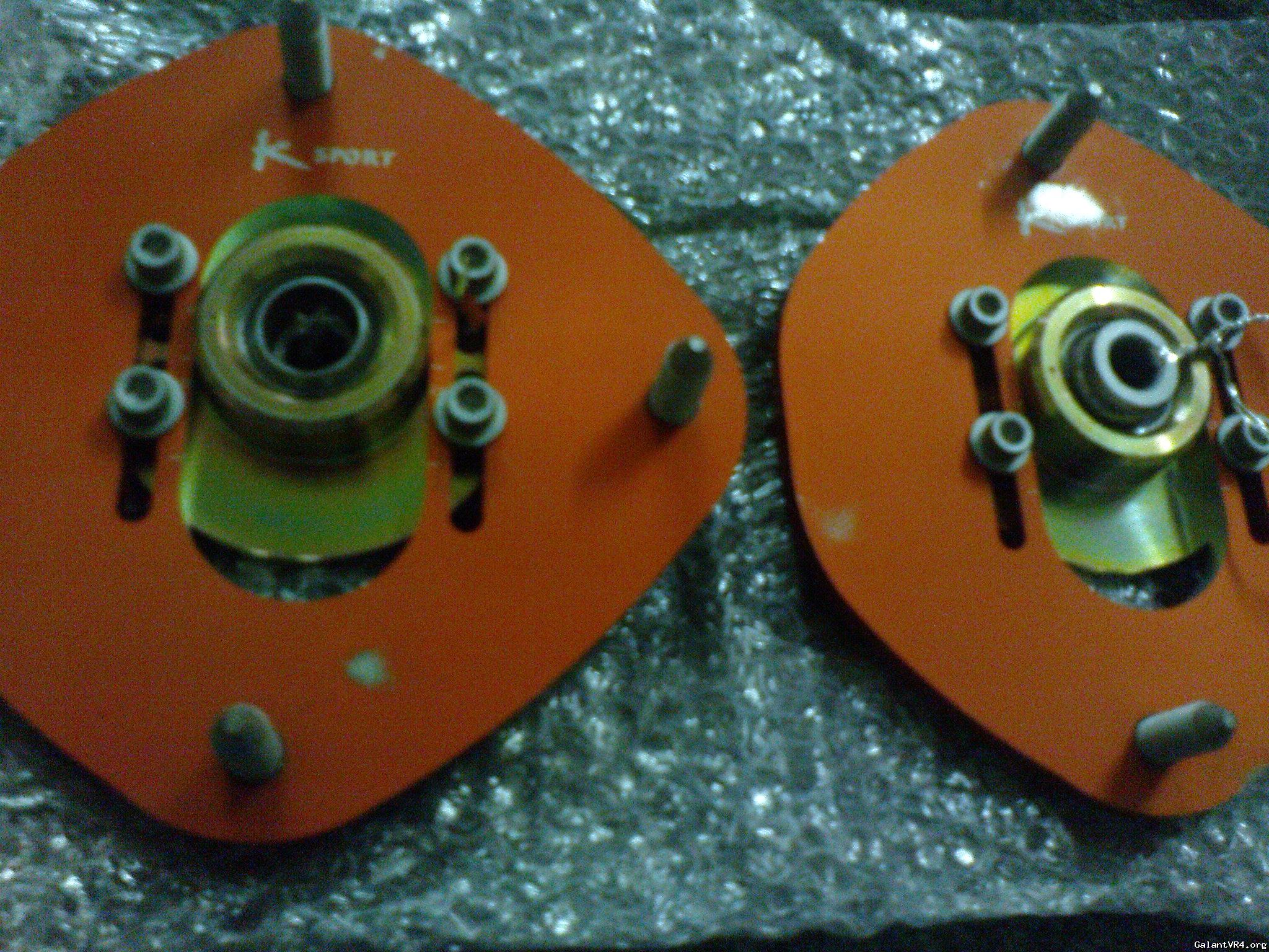

I just want to confirm receiving the item and report that the packing was very bad. The two mounts was hitting each other during shipping and one bushing is lost. There where some holes on the box. It may shipped on a horse. I need a bushing to fit it I will try to make one. Also the ksport sign printed on the wrong place on one of the mount.

/ubbthreads/images/graemlins/uhh.gif /ubbthreads/images/graemlins/uhh.gif /ubbthreads/images/graemlins/uhh.gif That's the worst packing job ever! I'd be down for getting into contact with Ksport and trying to talk them into getting some better quality products to its customers. Three sets of camber plates, all arriving in consecutively worse condition... poor job Ksport
EDIT: Apparently they have a 1 year warranty. I'm sure if you wanted to pay shipping costs you could get them to send you new ones without missing parts.

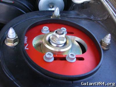

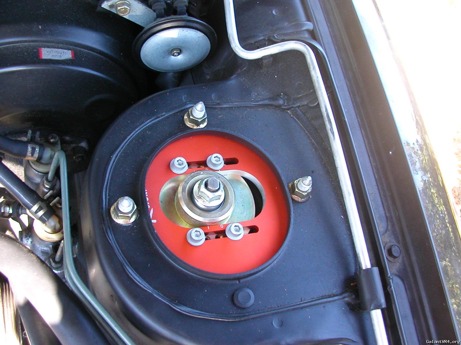

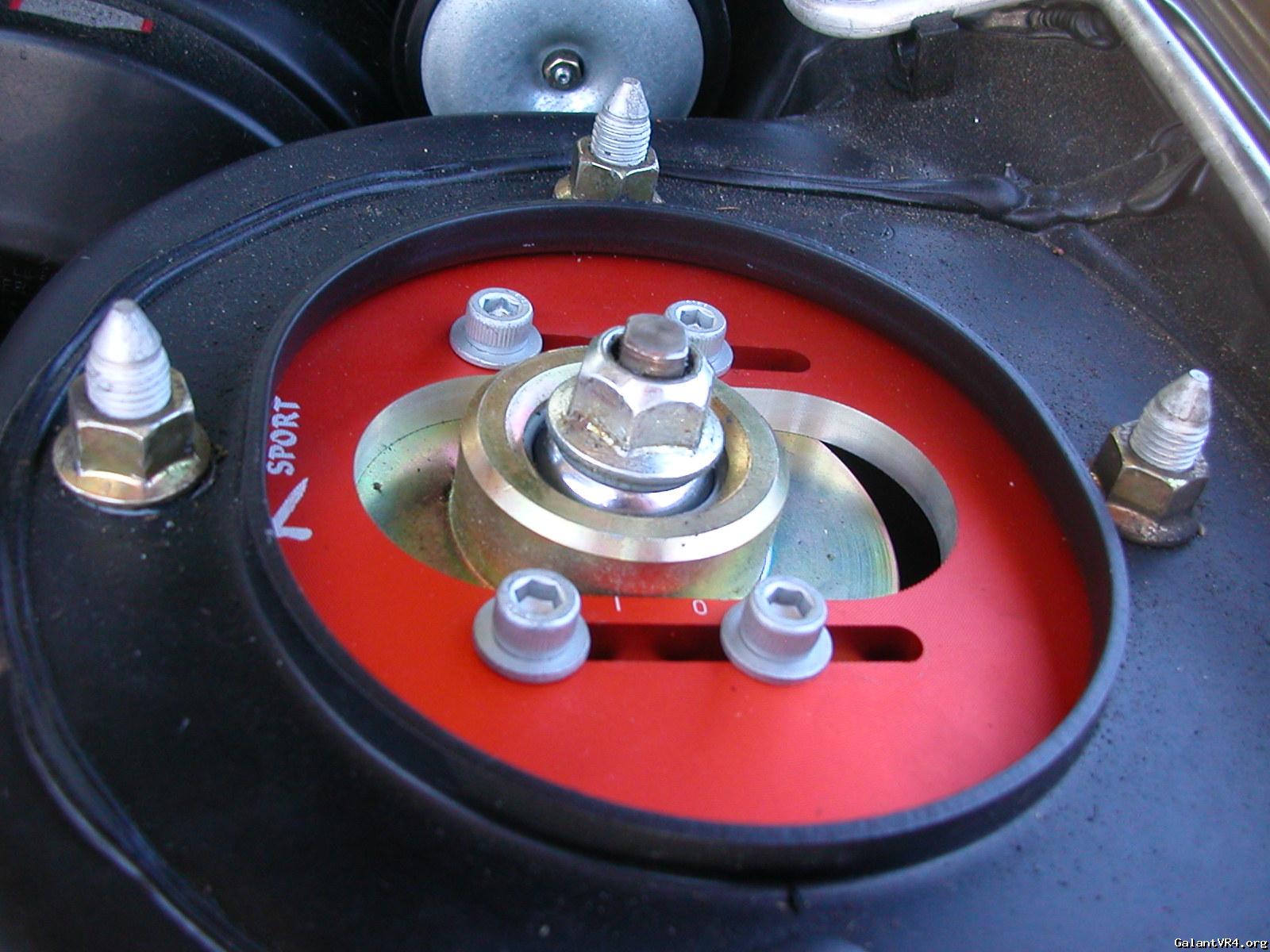

Here is my driver's side installed on an evo X front strut (be mindful that because I was using this strut I had to do quite a bit of modifications. I have explained them earlier in this thread)
