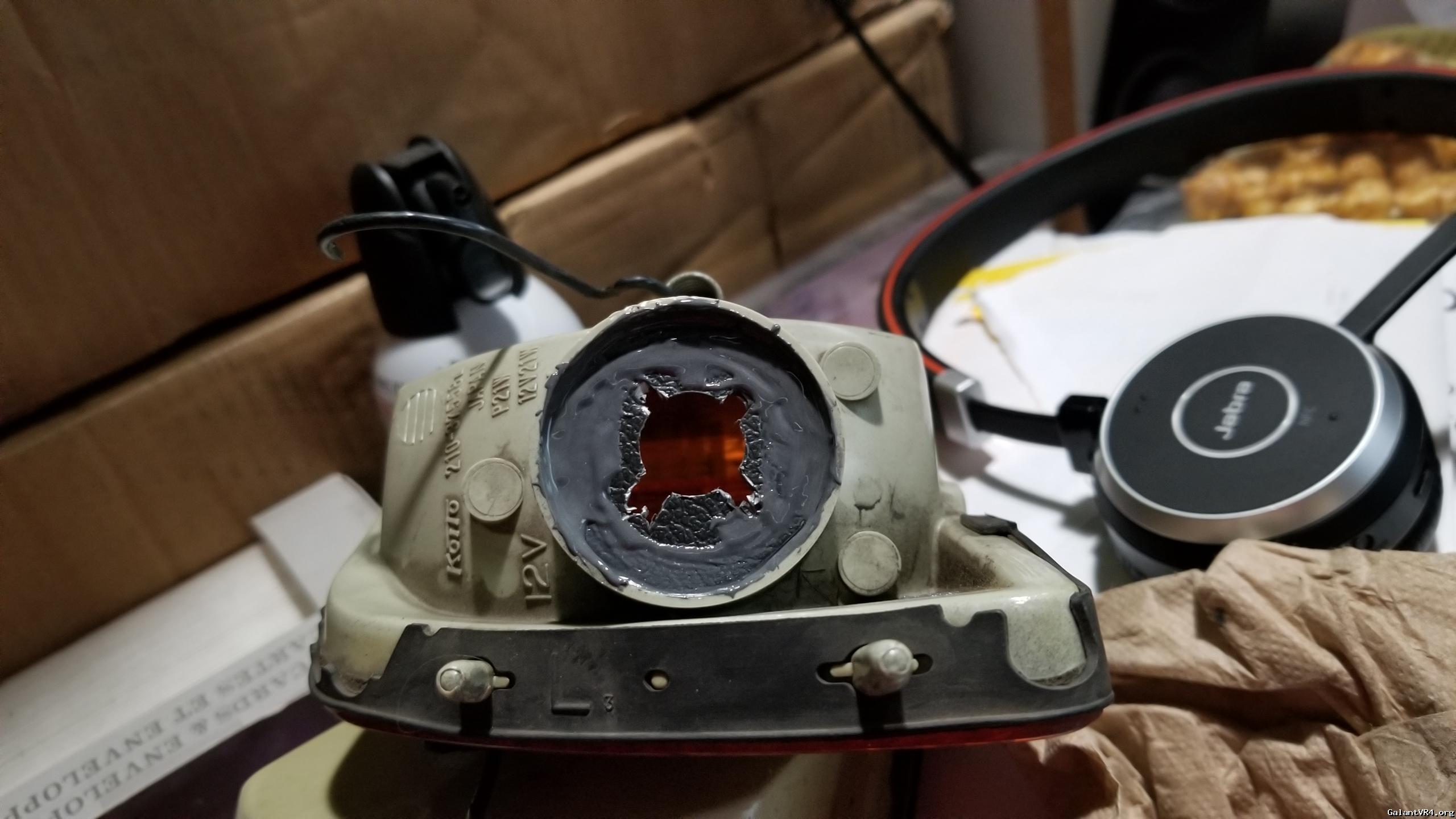

I just made a template for the factory bulb socket and glued it into the larger hole, so the factory corner bulb and socket fits.

That's a genius idea. I also have a JDM bumper so I'm looking to make the corner lights the driving light as well as the directional.

I believe, if I run a grounding wire from the second bulb, I can make a spot for the other light that goes into the corner, there is plenty of space.
