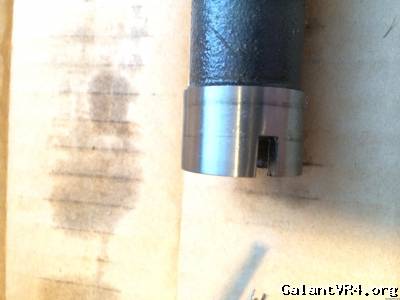

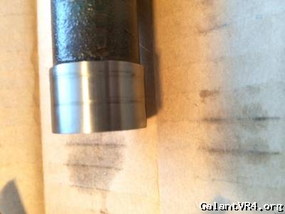

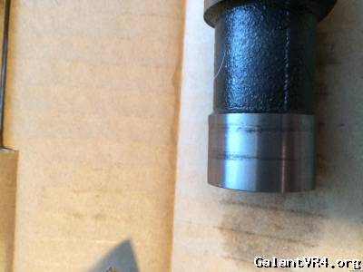

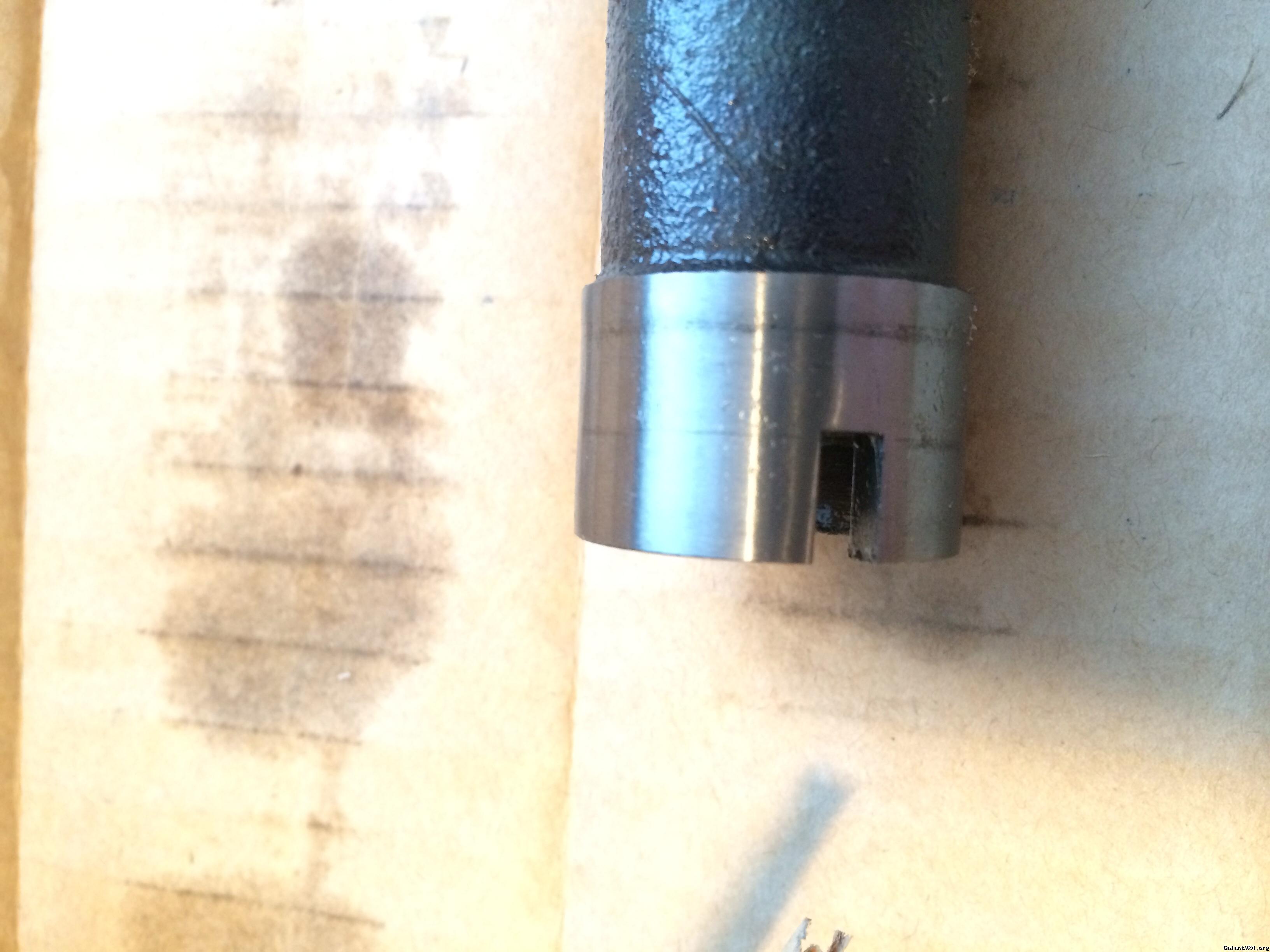

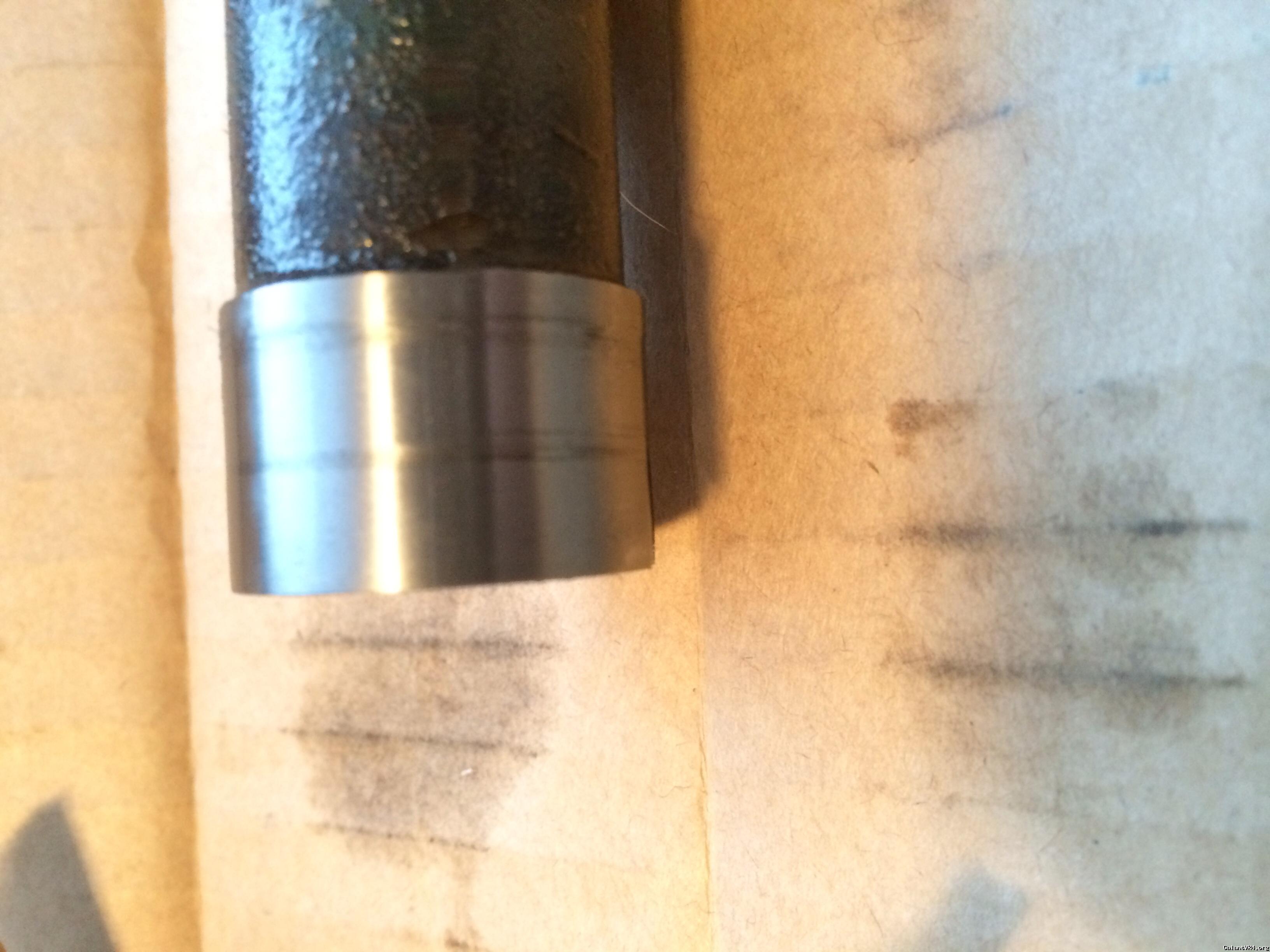

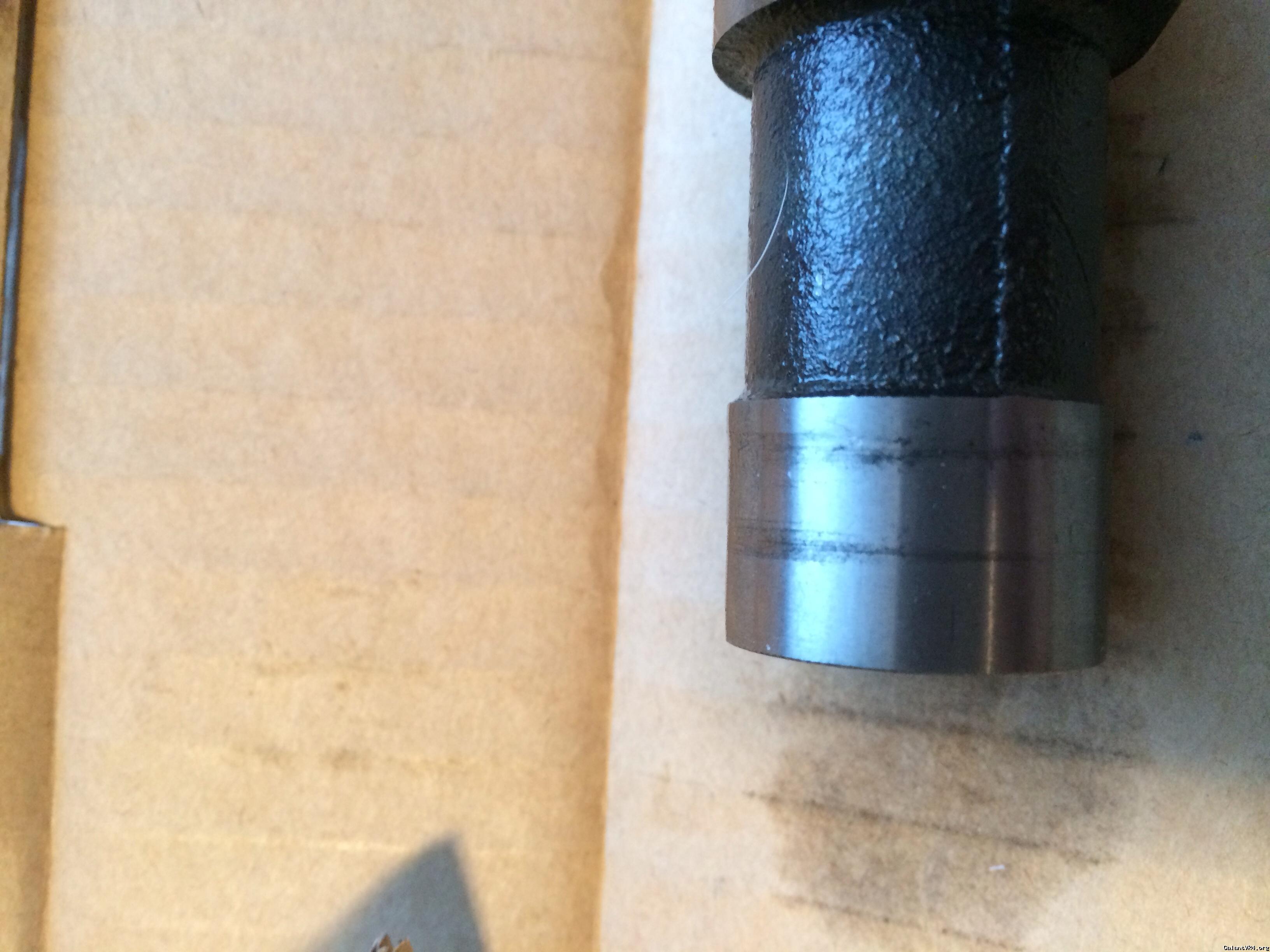

So I just got the cam back and it looks to me like they just cleaned it up. Maybe I was expecting more but this is what it looks like now. Should I send it back or does that look repaired?

Can you feel anything with your fingernail? or is it just discolored?
I doubt they just ground it down, with as bad a groove you had, your oil clearance would be huge on that journal.

Nothing really catches my fingernail, but there is still a slight groove in it. Jon from delta said he would pay for shipping both ways, If I paid an extra 25.00 for the cam welding.

Quoting 14of2000:
Pictures only tell part of the tale, but that looks like less than an optimal "repair"
fwiw, I've had more than a few pieces welded / resized over the years, and they *generally* showed some evidence of being worked (like a heat effected zone) adjacent to the area that was serviced
Have you measured it yet?
I'd also check it for run-out while you're at it.
That will tell many tales.

Quoting 14of2000:
If it is straight and true and you can't catch it with your fingernail, it will probably be just fine. If you are worried, you can have it welded and ground, but I suspect that it is fine. It looks like a little discoloration is all...

I hope Delta did more than grind/polish it down.
That section of the journal does have an oil feed to it, so if all Delta did was grind it down the oil clearance will be too large, and rob oil from the other journals up the line.
If you have a set of dial calipers, measure it, and compare it to the other journals. If it is about .001 smaller you should still be fine, but if you are like .005-.010 send it back.
