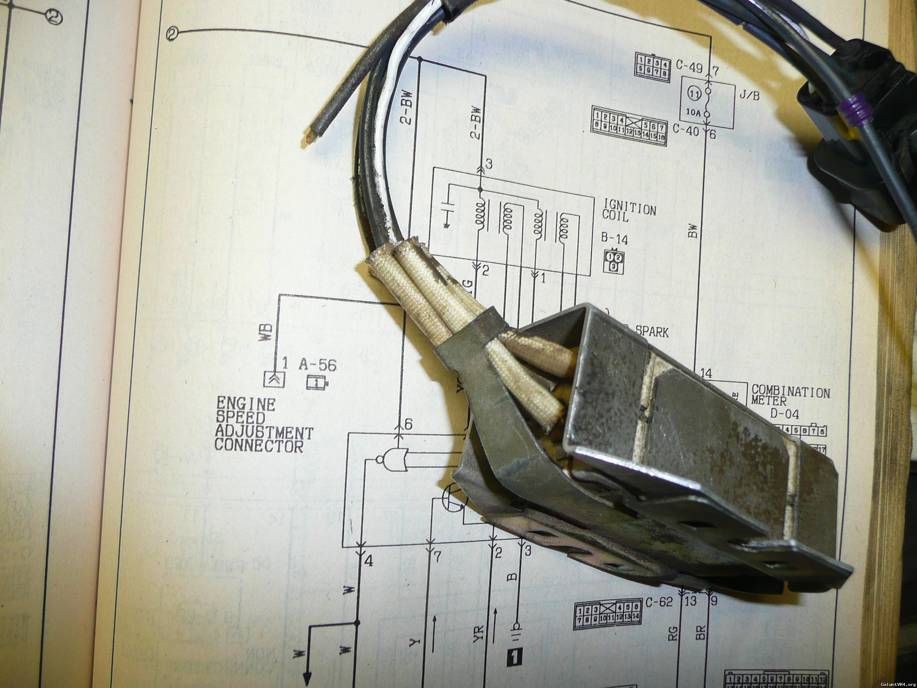

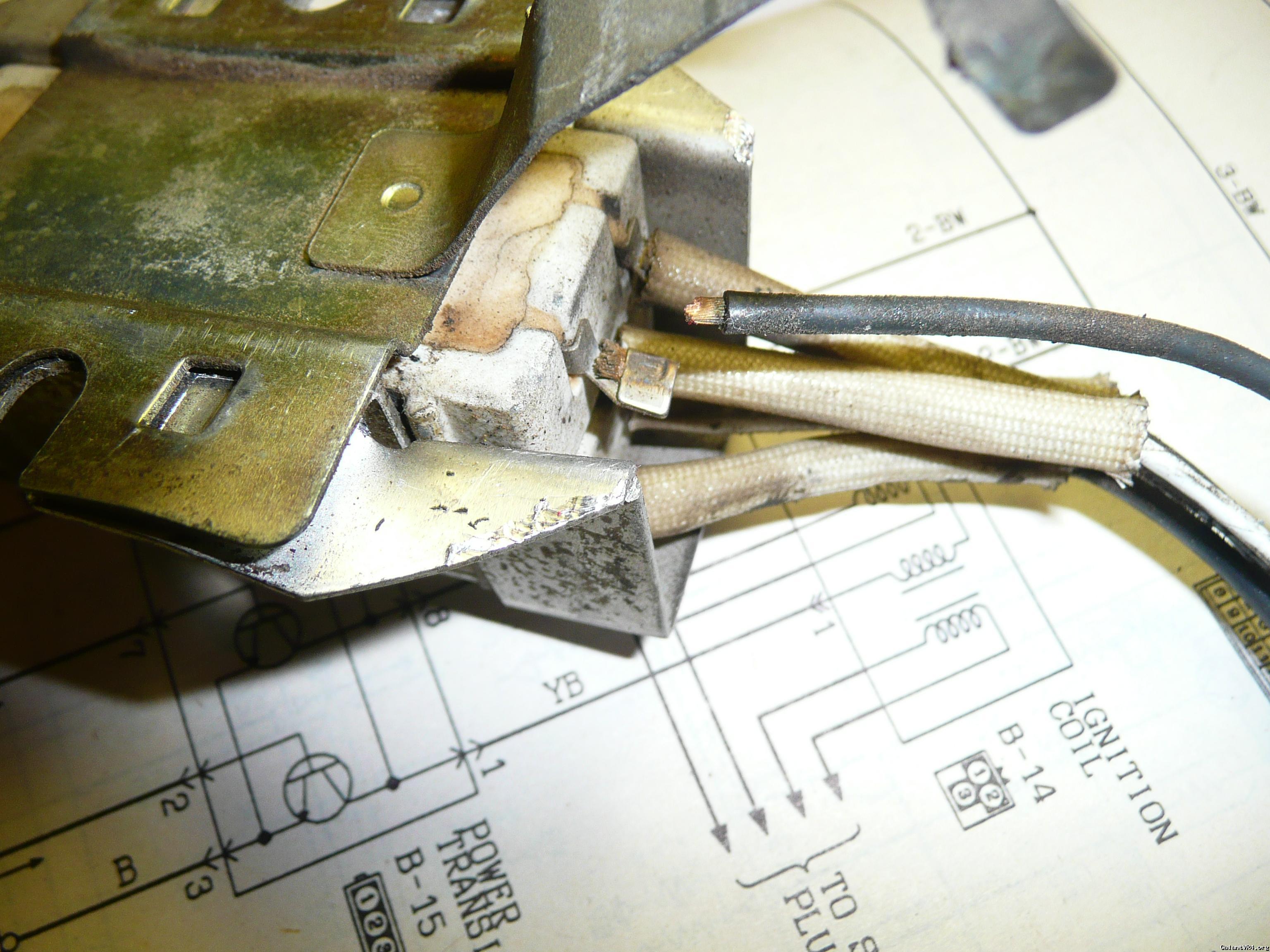

Another place for a single injector problem is at the injector resisitor pack.
The wires can break at the tab where they connect to the resistor (under the white sleeve).
The resistor itself can also go bad.
The pin can also back out of the connector where it joins the main wiring harness.

I wonder if a Dsm 1990 resistor pack would work on the galant ?
Should work fine. According to CAPS the resistor pack for all 1G's and GVR-4's are the same.

Steve, CAPS says all DSM (1990-1994) resistor packs and the GVR-4 unit are the same. The original DSM part number was MD127666 but is replaced with MD172146 which is the GVR4 unit.
