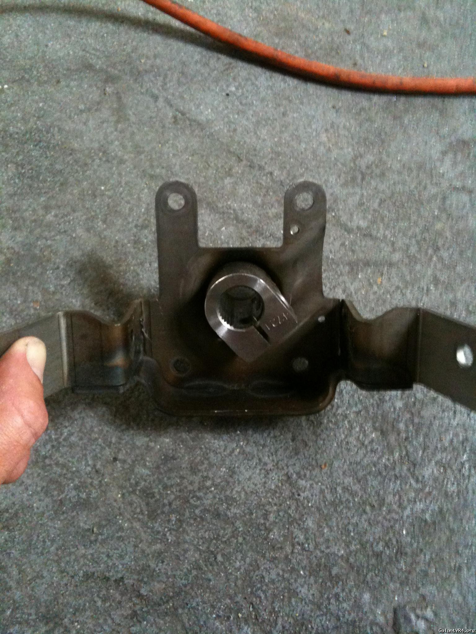

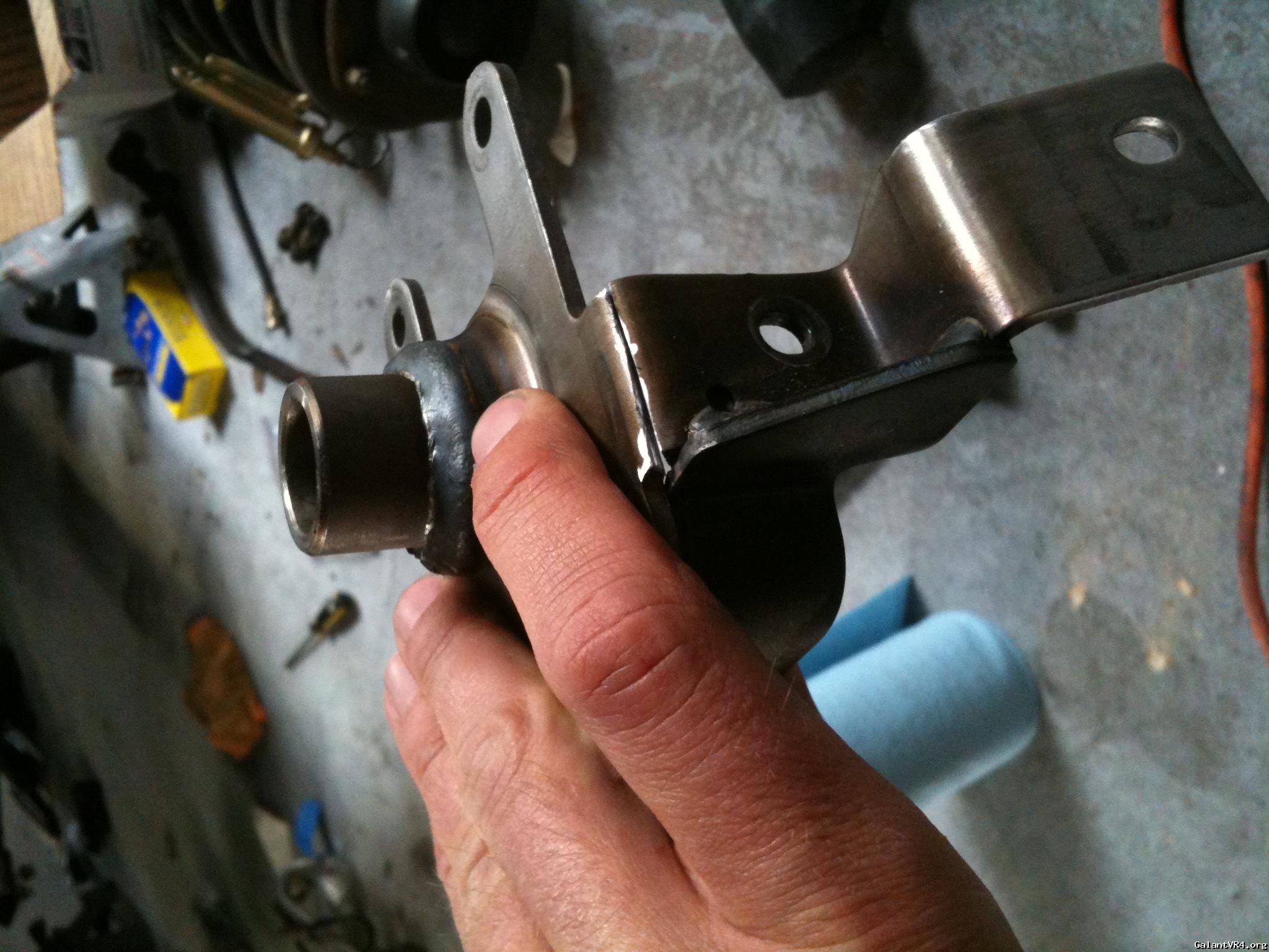

So, it was simple really... Take the hub from the EVO wheel that needs to be removed to install the adapter plate and grant hub and simply hack off the part of the bracket the airbag/horn mounts to and bolt it back in!
Before

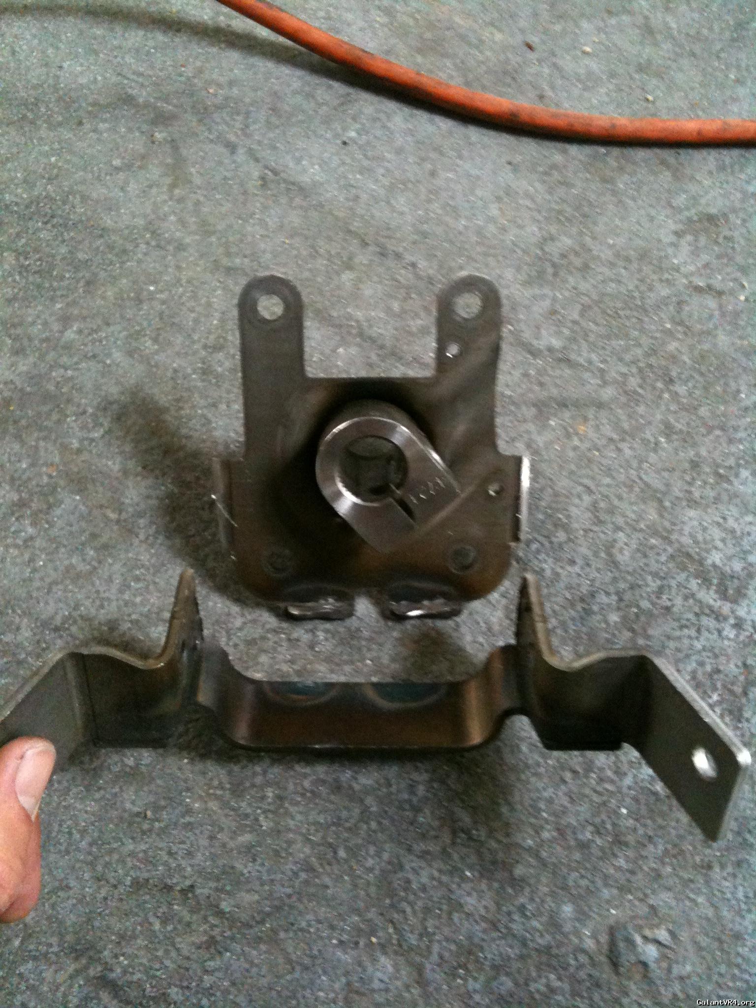

After

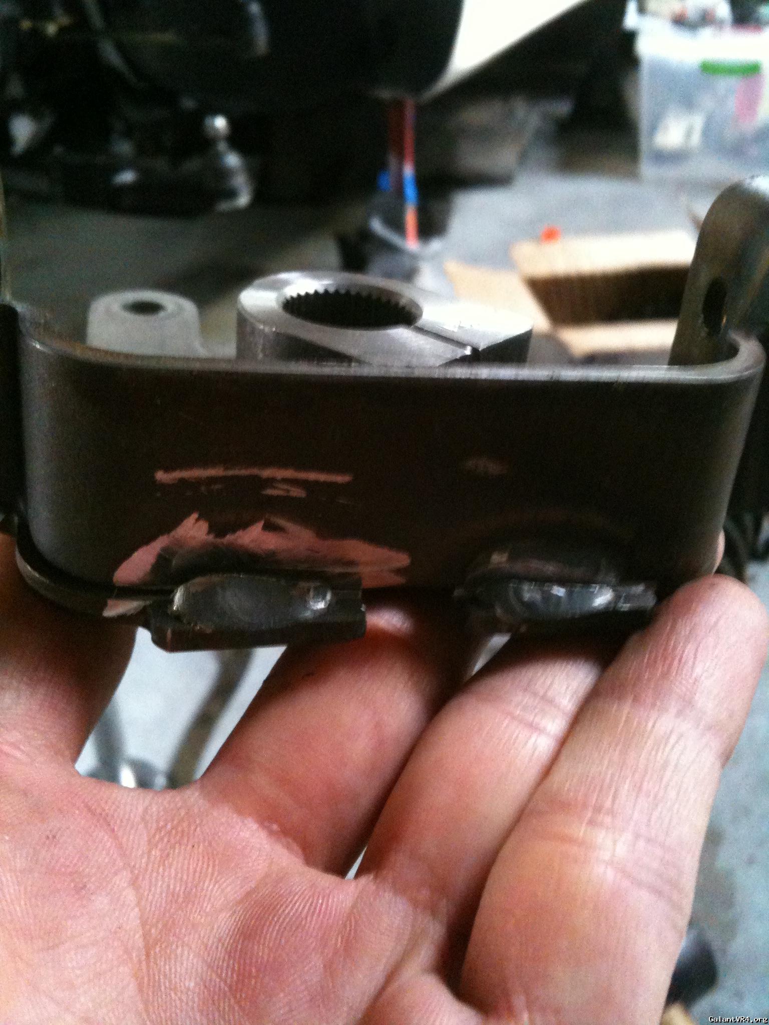

I just made a cut down the sides and cut through the two welds on the bottom with my dremel and trusty metal cut off wheel. Didn't take long at all.

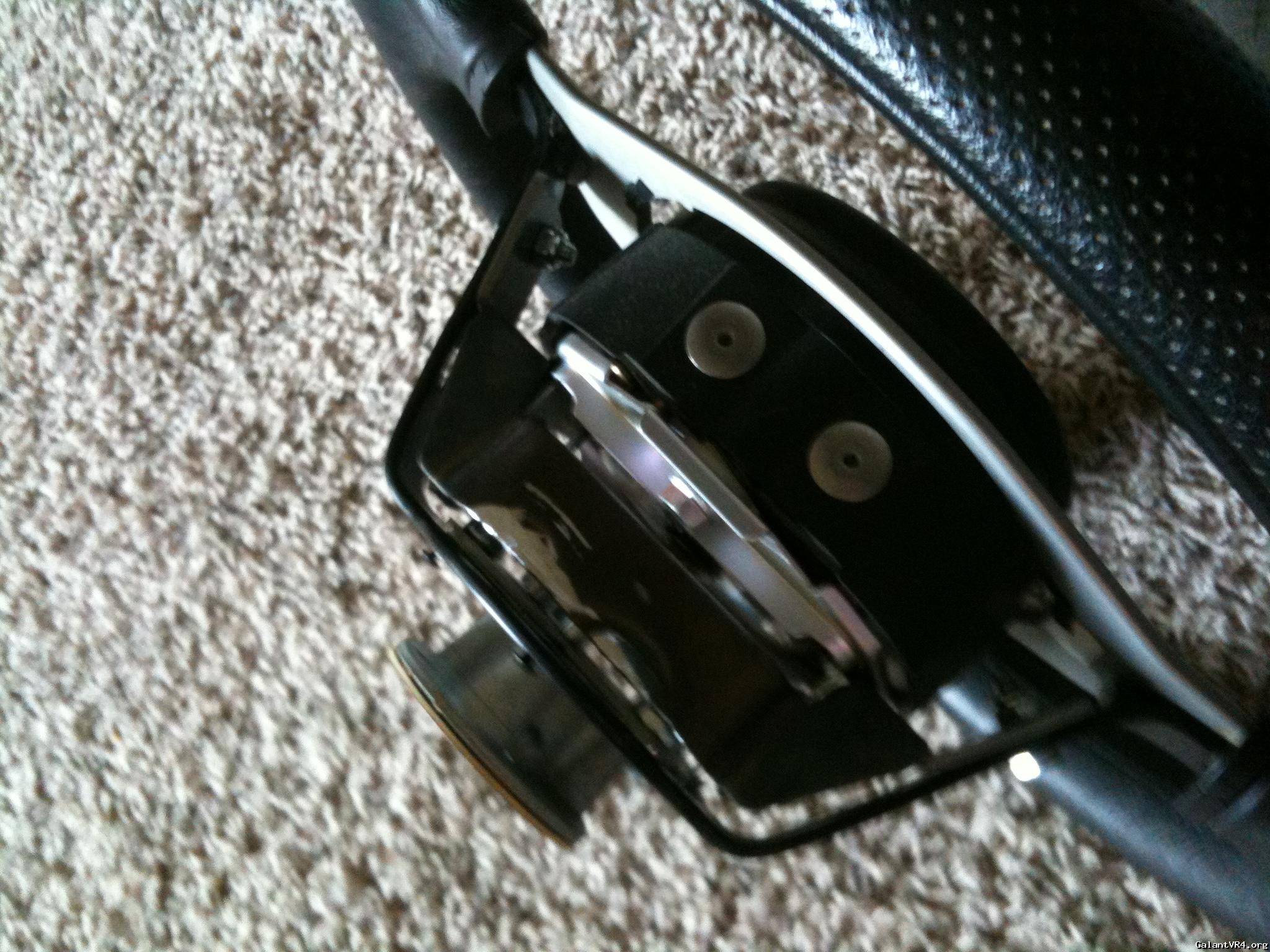

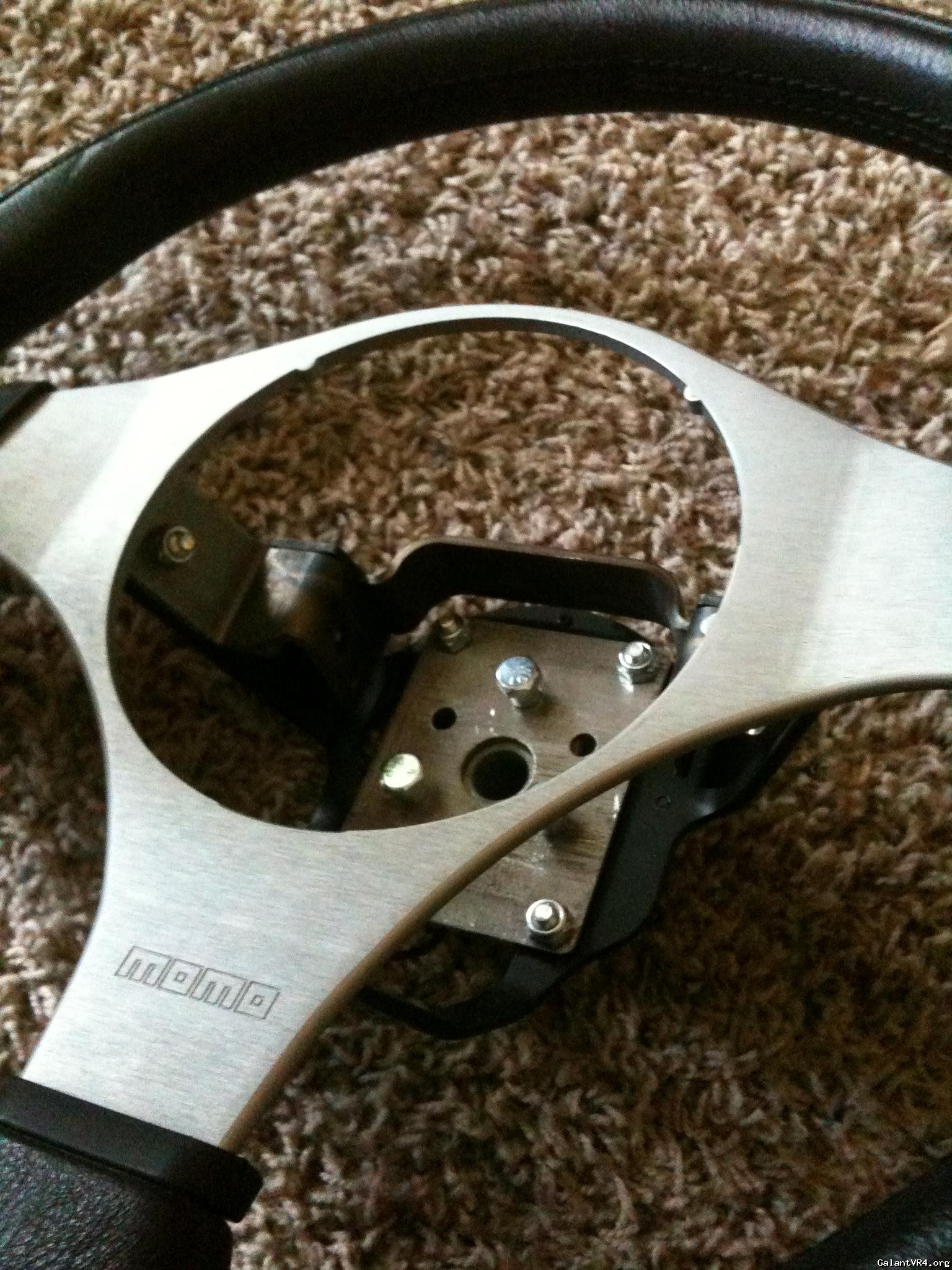

...and the modified bracket back in...
VIOLA! Horn button.

My horn works. I posted what I did above.
A little more detail... the hub adapter had the contact ring in the back and a wire lead for a horn. All I did was attach a male spade connector to that wire, then cut the connector off the horn wire on the evo wheel and attach a female spade connector, plug the two together to make the connection. Done. BEEP! BEEP!
