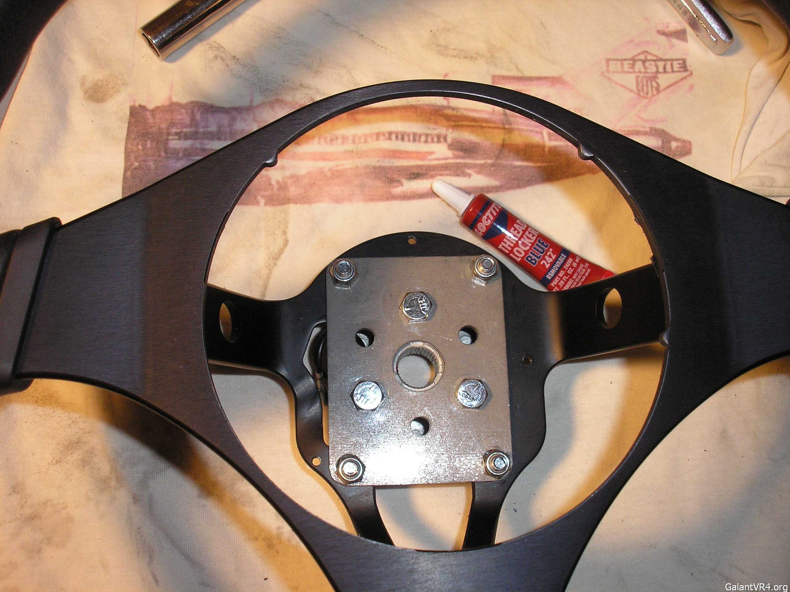

I got it to work !!
all you need a Momo adapter and a good Friend that's an engineer

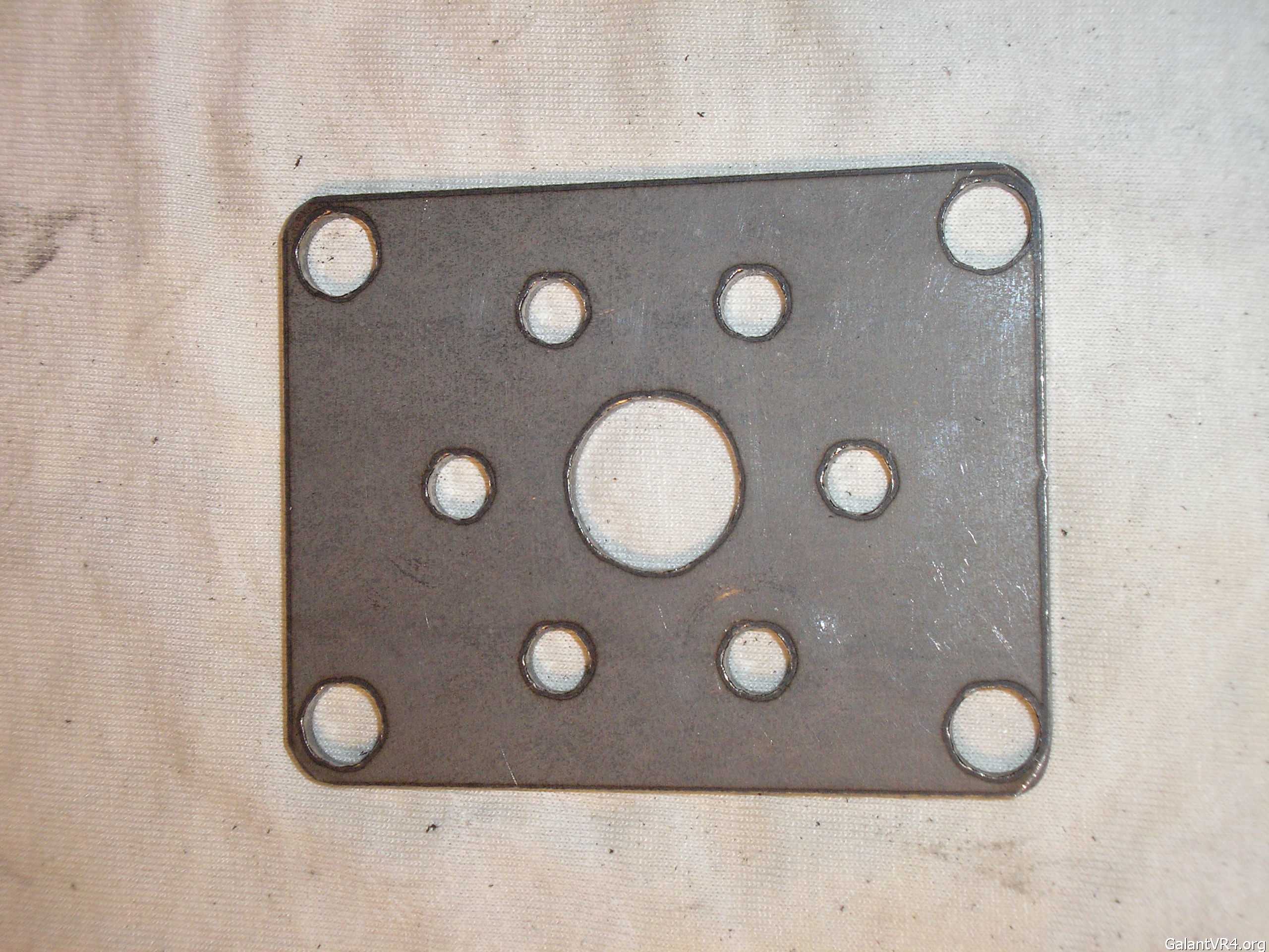

if any one is looking for the mounting plate we made let me know and I'll talk to the guy that cut it for me.
I'll have pics up by the end of the day.

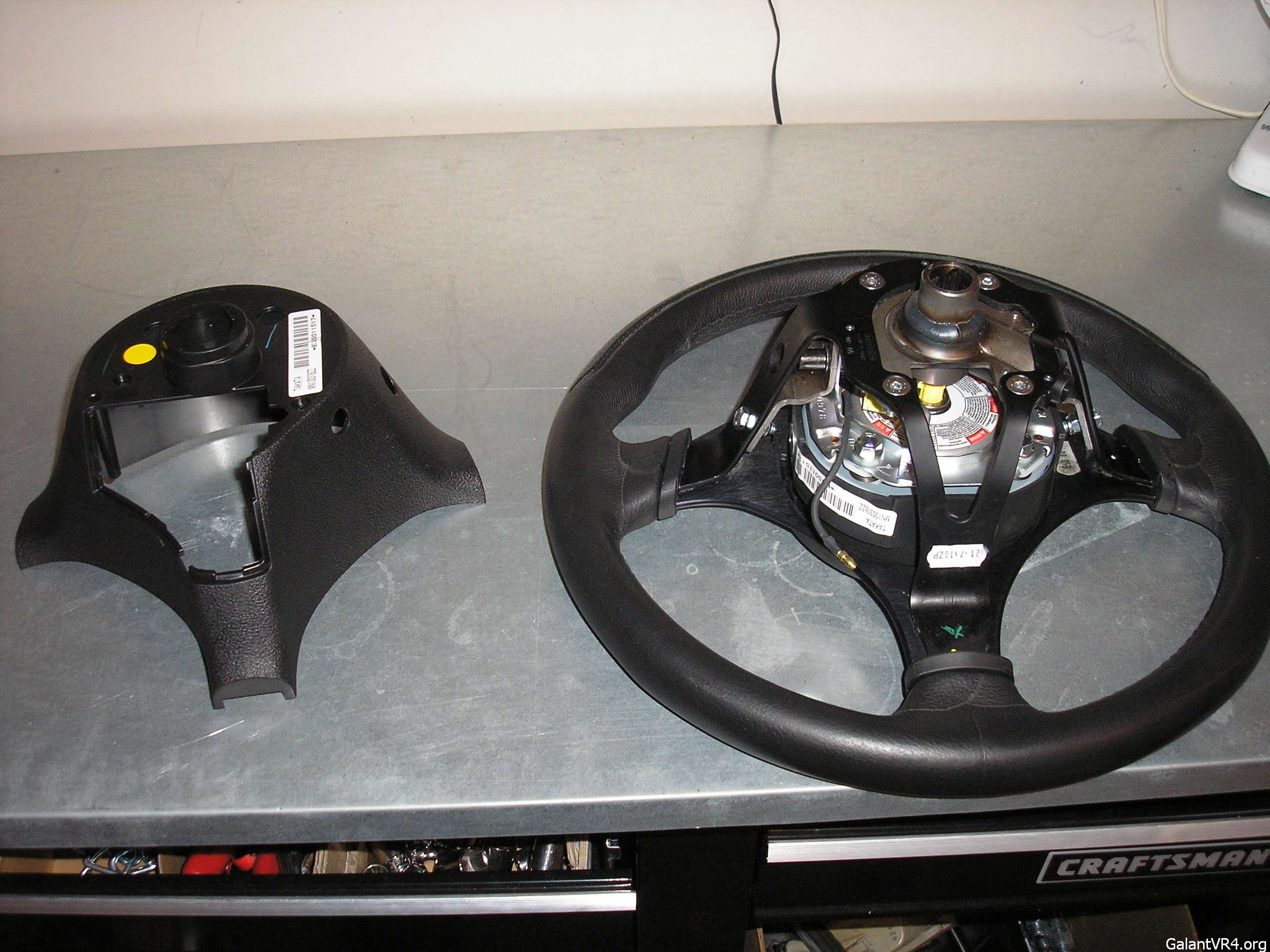

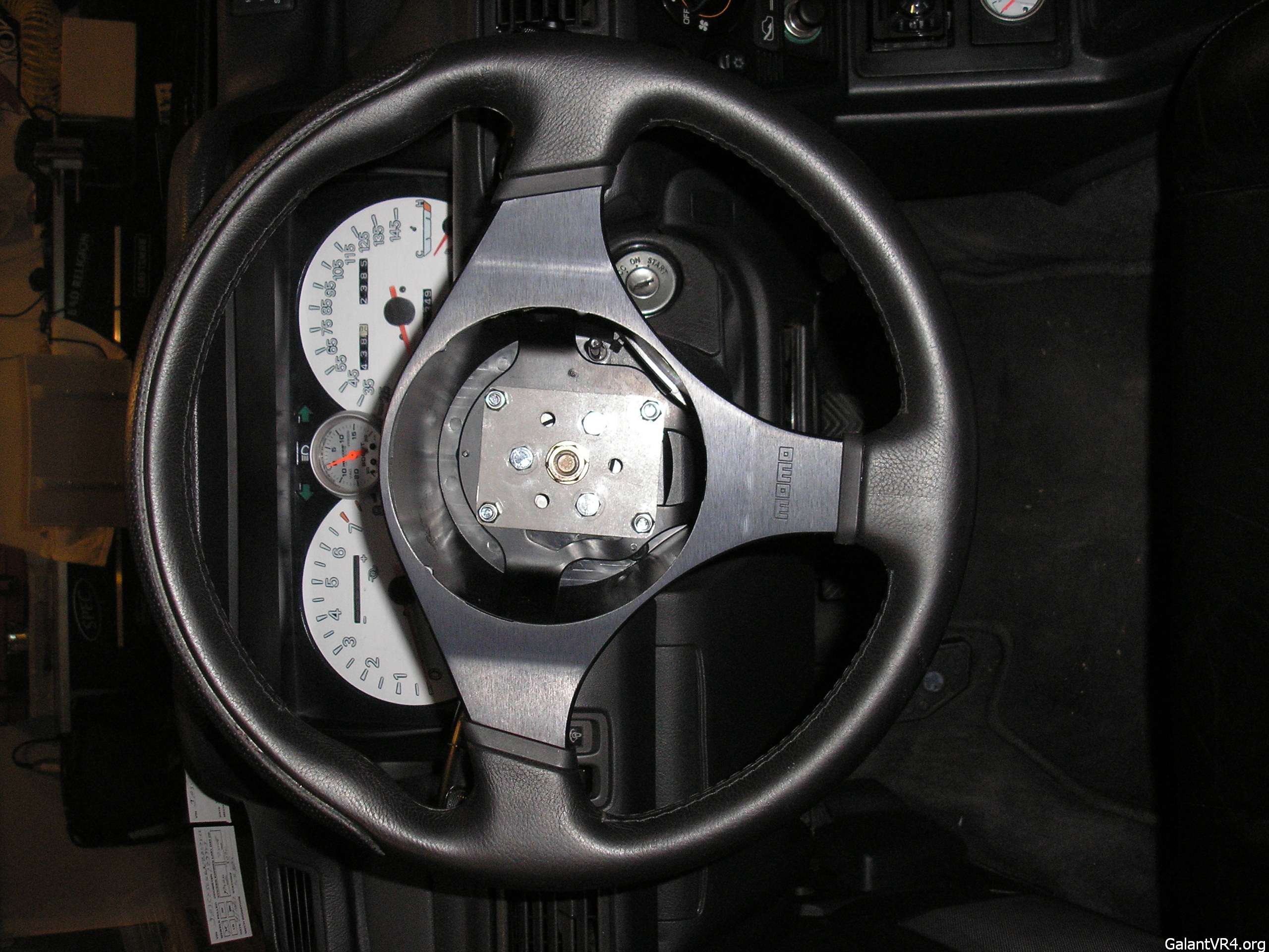

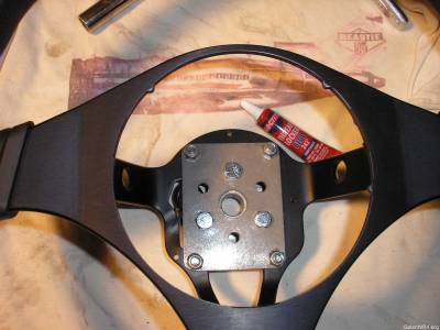

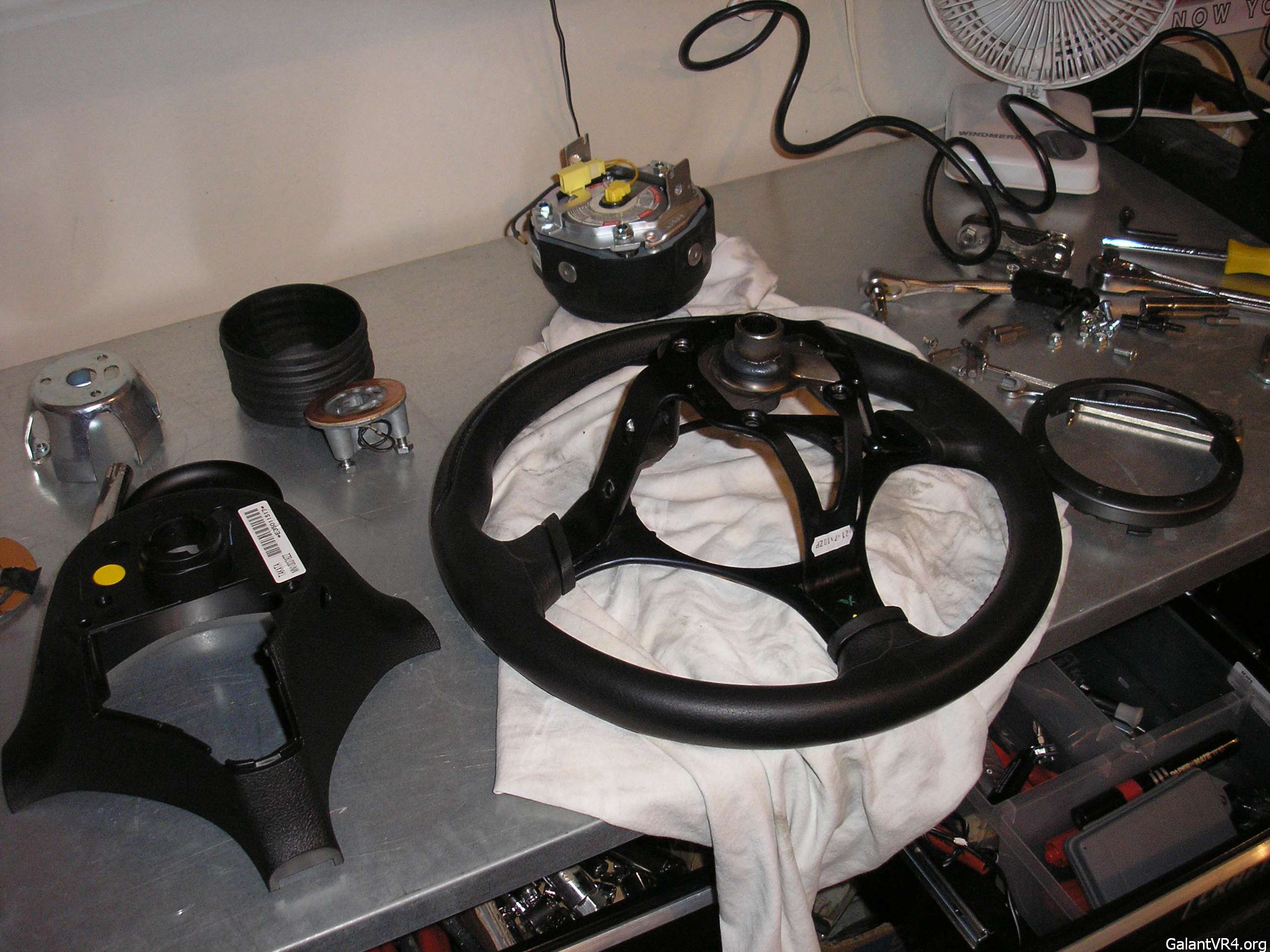

There are 4 bolt holes that hold the air bag in. So what I did was have a plat made that I could bolt up to those holes, you will need to remove the airbag also you will need a Momo adapter to then bolt to the plate. Reinstall the back cover and thats it slide the wheel with adapter attached over the main steering bolt and your good.

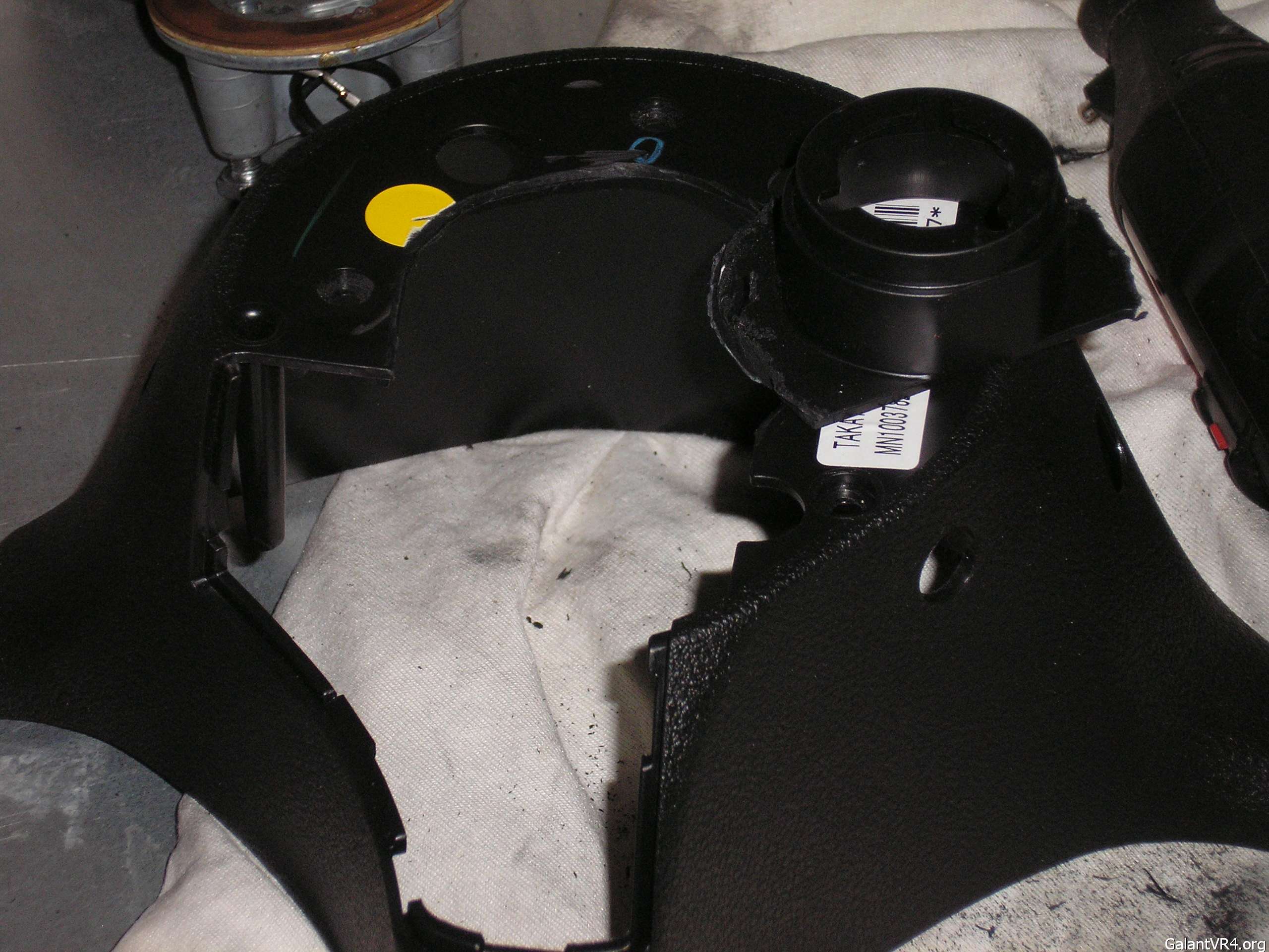

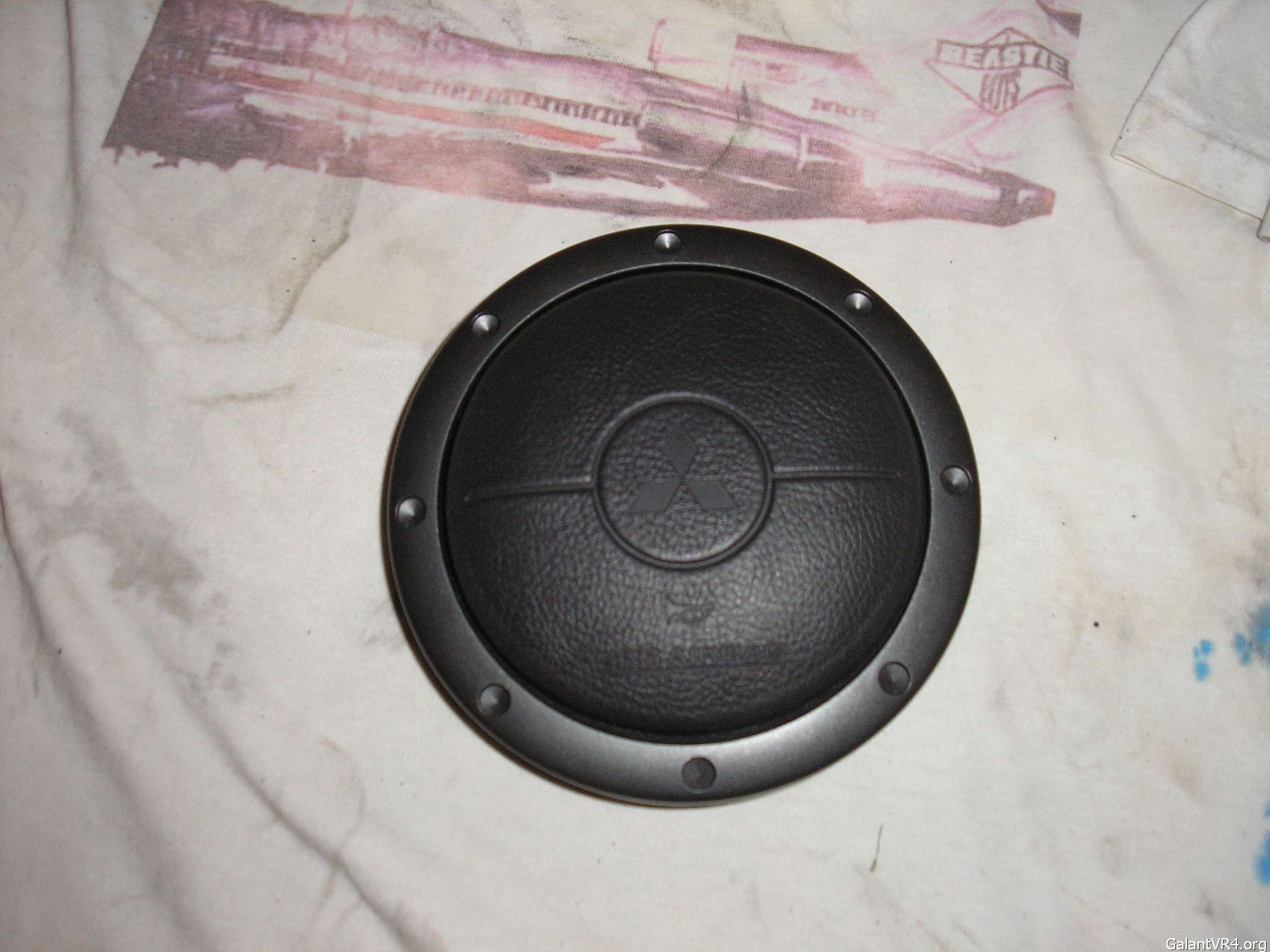

Take the ring that goes around the airbag and the airbag cover it self and epoxy them together, then they will snap back on the wheel. Be careful when removing the the ring you don't snap the clips. I used a Dremel with a cut wheel to cut the cover from the airbag.I would lock tight all nuts and bolts but the main one.
