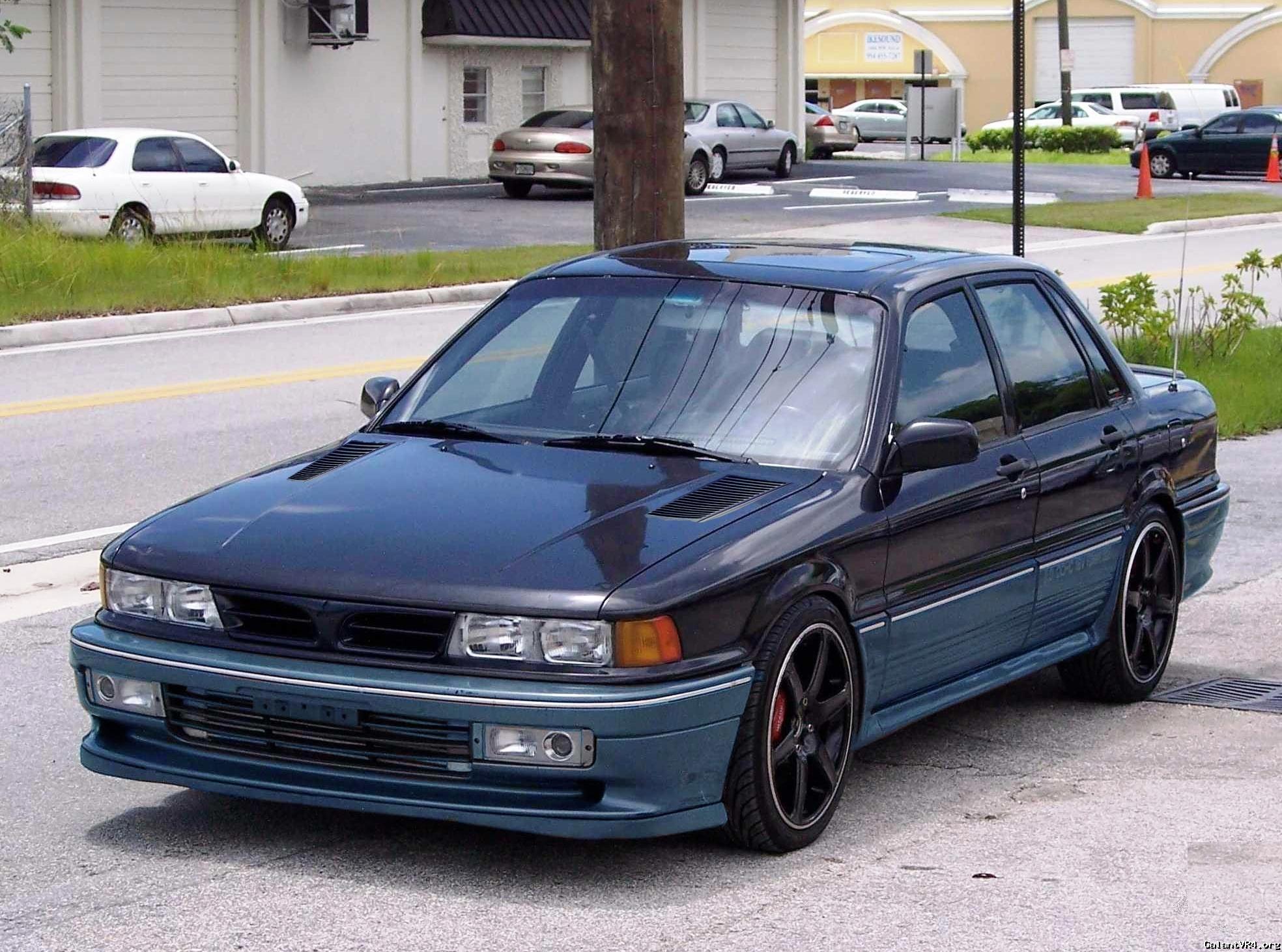

really been wanting to make or buy some functional and good looking hood vents, i wanna see what everyone here has seen or come up with.

seen some of the gt500 vents, and not really a huge fan. really like this one, and the evo 3-4 vents.

After slating the OP of that photo stating that those vents wouldn't be very functional, I actually became a real hypocrite because I started to like the way that looks. I found a set of vents almost identical to that but one side was missing the drip tray beneath it.
It wouldn't be difficult to duplicate a drip tray for the other side. The vents themselves have some surface rust in places, so would need some tidying up plus either paint or powder coat. I think they would look good but I'm still not sure how functional they would be mounted pretty much right over the strut towers.

yes it wouldnt be as functional as a vent like the evo8 but it would still help with underhood temps. it would take alot of work but they could be made functional.
