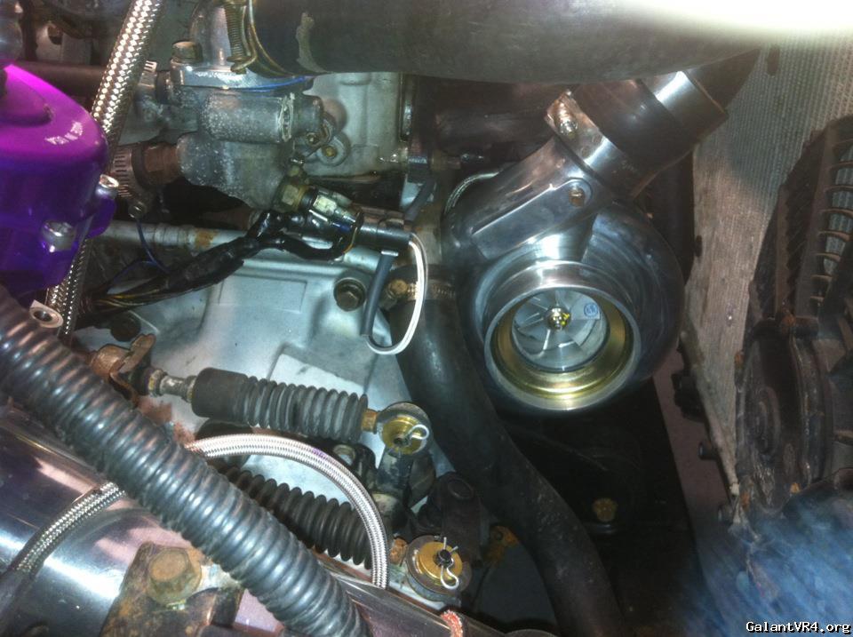

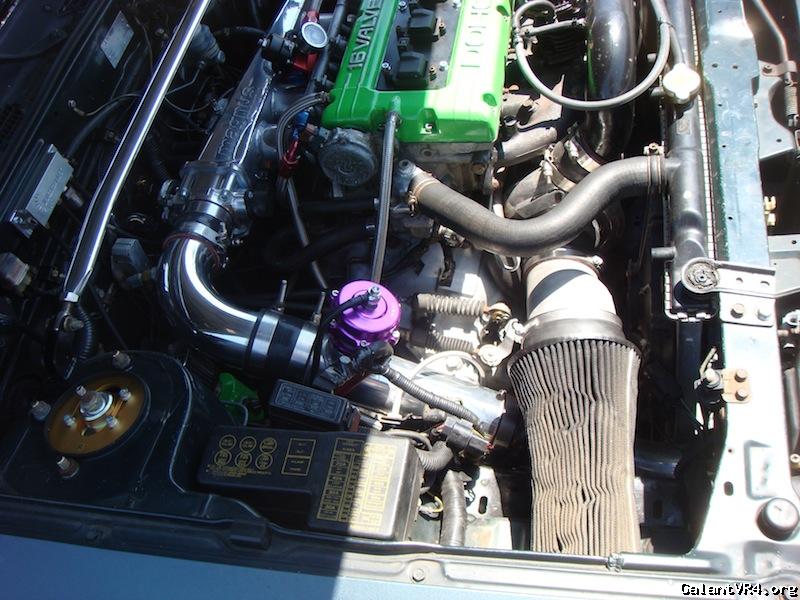

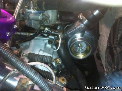

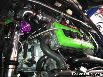

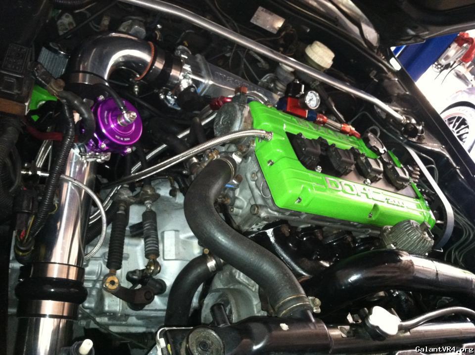

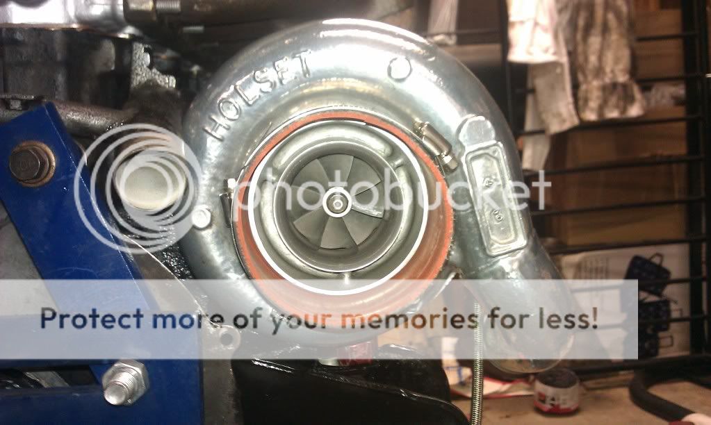

Been rocking a BEP hx35 since March 05' and love it!! Prob one of the first in Chicagoland to use it.
The turbo has been reiable for me. Had it rebuilt only twice in 7 yrs, [once on GP for when my oil filter spun off during a highway race and metal ran through it.And the other time for alittle shaft 'play'/scored bearing],Both times basic rebuilt by Jeff @ TurboAuto in Nashville,TN.
Curtis ported it and welded an alum elbow on it. /ubbthreads/images/graemlins/applause.gif
Turbo hits full boost @ 4k rpm, stock bore,w/272's, JMF Race smim,63mmTB,Wiseco's/Scat Rods,stock head,etc,etc...
I'm only running 20psi[baby boost LOL] on pump gas & Im happy with the setup!
pics from 12/11;
