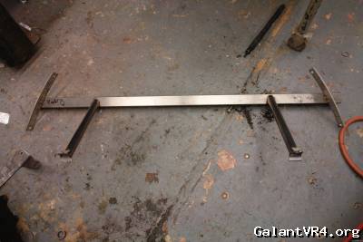

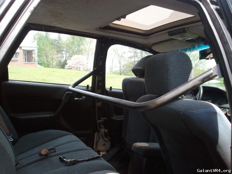

Harry measurement from the b pillar to the bar is 10.5 inches
I laid a framing square on the bar and the shoulder bolster on the recaros and then another square on it and from the center of the seat belt shoulder bolt to the inward side of the bar is 10.5 inches. This was a bar from the original run years ago. not sure if you changed anything or not ....if not thats it. Oh from the little flat area next to the bottom of the backseat corner up to the top of the bar as it runs across the car is 22.5 inches. That way they can figure the angle.

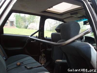

I'm running a bolt in 6 point safety 21 cage. Anybody one of these with one of the cages I mentioned? Not sure id it would clear the hoop.
May 4, 2003
11,892
Clarksville TN
I have one of the cusco cages as well but for a non sunroof car and I have a sunroof. I did set in the front a pillar bar and eyeballed it and looks like it will clear with Harry's harness bar. If not you could always notch and tig weld the two together. This would add additional strength to the chassis
If you want me to set in the A pillar bar and takes some photos's just send me a PM and I'll post them here.
