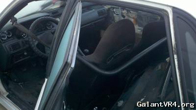

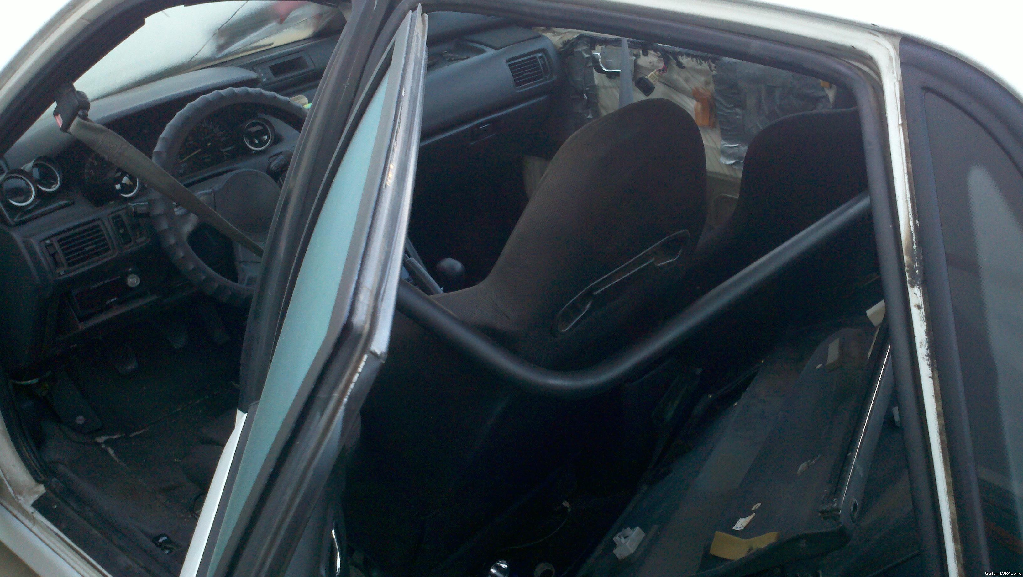

Looks to be the rear seat area of #3 which is caged.
Not sure what that has to do with a harness bar unless it is to show what it kinda might looks like if you bought one. /ubbthreads/images/graemlins/dunno.gif

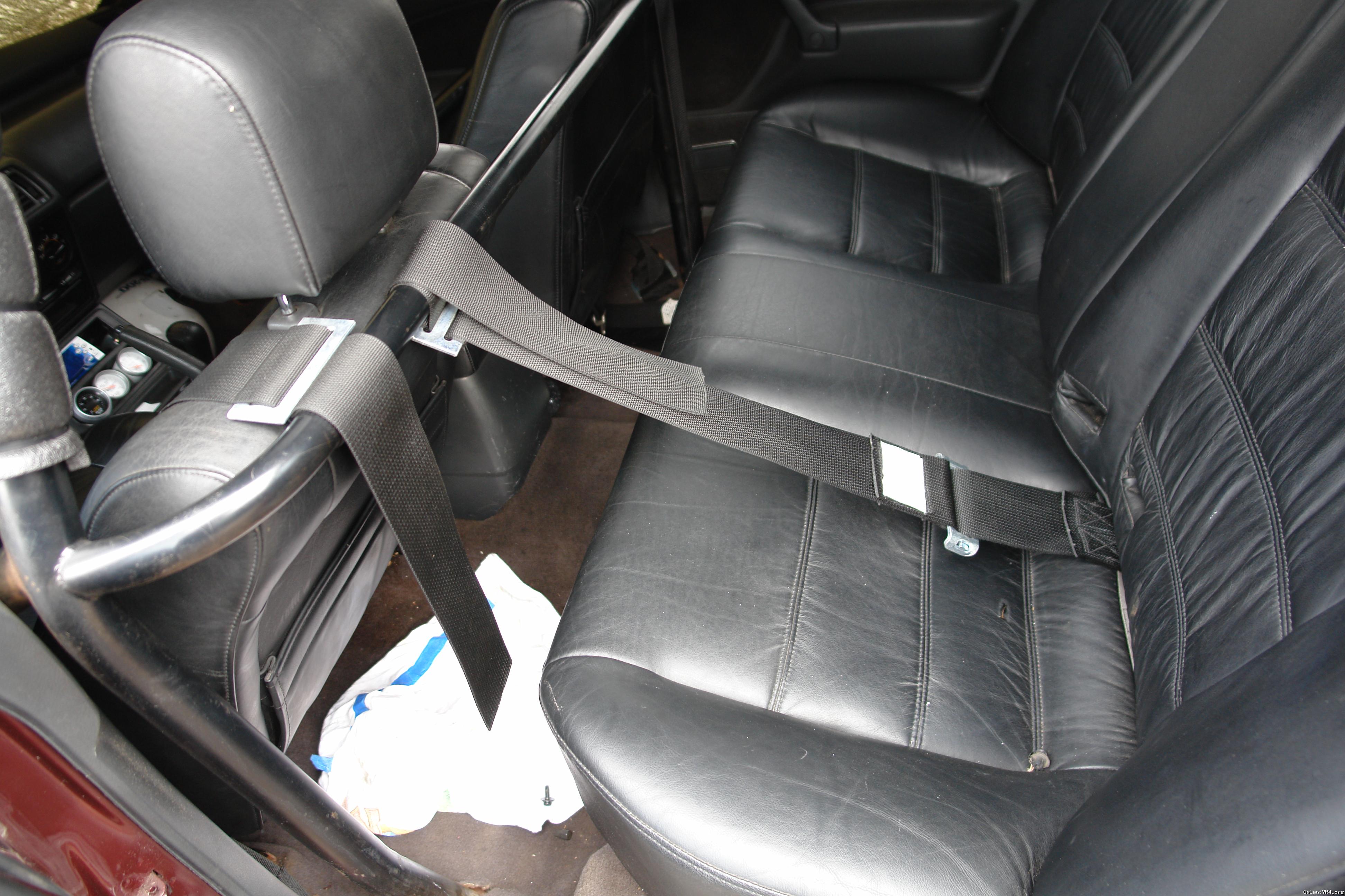

Playing with the idea of straps that could be wrapped around the bar then bolted to the rear oem seat belt mounts for a little extra strength. Any takers if the price is right?

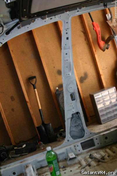

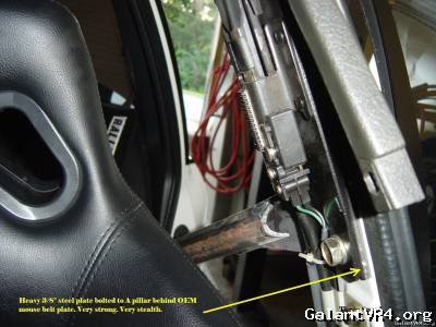

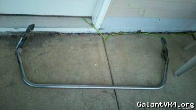

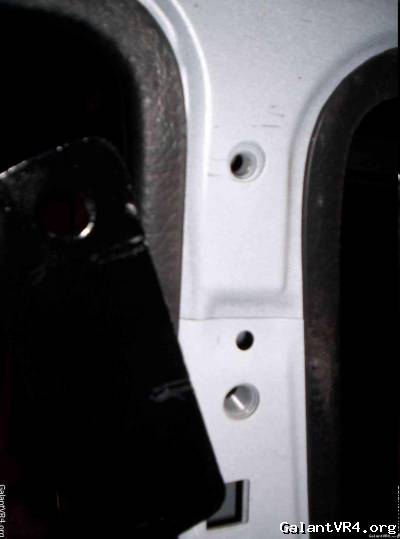

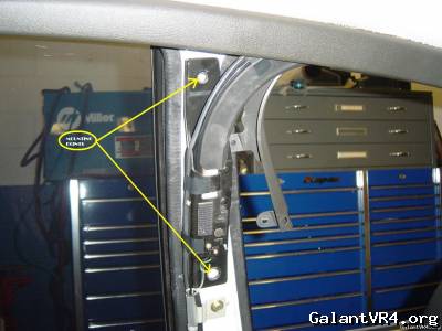

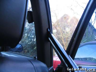

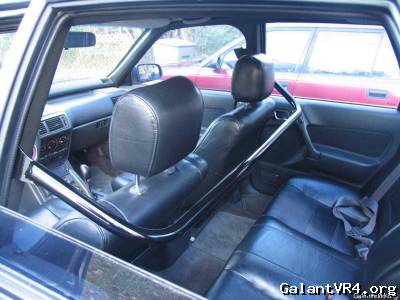

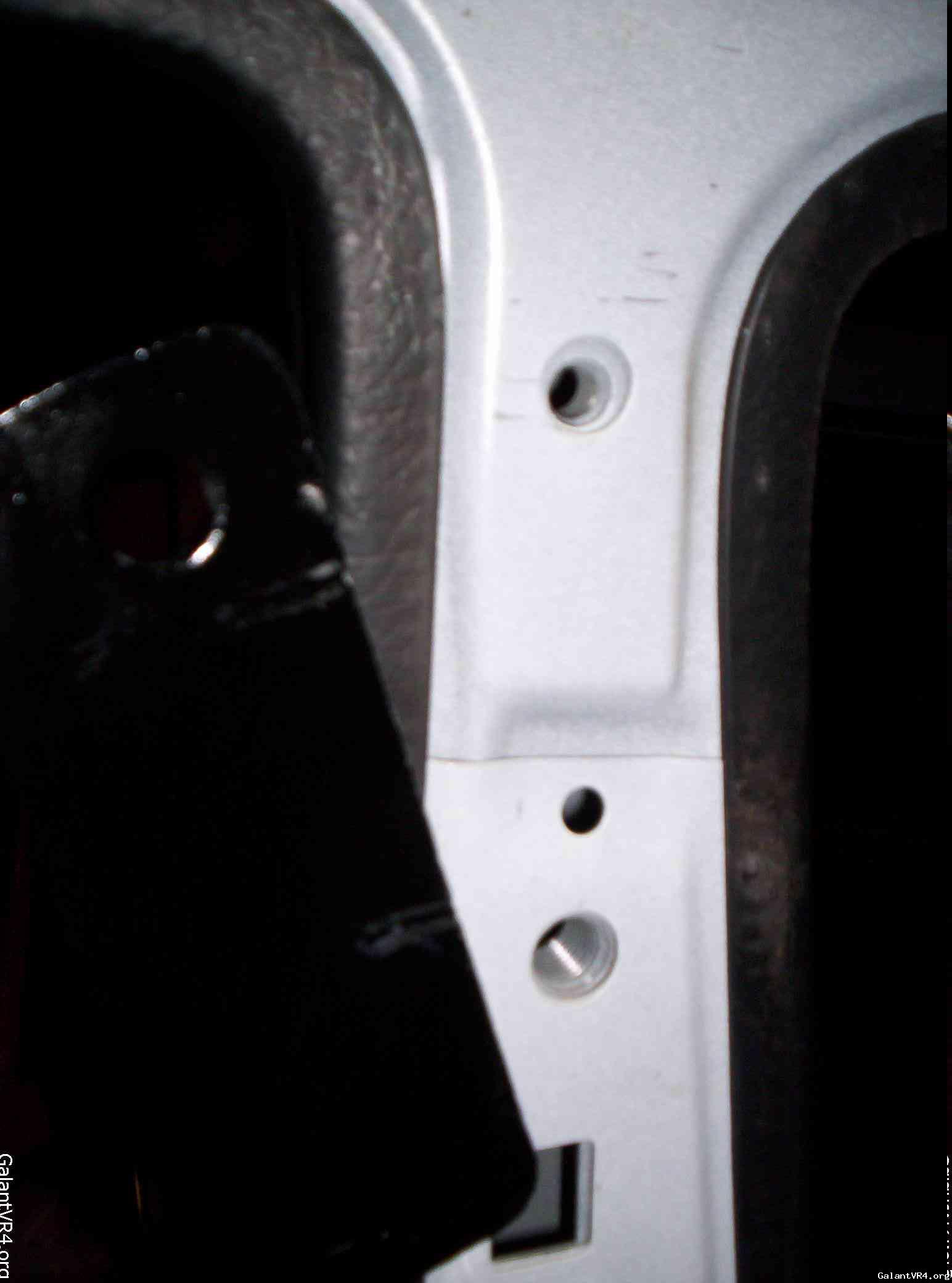

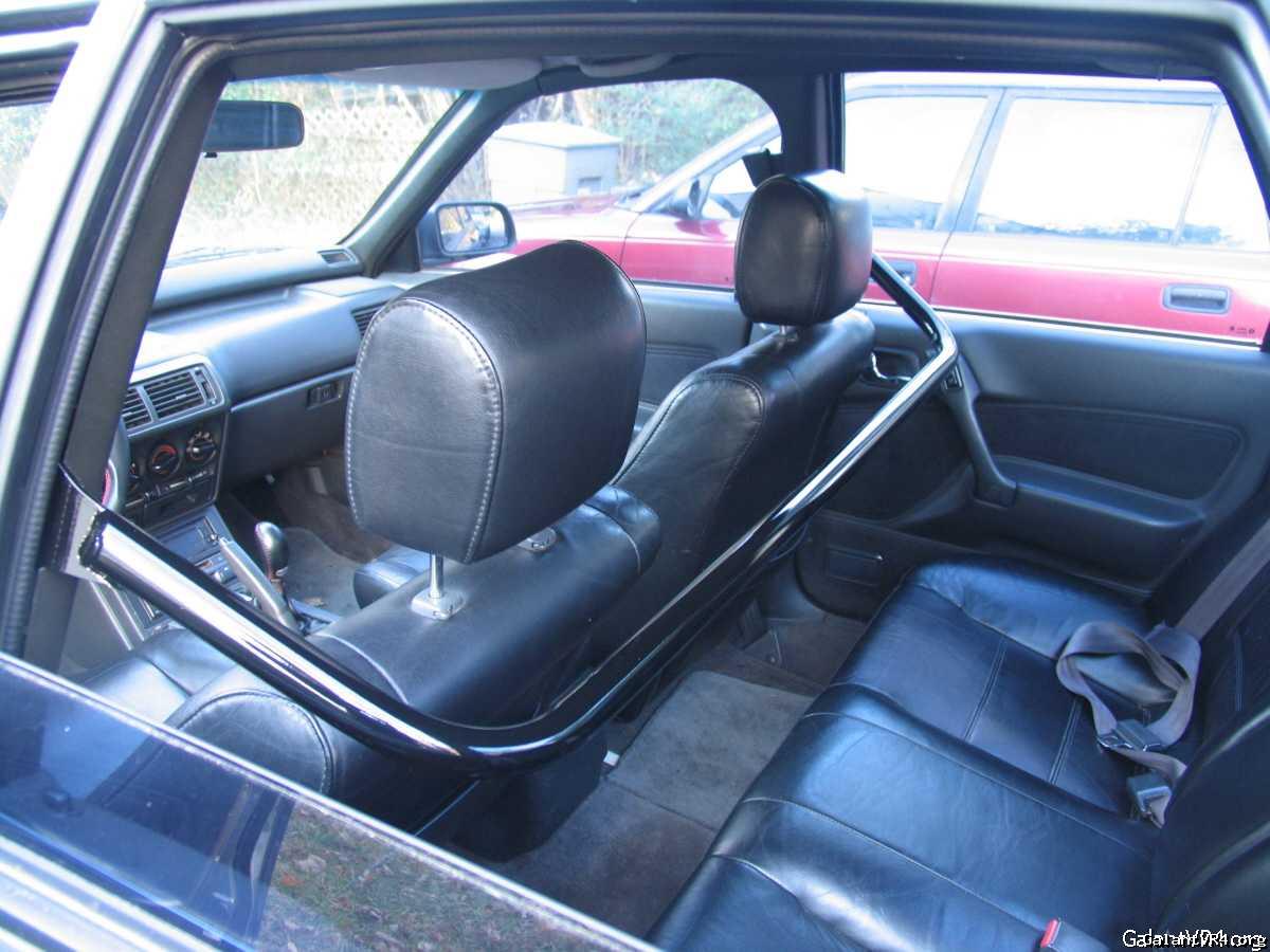

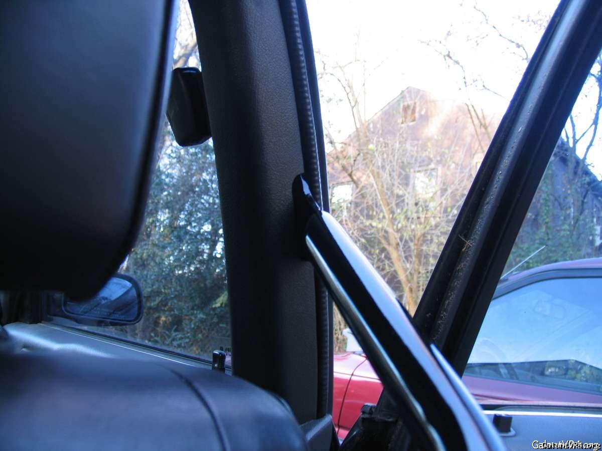

People are asking how does it get installed. Very good question. It is easy. (note the first two pictures are just for reference. You don't remove everything as shown in the photo)

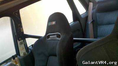

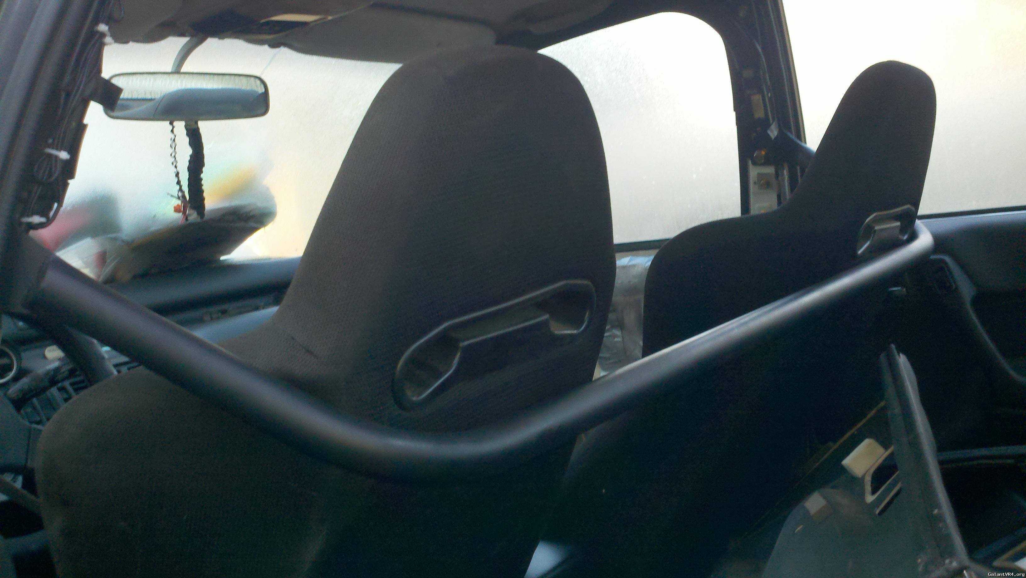

Mine came about 5-seconds after I ordered it but I haven't had a chance to get it installed yet. I fixed my fuel issues first so the car would move and now I'm turning up the wick a bit by replacing my L1R with a GT30. Should have that done by tomorrow and then I'll work on the harness bar.
1870 is down for some debugging and JDM mirror install /ubbthreads/images/graemlins/grin.gif
Thanks #3! fits like a glove!
Yes those seats are ugly as hell, but they work. Still gotta order in my belts.
Edit: The Bar position is right on in my opinion. Yes my seats are all the way back in the "cool guy" position. Not in competition / pay attention position.
This product is better than I thought it would be and #3 nailed the fitment perfectly. I didn't have to pull, twist or hammer AT ALL. Slide it in behind your seat belt rail and use the existing bolts to lock it all down. Perfect and easy.

The back seat view reminds me of the safety bar on a roller coaster... /ubbthreads/images/graemlins/grin.gif
