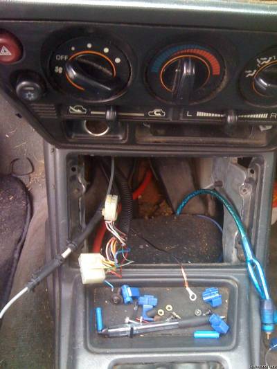

Well here is what the mess looked like when i pulled everything out today.

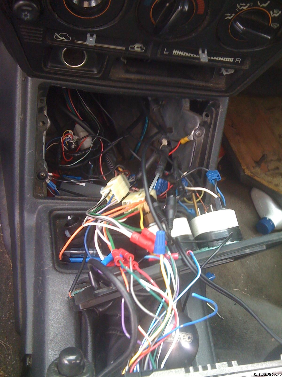

Heres what it looks like now. They only spliced into one wire on the stereo harness so thank god, but it was bad too because the daisy chain of wires is not good. still not sure what it was that caused the smoke, haven't found any signs of burnt/shorted wires.
i touched the positive to the battery just to see what lit up. reverse lights are out but headlights are still on??? maybe i have a stuck relay or something. ill look at it more tomorrow since i ran out of light today.
so after this is done, i have a boost/vac, water temp, and AF gauge to wire back in.
