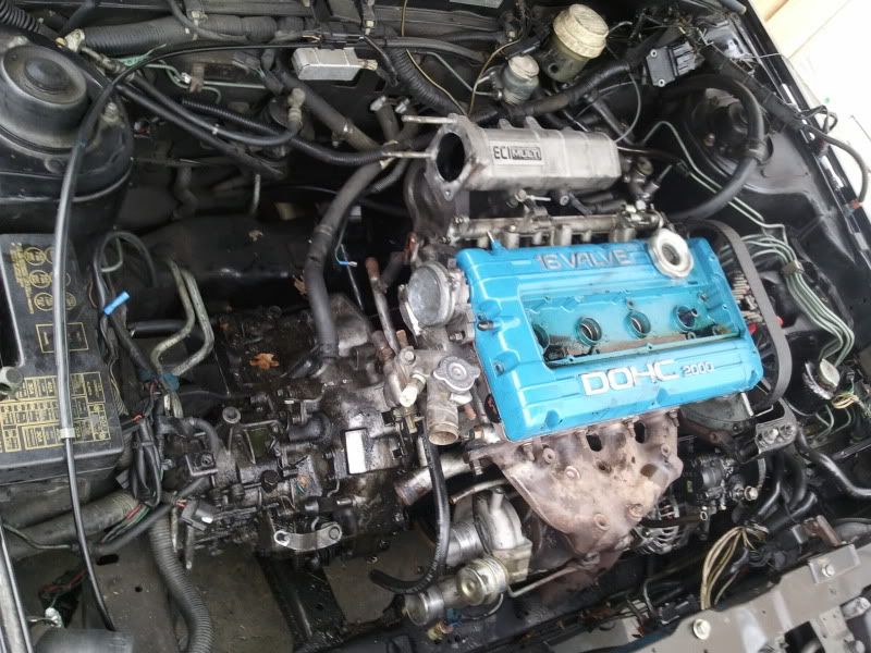

How the engine is sitting at the moment. Got to find a place to pull the old engine and swap some parts over.

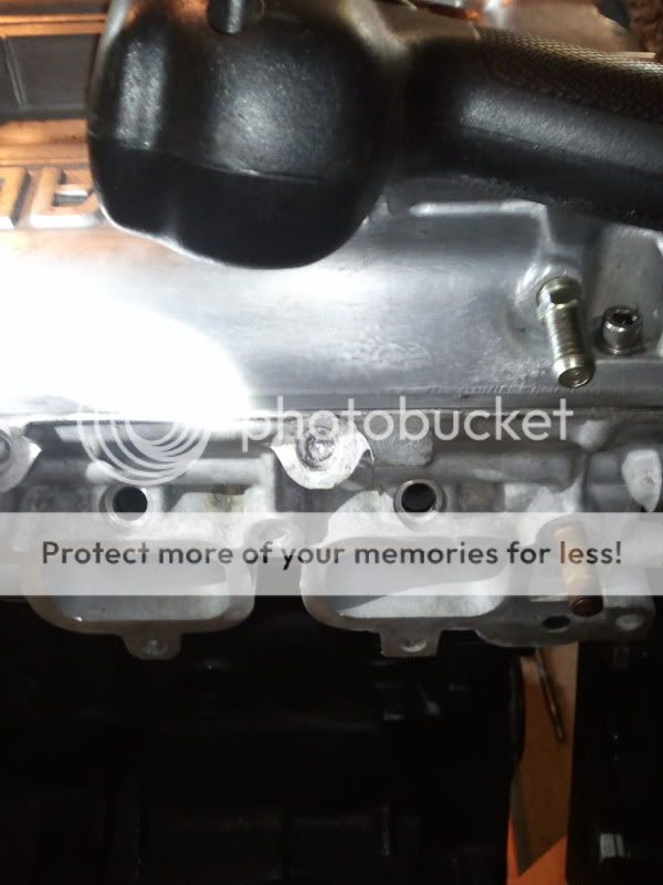

Another broken bolt discovered..... great. This is one of the bolts for the fuel rail.

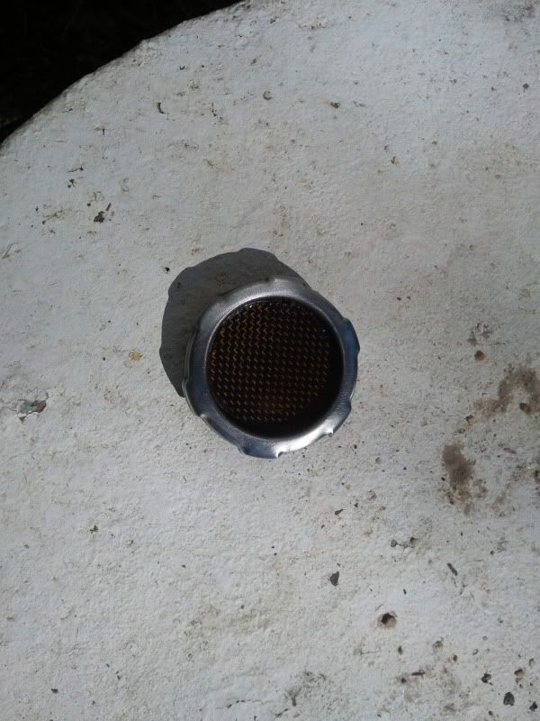

This was the oil cap that came with this engine. Figured I'd sand it down to get the tarnish off and cleaned up the CF with goof off. Decided to throw down some clear to help it stay pretty.

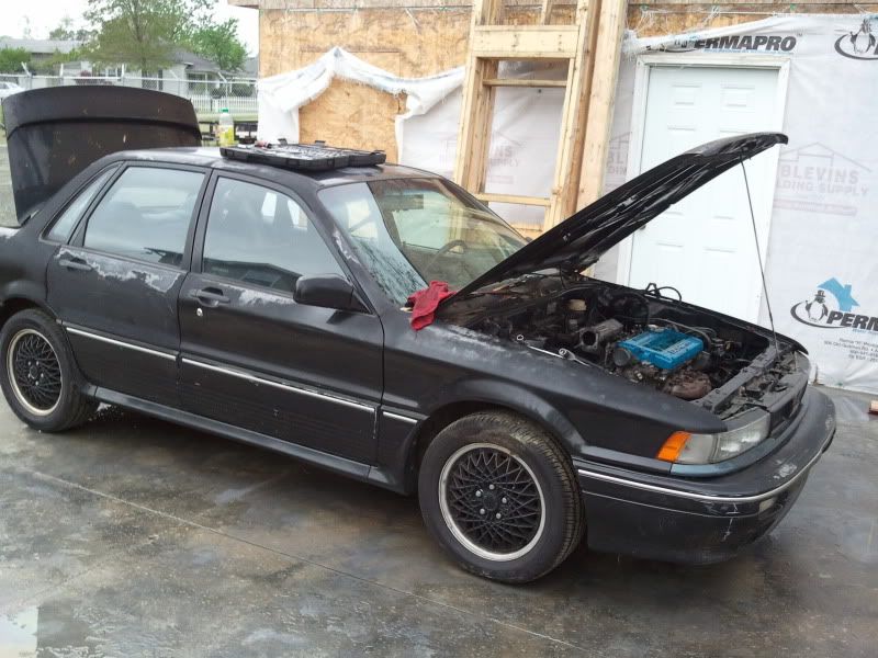

Well after some time I finally was able to locate a place to do the engine swap on the car. We got it towed over there Friday before it started to rain.

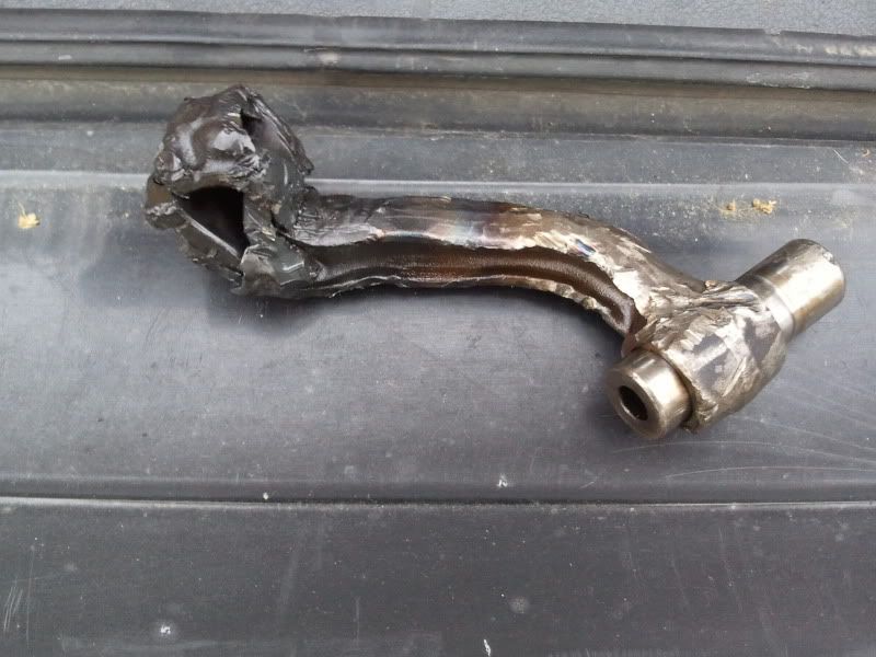

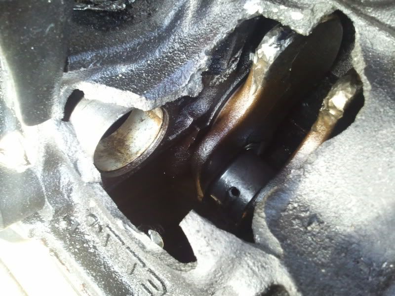

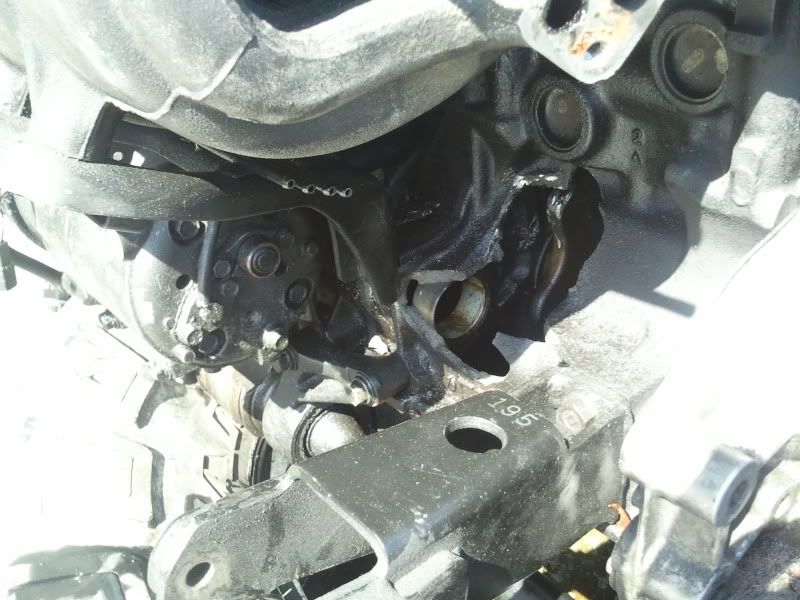

We dove into the car Saturday pulling the engine harness and other cables and such out of the way. As I was pulling the starter I realized that the something was wedged between it and the block. A quick tug and I was holding a good sized piece of cast iron in my hand. Well as that would suggest something had broke loose. Upon further inspection I found this and was able to easily pull it out of the gapping hole in the back of the block.
We ran into alittle hassle getting the transfer case bolts out. So after my buddy cut his arm pretty good, we called it quits for the day. I came over this morning and within 20 minutes I had the last two bolts out and the transfer case on the ground. I found that both of the front axles had torn boots and would need to be replaced. I actually broke the drivers side axle pulling it from the transmission. But with alittle push and tug we were able to get the engine/trans out and on a tire to rest till I can tear it down and move what I can over to the new engine. So stay tuned, with hopes I'll have the new engine in the car and getting it all bolted down next weekend.

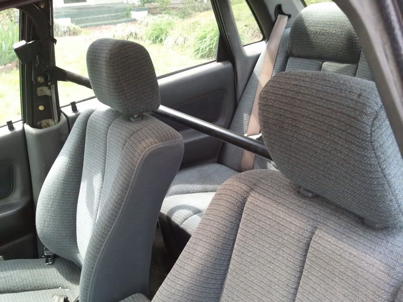

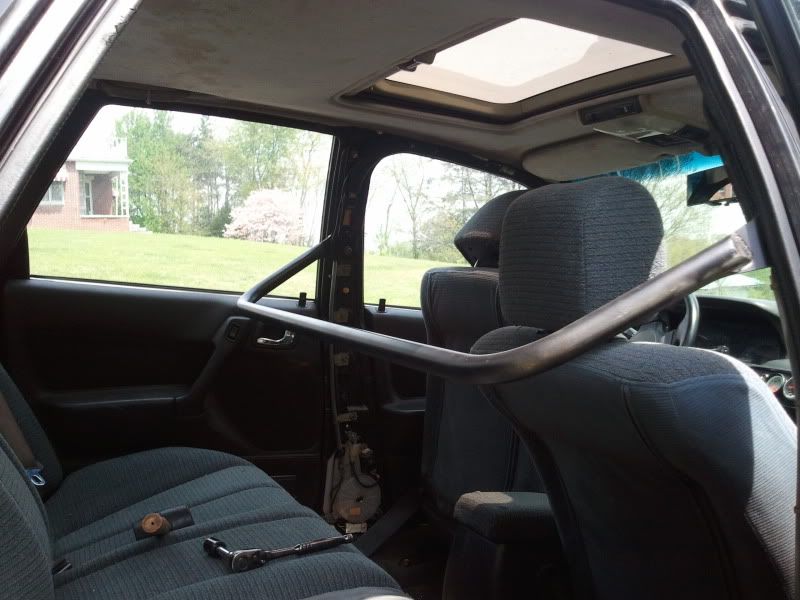

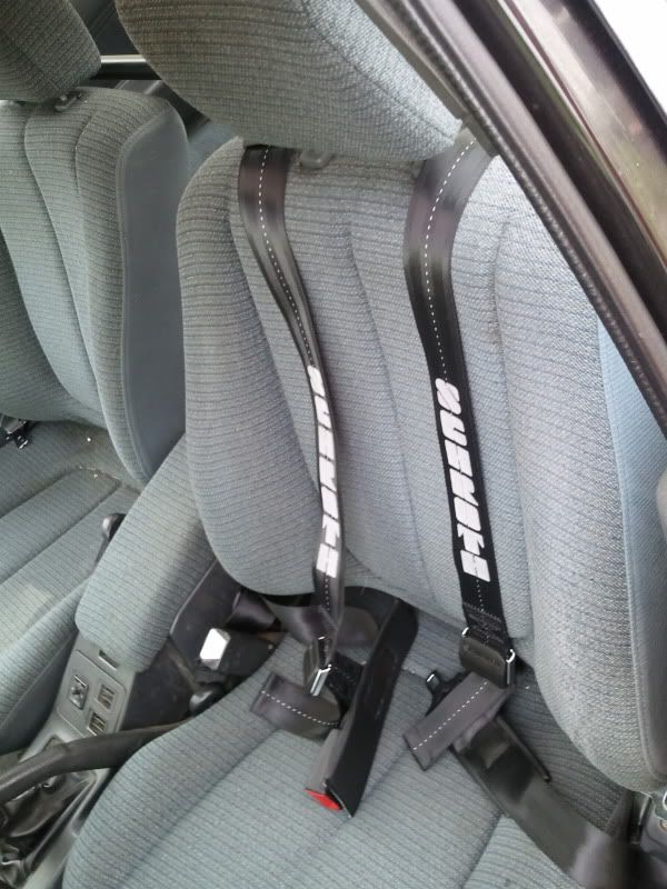

I also got my harness bar installed with my new Schroth harness the other day.

Heres a better picture of the block. lol /ubbthreads/images/graemlins/jawdrop.gif

wow. that looks like that was fun when that happen. You got the same vc as me that sittin in a box now bec went to my black one.
