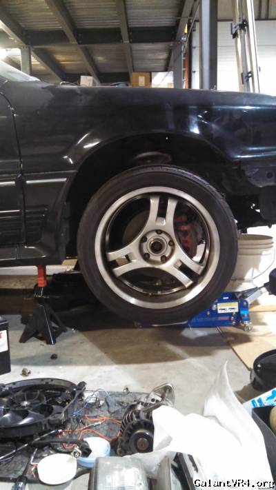

What are the specs of the wheels you want to run and what size tires?
The size tires are fine on the Evo X wheels. You just need to roll your inner fender lips and add a bit of camber. You don't even need to raise the car. If the wheels rub on the inside use a mallet to bonk the inside of your wheel wells in a bit. Simple. I wouldn't go with a smaller side tire, it's unnecessary.

I think that looks 1000x better than your old wheels. Keep em on. /ubbthreads/images/graemlins/smile.gif
Totally agree.

I still think the Evo Xs are the best option posted in this thread so far though.

GSX_TC
Apr 7, 2011
3,733
Houston, Texas
