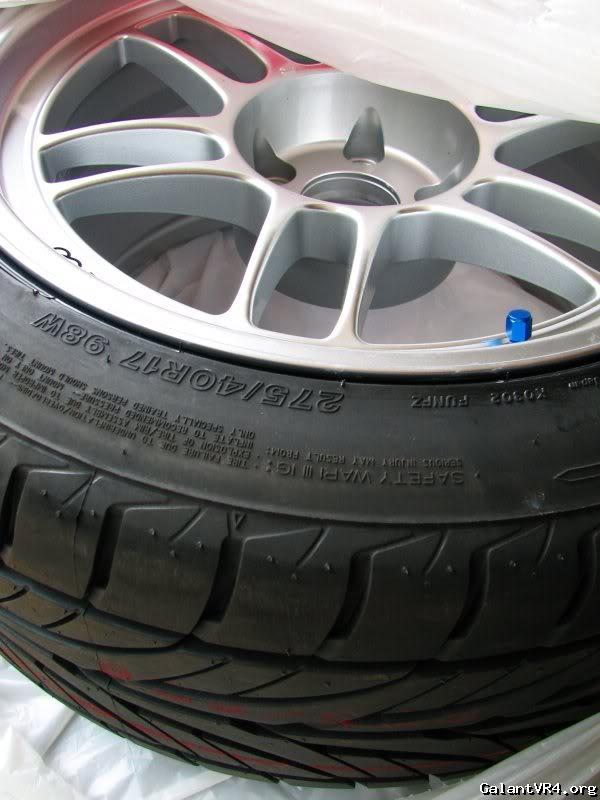

Looks like 245/40/18
They would not be hard to fit at all. G I know you understand wheel fitment as well.
G
Feb 24, 2004
8,896
zompton
No way dude, that size is going to rub all to hell. Get 225/ 40's. I have some 225's installed on 18" x 9". So on your 8.5" wheels they'll fit perfect, and be a little lighter than 245's. Also cheaper.

Rub where? Plenty of people run those size tires with no rubbing. Granted they have more camber and rolled fender lips.

Inside the wheel well, fenders. I don't like rolling fenders unless absolutely necessary. Or running excessive camber because the tires are too wide/ tall.

Yeah maybe with an 18, 17s have plenty clearance. I would just bonk in where it rubs inside the wheel well with a mallet. Not gonna rub on the fenders if you roll them. He wouldn't need much more camber at that ride height to fit those tires.
Or raise the car up, add a little camber, and don't roll the fenders.
Or just get smaller tires I guess. /ubbthreads/images/graemlins/smile.gif

Azenis RT-615K's right? I was considering those. And yeah I forgot about those star specs, heard those are pretty good too.

225's on a 9" wheel is the maximum safe width for that narrow of a tire, I like having the lip protection and slightly less HERRAFRUSH stance yo tuck & poke.
Nice deal on the wheels Mike, don't stretch tires like that, get the 235 starspecs, or 245's and make it work. A little lift on the car and some camber and you'll tuck in just fine.
