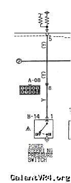

Possibly unrelated question, what is the electrical connector on the power steering pump for? Is it turbo specific because my GSX doesn't have it but the VR4 does. I remember my 1g had it and it wouldn't run without it connected.

the connector on the PS pump tells the ECU to increase the idle when the steering is on full lock - I'm surprised the GGSX doesn't have it as even my base model Galant had it. Turning A/C on should bump idle speed up too.

I gotcha. The pump has the nipple, I just don't see a wire for it anywhere. I thought turning on any of the accessories would bump the idle up but none of them do. I'm gonna pull the ECU after work and take a peek.

GGSX did come with the pump switch wiring. It is part of the same harness that goes to the alternator. It breaks away from the harness just before the alternator wires.
