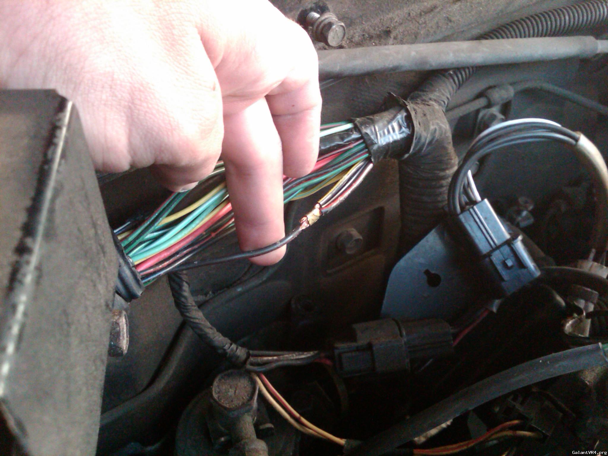

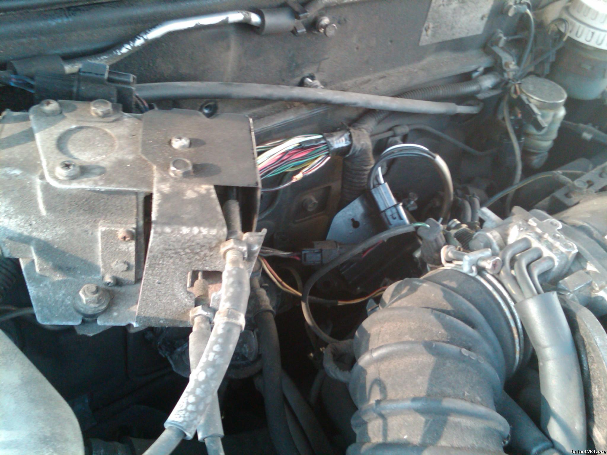

So I went to the junkyard the other day to do some research for converting to turbo. After looking at the turbo electical diagrams I saw that the resistor pack power lead came right off of one wire sourced from the MPI Relay. This prompted me to do a little digging within a harness (which was already a bit chopped up) by following the injector leads to a "fork in the road" which is in the same spot as where the Resistor Pack is spliced into the Turbo Harnesses. Very convenient since the wire colors match up.
- Area you will find the junction -
- Close up view of junction -
I don't know if this has been archived somewhere else but it sure kills some of the confusion that is associated with adding this in.
