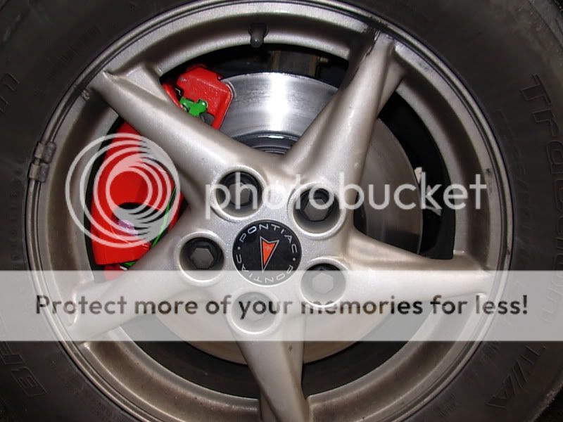

FWIW I have Camaro calipers on my GTP with 12.1 rotors and they BARELY fit with the stock 16's. I think I have a picture somewhere.
