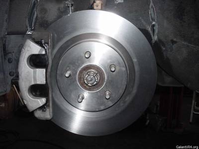

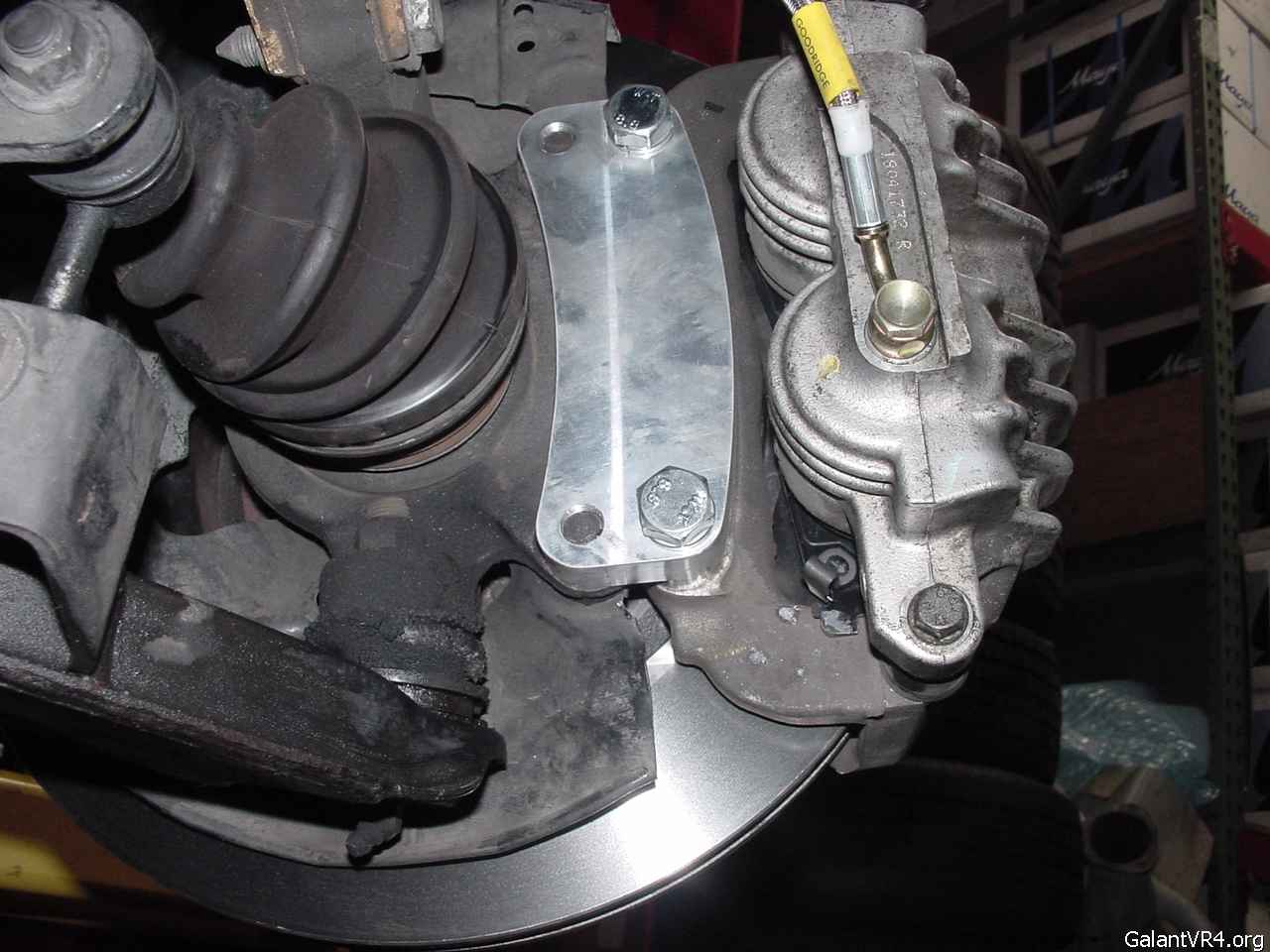

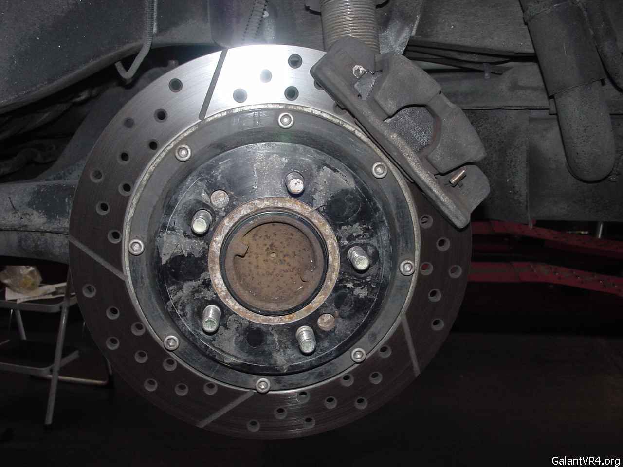

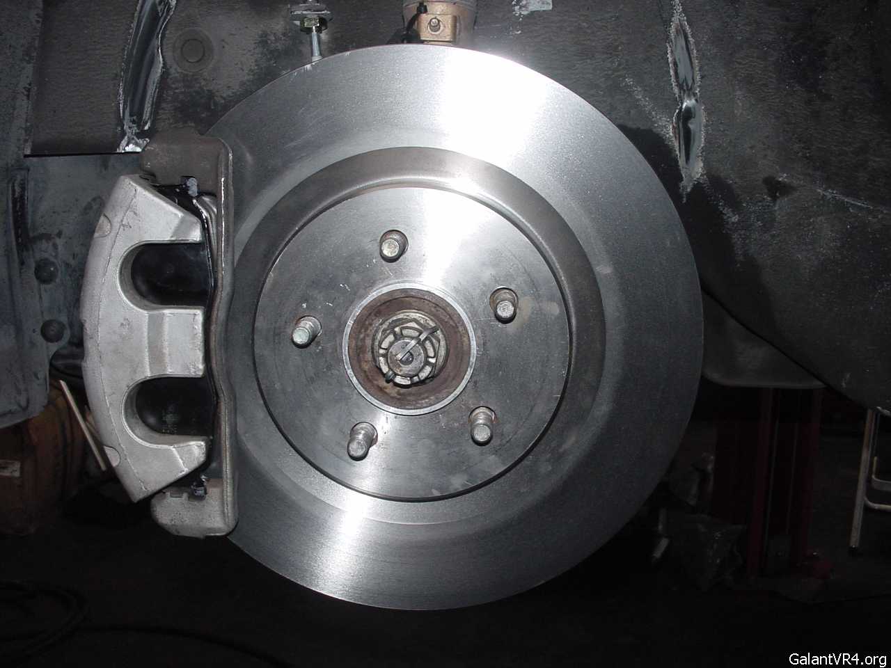

I had a set of front brakes from a 01 Camaro laying around so I had a bracket made to fit the VR4 using Mustang Cobra Rotors (Blackhole said those rotors fit somewhere on this board, Thanks)
If anyone else wants to get the brackets, I can probably have more made. I think the Camaro Calipers are easier to find then the 3000GT ones.

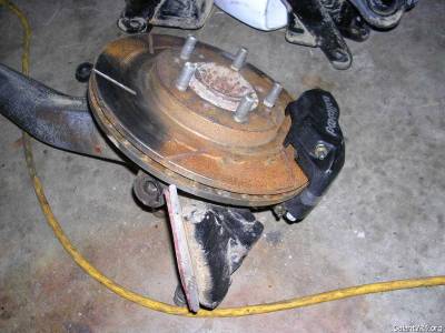

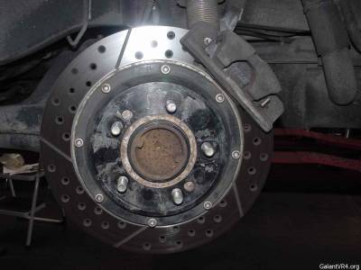

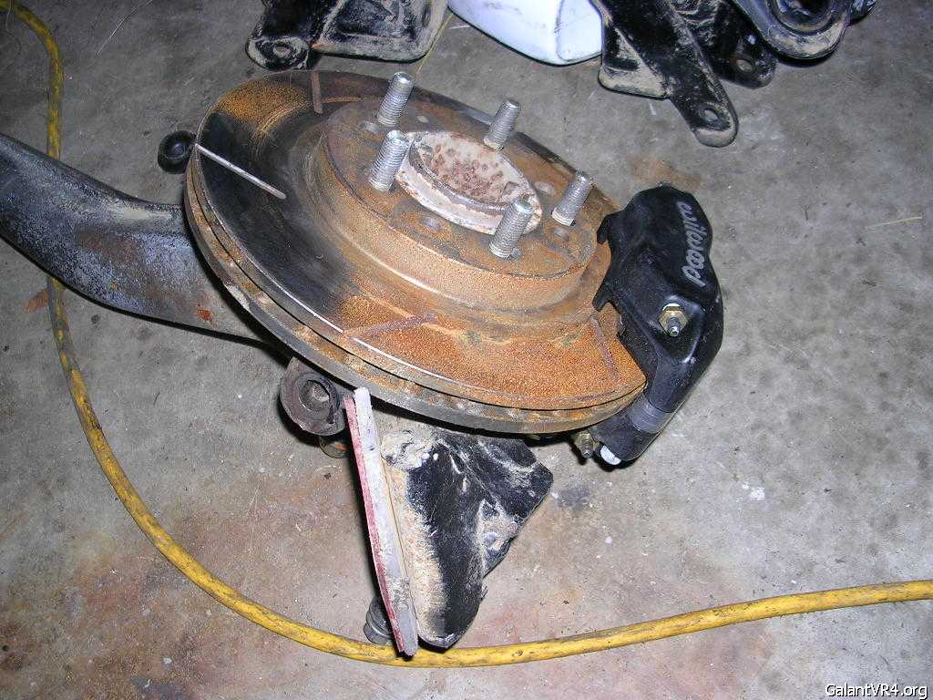

Also I found this rear brake kit at a junk yard on a Talon.. Is it the AEM one?

you just made yourself a baer racing brakes kit

Are you using hub-centric spacer rings to center the Cobra rotor? The Baer kit I have on my GSX uses them and it would be cool to find a source of those to go with your brackets.

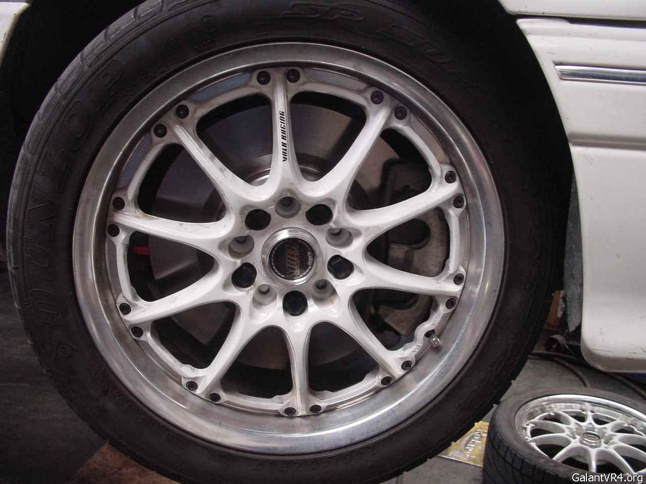

funny.. i have never seen volks with universal 5 lug... thats awesome about hte brakes.. looks almost exactly like the bear brake kit..
I will have to ask for a price but I think it will be about $50-75 depending on how many I order.
I can probably include the spacer/hub ring included in the price. My hub rings centers the Cobra rotors and the wheels.
I have seen these PBR calipers go for pretty cheap. I just had them laying around from a parts car I bought.
The rotors can be bought for $25 each but I got the Brembos for $60 each. For the brake lines, I found a couple of Honda civic lines laying around that fit. /ubbthreads/images/graemlins/smile.gif.
I just look found out I can get the Baer kit for $600. I would have bought those because I paid $300 for their 2 piece rotors for the Cobra but it wouldn't work. The little bolts wouldn't clear the caliper bracket.
? Not sure what that means.. I haven't seen the Volk GT-N come any other ways. But yeah, there are alot of copeis of these wheels. /ubbthreads/images/graemlins/smile.gif
Nice thing about the camaro calipers is they have 45mm pistons vs. the 38mm C5 vette calipers

I will find out the exact price for the brackets in a couple of days.
I don't know if the C4 or C5 ones will fit.
I tried the Camaro Calipers with the Camaro brackets on the mitsubishi knuckles and they pretty much bolt up.
So, it the Corvette ones do the same, it will work.
Larry, The od on the Cobra rotors are about 13" but I doubt it will fit under a 15" wheels with these calipers.

The brackets are $75 a set.
I can get the Baer brakes. The only thing is they take forever to ship them.
