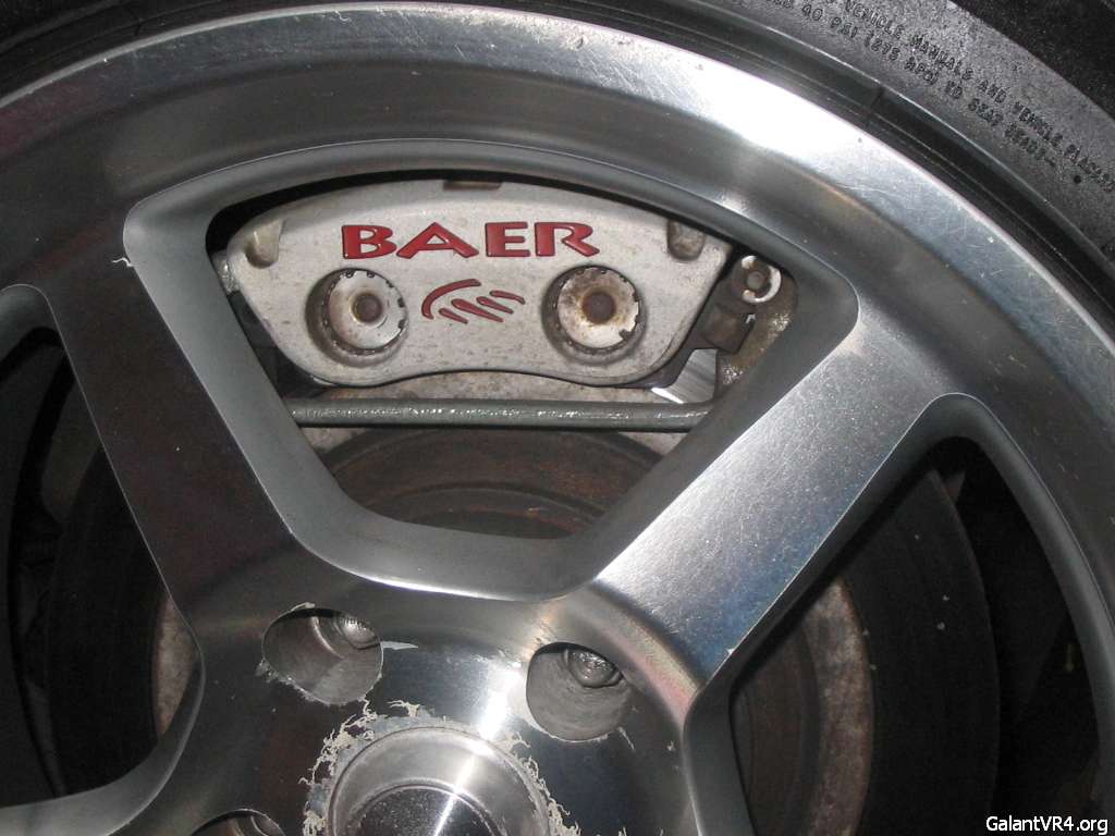

Wow, that's cool! I have 5-lug powerslot rotors all around right now, but I am definitely gonna consider this as a replacement for that!
I didn't read thru the whole thread, but did you have to do anything to the master cylinder, to compensate for the larger calipers, to get more fluid there (usually done with a larger rod), although it may not be an issue?

No changes to the master cylinder are needed since the piston sizes are almost identical to those of the stock ones.

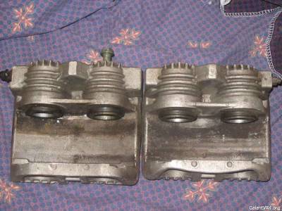

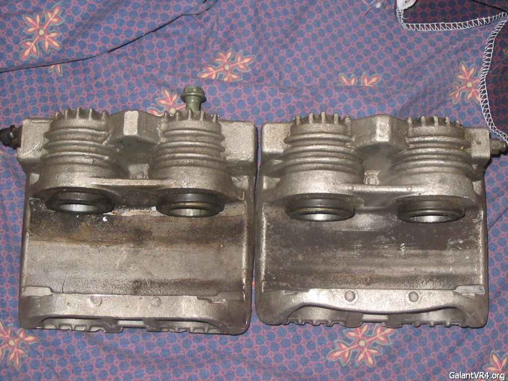

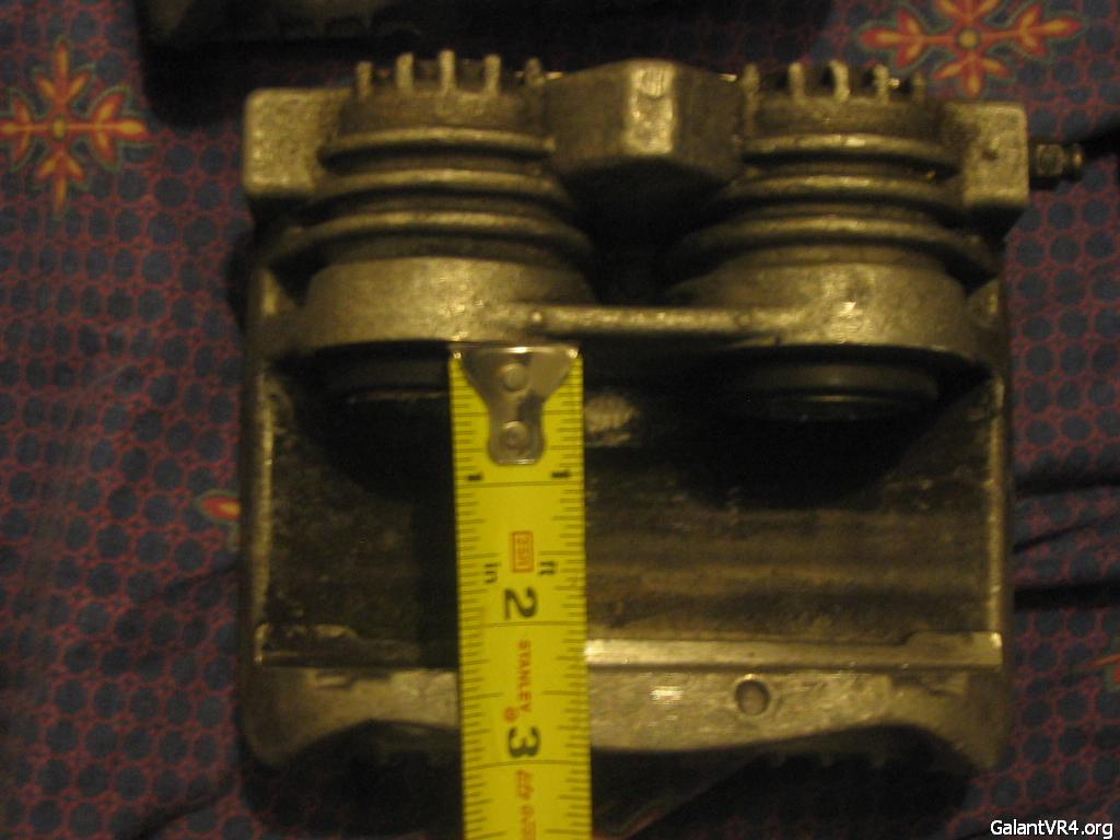

here is some of the difference i found out between the heavy duty ones and the regular ones these one are from the C4 vette , they look different from John's but i am sure they are the same..
^^^^^^Those are actually Corvette C3 calipers not the C4's that John has. Those calipers in the picture also come on the SN95 Cobras and are cast iron. The basic Baer kit comes with the same caliper pictured above.
Daryl
boostx
Apr 24, 2003
4,326
Orlando, FL
thanks for the corrections i always get them mix up all of those in the picture are cast aluminum
atc250r
Sep 11, 2003
13,235
Orange County, NY

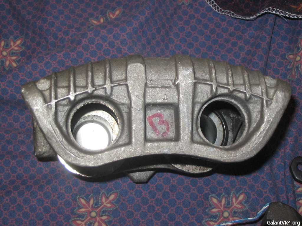

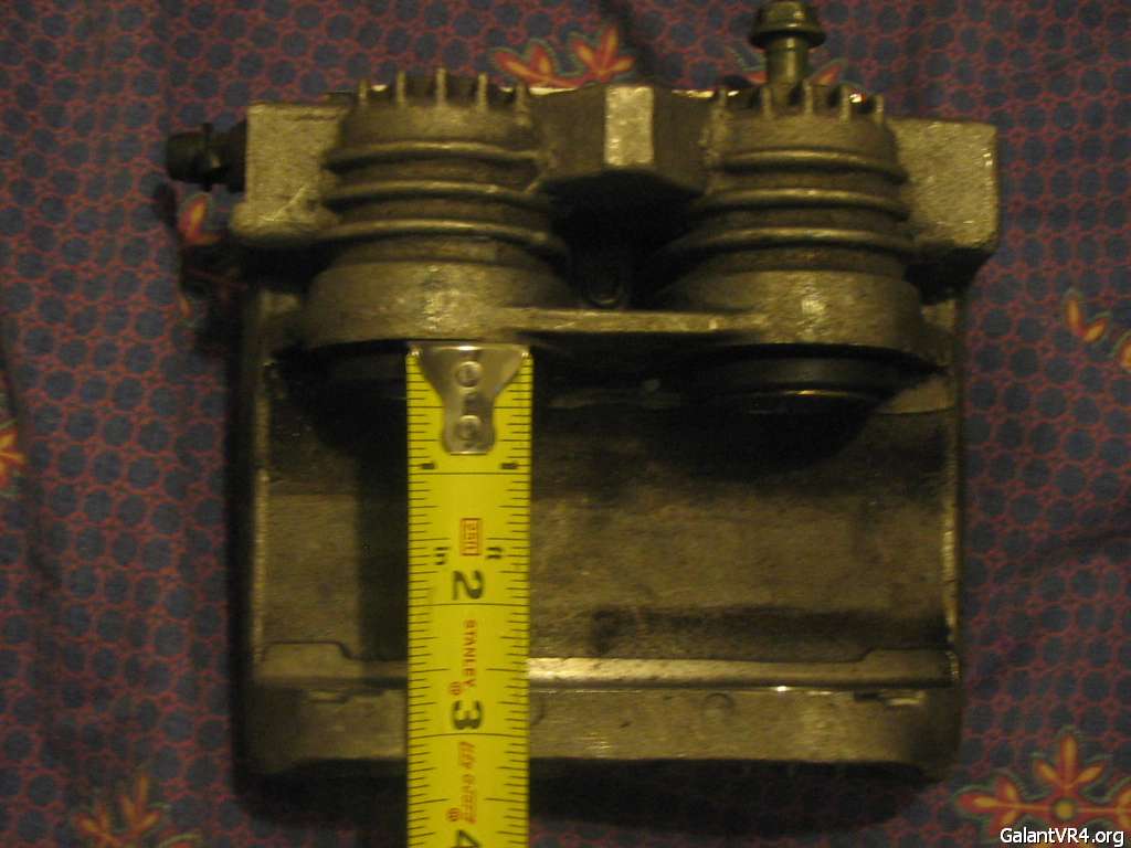

The calipers that I am using came off of a 1998 Firebird. They have slightly larger pistons than the Corvette ones and are much easier to find at a junkyard.
