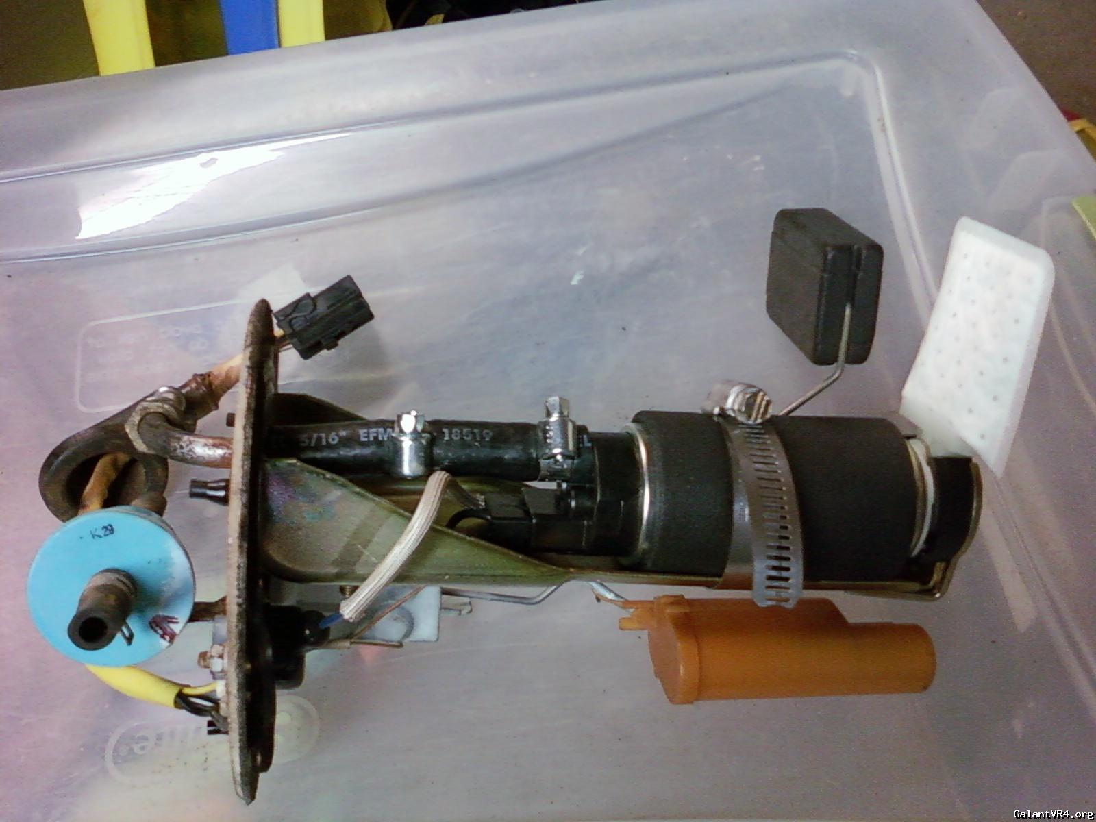

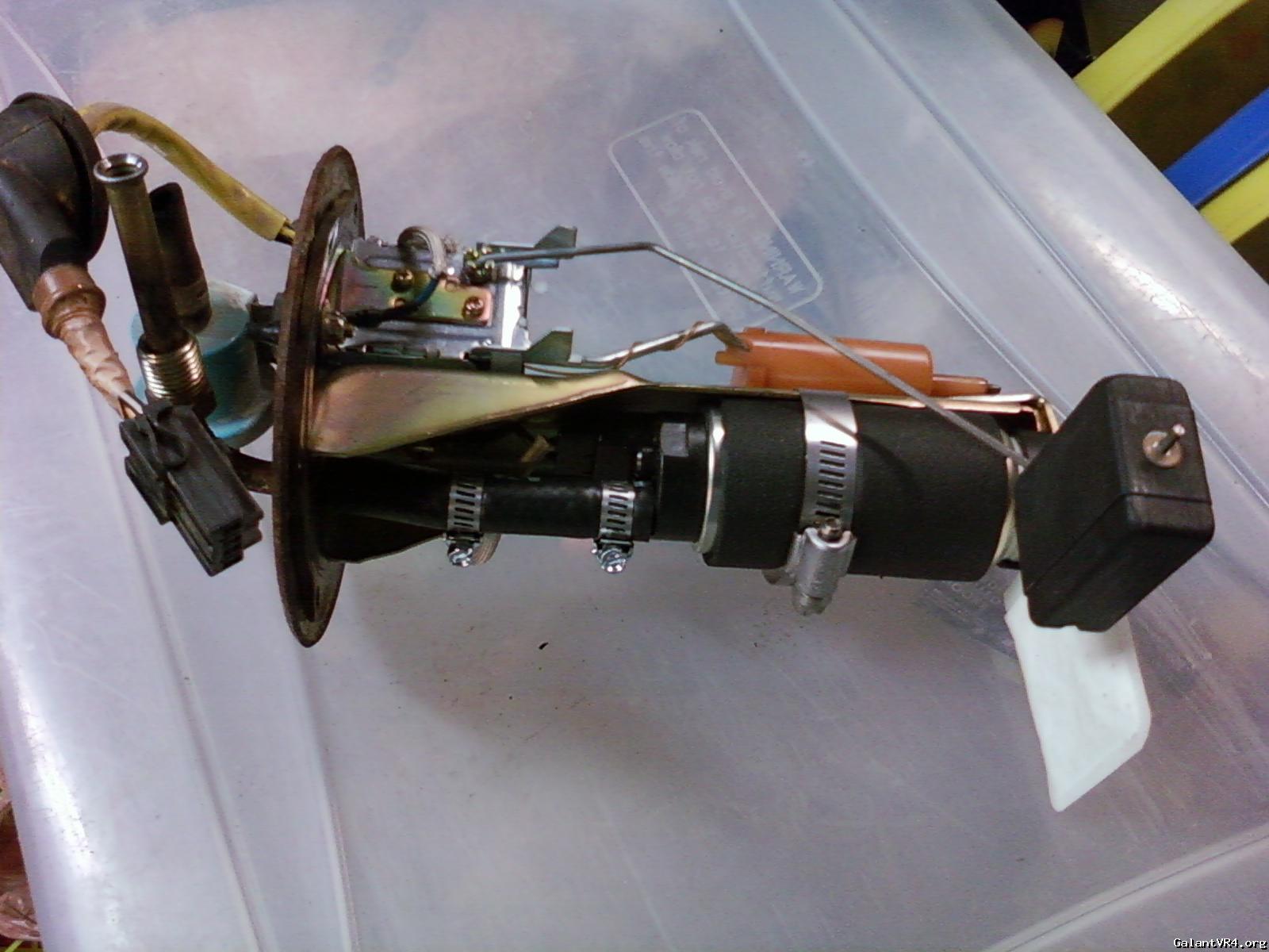

i just did this for my car and I also replaced a rusty and leaking fuel pump housing. i installed a (gss-342) walbro 255lph pump.
great thanks to tredmkv for getting the pump to me ASAP. it was not a bolt on affair. i followed the suggested install from Auto performance Engineering. the instructions were straight forward enough to follow.
i do have a few questions.
1. will there be any gains in rewiring this pump or will
this be sufficient for 18 psi of boost?
2. does any one know where to source the nuts for the fuel pump cover plate?
i reused the old ones for now. the old nuts are rusted to half their size.
thanks in advance and pics for reference.
