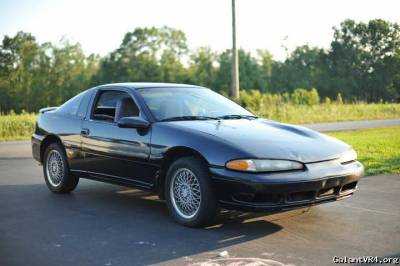

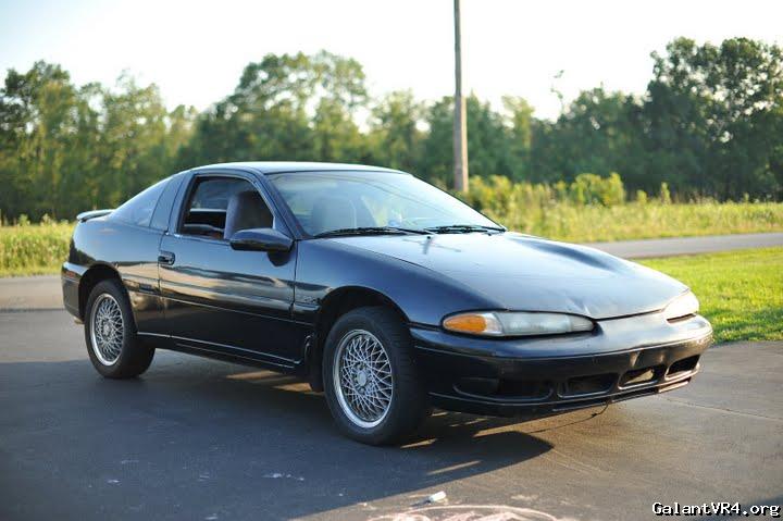

Got the new car (stock 92 6 bolt 4 bolt) for $1100 - drove 500 miles back to Pittsburgh and upon proper inspection noticed the front engine mount snapped off and took a chunk of the block with it. After talking to Curt Brown I am considering just eliminating the mount. The engine is solid 160-170psi on a supposed rebuild - never been hammered. I have a 6 bolt with a good mount lined up but it has been through abuse.
Should I say F the front engine mount - and go with solid/inserted mounts on the other 3? Or get this other bottom end? Time and money are of issue...
Thanks
(pics soon)
Oh yeah - I bought this for a donor car...
