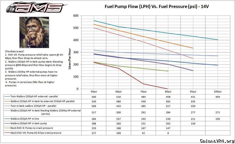

Based on my calculations and estimates you'd need about 1660 cc/min at 100% injector duty cycle. So plan for something like 2000 cc injectors. This is targeting 650 bhp (so 550-600 whp, I'm guessing). You'd need to flow about 1000 cfm, which would put you at about 35 psi MAP. Keep in mind I have a lot of estimates in my calculations(BSFC = .55, AFR = 11.5 [did my calc based on pump gas and then compensated for the difference in e85 when doing the injector calc], IAT = 130*F, Peak VE = .95).
At 32.5 psi MAP (assuming you're running stock base fuel pressure of 37.5) an in-tank HP Walboro 255 will provide 231 LPH according to AMS. That max injector that can support is 960 cc/min (4) at 100% duty cycle. So it'll be a bit less for your target. Adding an in-line 255 might get you there. I didn't run the numbers. (most of this was based off an excel chart I already had set up. Otherwise I wasn't going to do all that work for you /ubbthreads/images/graemlins/smile.gif )
I highly suggest you do some research on your own for how to figure this stuff out, instead of just trusting what someone on a forum says. Garrett has a good primer on turbo technology and how to do some basic calculations on their web site.
Here's the fuel pump flow chart:
The FIC 2150 are great and they idle much better than 1600's. You just can't run Q or import through them. As for the fuel pump just run a twin 255 set up. I have seen the twin 255 pump set up make over 700 whp with E85 on a mustang dyno.
last motor we built that had a little over 700whp had two 255lph pumps inline, FIC 1600cc injectors, and a larger return line and fuel pressure regulator. with the stock regulator and line the fuel pressure can run up to 56psi or better.
As for the twins fighting themselves like stated before just run a y block. Series is a bad idea you can run higher psi but lose the volume you are looking for with E-85.

In principle both work fine. In parallel the pump only needs to flow half as much as a single pump. In series the pump flows the same, but the second pump bumps the pressure as the single pump trails off at higher flows.
As far as pumps fighting each other, I don't really know enough to comment on that. I don't see how pumps in parallel would cause a problem, but I haven't thought about it much.
We have never had a problem with the pumps burning up in our twin pump set up.( I work at APM Racing) . On a car we recently did with a Borg Warner S366 on E85 we ran out of fuel around 450 whp(dynojet) with a single 255. With the twin pump the car was able to run 39 psi and make 700whp with out any fuel issues. You don't need as great of fuel usage as you think with E85. When it first came out everyone said you needed 30% more fuel but honestly you don't since you can lean out the mixture greater with E-85 compared to 93 octane. I have seen close to 13 0 on an Evo at 30 psi with zero knock. With our set up we use 2 modified walbro 255, -6 yblock and lines, and a hobbs switch so unless you are under boost only one pump is on.

To clairify, pumps in series means the flow will drop off less as pressure increases.
If you flow tested a single 255 vs two 255's in series at very low pressures they would flow about the same.
That's why the flow chart for the 255 in series is higher then a single 255, but it also keeps flow more constant from 40-100 psi.
