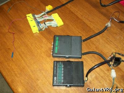

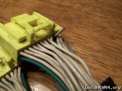

its been awhile since i had a vpc so i dont remember what every wire is but anyways im looking into buying one from a member and there is a cut wire in the harness and loose wire. anyone know if this is gonna cause a problem or what it goes to?

i know about the ECU's pins but thats not really gonna help me. I need to know if that cut wire is gonna affect the VPC functionality and what the long wires by themself are for in the 2nd pic

Quoting BoostedAWD91:
If you would PLEASE do us the favor of looking up the pin # on the ECU that those wires go to, it would GREATLY help! /ubbthreads/images/graemlins/banghead.gif I wasn't trying to be a smartass posting that link, that is the information you need to give us before we can tell you if it will affect the VPC operation! Same thing with the long wires. It *appears* that they might be where someone spliced into the Karman Hz wires to run too an AFC. But, here again YOU need to tell us which wire they are spliced into. We can't get that much information from just a stupid picture!
