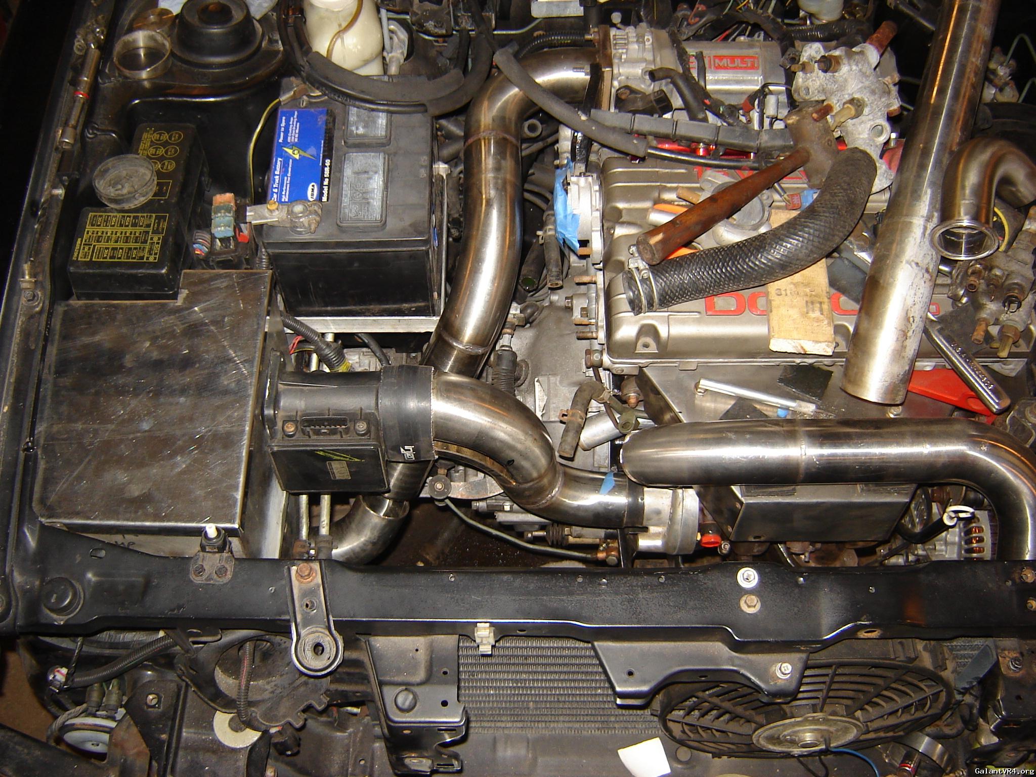

Thought Id add you should get 14ft of wire to run to the engine bay from the trunk..That way you have some slack to tuck the wire and run it out of harms way.
Moving the battery to the trunk is probably the best option. It frees up space in the engine bay & makes it look a lot cleaner. Also better for routing intercooler piping.
The reasons I went with the tray Jeremy sells are:
1) If you plan on taking your car to the track, most sanctioning bodies require a cutoff switch if the battery was relocated to the trunk.
2) Using Jeremy's tray, you need a smaller battery & an extension cable maybe 12" long. There's a lot less work involved & no cutting/drilling.
3) The job can be done in minimal time with very little tools compared to relocating to the trunk.
4) I hate cutting/drilling my car so I don't do it. I've never drilled or cut into my car where it's not reversable.
This is actually the way I'm going I ordered that tray yesterday. Yours is really clean.
I'm all for the trunk mount. Take your time and do it right, and no issues should arrise. The only issues I've heard of had to do with the realeasing of gas'es.
Like wop said , an optima battery should take care of that.
