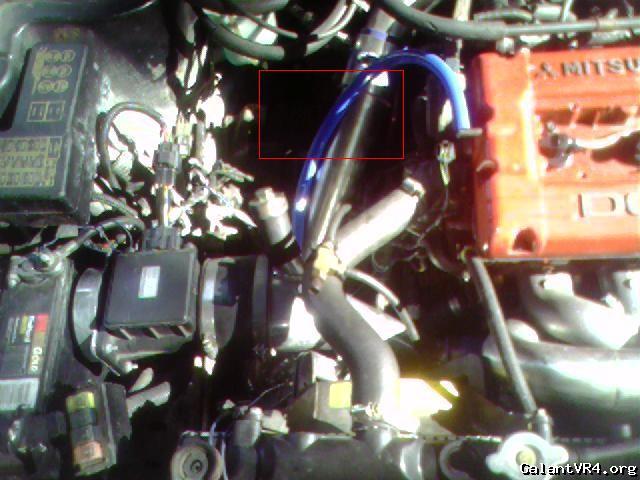

Hi guys when even I get my car back I will be installing a 2nd MAF an intake. Where do I out my battery. I looked at it before the car went back to the shop and the MAF is right up against the batter /ubbthreads/images/graemlins/dunno.gif

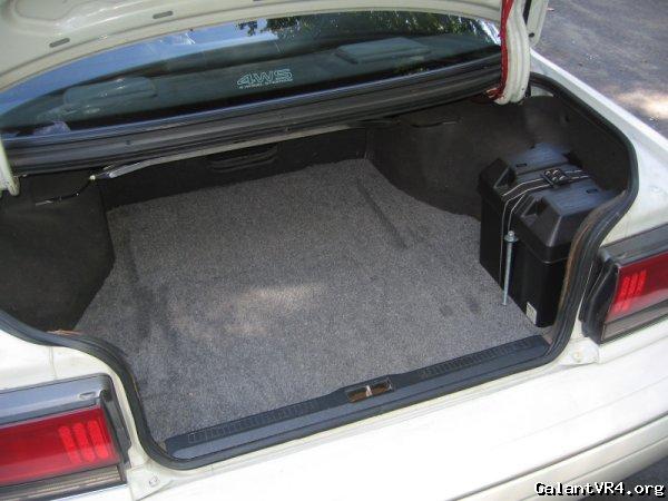

Or you can buy a kit and trunk mount it.
Quoting mac515:
LOL Where?? I do not want it in the trunk.
Why dont you want it in the trunk? Better weight distribution and looks cleaner imo.
I have read of to many issued with it in the truck, IE starting an some electrical problmes..
^Starting electrical problems? Only if they don't know what they are doing. My car has had the battery in the trunk for 6 years with no issues.
Same here - located to trunk 5 yrs ago - never a problem
Also I don't think it looks that bad either.
It probably was more work than any of the under the hood relocations.

Run 2awg to the stock location and ground to the rear shock tower and you'll never have an issue. Make sure you sand the paint down to bare metal at the ground connection though.
Both my cars have been this way for over six years. Starts up fine even in below zero temps. Also makes wiring in a stereo amplifier easy.

Put the battery in the trunk..I have not had a battery in the engine bay of a DSM or VR4 in 11 years..I have never had a problem.I can even jump start my car from both ends.
