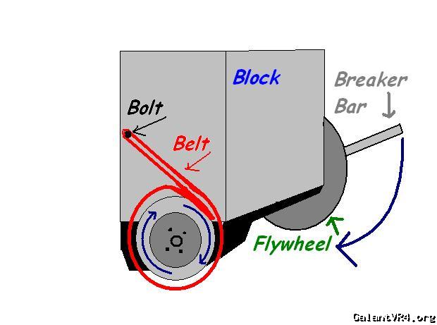

I use an old belt to hold the dampner pully. It locks it self and you dont have to try to hold both ends of the motor. /ubbthreads/images/graemlins/wink.gif
This might help you understand.

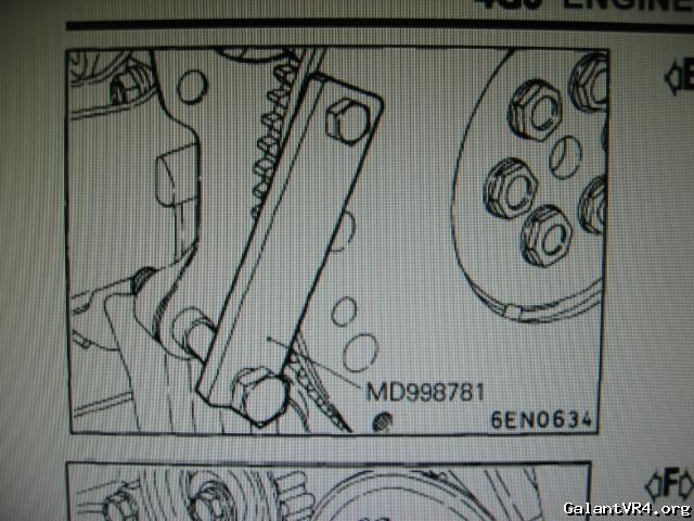

381gvr4
Nov 5, 2007
568
Wakefield, RI/Meriden, CT
^Mark, what kind of force do you think dual valve springs would put on the t-belt?? Stock motor for that matter. I can guarantee the belt wont jump if it was properly installed!!!! /ubbthreads/images/graemlins/wink.gif
Right from Mitsu....
11,991
Spin a motor using dual valve springs or a stock motor over by hand at the crank, then try to spin one with somebody holding onto a flywheel bolt with 100ft/lbs of torque applied to it and tell me the difference. Huge difference. Trying to remove flywheel bolts while using the timing belt to hold the crank via zip-tied cam sprockets will not work.
381gvr4
Nov 5, 2007
568
Atleast I back my posts up with some helpful facts....
exhibit A
I hate your furry face!!! /ubbthreads/images/graemlins/mork.gif /ubbthreads/images/graemlins/tongue.gif Post whore $.02 droppin'! /ubbthreads/images/graemlins/smile.gif
11,991
WTF, that's not a pic of a zip-tie holding the cam sprockets. /ubbthreads/images/graemlins/rofl.gif
The pictured way of doing it works though. I like that Mitsu has an actual part number for the "tool" used in that pic.
