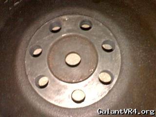

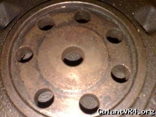

Specter
Apr 20, 2008
367
Karachi, Pakistan
I just took the pics. Sorry for the inferior quality.
This is how the flywheel looks like which we would like to install:
This is the pic of of a stock flywheel
Yes so this is the ring i was referring to as the collar. Now you can see that one flywheel is fairly plain. Back to my initial question, should we make it like the flywheel in the second pic so it sits on the crank tightly and gives no chance of any play?
Thanks /ubbthreads/images/graemlins/smile.gif

click Are you talking about the rings on these flywheels as seen in this picture? I think they are necessary to hold the flywheel square on the crank.

CSMShaun
Jan 2, 2010
129
Cincinnati, OH
Now your pics are of flywheels. I would think that a flywheel that does not have that "collar" could potentially shift and move during engine operation. But I would not atttempt to make that collar on a lathe as removing material from the back of the flywhell could weaken it and lead to it breaking under load.
Specter
Apr 20, 2008
367
Karachi, Pakistan
Hmmm so we either make that collar, and hope that it does not break OR we either bolt it as it sits and hope that it does not shift. That is not a good situation in either case /ubbthreads/images/graemlins/frown.gif
