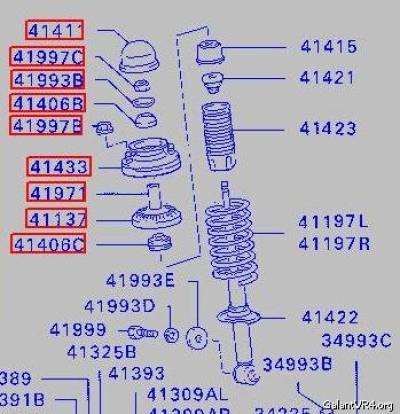

Second, on the rear, the main nut at the top of the old stuff has seized up. This has locked everything between that nut and the spring on the old stuff. I am contemplating buying all new stuff to replace it, but I'm not sure this is the best option. CAPS says i need these parts:
MB242358 Bushing,rr Susp C
MB338610 Insulator,rr Shoc
MB338620 Collar,rr Susp Co
MB338613 Pad,rr Susp Sprin
MS440002 Nut,steering Gear
MB338618 Bushing,rr Susp C
MB242360 Washer,rr Susp Co
MF434105 Nut,p/s Oil Pump
Do I even need all of them? Since I can't get to them, I'm not sure what needs to be reused and what will be thrown out. I would hate to buy new parts that I don't need. Also, is there a better place to get these parts than the dealer? mitsubishiparts.net as all of these for about $85-$90 after shipping (I would get both sides).

take the rear strut to someone with a big rattle gun to get that nut off, and then use a rubber mallet to seperate the parts (mine were still stuck together quite firmly).
If no luck, you need new spring platforms (41433) and new nuts (41997C) and washers (41993B) for the top of the stut and new bump stops (41421).
