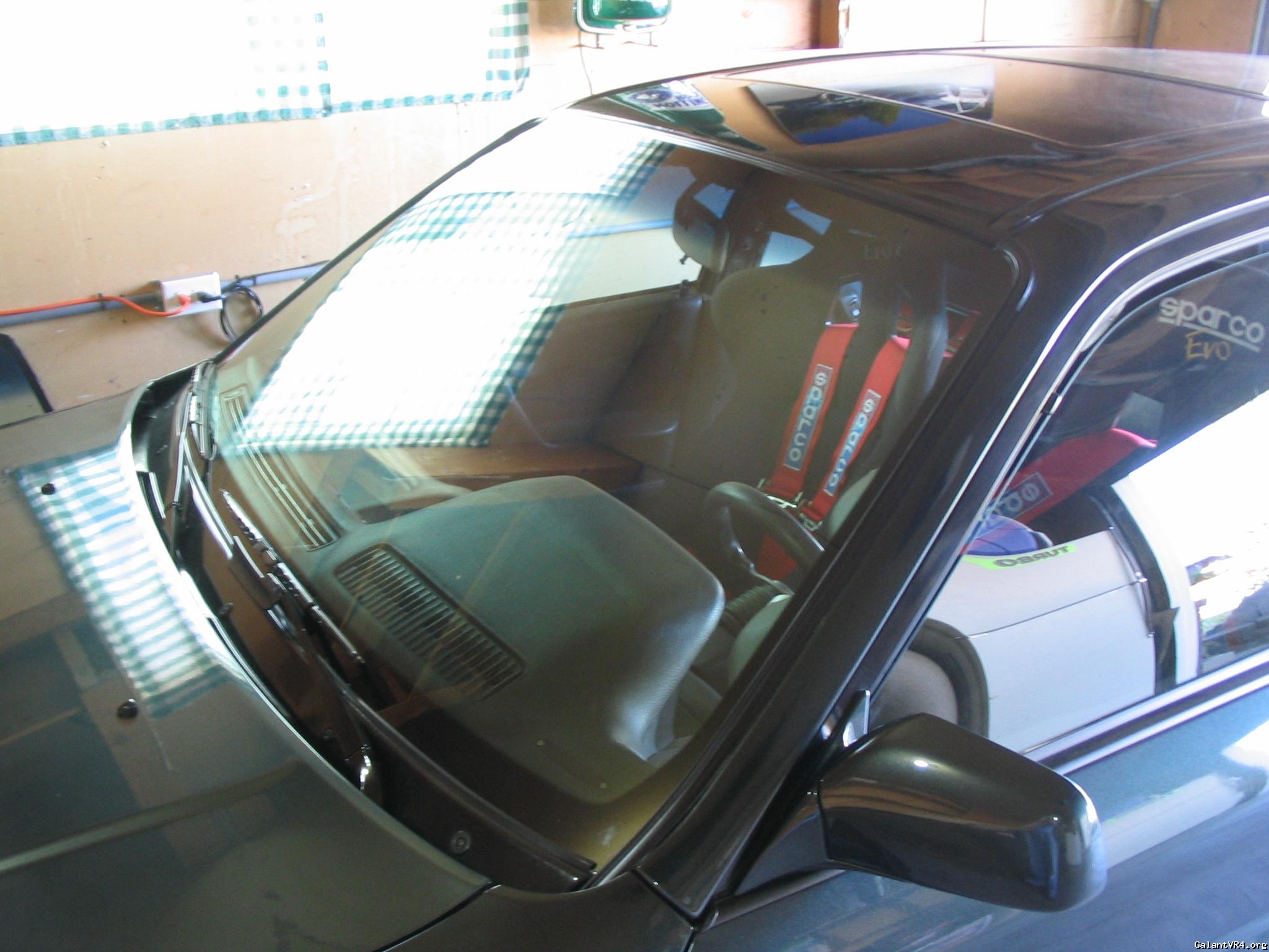

BTW, here is a picture of the new windshield and painted trim...

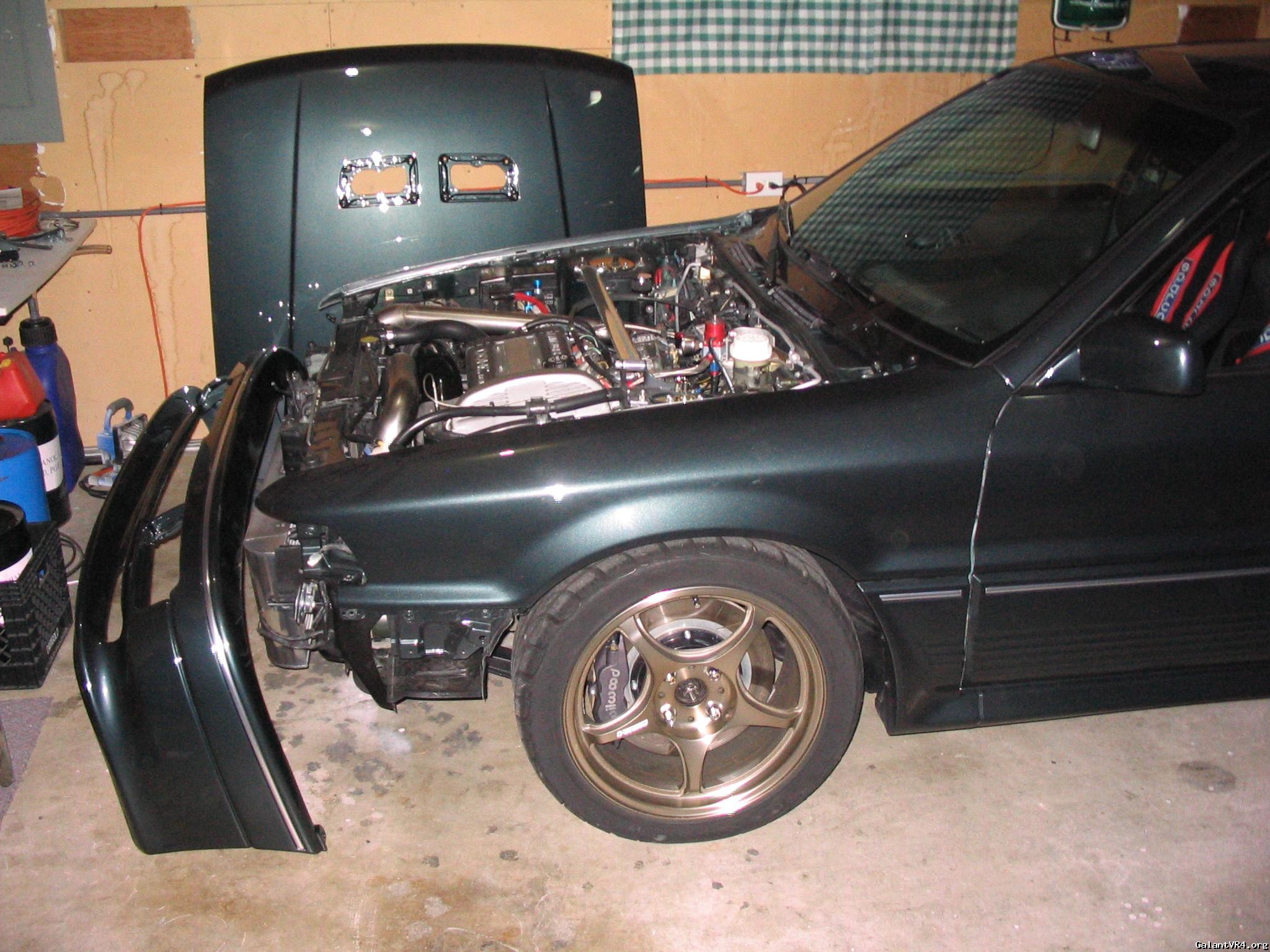

Please notice the difference in color from the hood to the fenders. I just had that painted, as well as the front bumper and valence. The paint supply place didn't put my custom mixture onto the side of the can a couple years ago. I assumed they put the colors that were actually mixed onto the side of the can, not just the factory sh*t, so I chucked my little piece of paper that had the custom mix ingredients. So now I'm fucked as far as getting my paint mixed 100% correct again. It wasn't as noticeable when I put the bumper back on the car, but once the hood went on I was like /ubbthreads/images/graemlins/frown.gif . They just mixed me factory belize green, but it looks close enough before it's sprayed on that I didn't think anything of it.
I repainted the parts due to some issues that you guys usually don't see in pictures, but can be noticed in person. I had the opening in the bumper smoothed out better and some of the paint was chipping down low from rocks, etc. When I had the JDM hood painted the painter didn't quite lay on enough base coat at the edges, which bugged me also. I just lived with it. In fact, that was the last time I had the correct paint mixed, was for the hood when I first got it. Here I am thinking this sh*t was all going to be fixed, and now the sh*t doesn't match. /ubbthreads/images/graemlins/mad.gif

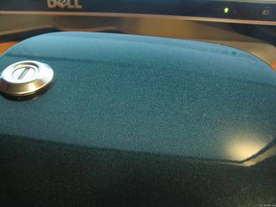

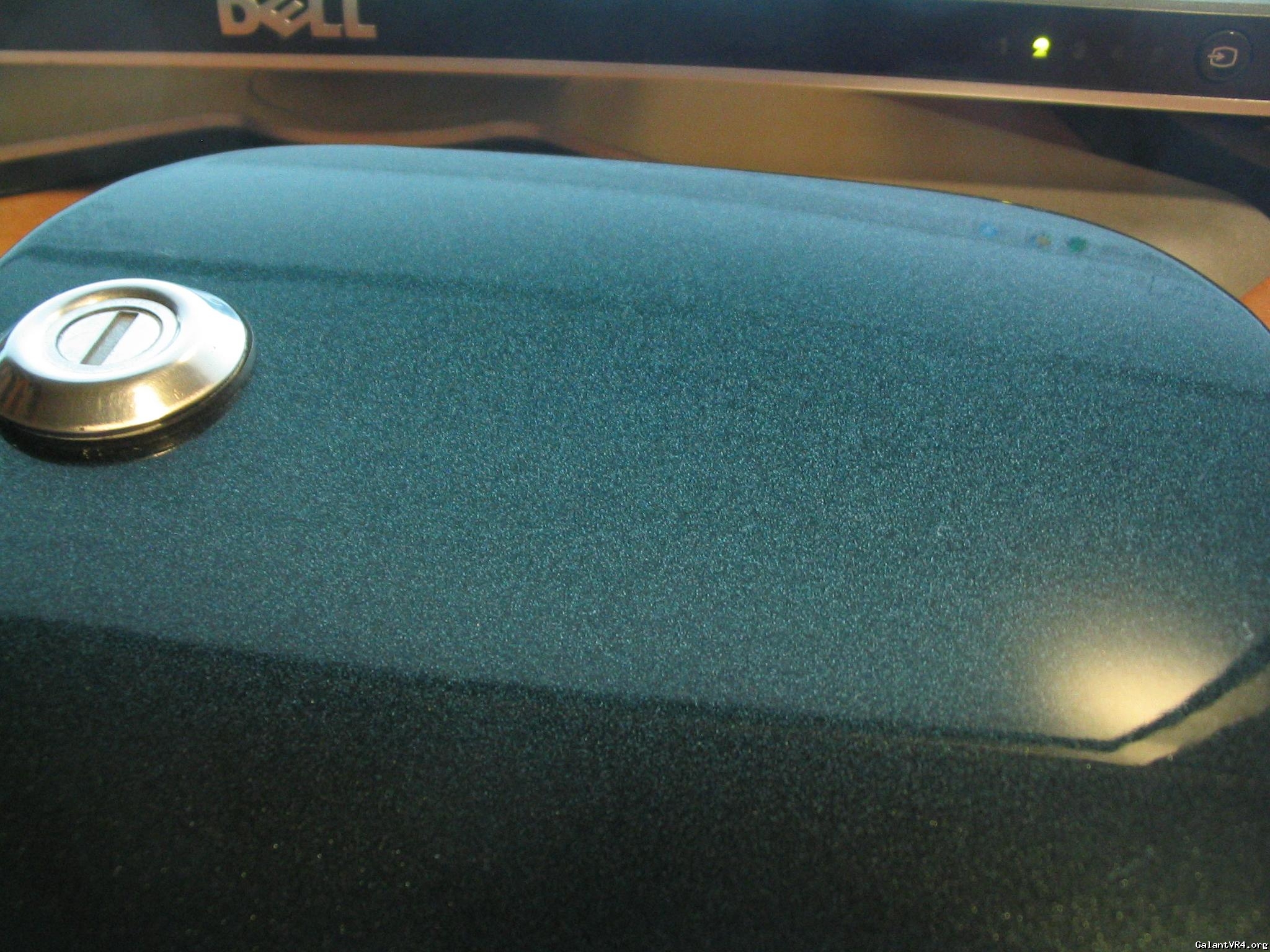

Anyway, I'm supposed to take the fuel door down to the paint place and they are going to use their electronic dealie that takes a picture of the paint to see what's in it and try to match it. She said it should come out way better than what it is now if not almost perfect, and she's not going to charge me. I'm crossing my fingers. Anybody else had good luck matching paint like that? All I remember is messing with the amount of metallic in the paint, which made it darker, but I can't remember off the top of my head what we did. /ubbthreads/images/graemlins/bawling.gif

I pulled off the fuel door to take down there for the process... /ubbthreads/images/graemlins/crazy.gif

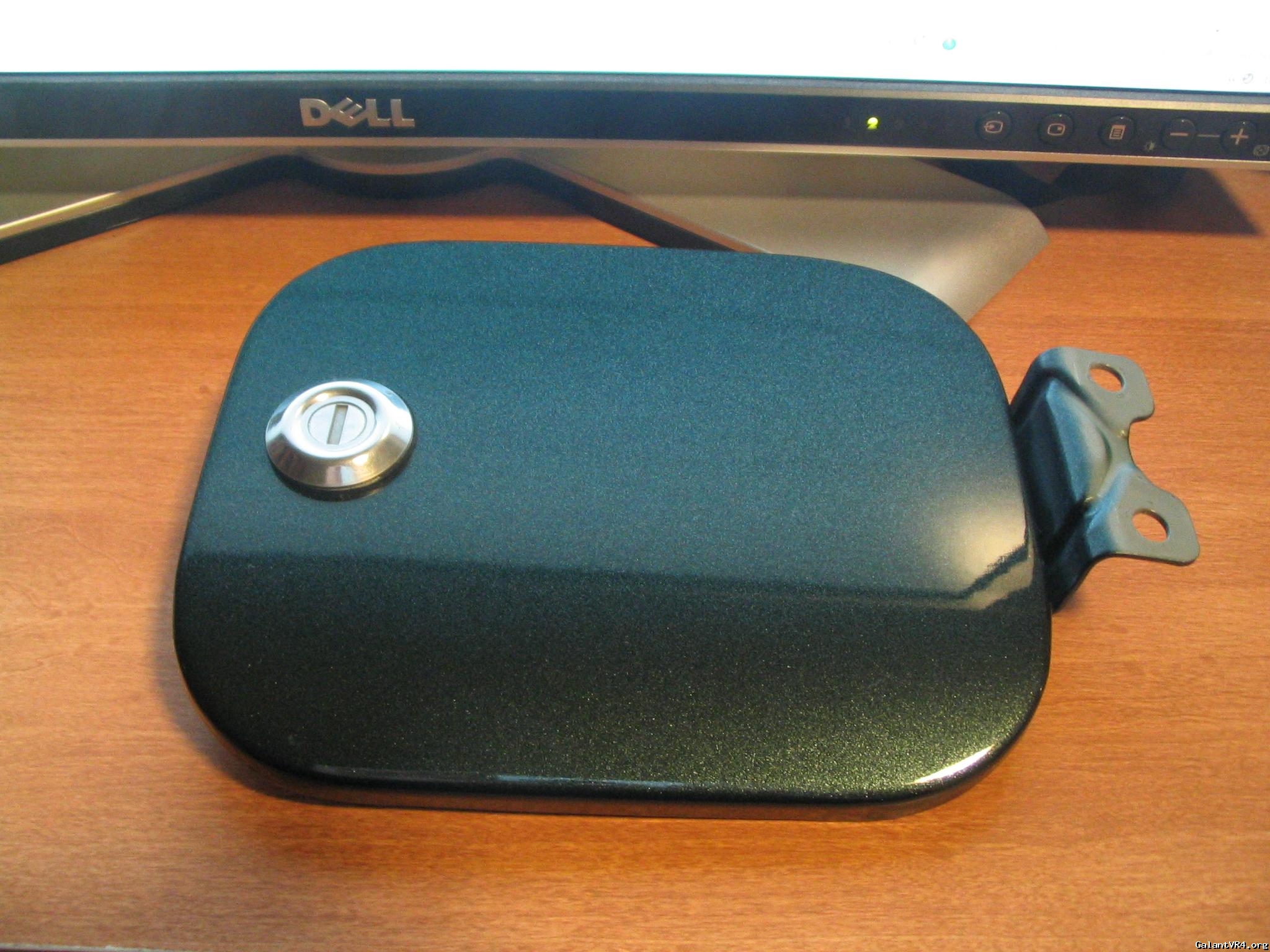

So they used the PPG camera dealie and matched up the paint using it. It looks pretty close, or at least closer than the stuff on there now. My painter is going to do a "spray card" I think he called it where he has different cards with different color sealers on them he sprays over with the base coat and then clears them for me to bring home and compare against the paint on the car. Hopefully it matches.
