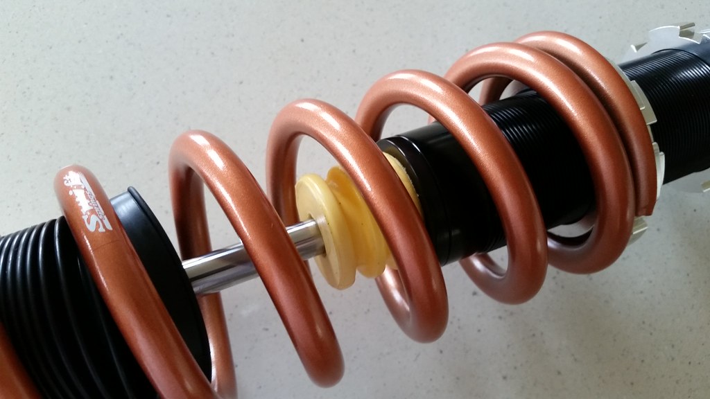

Update! Here are the measurements. This is total stroke, not calculated with the bump stop (because in theory, you could pancake the bump stop if you take a hard enough hit).
Total available stroke for the default kit:
4.5" Front
5" Rear
Total available stroke for the Max Travel kit:
5.625" Front and Rear

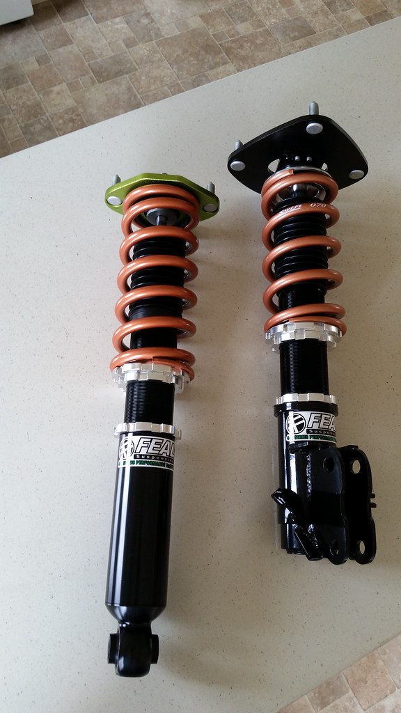

I finally got more pics uploaded and made a thread in the FS section to consolidate and make things easier for people to find the most pertinent info.
Link to FS thread is here: click

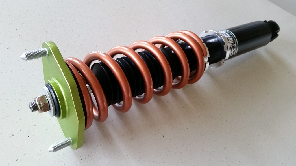

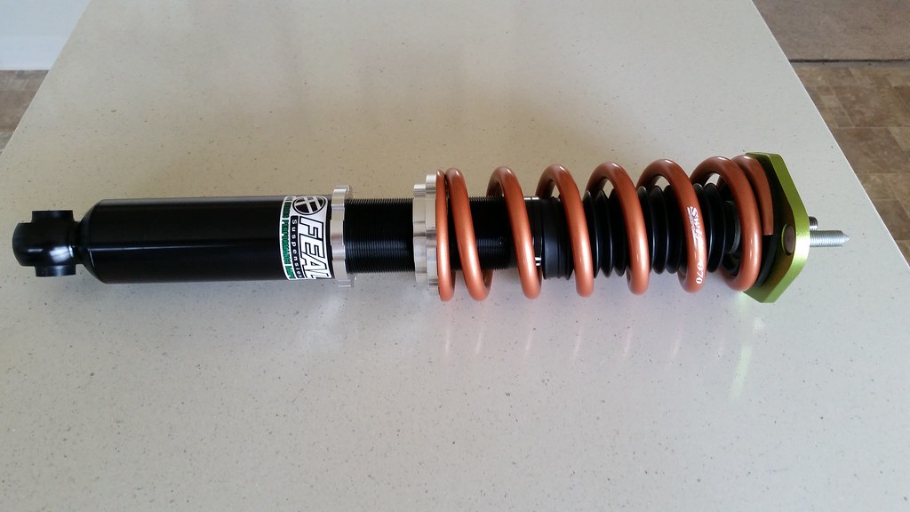

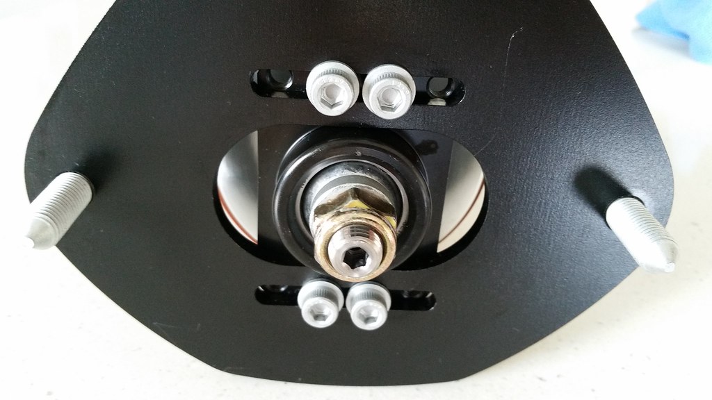

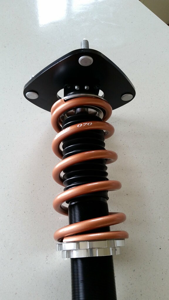

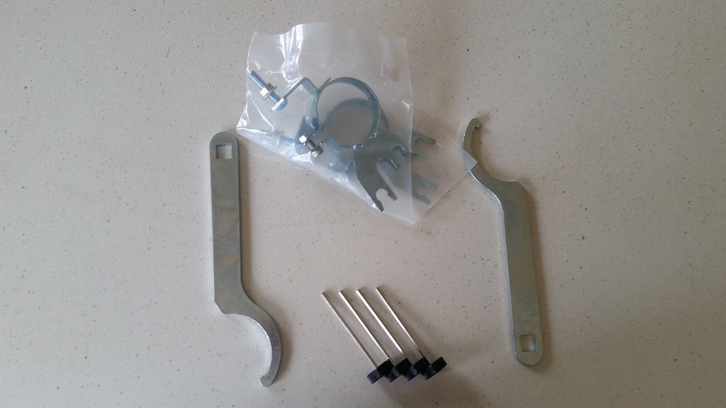

More pics below:
<b>Here’s what the universal brackets look like up front:</b>

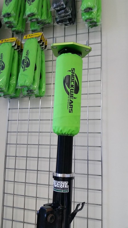

Also, I thought i'd list these for the off road guys, for cars that don't always get to drive in the most favorable conditions, or if you are just looking for added protection:
FEAL "Shockwears" shock covers
These are semi-universal. Fits 60mm, 62mm, 65mm and 2.5” ID diameter springs, and are available in 3 different lengths (see link for details).

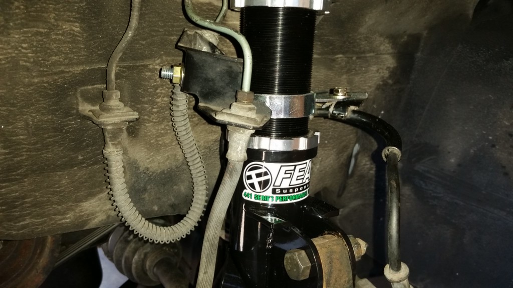

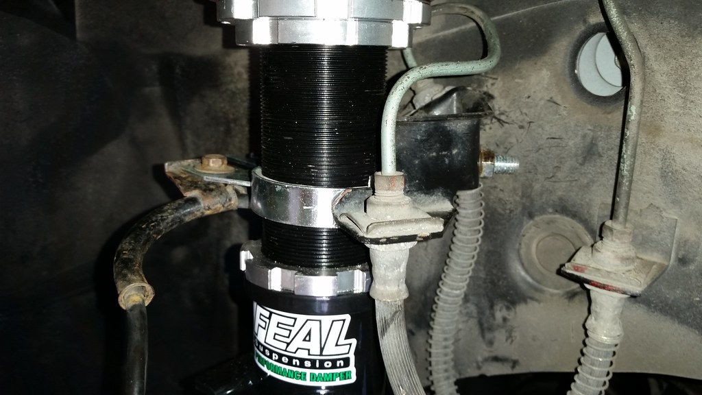

UPDATE:
FEAL is currently building a kit for a member on here that includes REVISED FRONT LOWER BRACKETS that allegedly have the correct ABS/Brake line mounting provisions. I expect to be picking them up next week and will report back with my findings, with pics!!

It would be awesome (and great that FEAL is willing to revise the tooling) to get the correct brackets for OEM hoses and ABS wiring. I've always hated that you were "on your own" with any of the coilover companies. Their universal bracket is pretty good, but properly designed tabs on the lower housing will be even better! /ubbthreads/images/graemlins/applause.gif

UPDATE:
The revised front lower brackets are now available, and they are very good. They have the correct provisions for both the ABS and hard-line (brake line) brackets. Woo hoo! Moving forward, i'll make sure that all kits that we have built use these brackets. Super stoked for this. Thanks to everyone who has helped on this project- notably Feal, EMX5636, oldmantau, and VR6Eater.
EMX5636
Jun 28, 2008
1,631
Bucks County, PA
So simple, yet so effective. /ubbthreads/images/graemlins/applause.gif Definitely nice to be able to run the factory hoses. I think I even purchased one of the last sets available of brackets and intermediate hardlines for the front. /ubbthreads/images/graemlins/devil.gif
