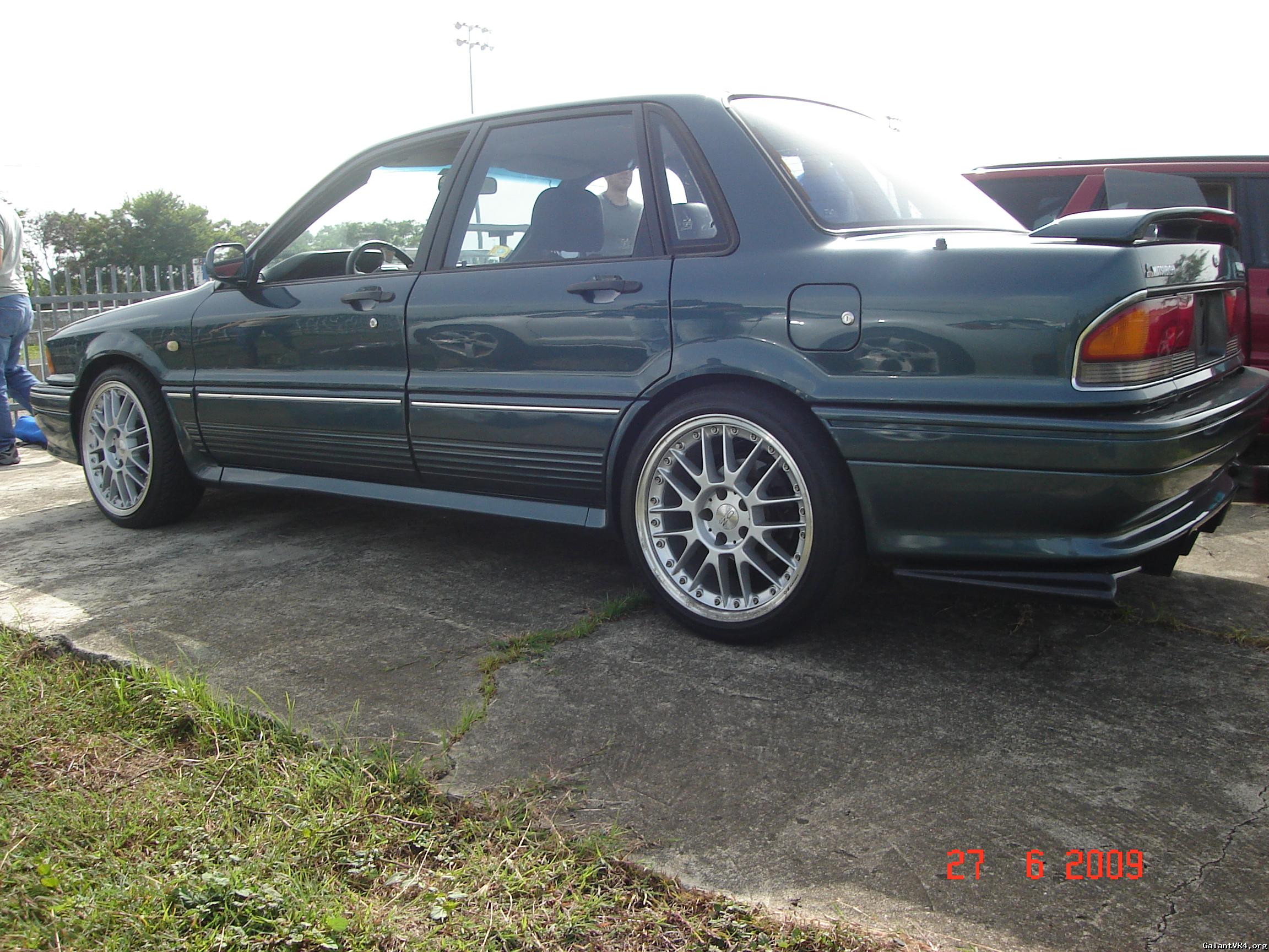

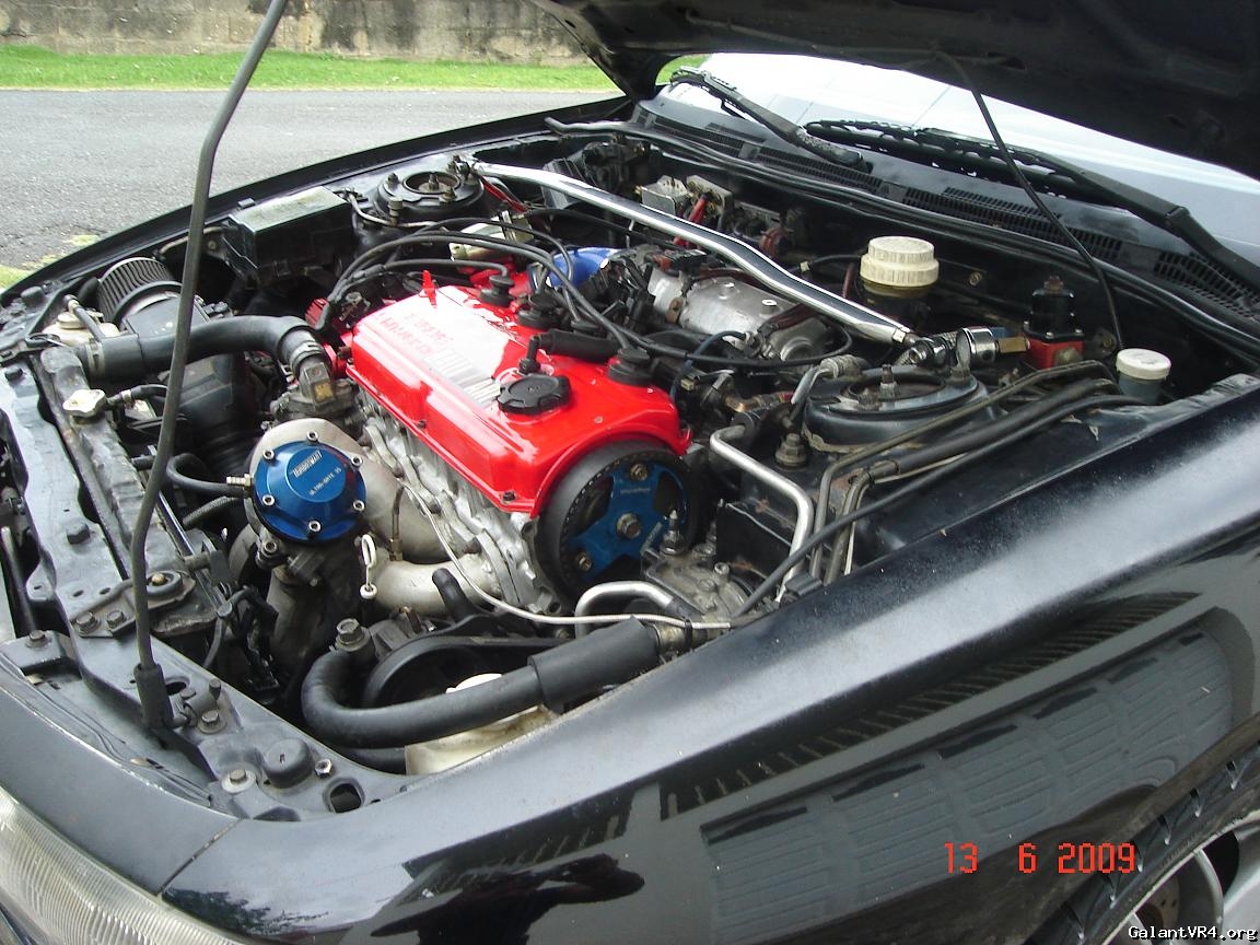

My daily car Galant 98 4G64 Turbo
Specs
Stock Internals
Garret TO3/TO4 turbo
Turbo Smart 38mm Wastegate
Greddy front mount intercooler with custom piping
Custon exhaust manifold with ceramic coat
Nippo Denso in tank fuel pump with Bosch external pump -6an line
Evo 8 injectors
ARP head studs
4 layer mitsubishi head gasket
Clutch Master 2100 / 6 puck clutch net disc
Apex AFC
HKS Turbo Timer

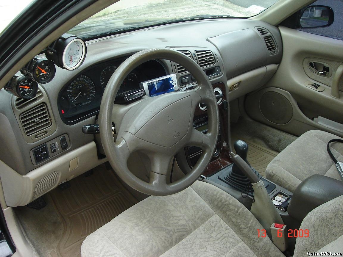

Greddy EGT with memory and warning light autometer fuel press and boost gauges
5 lug conversion
Eclipse GSX 94 2 pots front calipers and discs
Rear sway bar
KYB GR2 shocks
2003 eclipse rims
JDM front conversion
Numers 347hp/363tq 11.3 a/f 18 psi

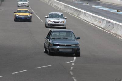

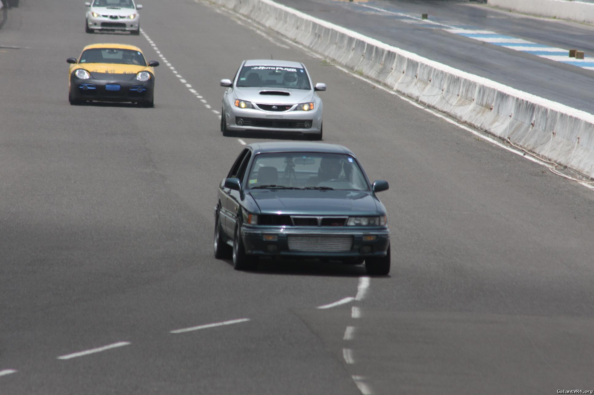

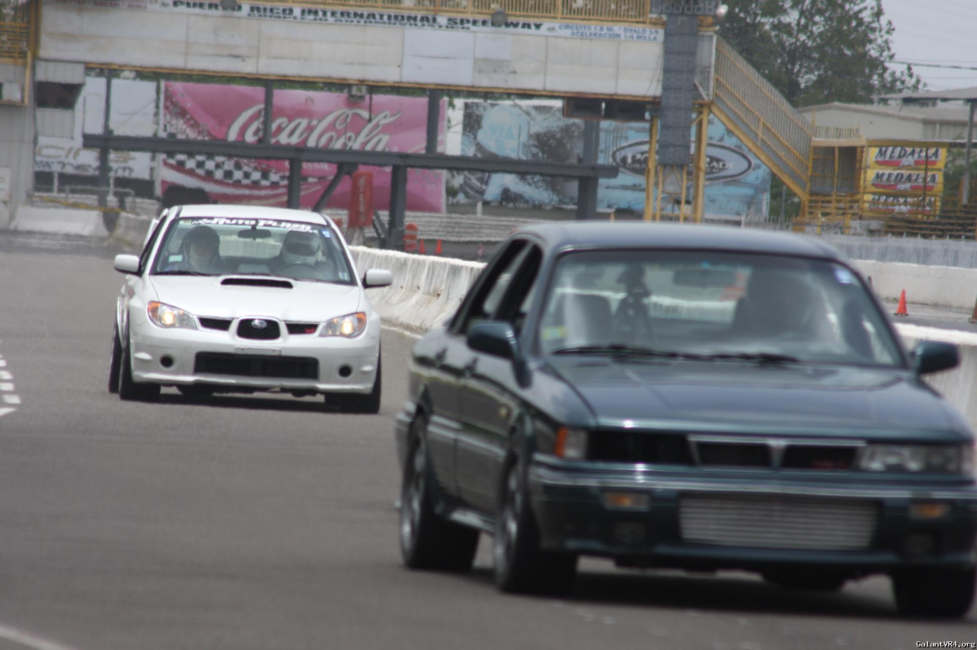

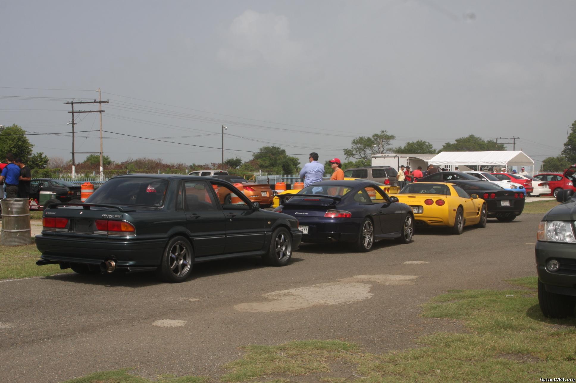

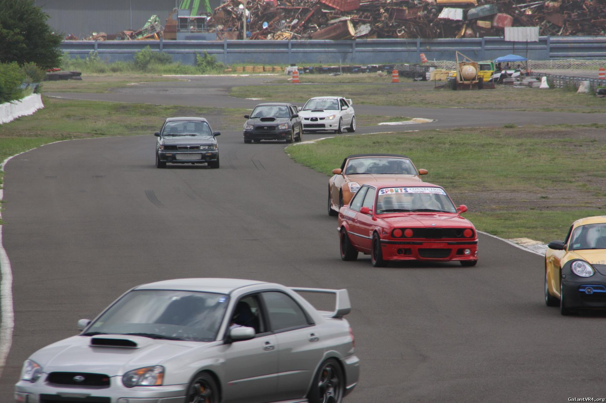

The car perform really great against all the newer cars subis, porshe and some vettes, as it was my first time in my car at this track, the expirience was really great. The car ran like a champ, my GT30R works great,power strong and full spool around 3400 to 3600 RPM and track temps were perfect. Without a ABS is relatively scary @ this track for a first timer, but once the tires were up to temp and pressure the car was very predictable, edgy but predictable. I finish with the third best lap time overall. As far as my future plans for the car i'm coming lower,lighter, wider and of course MORE POWER. I love drive my car... /ubbthreads/images/graemlins/rofl.gif /ubbthreads/images/graemlins/rofl.gif /ubbthreads/images/graemlins/rofl.gif

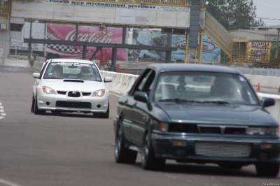

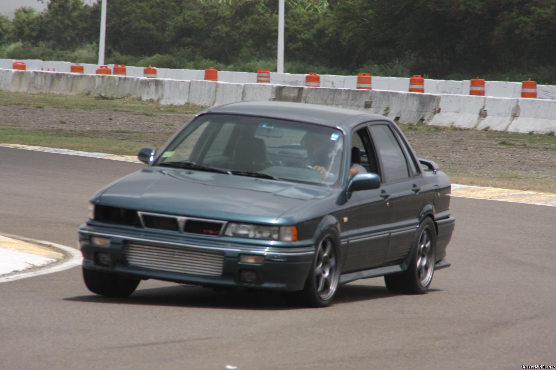

Is it rolling heavily in the corners or does that one photo just make it appear that way?
FCR
May 17, 2008
121
Orlando, FL
A little bit of both, but now i'm working in the suspension setup doing some upgrades(coilovers,swaybars,endlinks,etc)
