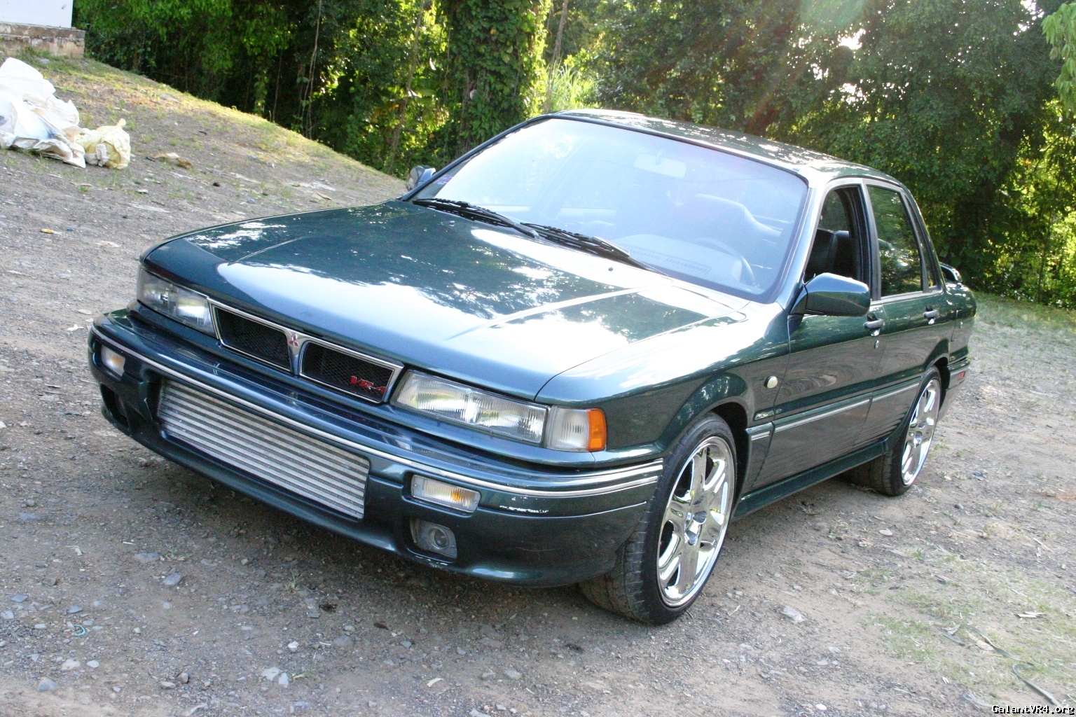

Specs
1352/2000 Time Attack/SOLO 1 1991 VR4

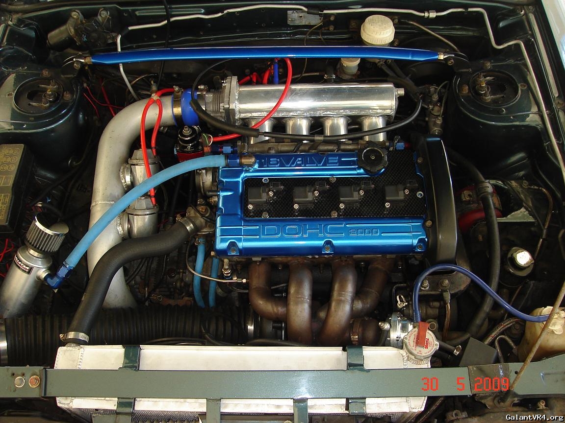

Engine
2.3L Stroker
Eagle rods, CP pistons 9:1, Balance shafts removed
Ported 1g head
Cometic head gasket
Crower springs and retainers
HKS 264 Intake/264 Exhaust Cams
ARP Head Studs and crank main caps
Custom Intercooler and piping
Custom Intake manifold with a 65mm ford Throtle body
HKS Blowoff valve x 2
Tial 44mm wastegate

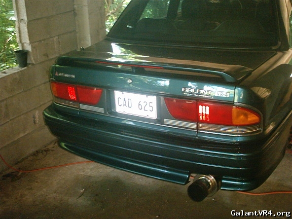

Stainless Manifold, downpipe, 3"complete exhaust with Apex'i N1 muffler (custom paint)
Garett GT3082R Turbo
Bushur coil pack
Oil catch can
Setrab oil cooler kit
Fluidyne radiator 27x17x4.5 dual pass(custom water lines)BERK/ARNLEY 160 Degree Thermostat
FAL Slim-line (pull) Maradyne 1500 cfm(push) radiator fans
850cc injectors
ACT 2900 / 6 puck clutch master disc, custom stainless braided line from clutch pump
4-Bolt LSD Rear diff
Aeromotive FPR and Filter 2 walbro 255 external pumps RCI 15gal fuel cell
Battery relocated
MOMO Steering wheel
Suspension tires brakes
KYB AGX Adjustable shocks struts
Eibach springs
Camber Plates

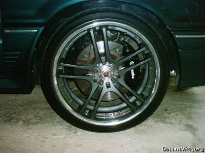

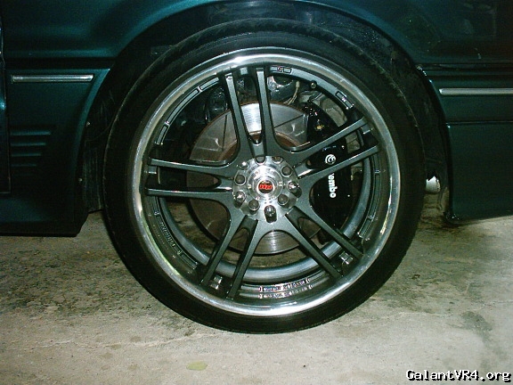

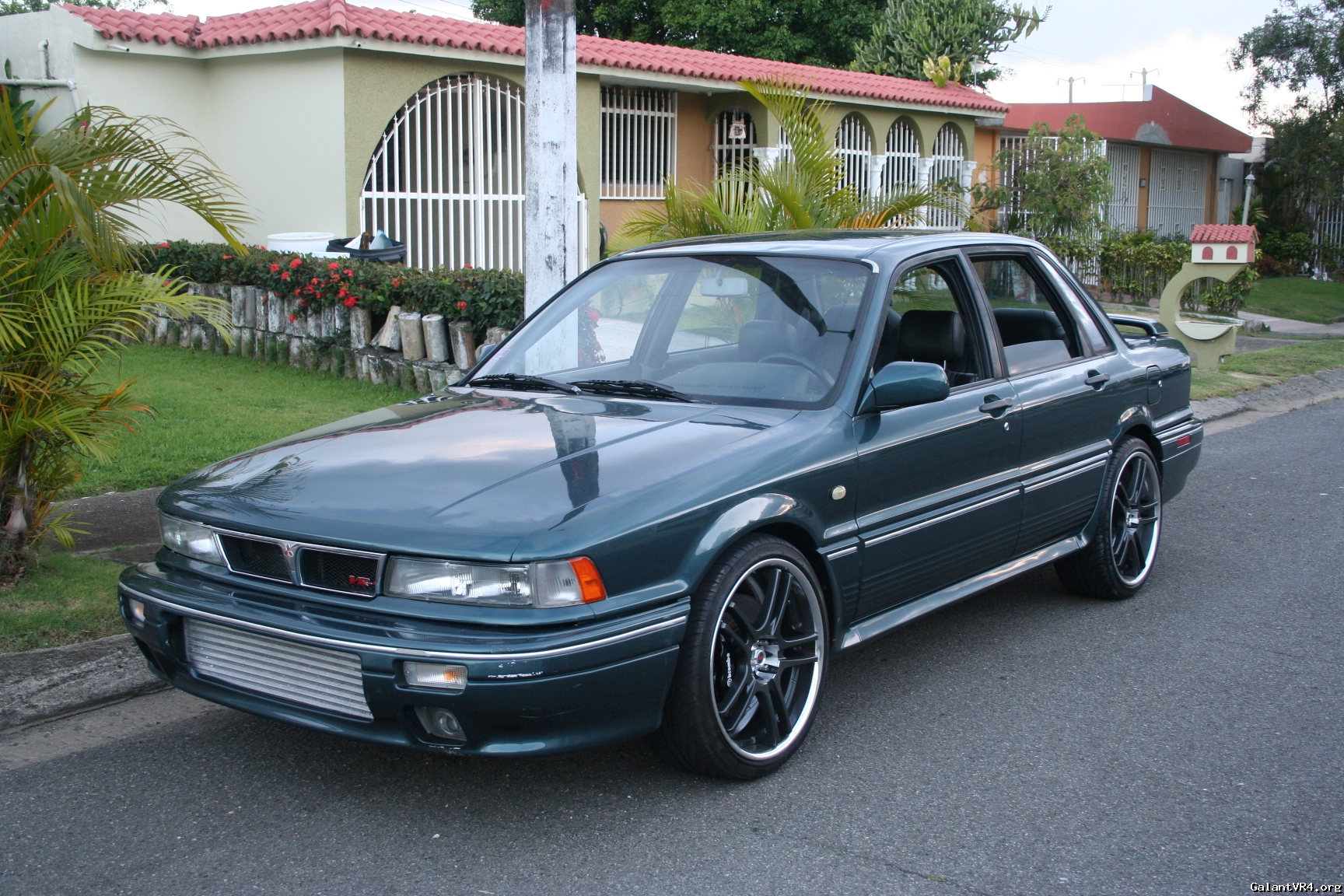

Racing Hart Pro series J5 wheels 19x8(street)

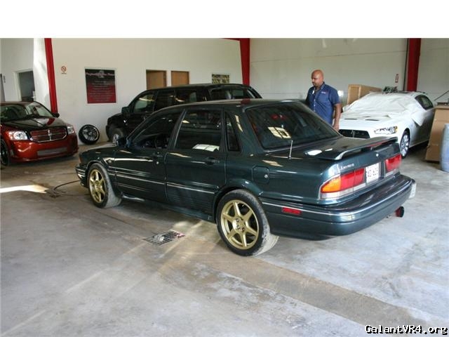

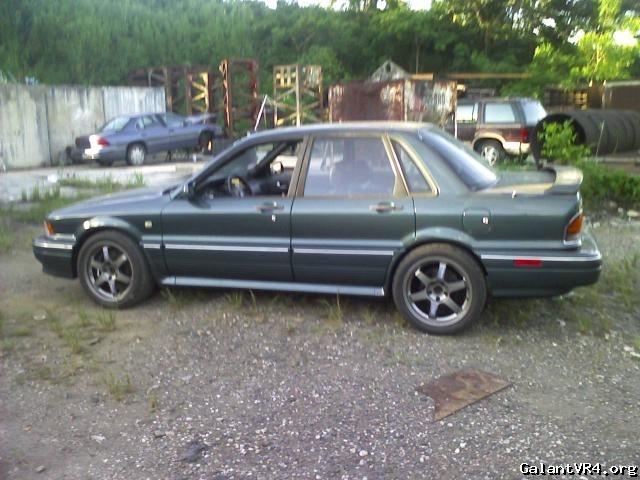

Volk Racing TE 37 Wheels 17x9/ Toyo Proxes RA1 tires 255/40/17(solo 1)
Brembo front caliperz with Project Mu (max 900)pads, Motul 660, stainless braided lines
ABS and rear steering removed
Varis Rear Voltex Diffuser (on JDM rear bumper)

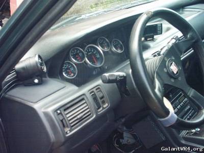

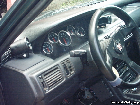

Electronics
Microtech LTX 8
Defi gauges EGT, Oil P, Oil T, Rev, Boost, Water Temp in custom cluster with a carbon fiber plaque
PLX wideband
HKS Turbo Timer
Greddy Profect B Boost Controller

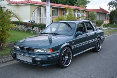

Holy clap, that is one nicely modded example!
The IC piping looks huge plus I still see the A/C lines...
